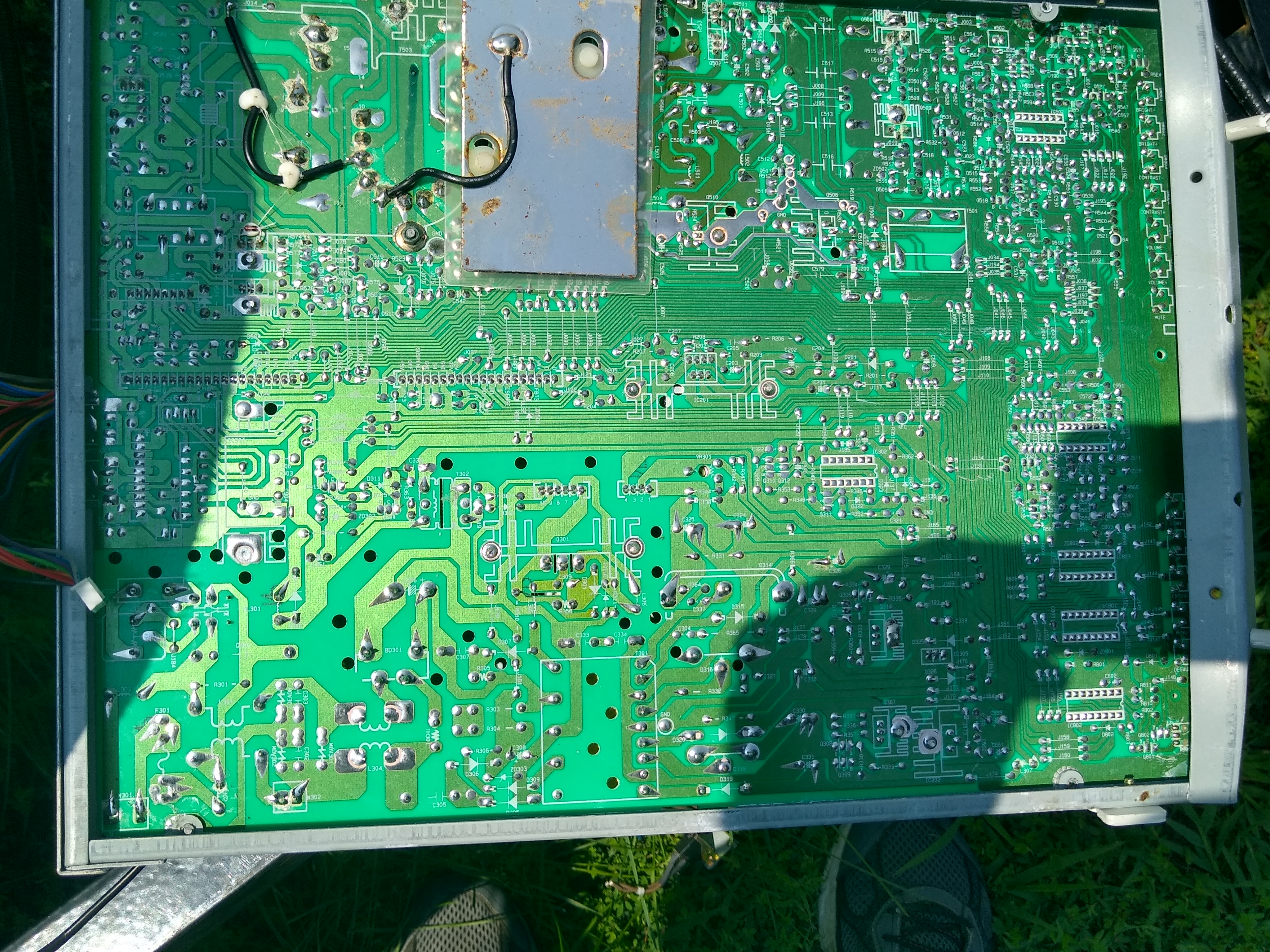

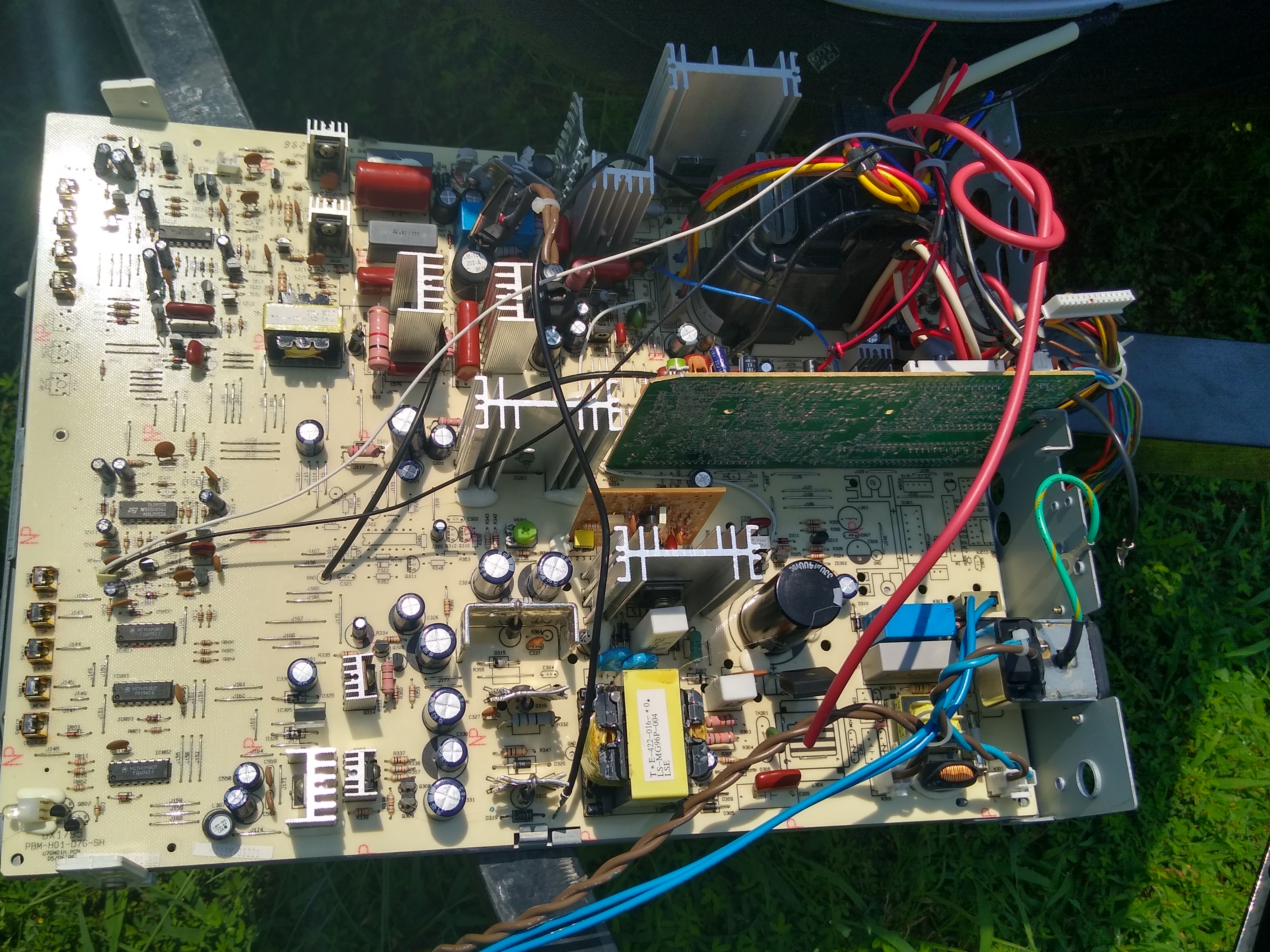

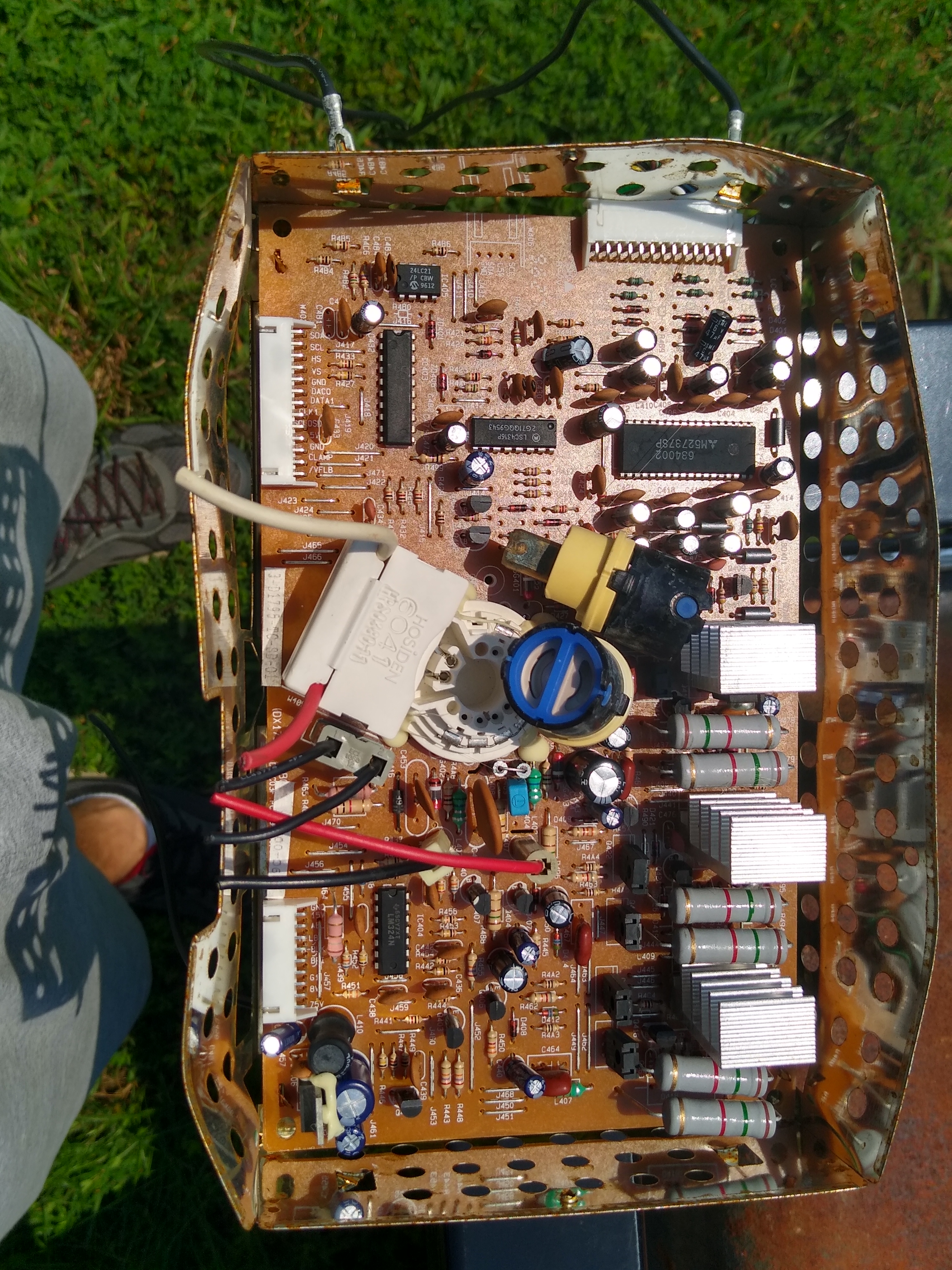

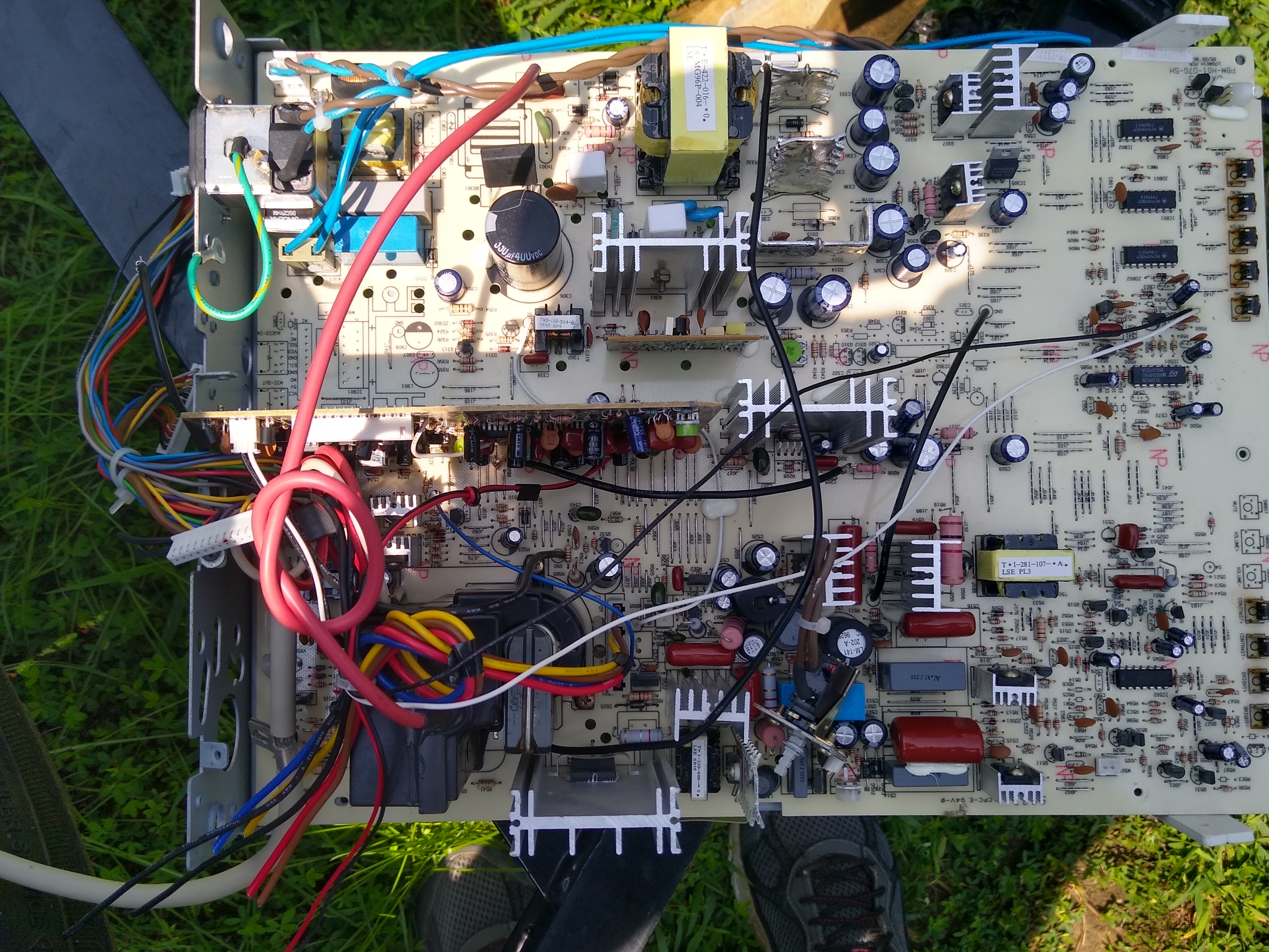

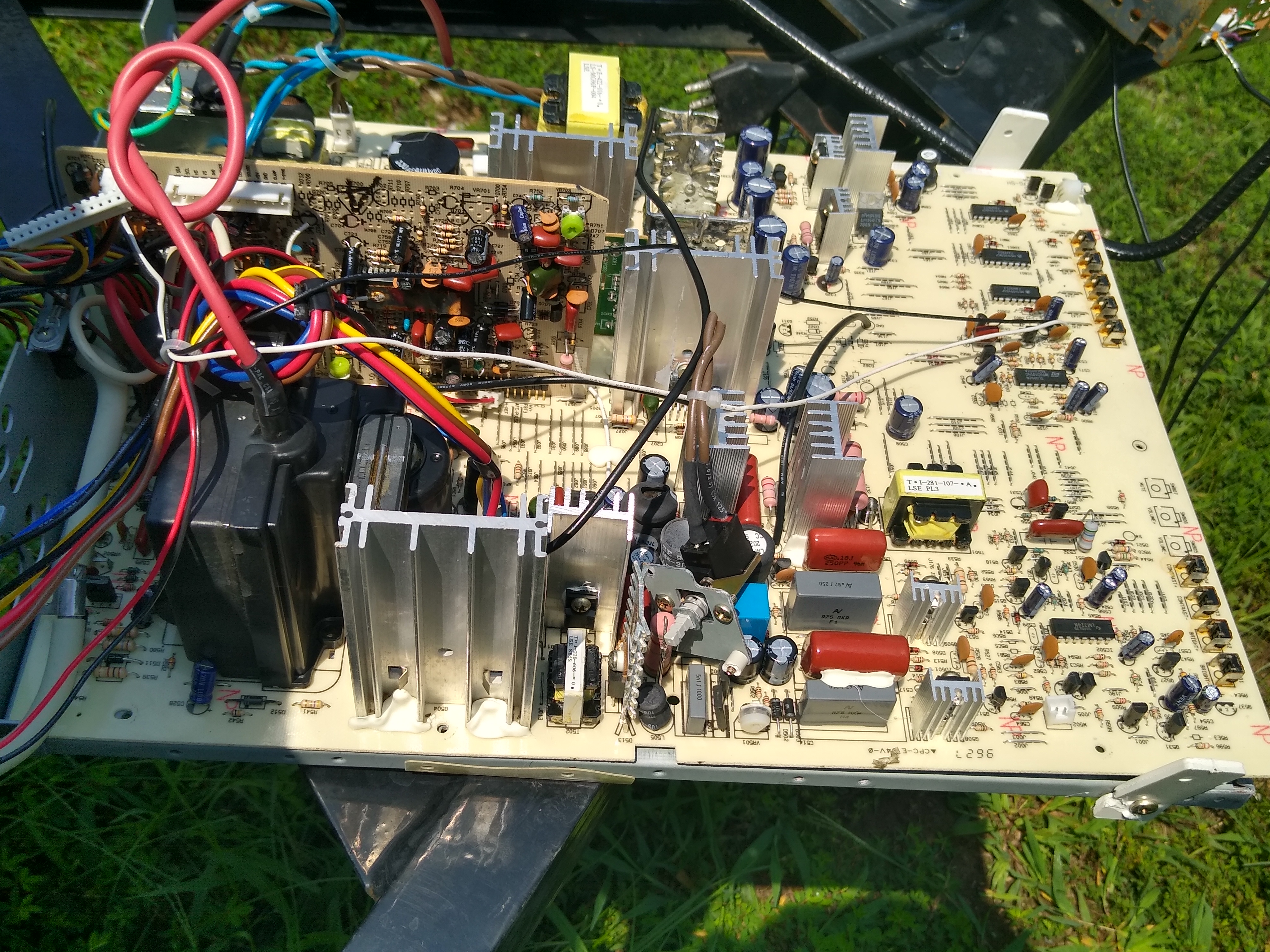

These came out of an old CRT monitor from the 90s
Thinking low grade on everything.... Other than the wires being removed and the metal casement on the last board pic, does anything else need to be removed? ex. the big capacitor/supply.

those are all low grade.
I would pull the aluminum, wires and the IC chips, transformers.

It appears that all of the TV mainboards are still have their mild steel backing plate on them, these need to be removed (held on with a few more screws, they may be slightly hidden). Along with any wire. Anything else is optional, but it really depends on what your low and mid grade board situation is, like bringing in person, or shipping.
