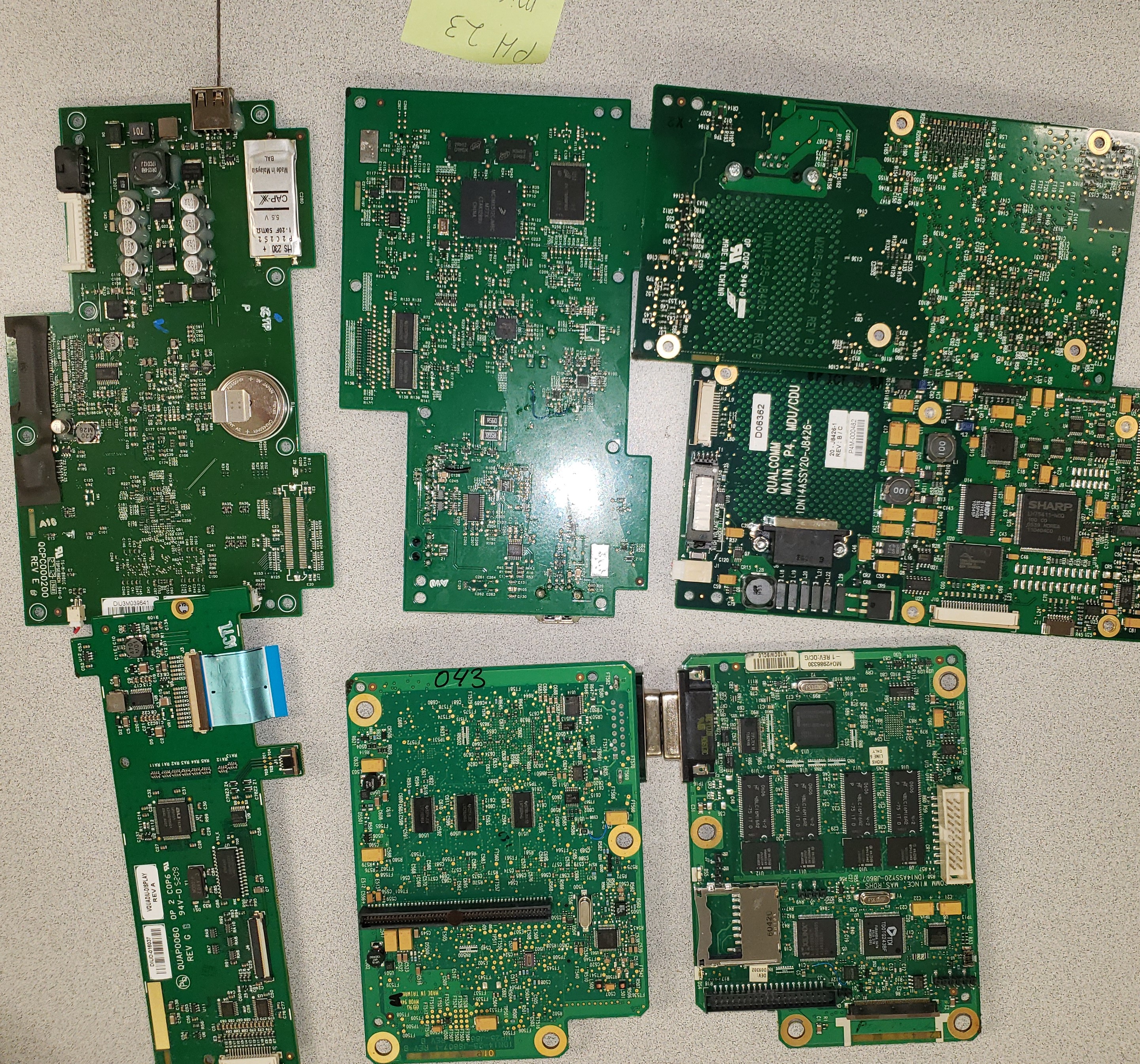

PH 23: All High Grade Peripheral

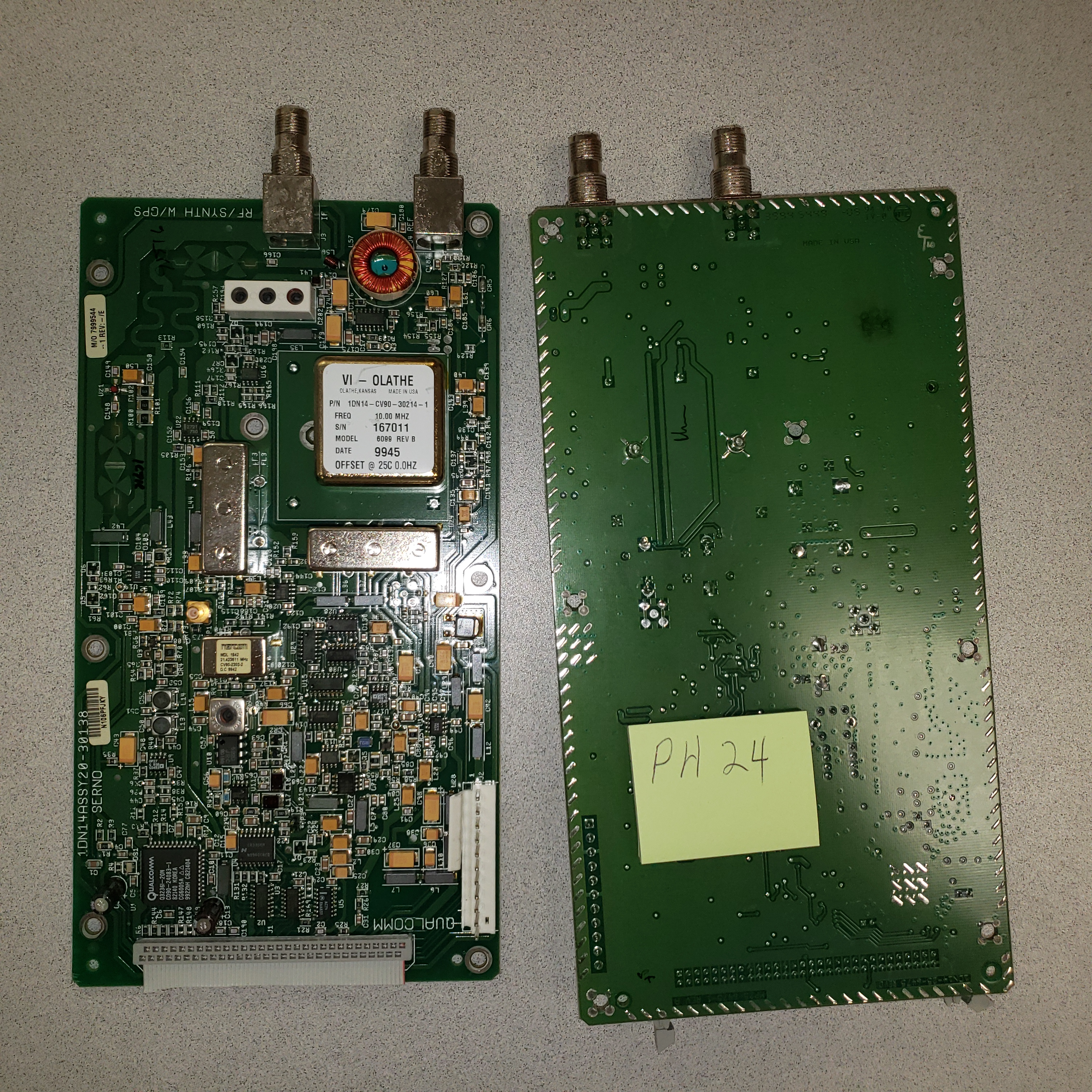

PH 24: Low Grade Peripheral

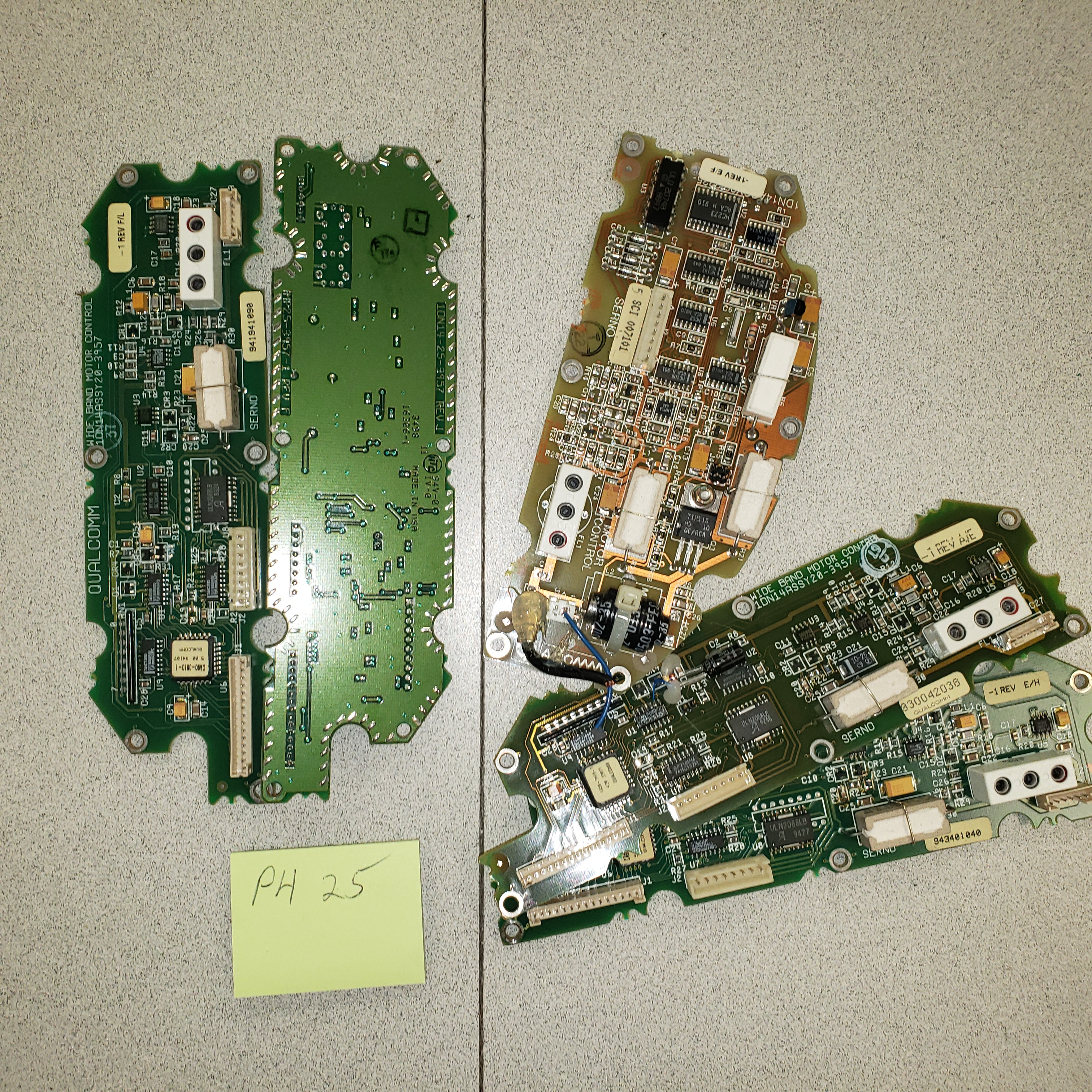

PH 25: Cut the boards in half; throw the populated halves in High Grade Peripheral and the other halves in Low Grade.

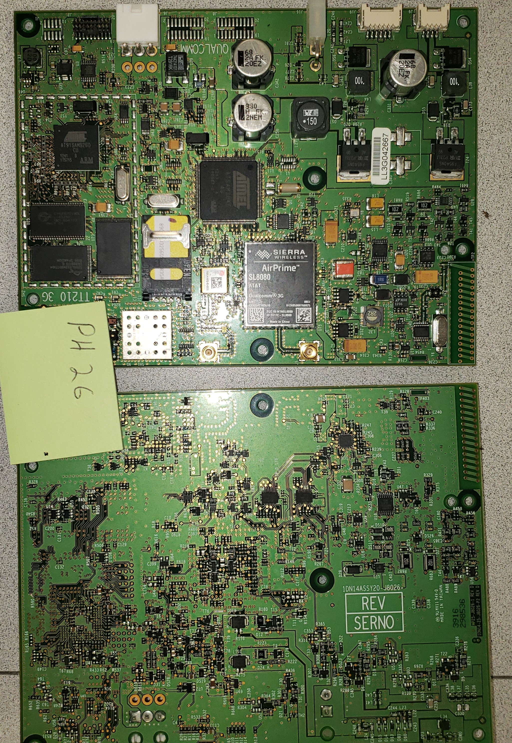

PH 26: High Grade Peripheral

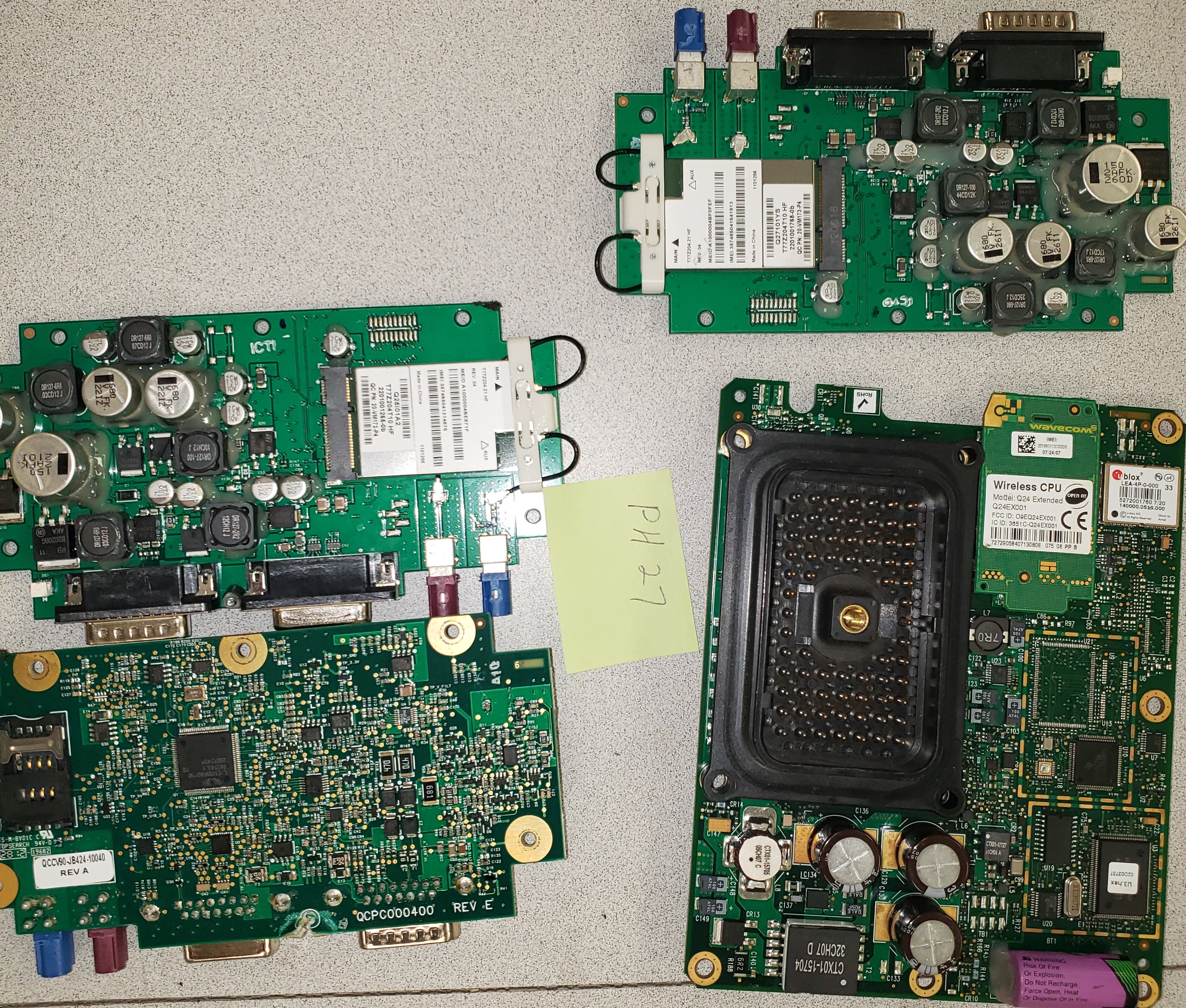

PH 27: All Low Grade Peripheral; remove the wireless cards and the wireless CPU. The wireless card will go as Clean Gold Finger Cards if you fully remove the shields on them. The wireless CPU will probably go as High Grade Peripheral. And make sure you remove that purple battery.
