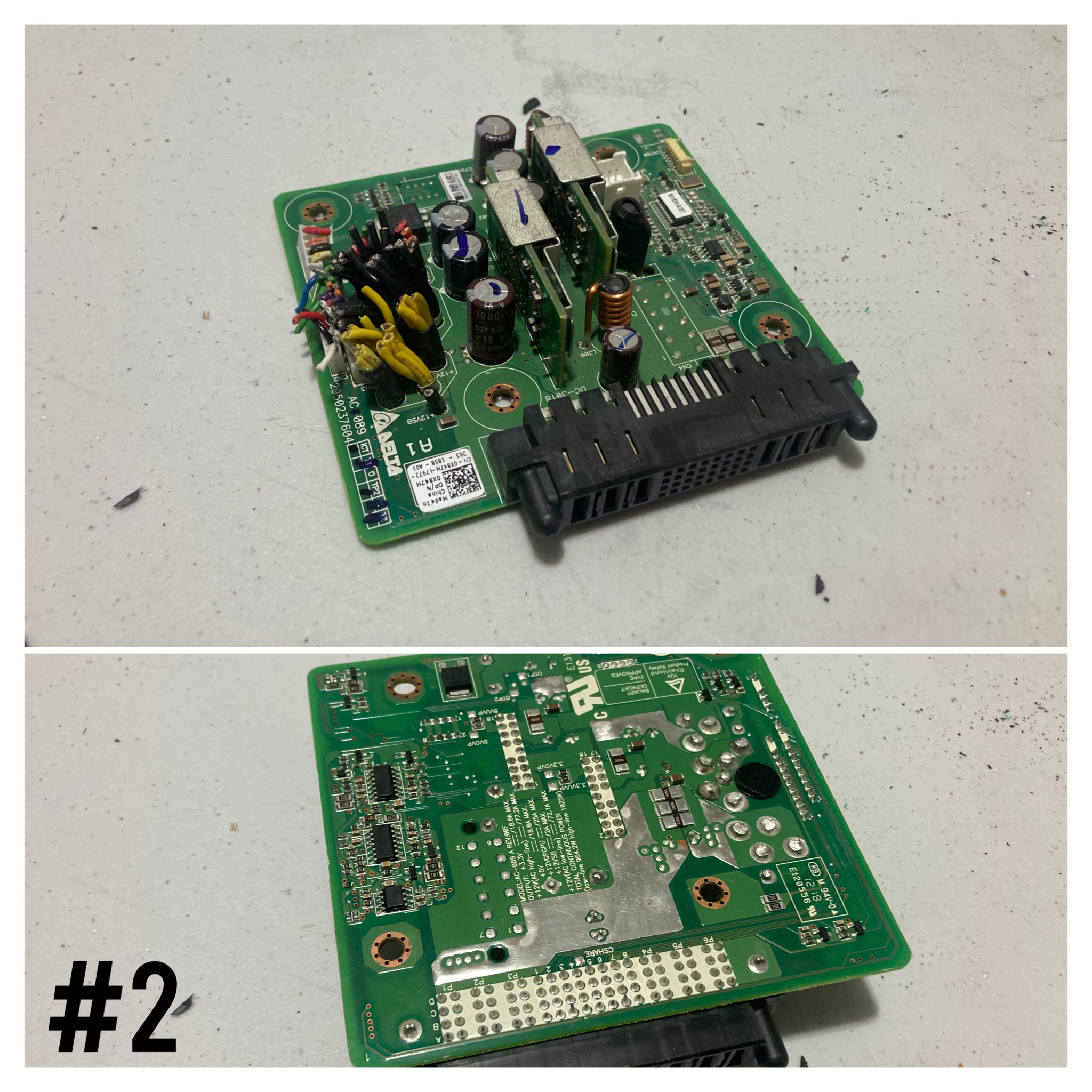

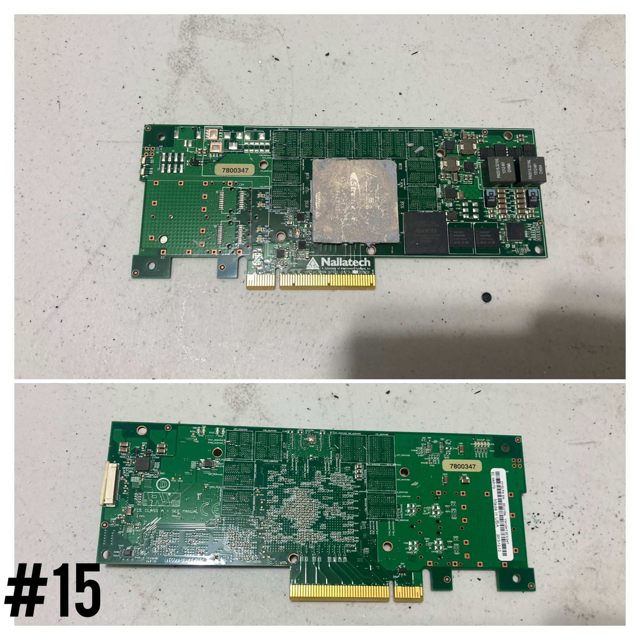

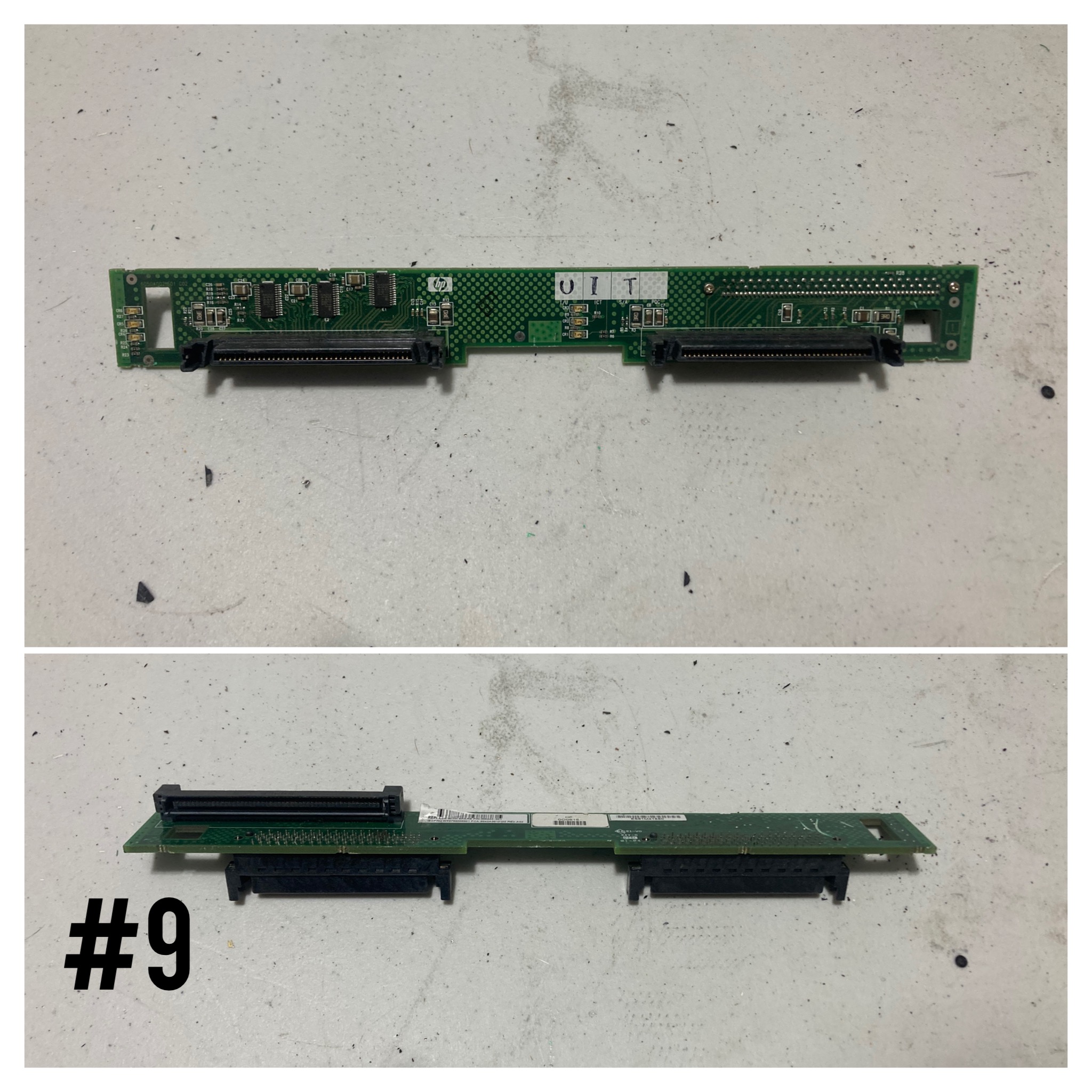

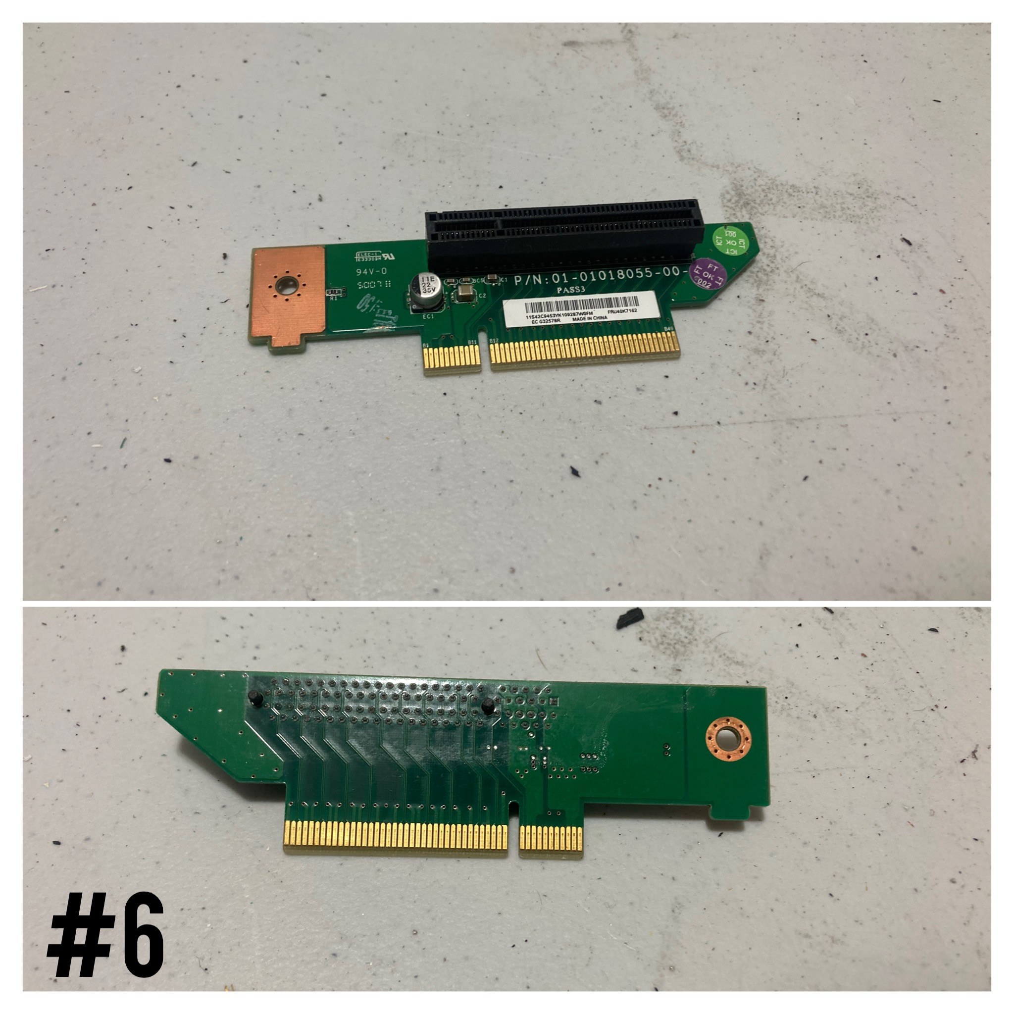

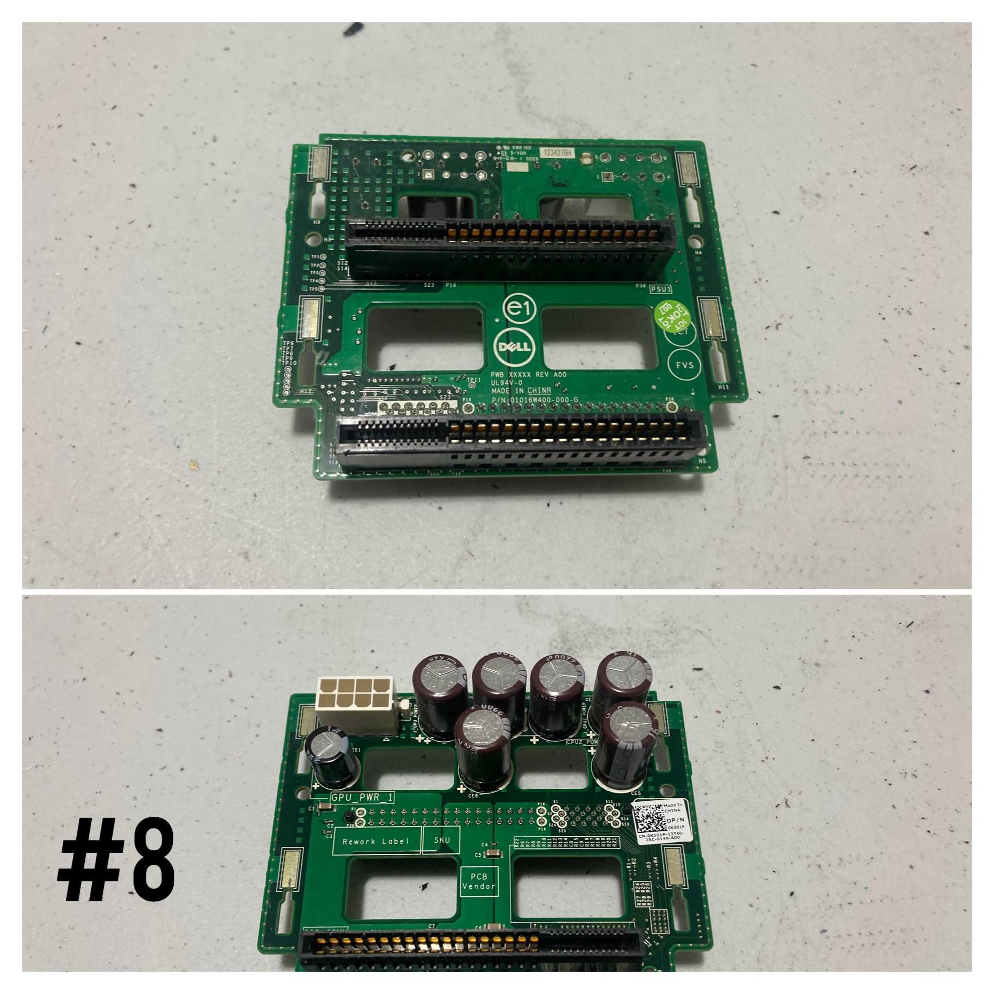

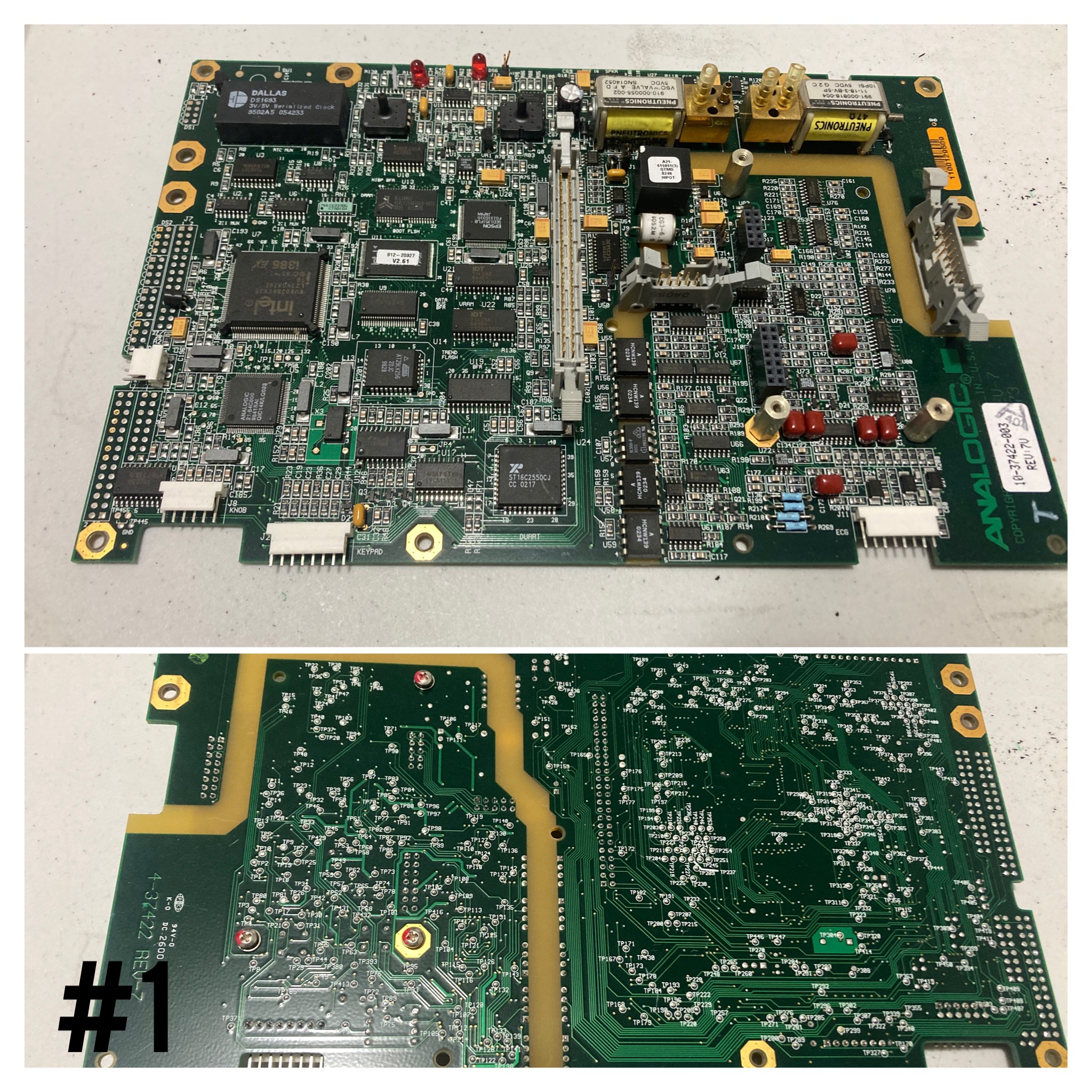

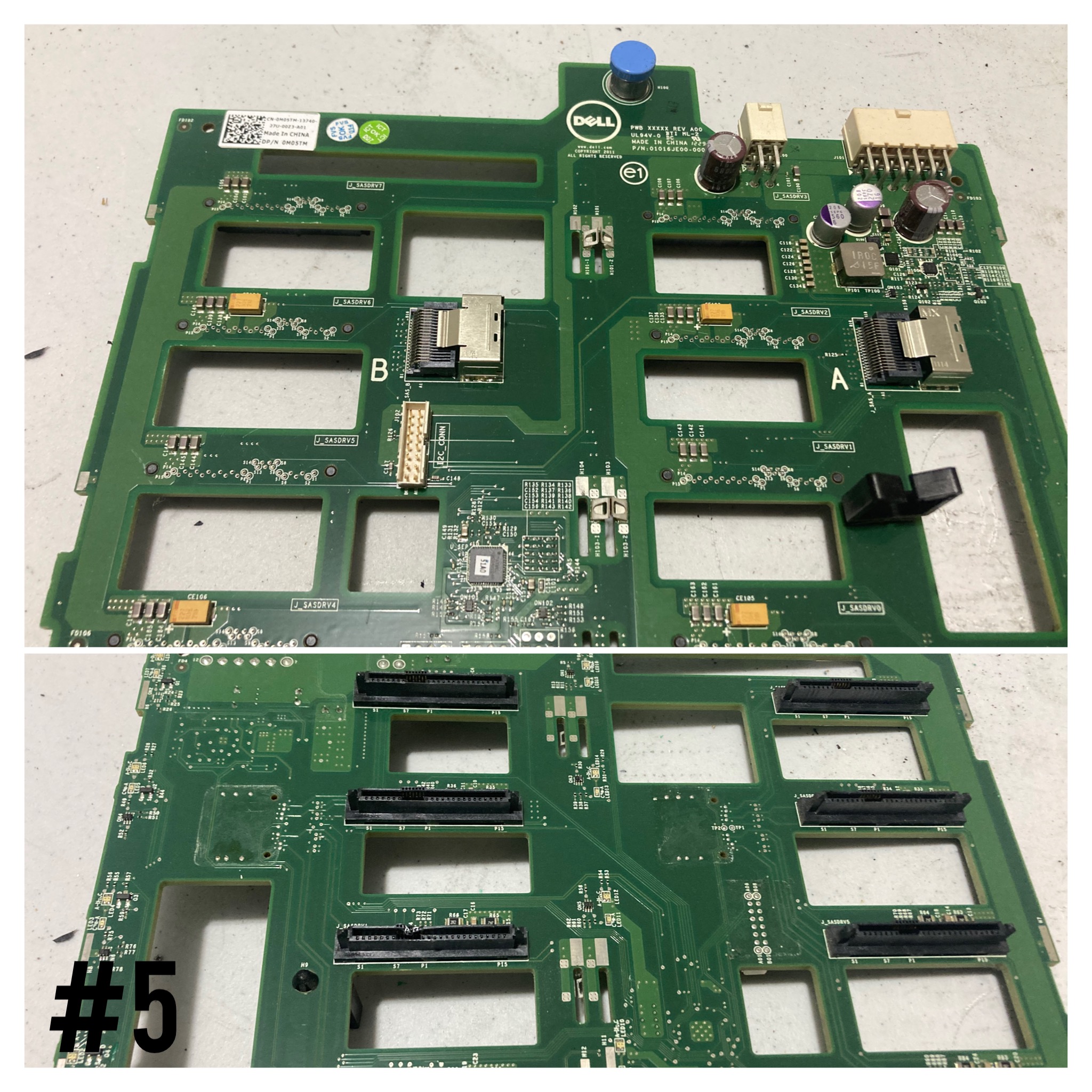

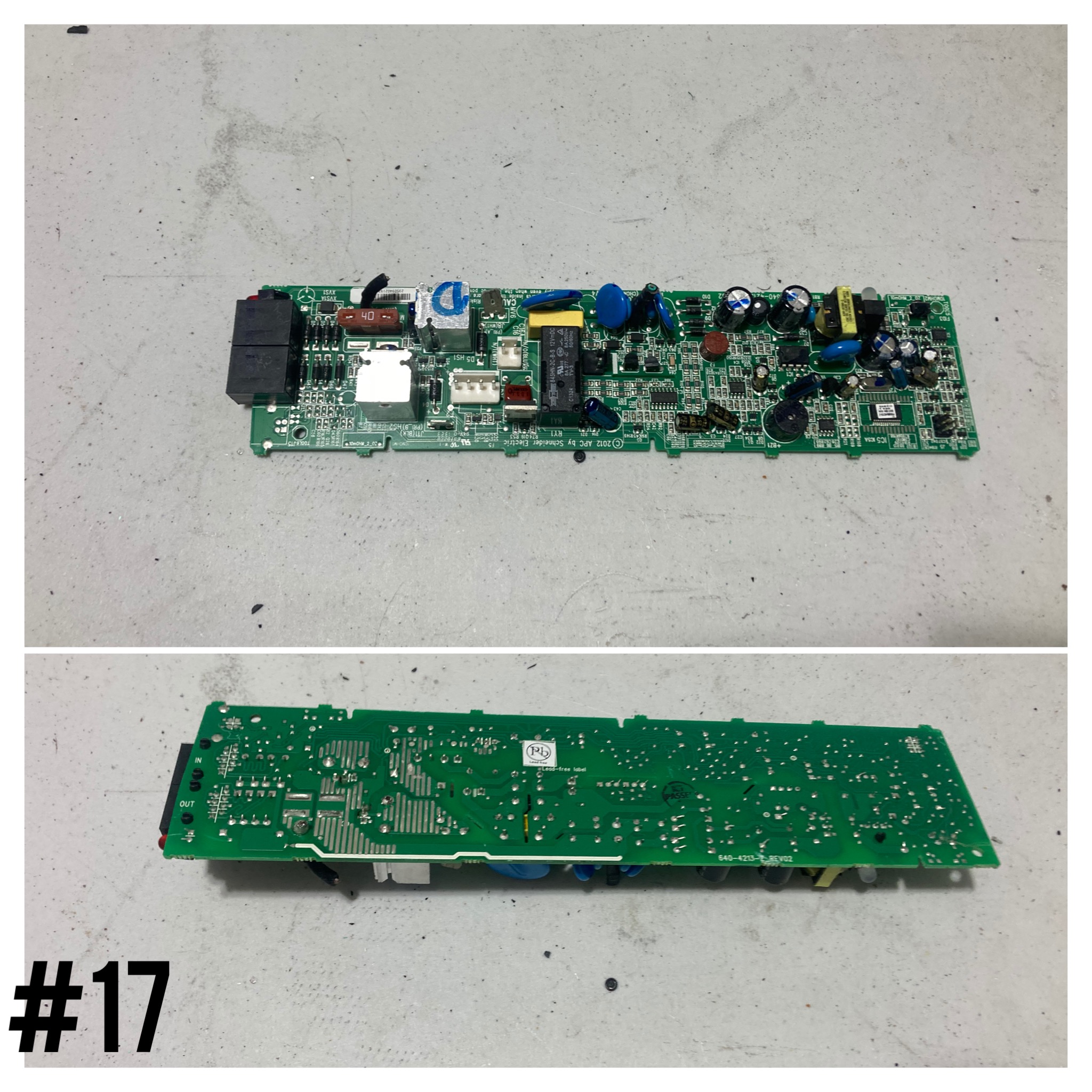

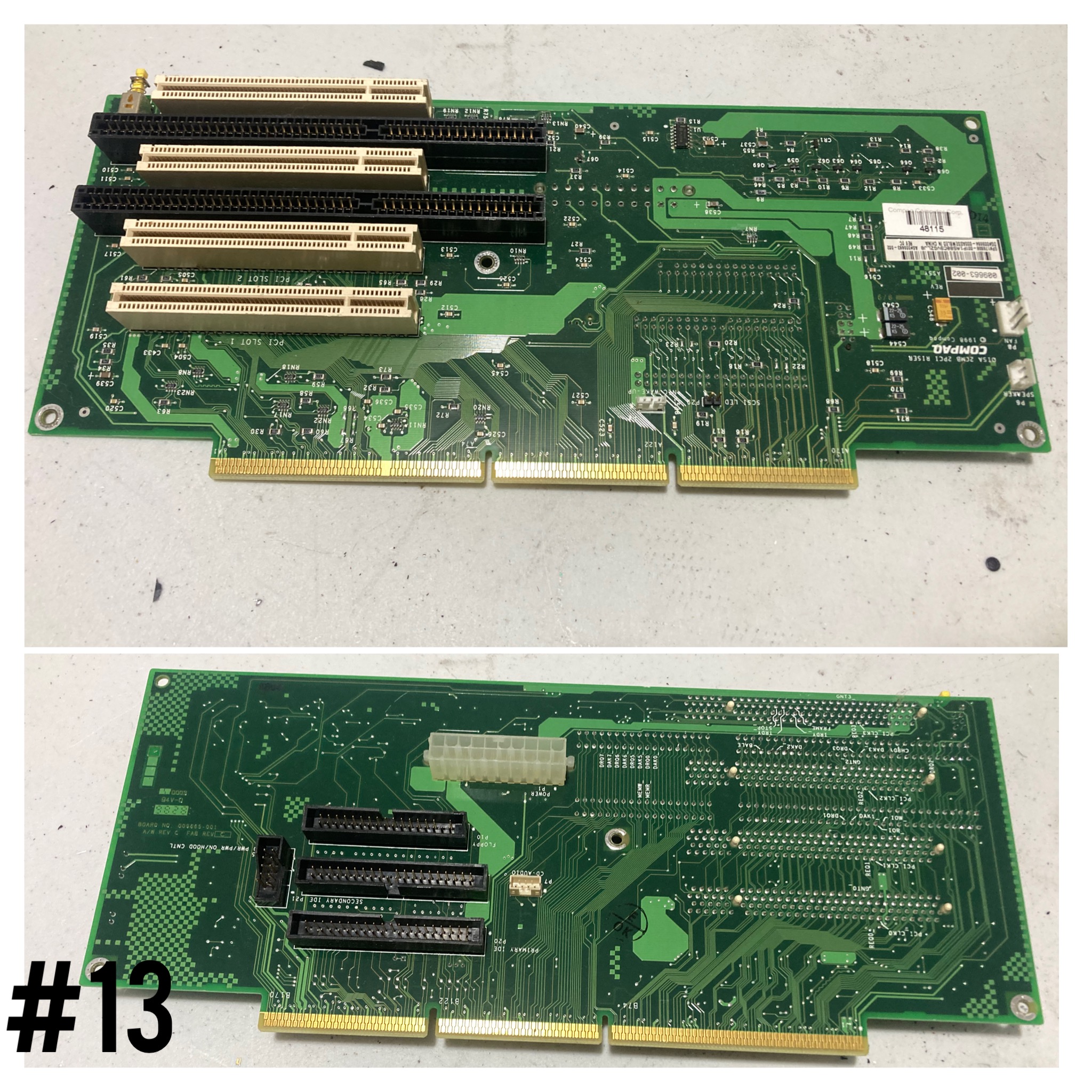

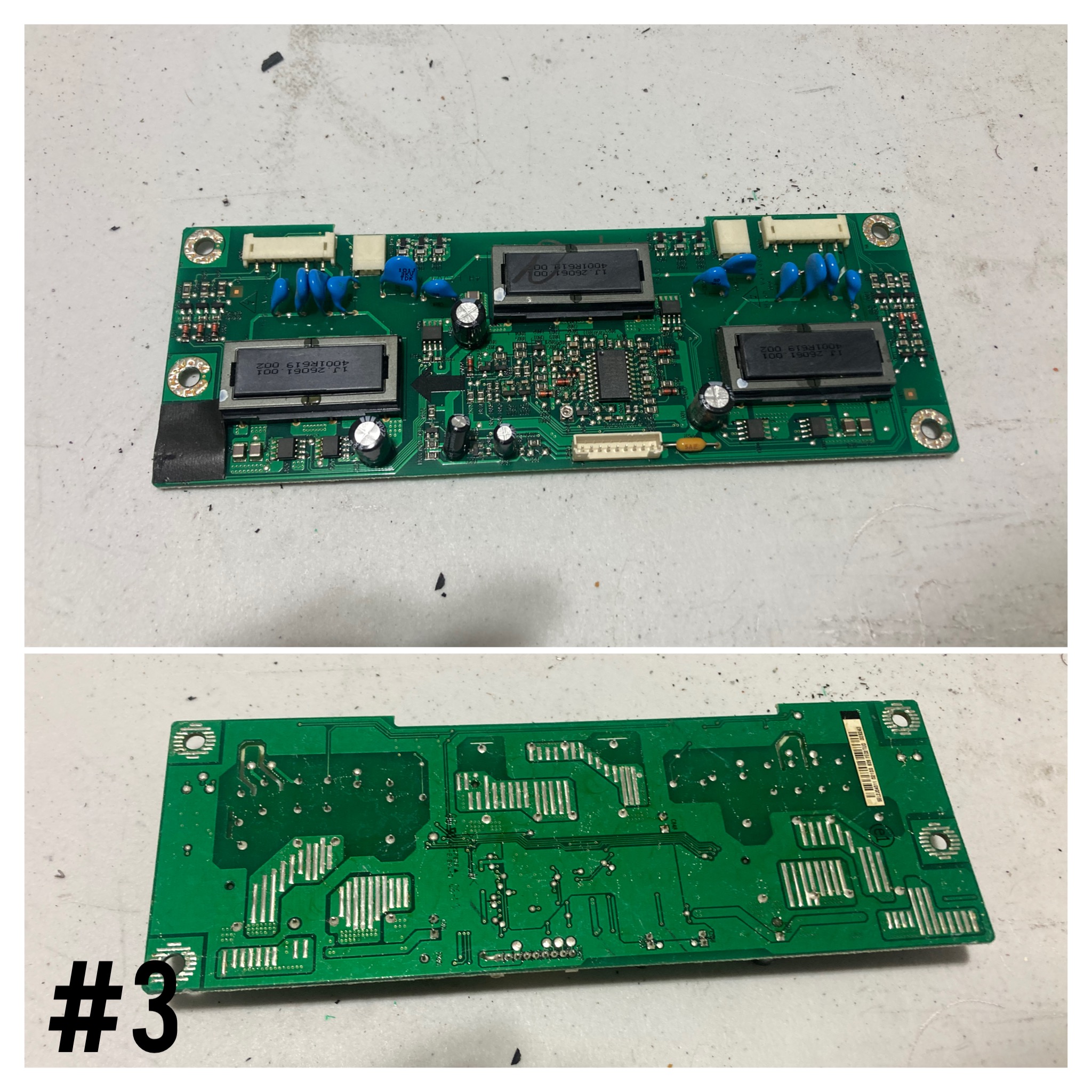

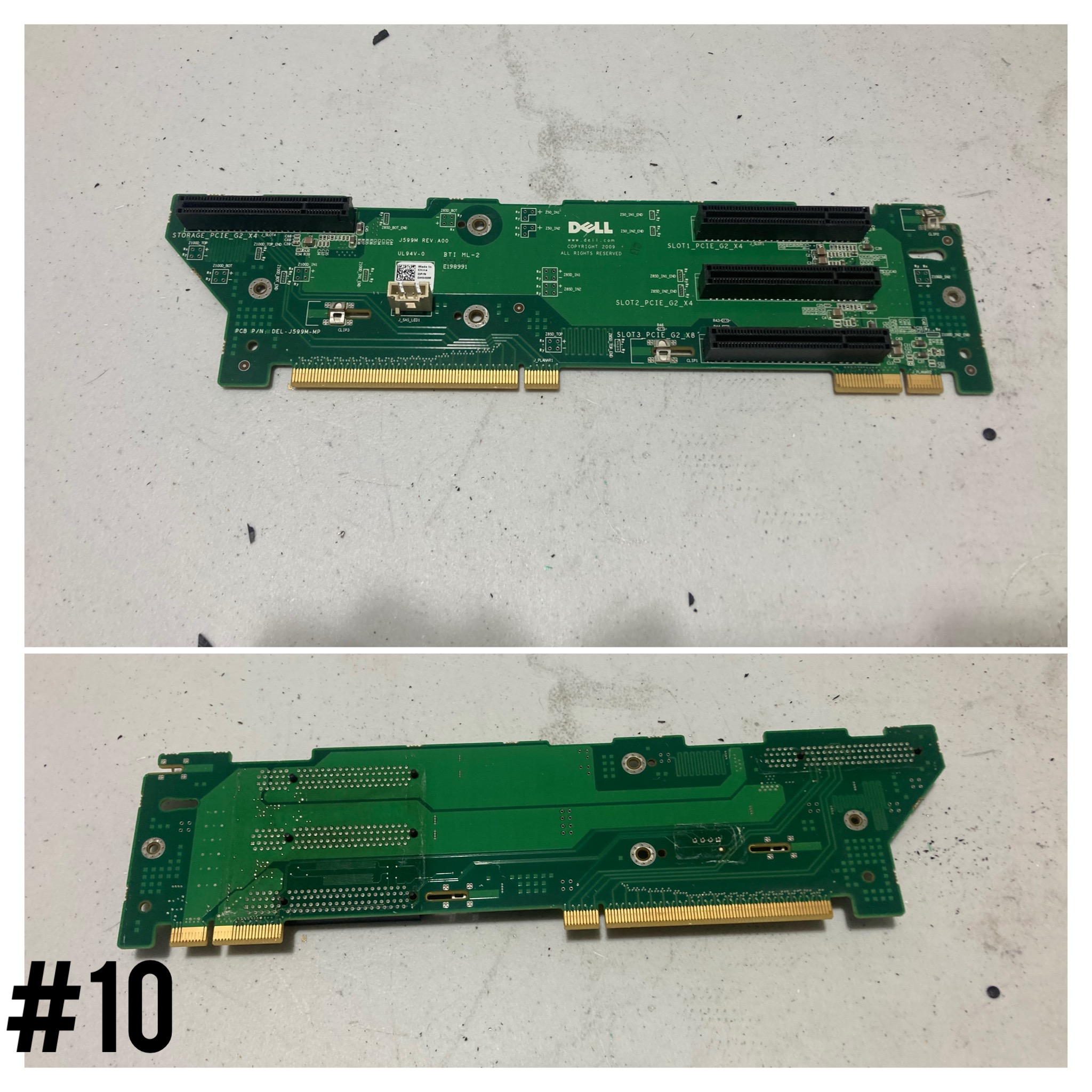

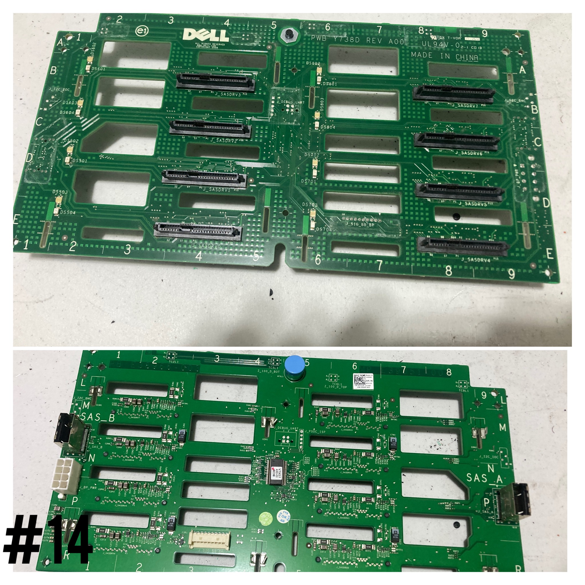

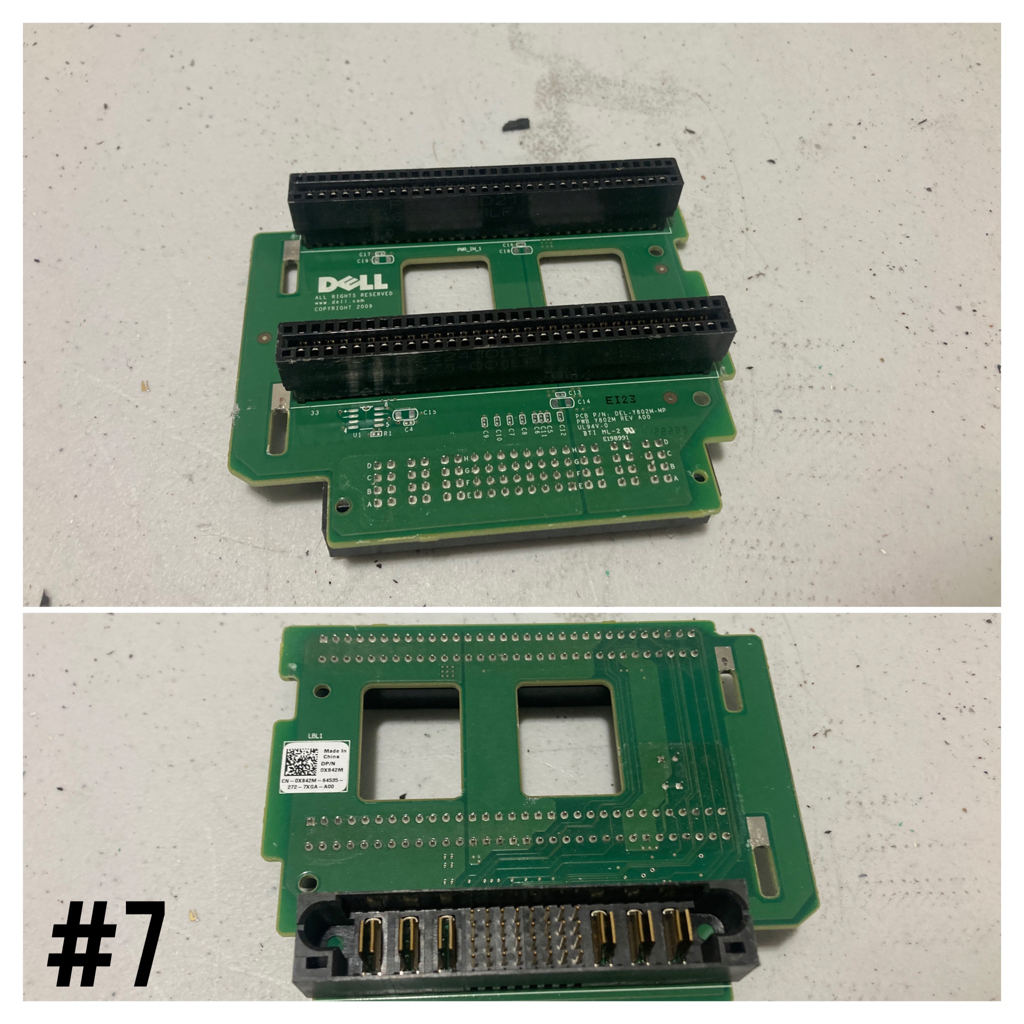

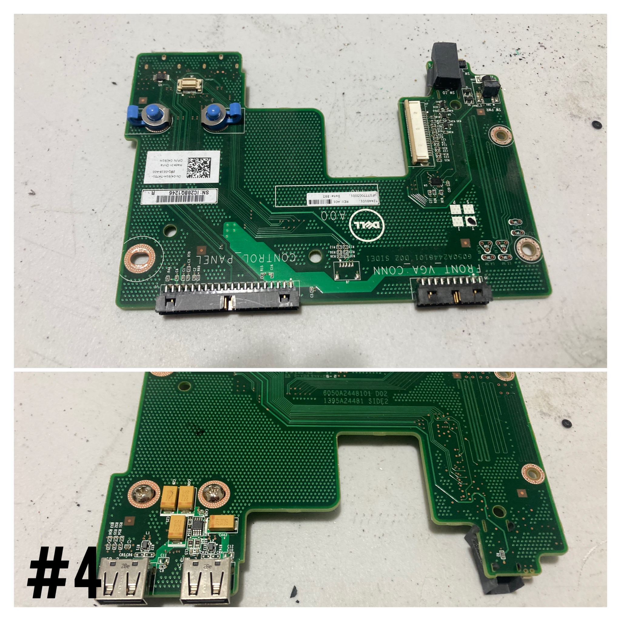

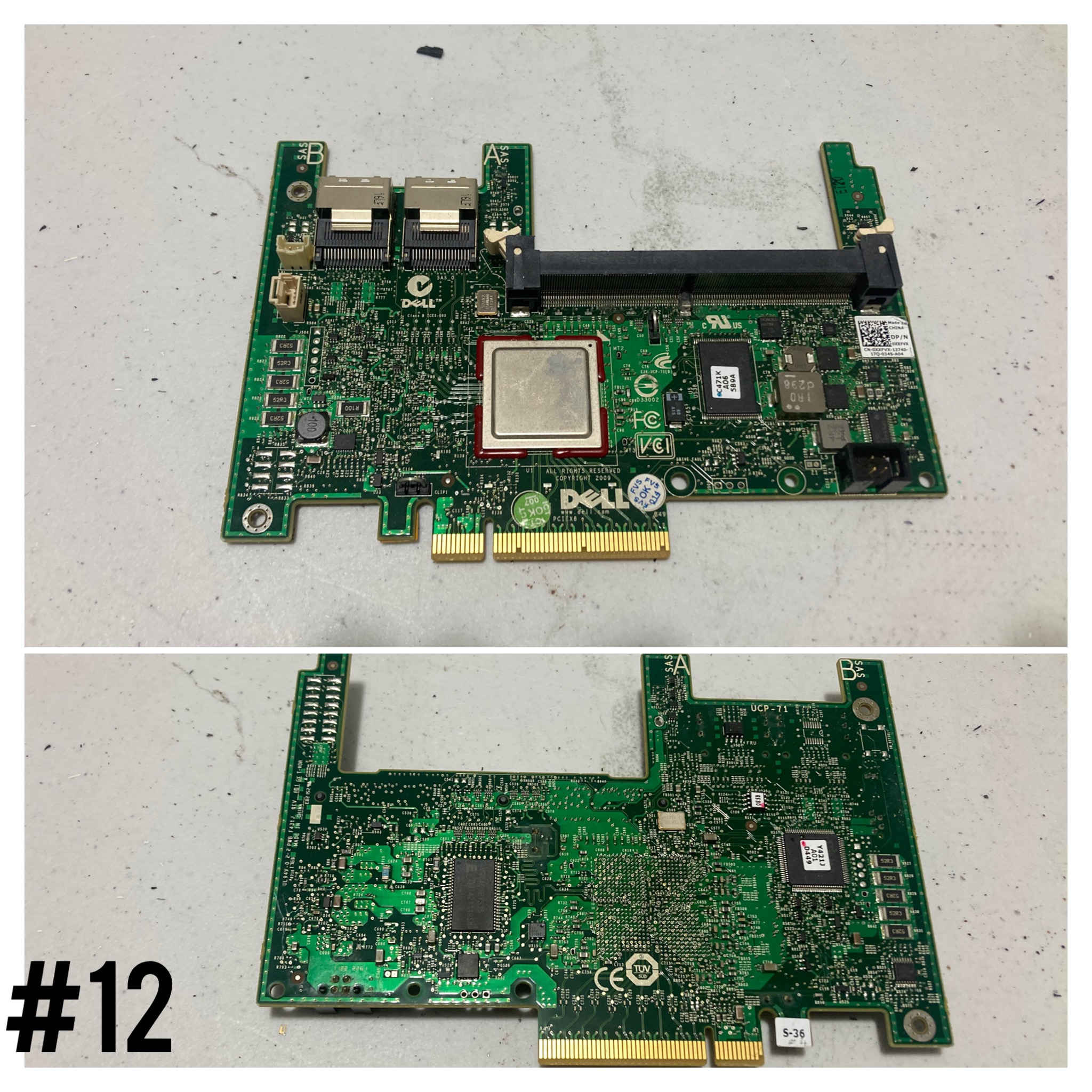

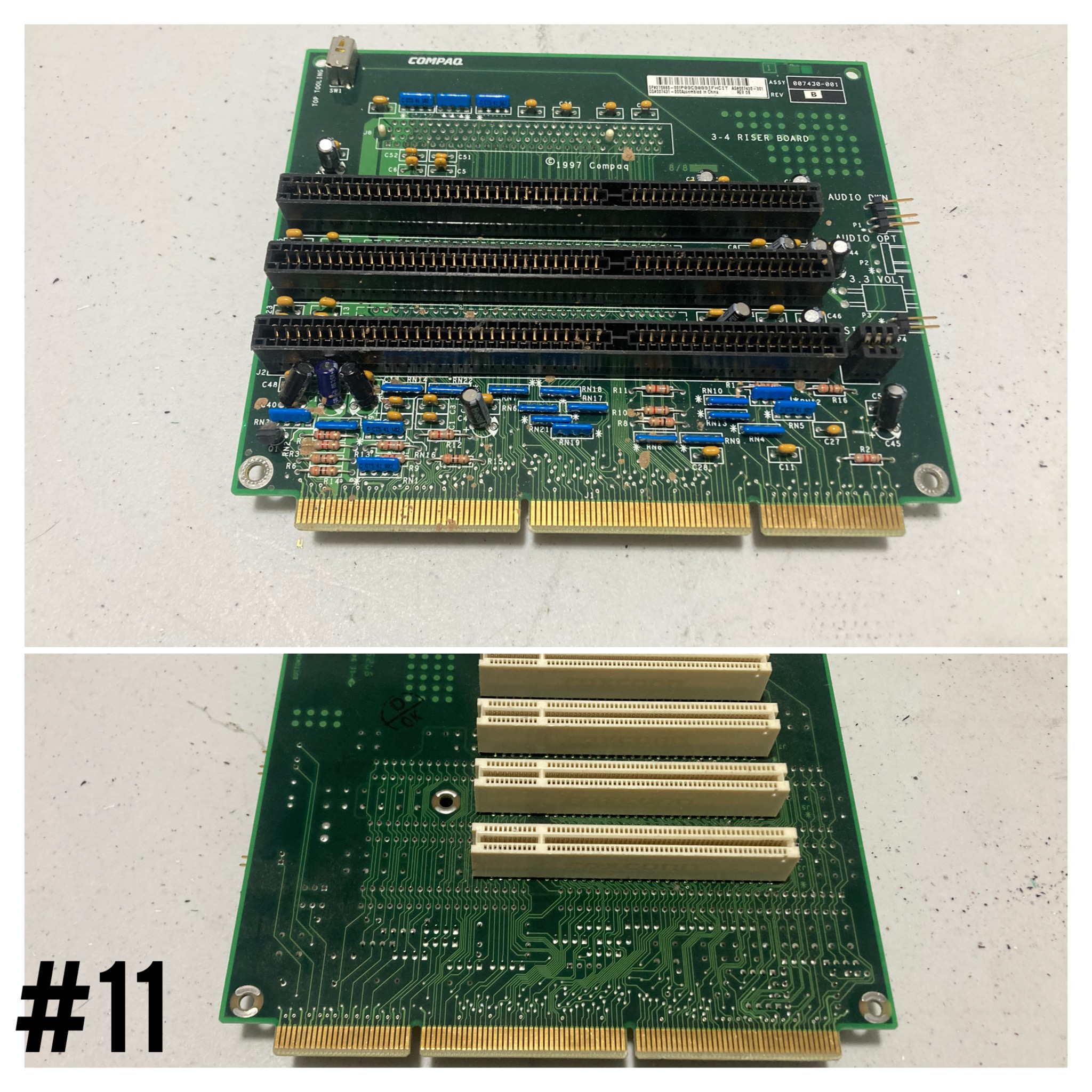

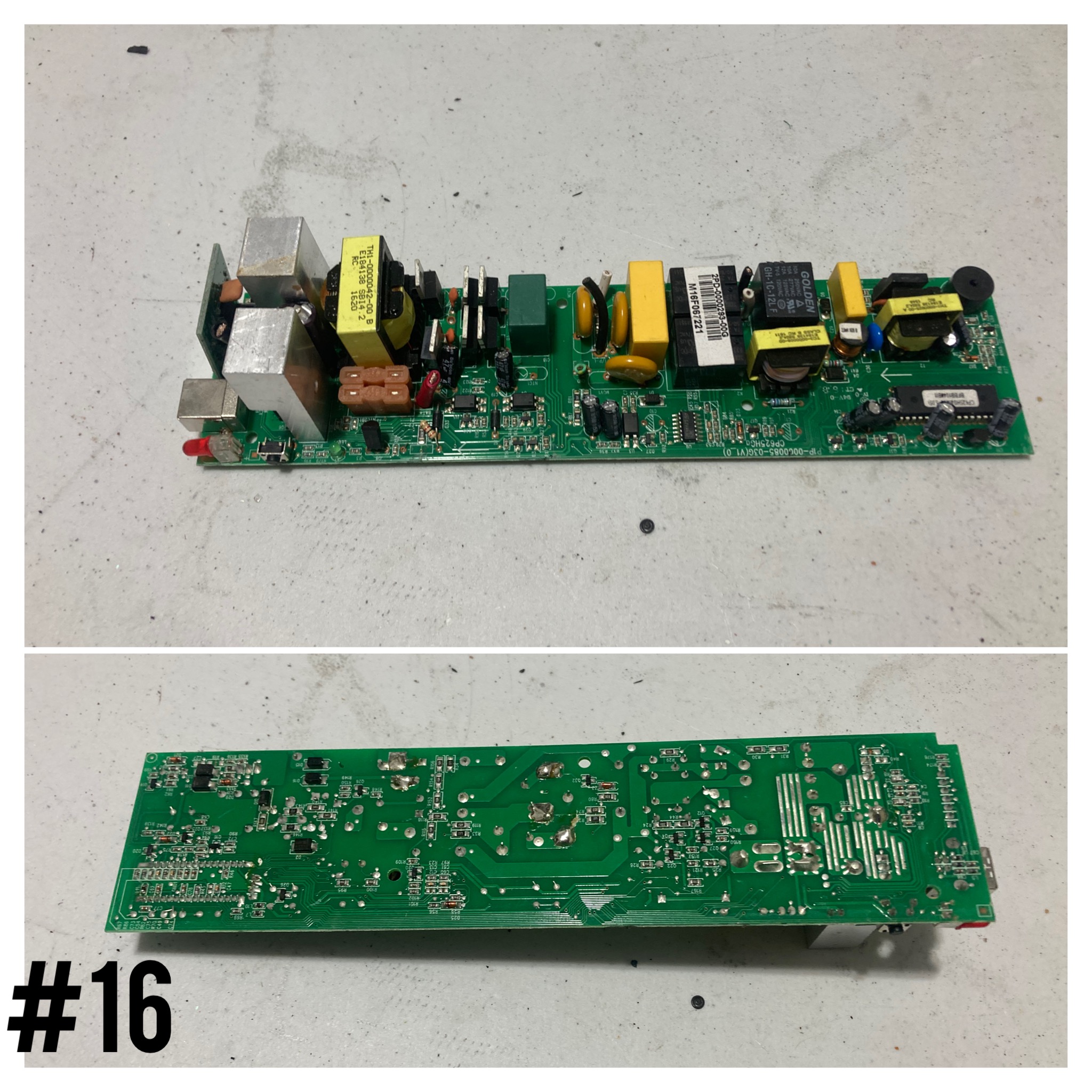

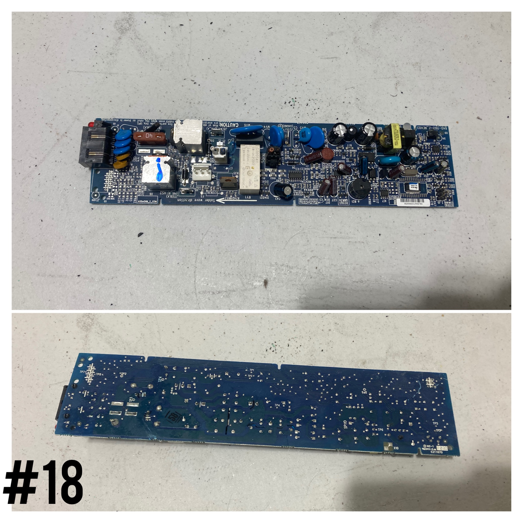

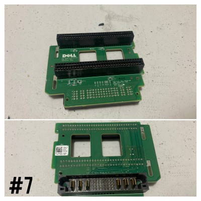

Hey Guys and Gals! Wondering if you lovely people could help me make sure I get these boards sent in in the right categories. Any help is much appreciated and thanks so much in advance. Pictures attached with numbers. Also if there is anything I should remove for higher value please feel free to share that information with me.

1) High Grade Peripheral; remove the black box that says Dallas on it as it has a battery inside.
2) Midgrade
3) Midgrade
4) Low Grade Peripheral
5) Backplane
6) Clean Gold Finger Card
7) Backplane
8) Remove those capacitors for Backplane
9) Backplane
10) Clean Gold Finger Card
11) Clean Gold Finger Card
12) Clean Gold Finger Card
13) Clean Gold Finger Card
14) Backplane
15) Clean Gold Finger Card
16) Low Grade
17) Midgrade
18) Midgrade
I'm double checking with Chris on boards 1, 5, 10, 11, 13, and 14.

Thanks so much ccussins for the help. Glad I asked because I was definitely off on a few of them.

Updated Info:
Per Chris this is what the boards are.
1 telecom high clean pneumatics and screw posts
2 midgrade
3 midgrade
4 midgrade
5 backplane
6 gold finger card
7 backplane
8 backplane
9 backplane
10 gold finger card
11 gold finger card
12 gold finger card
13 gold finger card
14 backplane
15 gold finger card
16 midgrade
17 peripheral low
18 peripheral low
