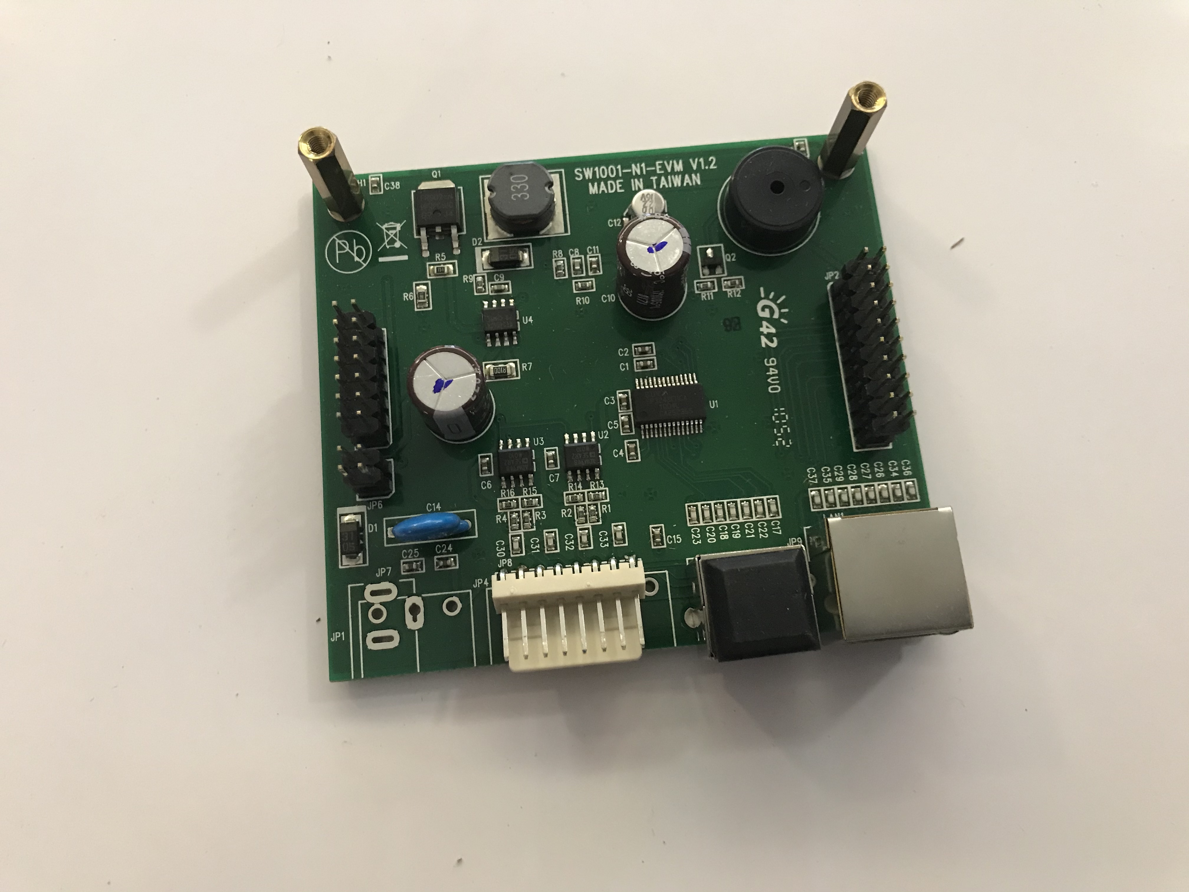

1) Midgrade

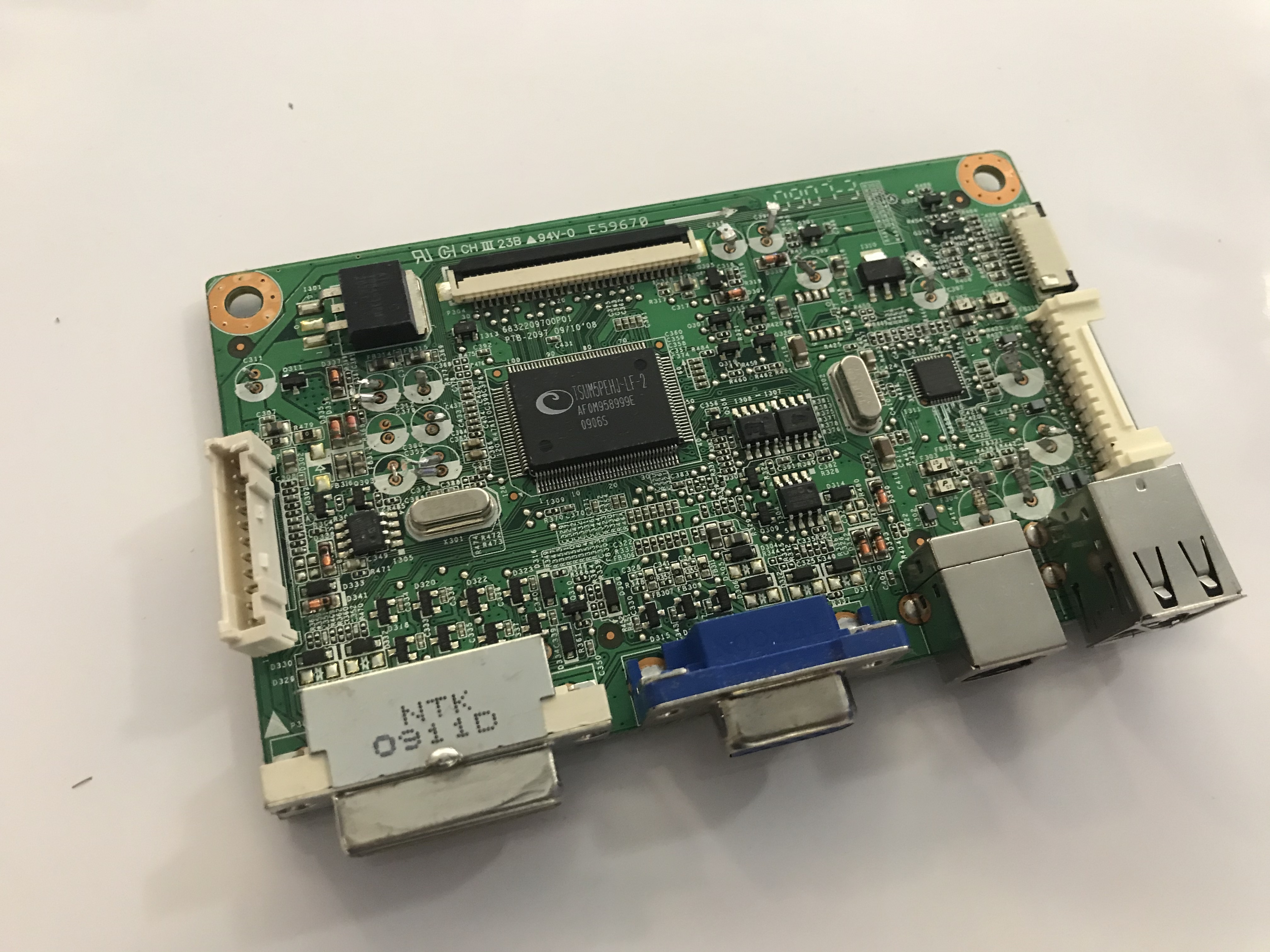

2) High Grade Telecom if you remove the 4 components that are labeled S1, S2, S3, and S4.

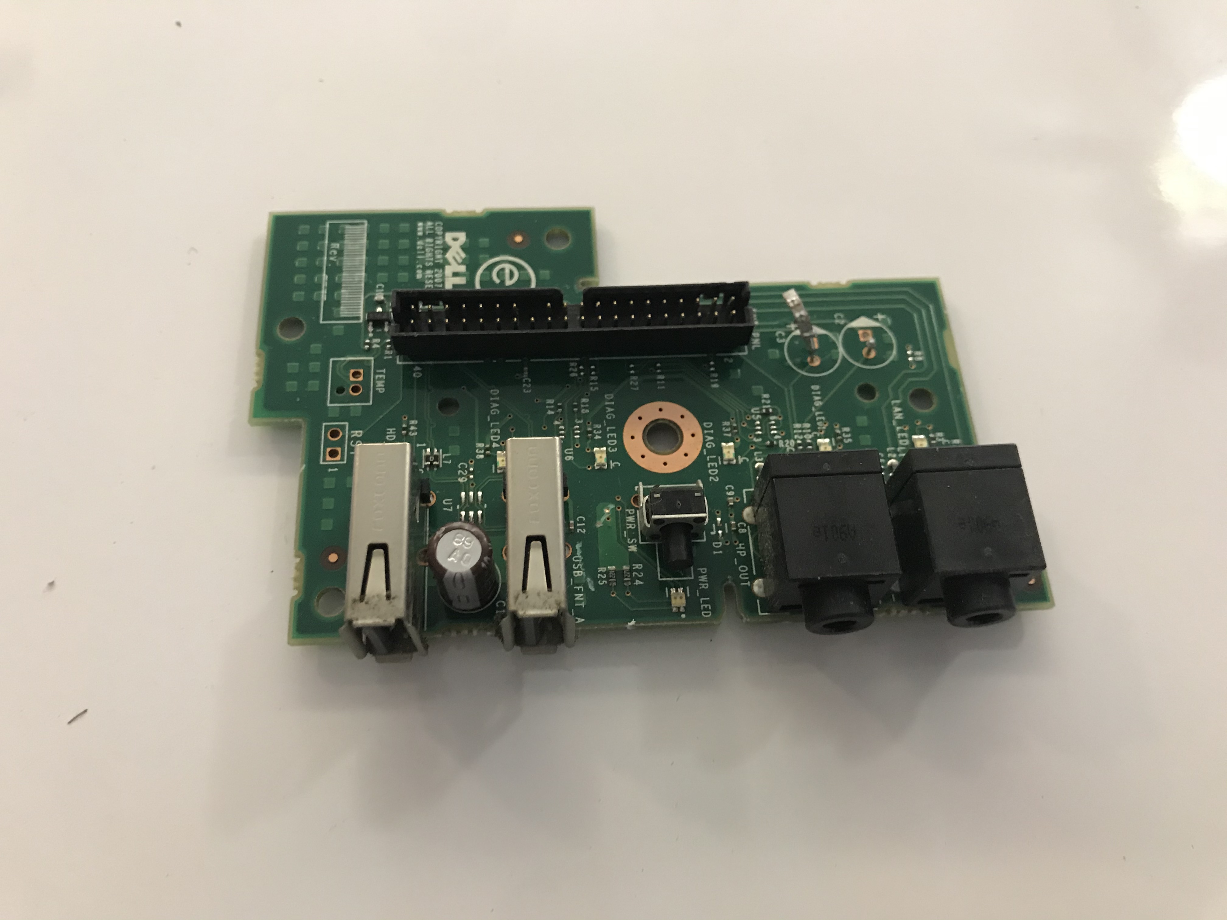

3) High Grade Telecom

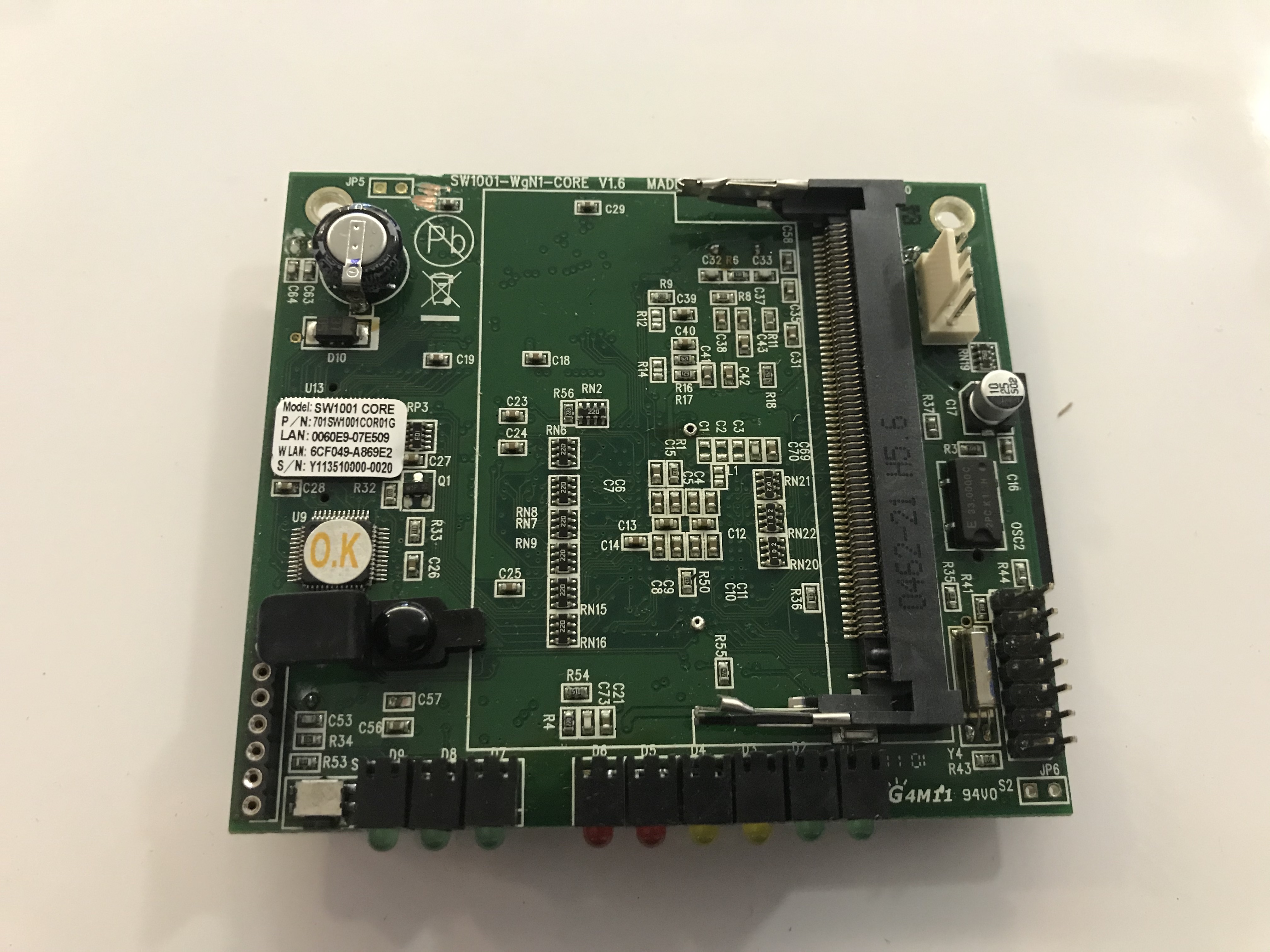

4) High Grade Peripheral

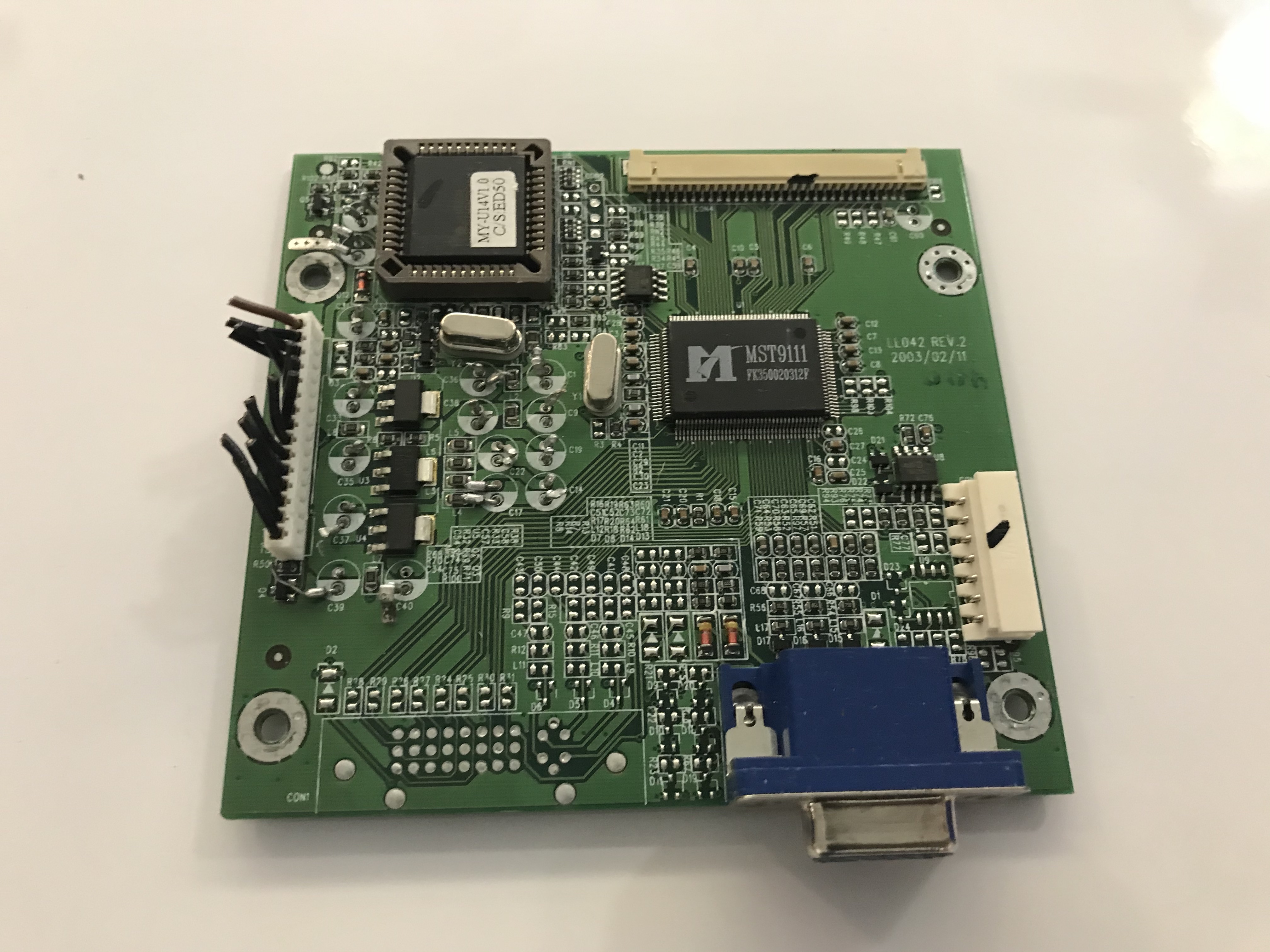

5) Low Grade Peripheral as I can see only one IC chip. If there are more on the back, it will probably go High Grade Peripheral. Don't forget to remove the battery cell.

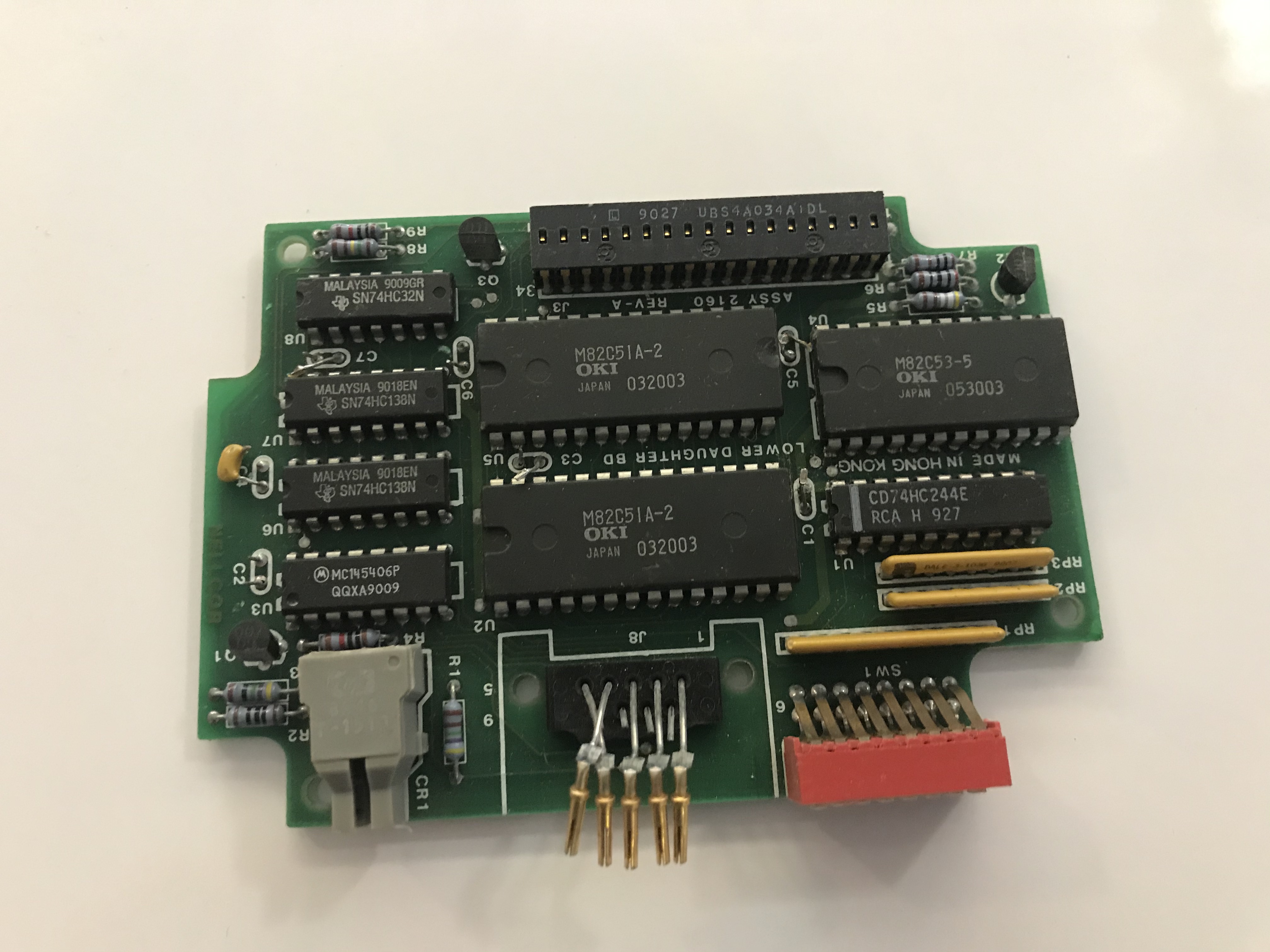

6) Low Grade Peripheral
7) Low Grade Peripheral
