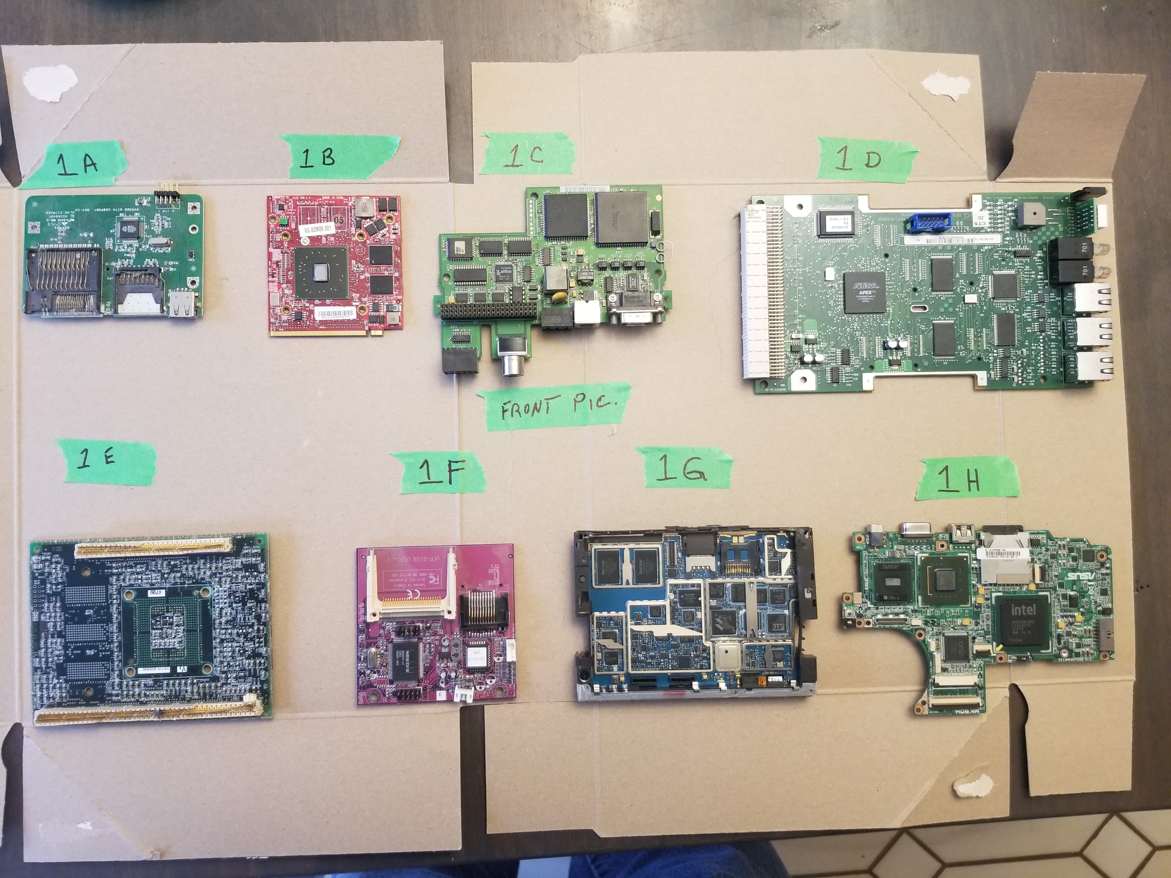

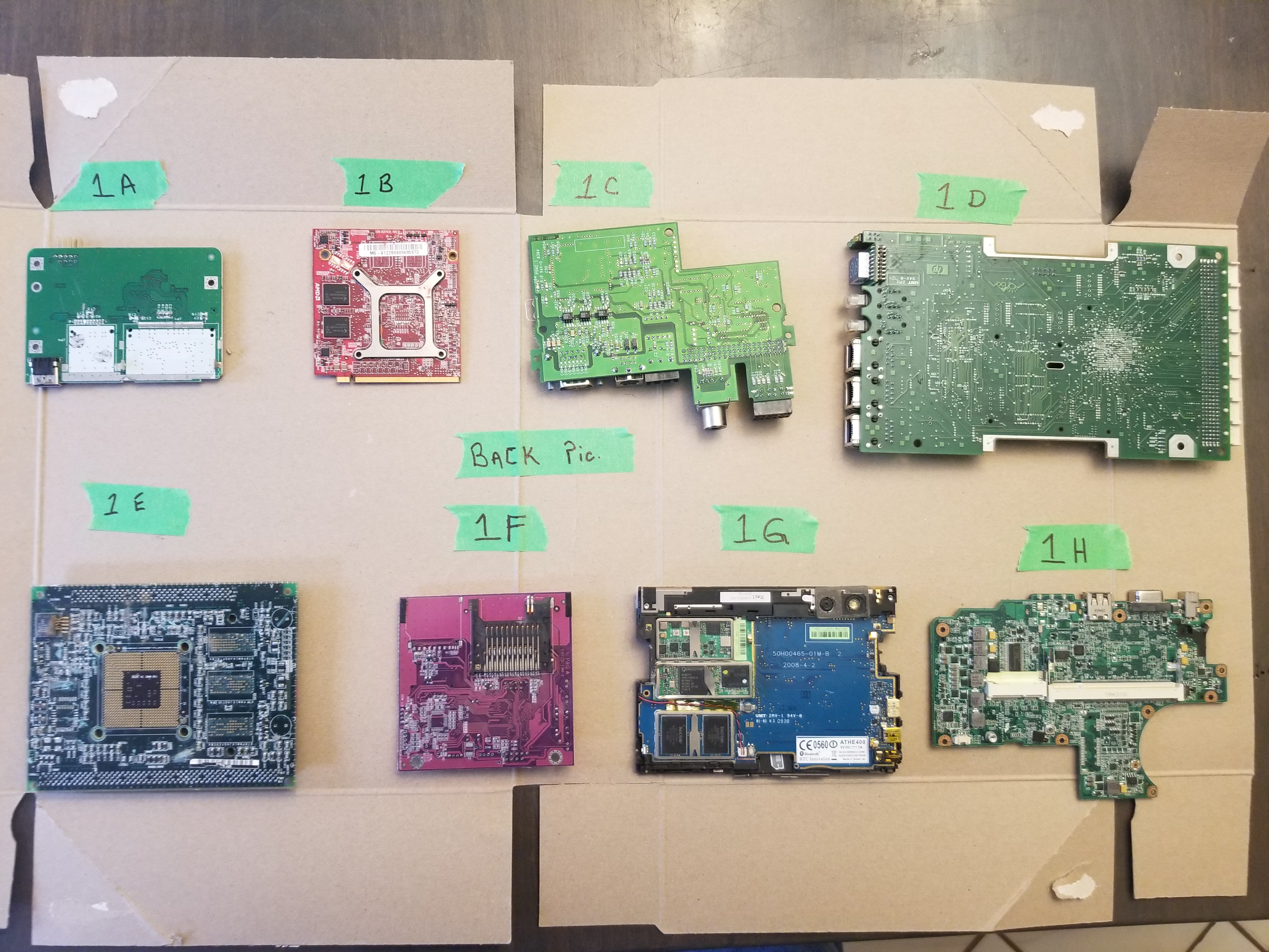

Any help would be appreciated and would I require to remove anything from any of these .
Thanks

1A low peripheral
1B high telecom, I'm not sure if the bracket needs to be removed or not
1C high telecom
1D high peripheral
1E not sure, backplane would be my best guess
1F high peripheral
1G please take the plastic and wire off. High telecom if cleaned
1H high telecom

1B) Laptop graphics cards like these are generally Clean GFC but can sometimes have enough population to go higher. Ccussins and I debated on one with more ICs before Chris said it could slide into high Telco so I'd bet on this one going clean GFC. Probably okay with the metal still on it but it's always recommended to remove any steel from a board if you can.
1E) Looks like it was a graphics card too. Please keep in mind if you're choosing to depopulate boards Boardsort has stated here that this will automatically bring a board grade down to midgrade.
