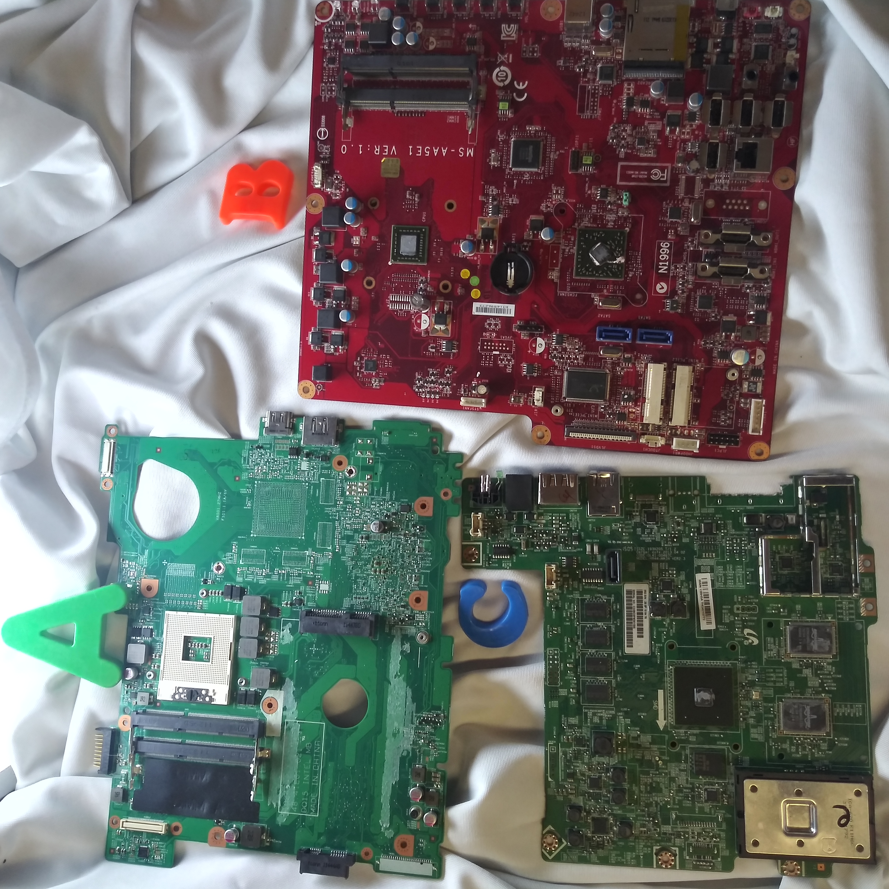

Finally getting around to sorting all my boards, need some help grading. Going to be posting a lot over the next few days. Hopefully once I have a sorted bin of each grade in front of me I can start to figure out more of them myself.
Would these all be laptop motherboards? If I remember correctly the red one came from an all-in-one system.

A and C I believe can go for Laptop Motherboard
B might be able to as well do to the population on the board.
But here is a quote from Lostinlidos regarding all in ones.
Most all in one boards fall into small socket. This works for almost all general use AIO computers. Dell, HP, etc.
The higher end boards like some modern iMacs and XPS boards and the like could fall into laptop. So always verify with a post.
On the other end AIO thin clients, such as kiosks and sales/POP/POS equipment will likely be high peripheral.

I'm leaning high peripheral on C.
If that metal piece on B is easily removed I would recommend removing to ensure it makes it as laptop grade.
