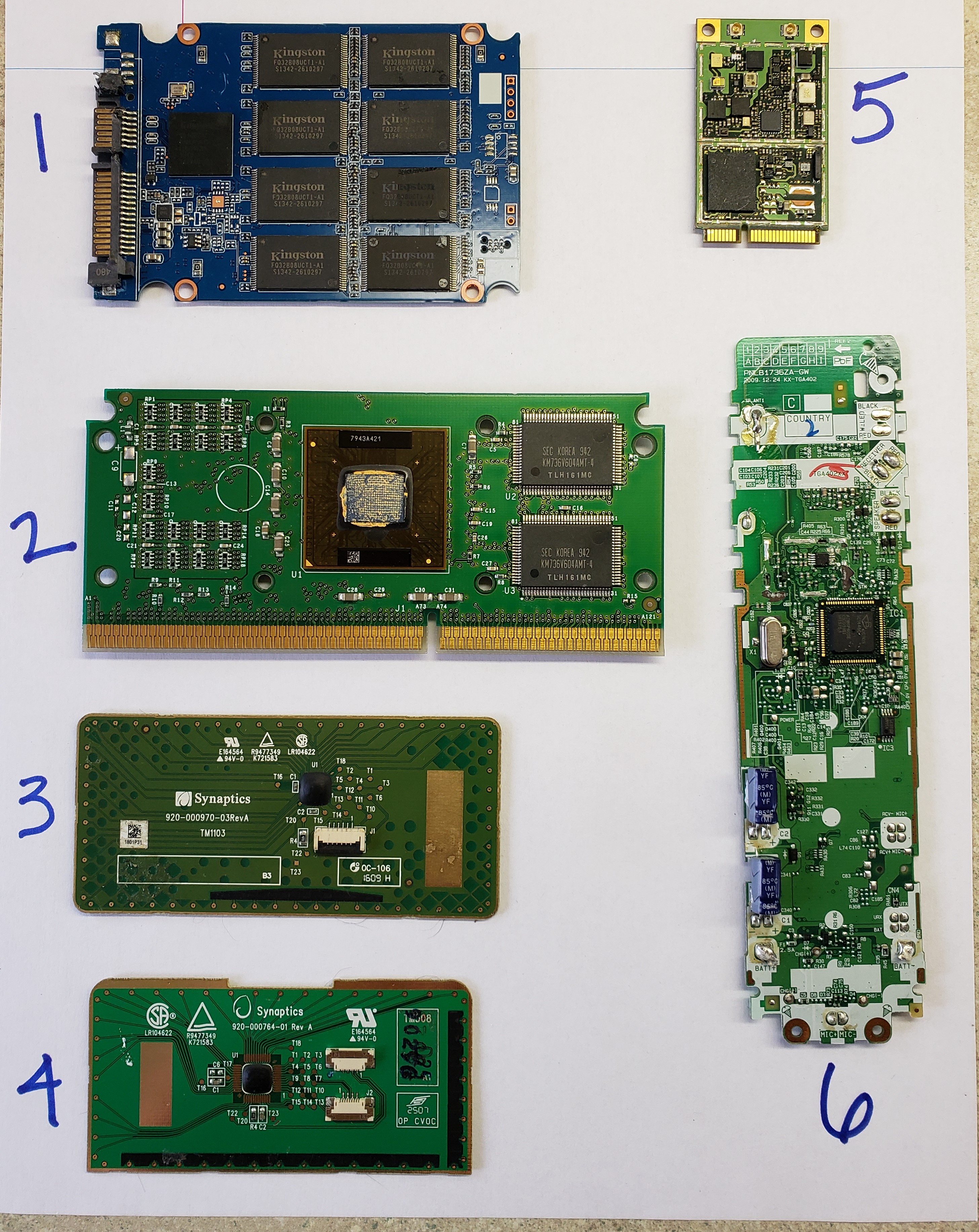

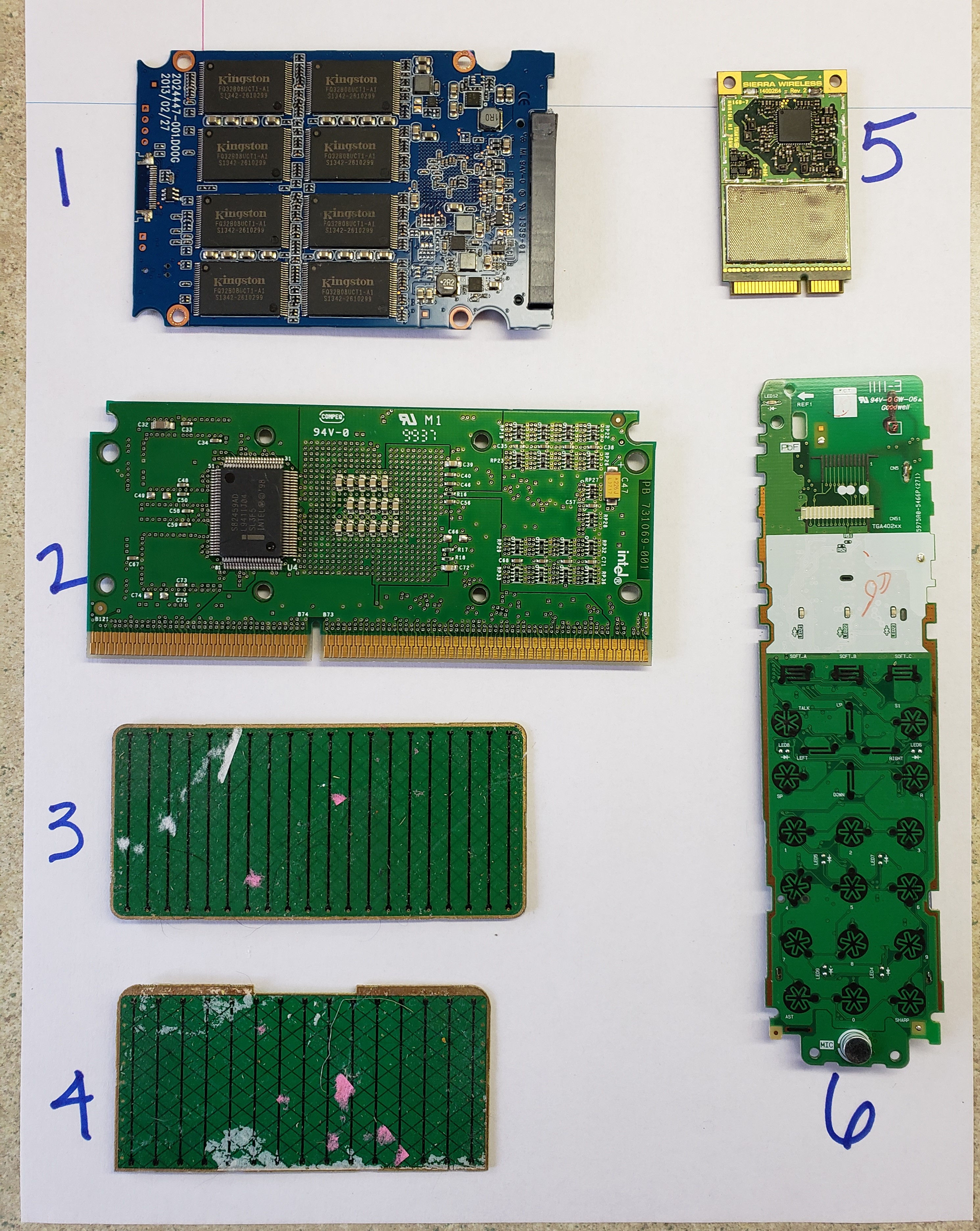

I need help in ID the following boards. Should I try and remove the mesh cover on the back of #5?
Photos of front and back.
Thanks in advance!

1) Hard Drive board
2) slot processor
3,4) trackpads are almost always high peripheral
5) that looks like some sort of tape that should peel off. If the metal under it completely covers the board it should be removed, if there's openings in the metal you can probably leave it on (take another pic after the tape is off if your not sure) clean gold finger card if the metal is all off.
6) Not 100% sure low peripheral at least.

Thank you for the help marked!!
