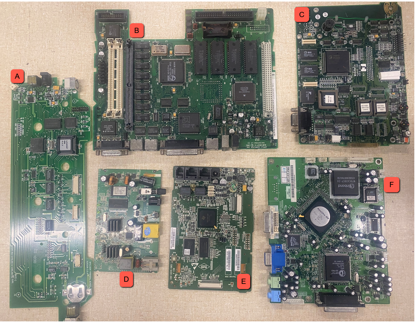

Thanks in advance!
PostPosted: Mon Nov 22, 2021 11:02 pm
Posts: 2705
A) Get the battery. High peripheral at least (possibly higher)
B) That's a motherboard from a Mac... says 1991? I think you're safe with large socket mobo based on the How to Grade Motherboards
C) High telco
D) Not sure if the aluminum heatsinks will make much of a difference here but I always try to get those off on a board like this. Try pliers or a flathead screwdriver between the fins and twist. If it looks/feels/sounds like the chip is coming off then stop. You can either apply heat and try again or just leave them on. I think this will make high peripheral either way but definitely will without the aluminum
E&F) High peripheral
