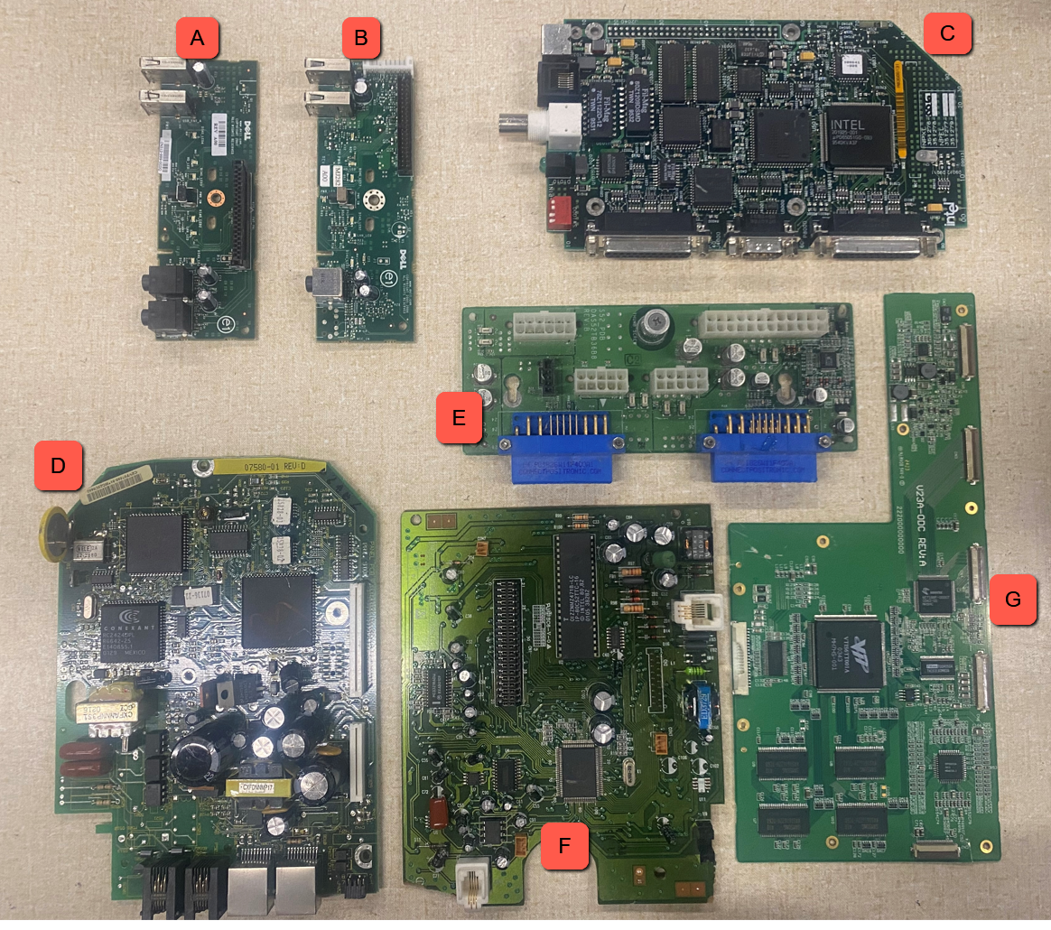

Thanks in advance!

A&B) Tend to go low peripheral. Sometimes if there's a little more on the board they can get bumped but I think these are low peripheral
C) Fairly certain this will make high telco
D) Definitely get the battery off. If you get the two transformers off it'll be good in high peripheral at least.
E) I'm torn on this one, one IC, looks like some gold pins but has that screw... low peripheral?
F) High peripheral
G) Normally these go high peripheral, there might be room for this to get bumped to low telco given the number of ICs

Thanks, appreciate it!
