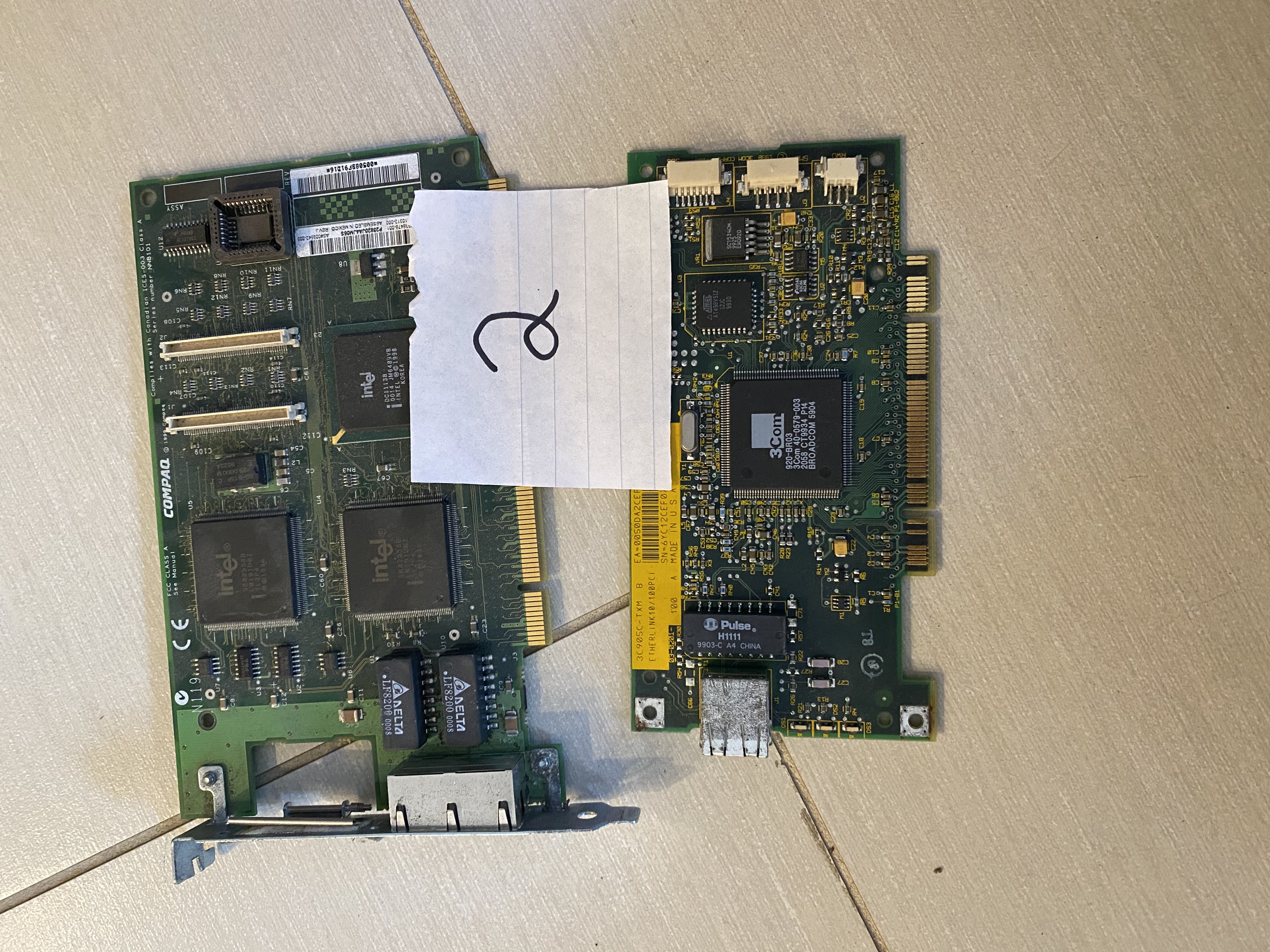

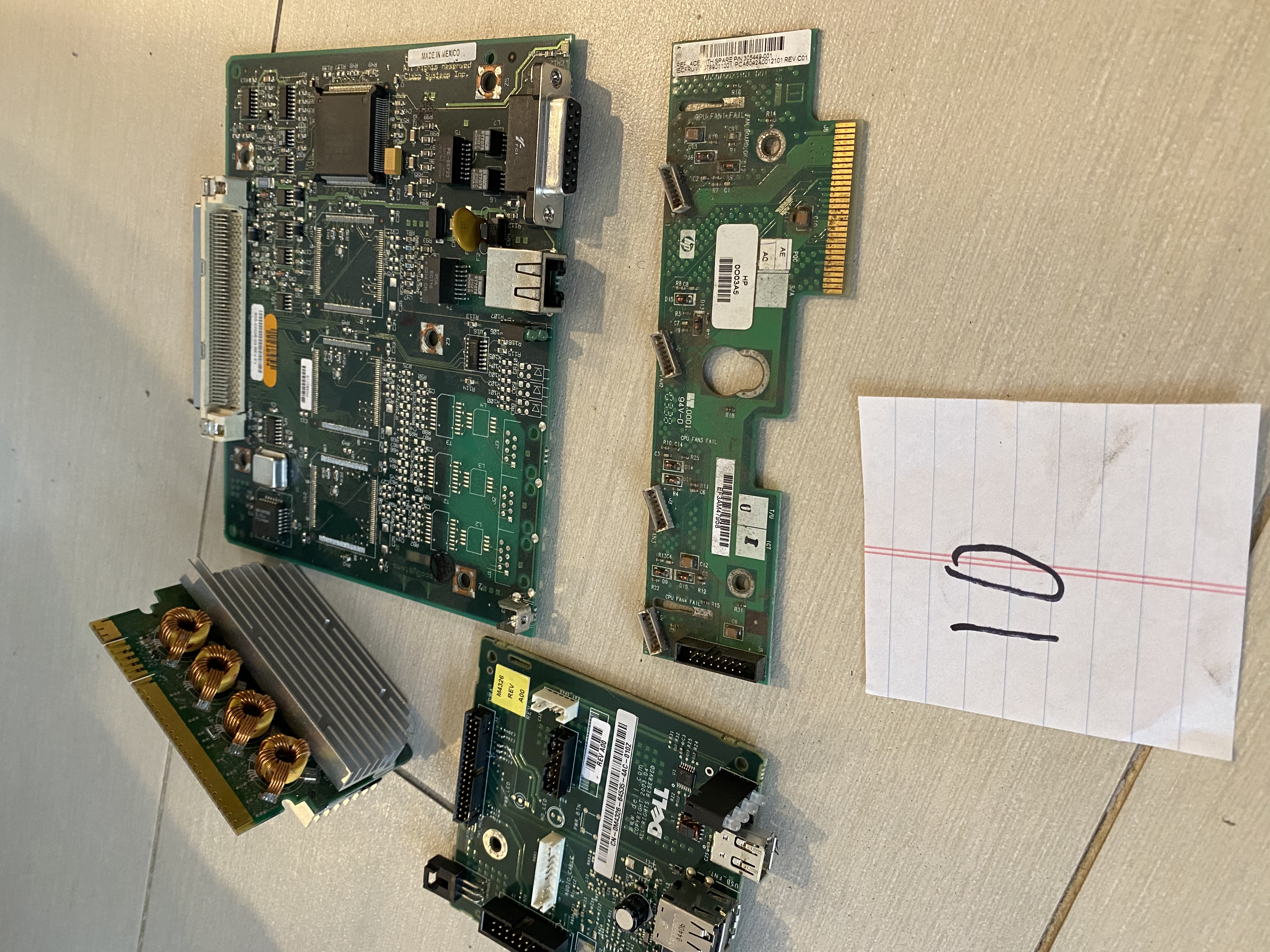

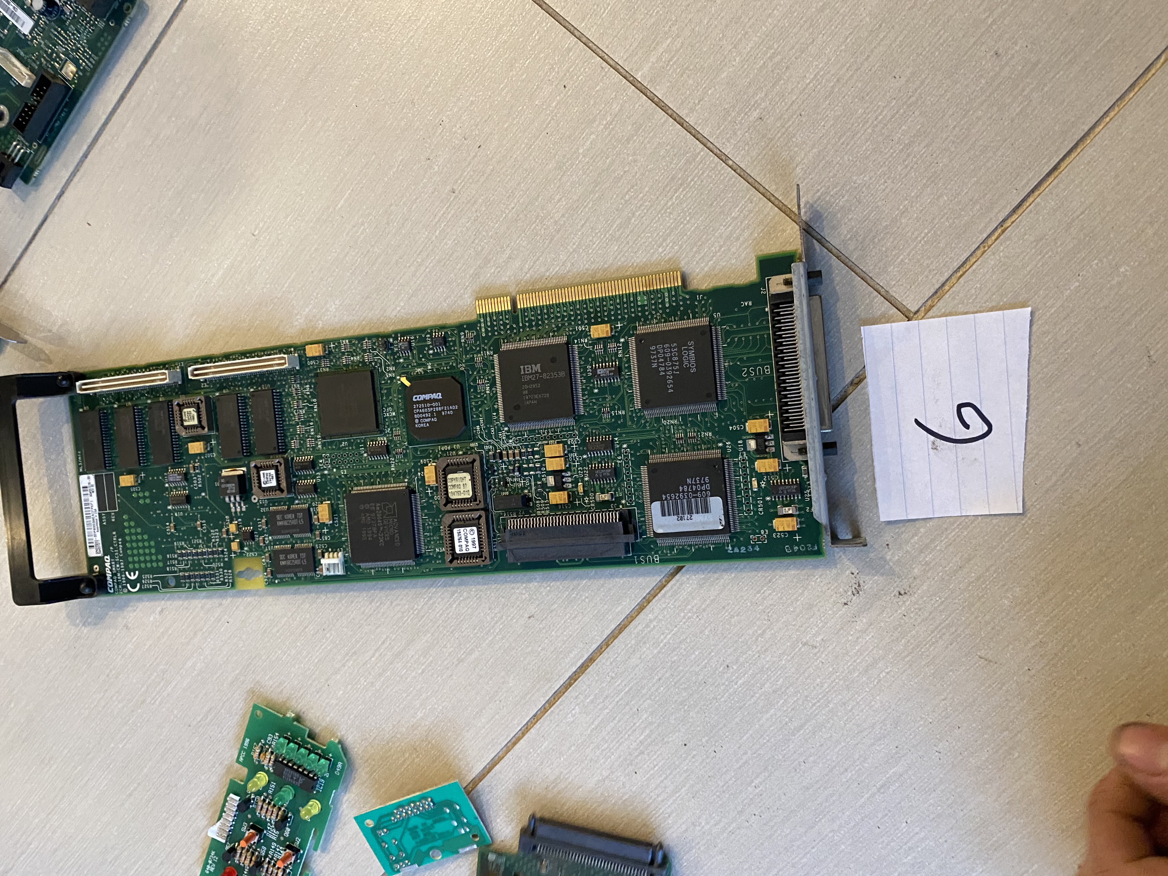

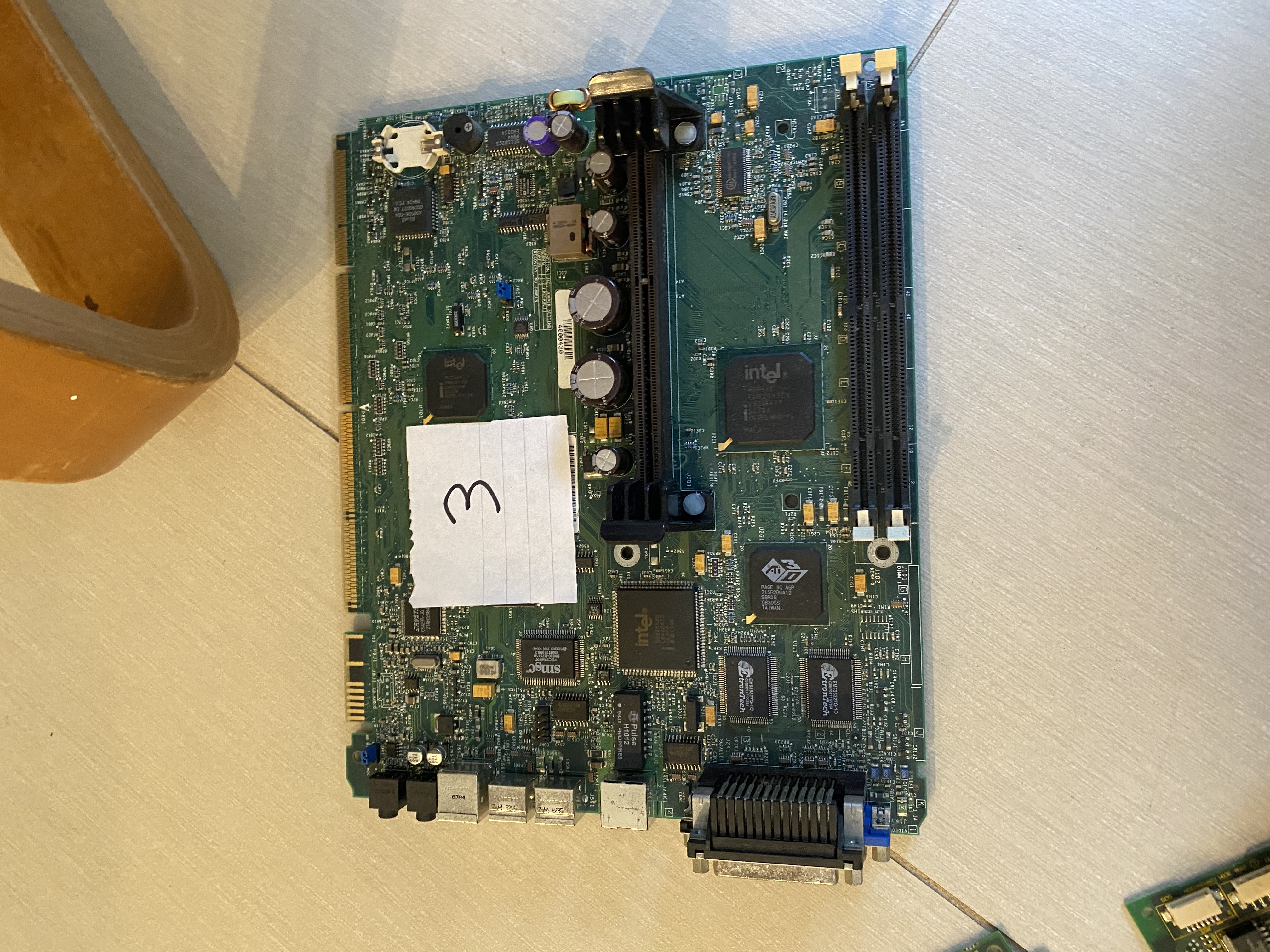

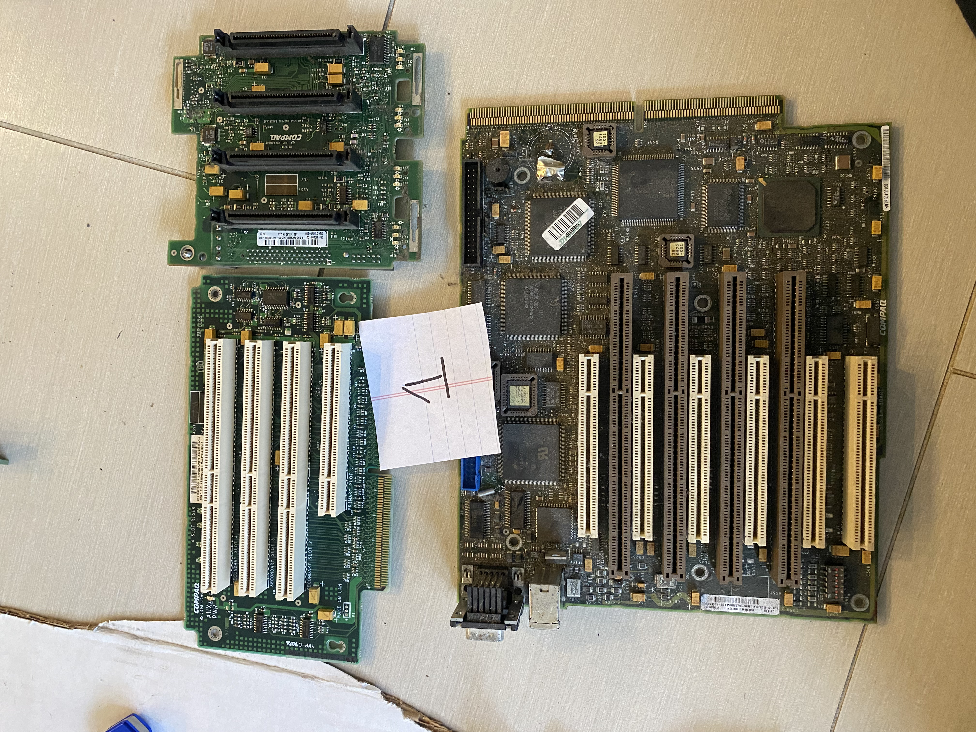

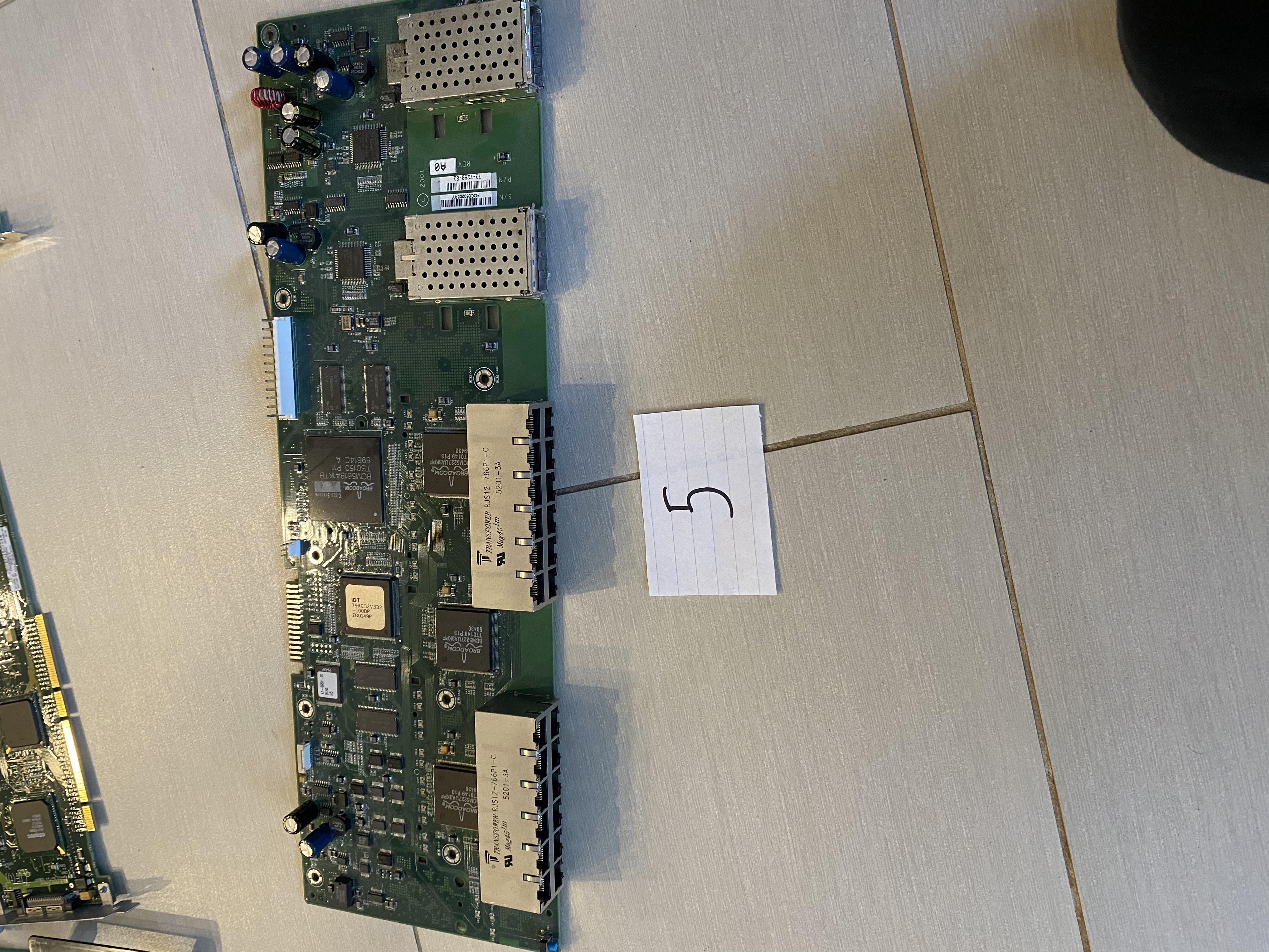

Hello I am new to Escrap and haven’t yet learned what everything is, I was wondering if someone could help me identify these pieces and if there worth scrapping

1. All backplane

4. High peripheral
5. Low telecom, remove the metal shields.
6. Gold finger card with bracket as is, remove the bracket and handle for high telecom

10. From top to bottom: oversized gold finger card (remove the heatsink for clean gold finger card rate), high peripheral, low peripheral, backplane

10) The board with aluminum on both sides and gold fingers is a voltage regulator, it will go high peripheral.
8) All the GFCs with brackets can be upgraded if you remove the bracket; second from the top may slide into high telco (especially if there's chips on the back). The green and brown board; if their attached by the wire, remove the wire. the green board is a CDRom board.

1) The compaq board might qualify for large socket mobo.
