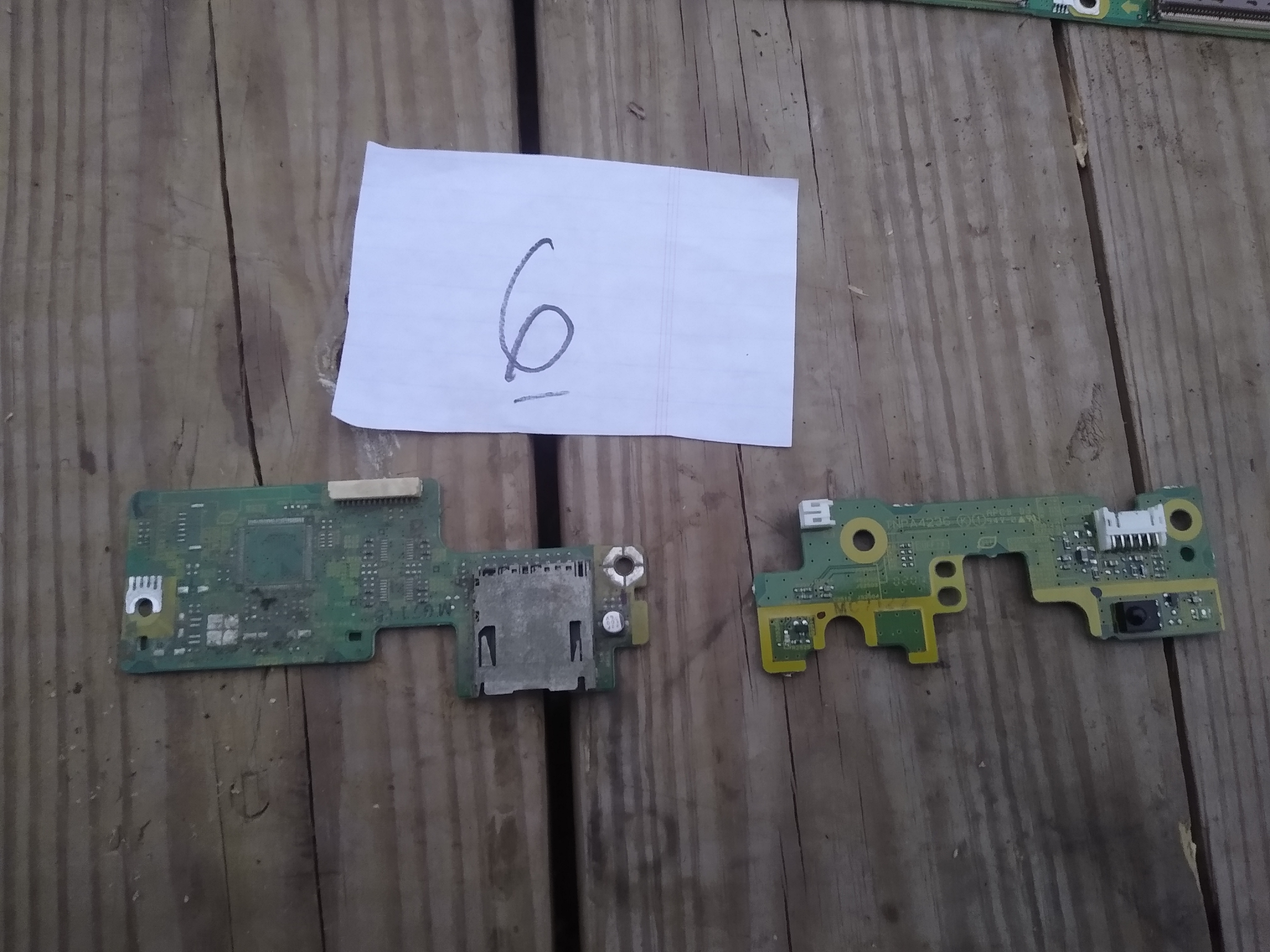

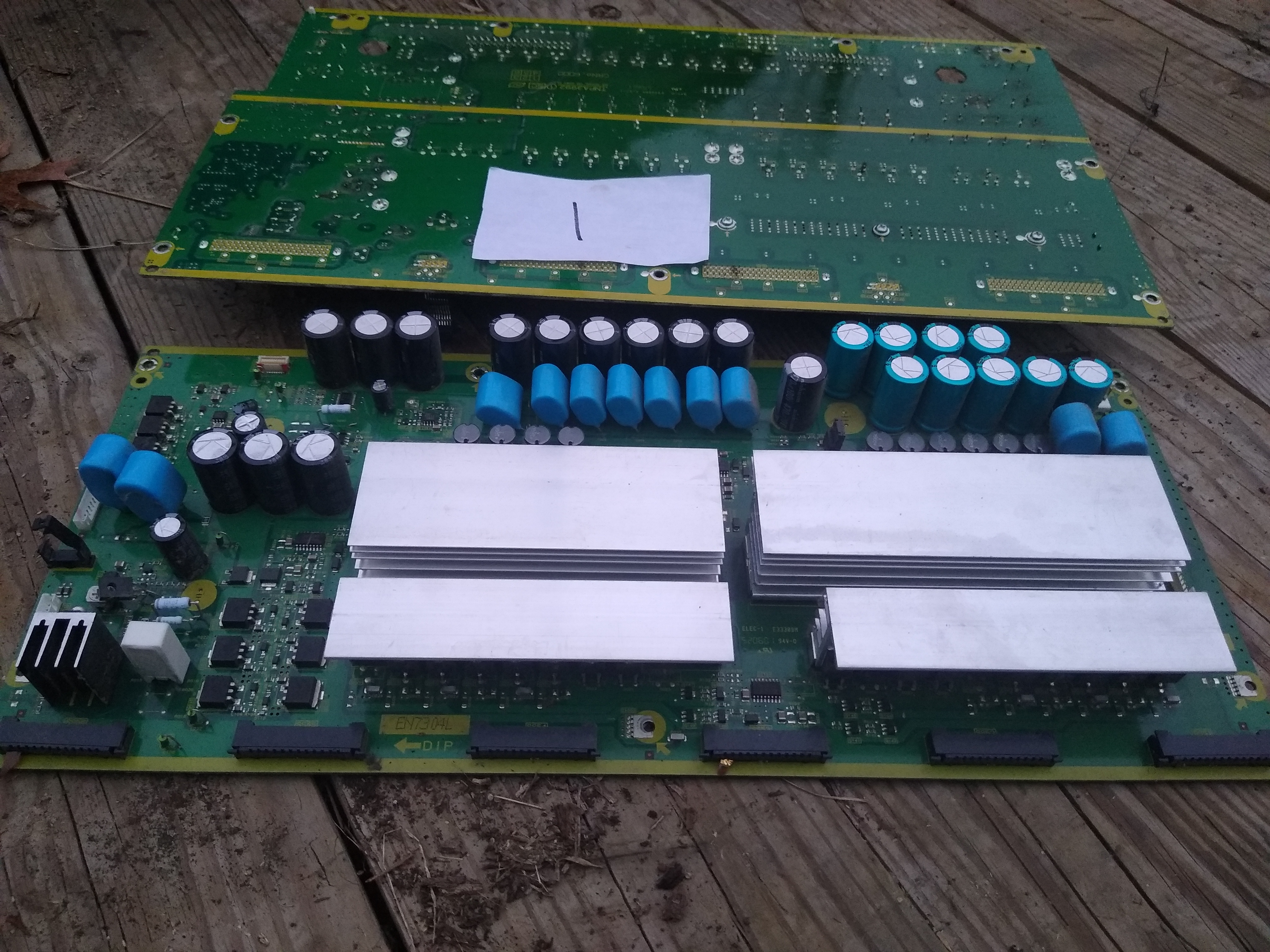

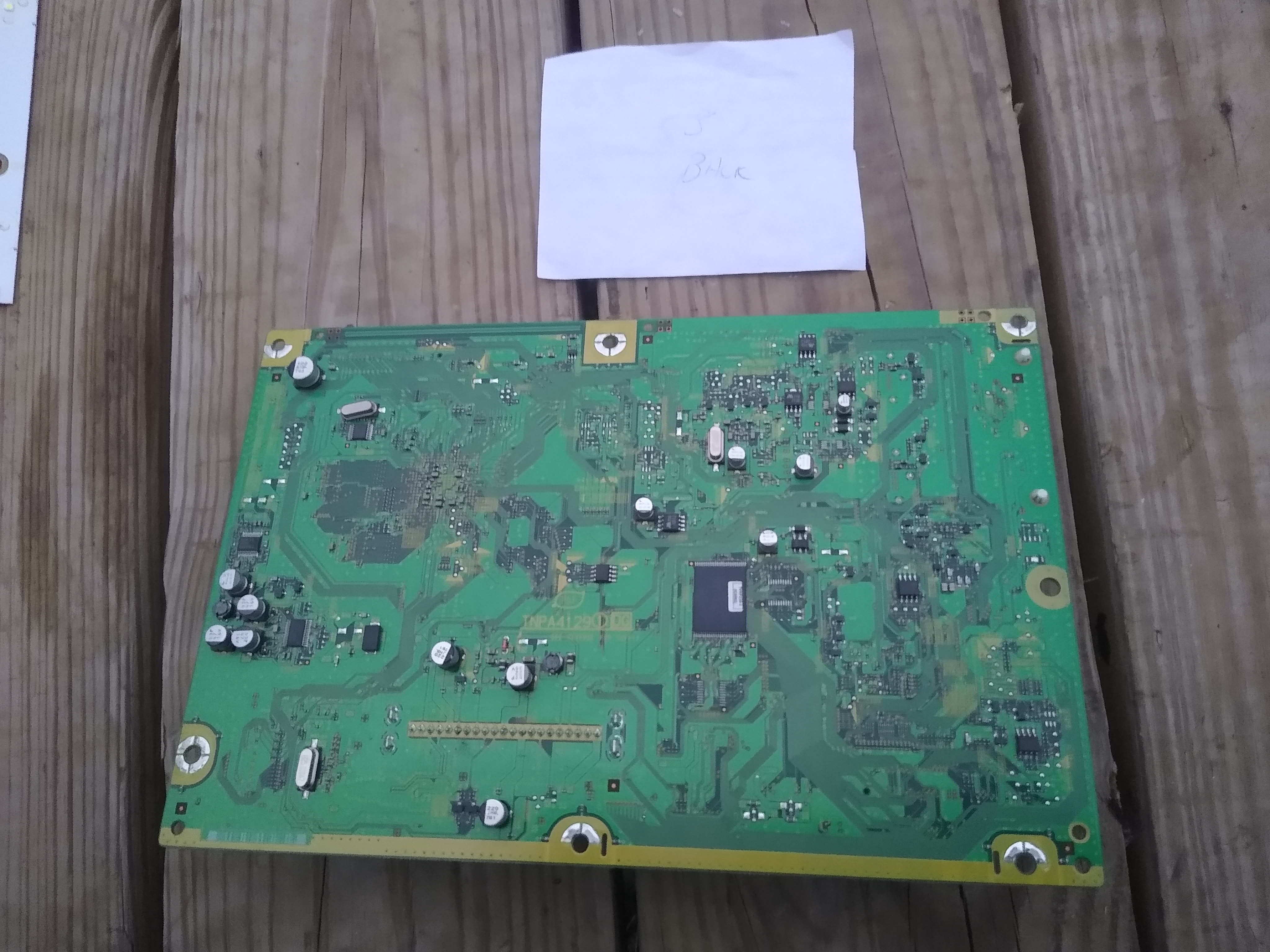

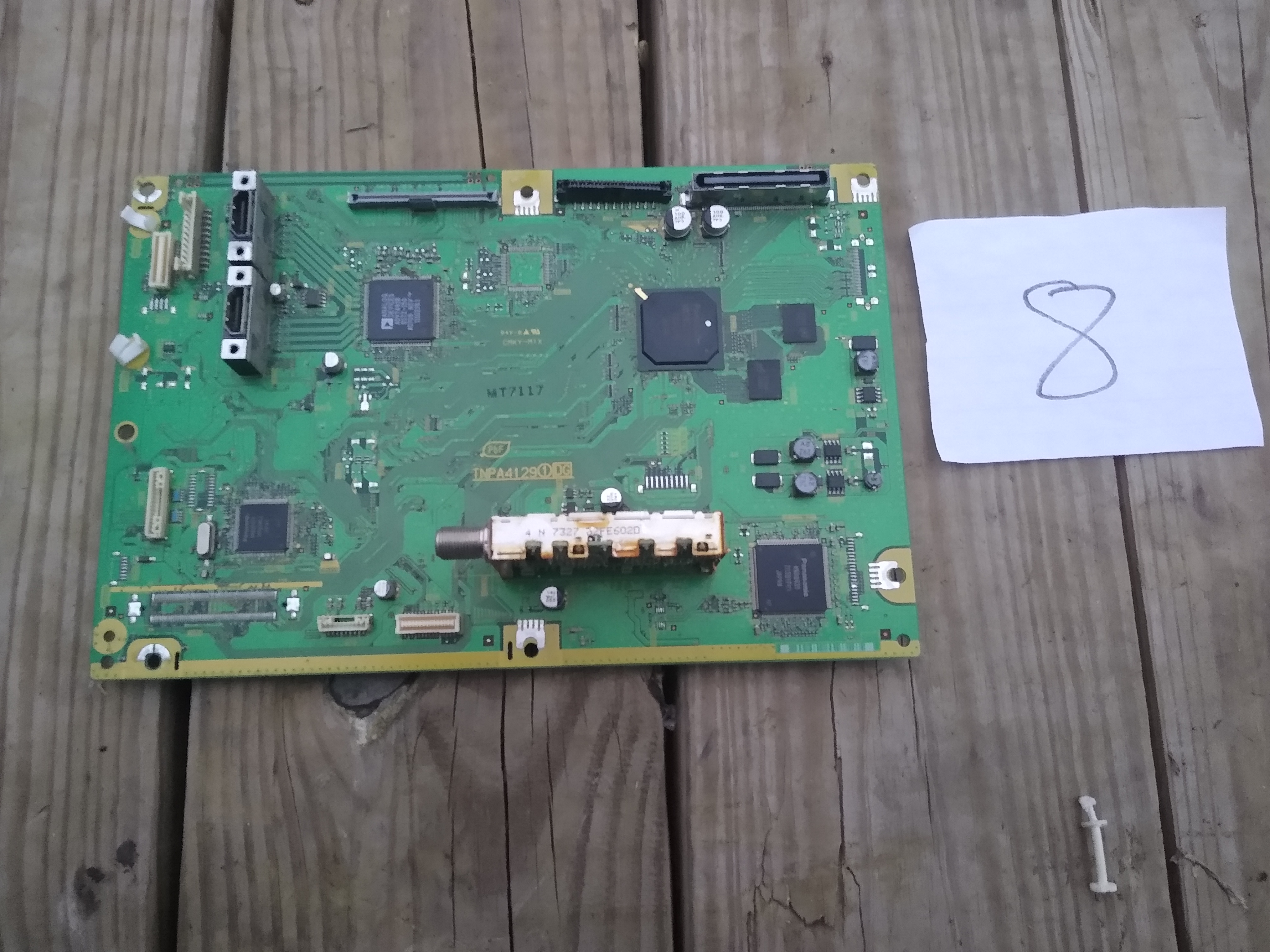

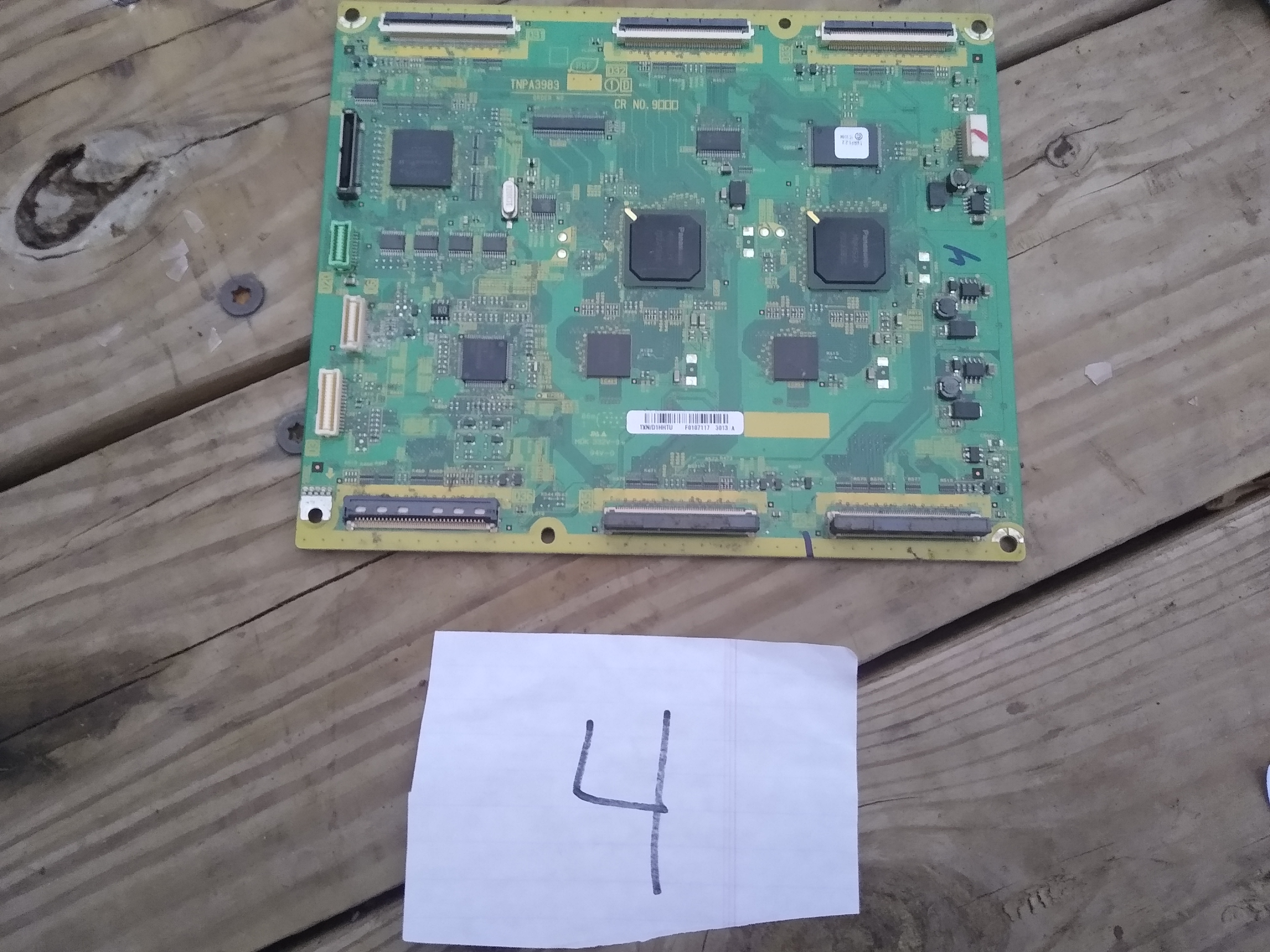

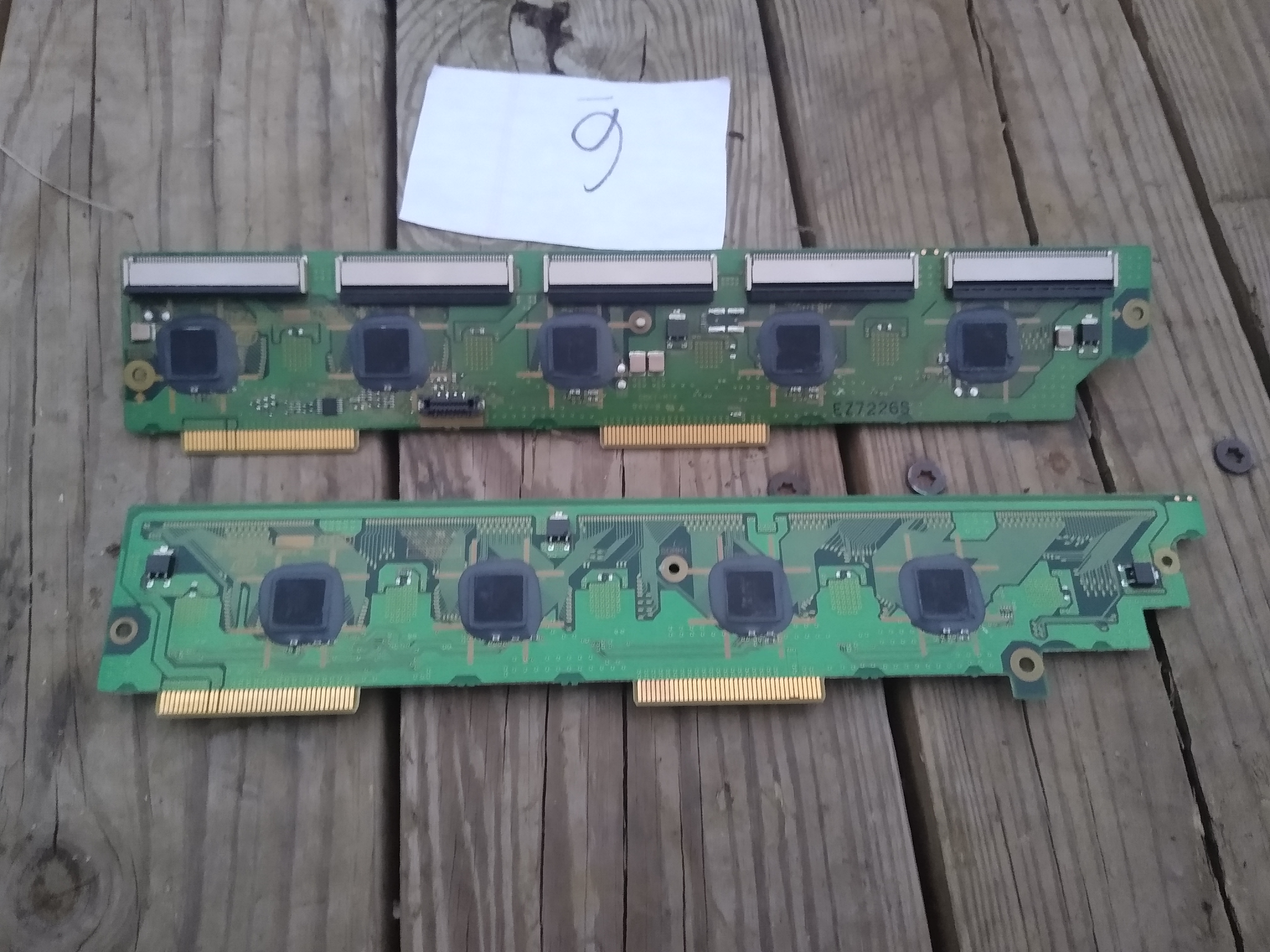

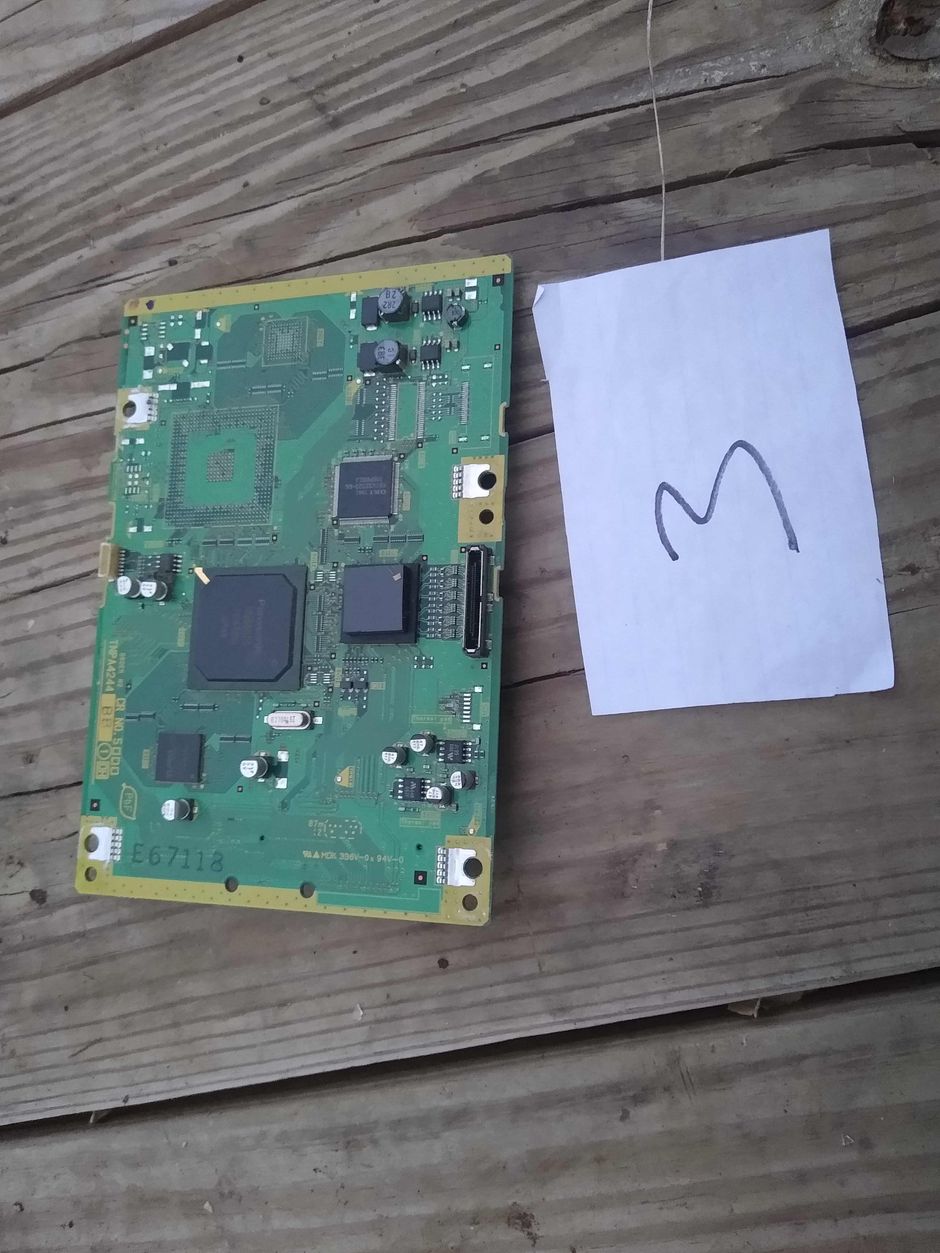

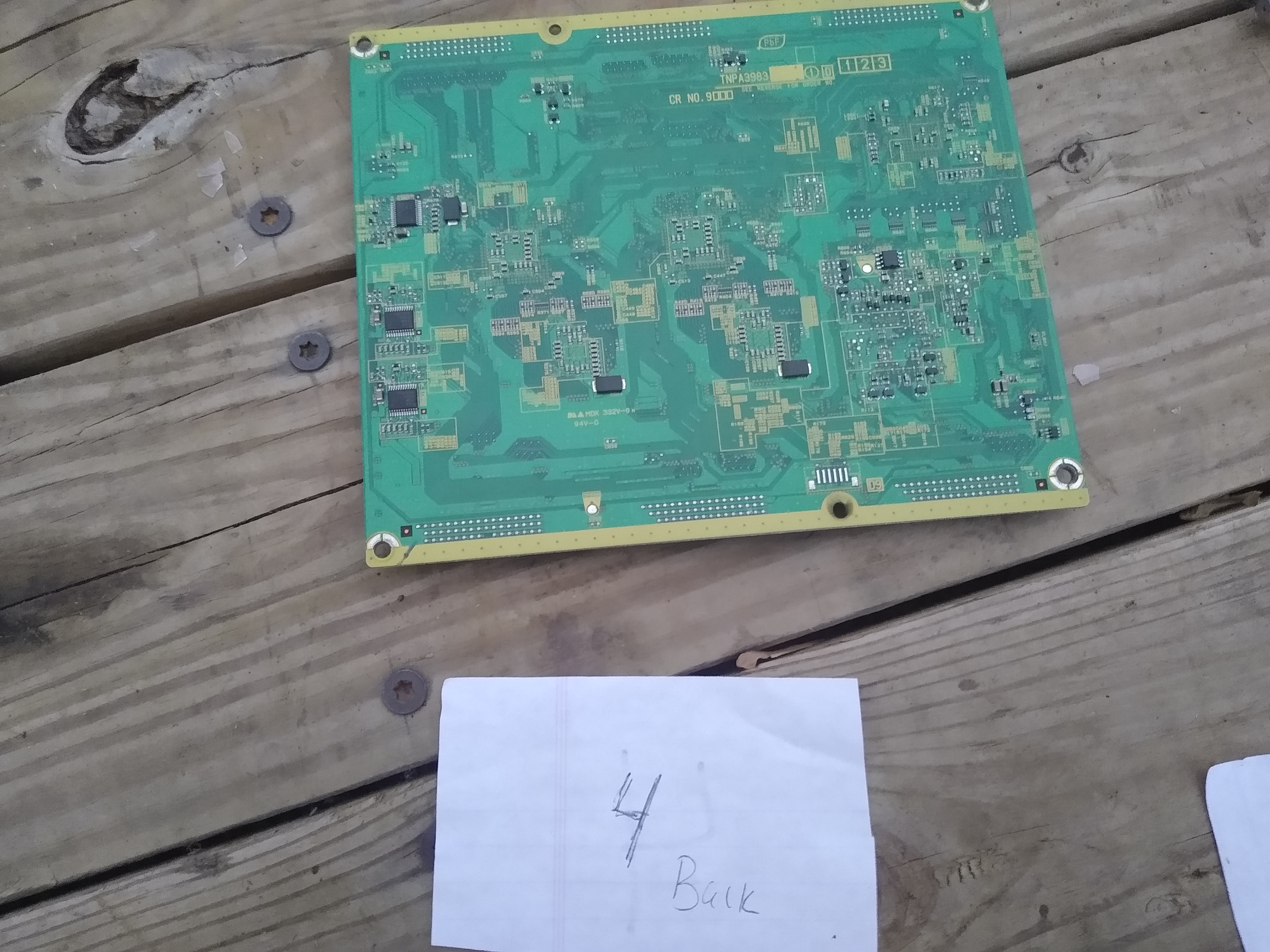

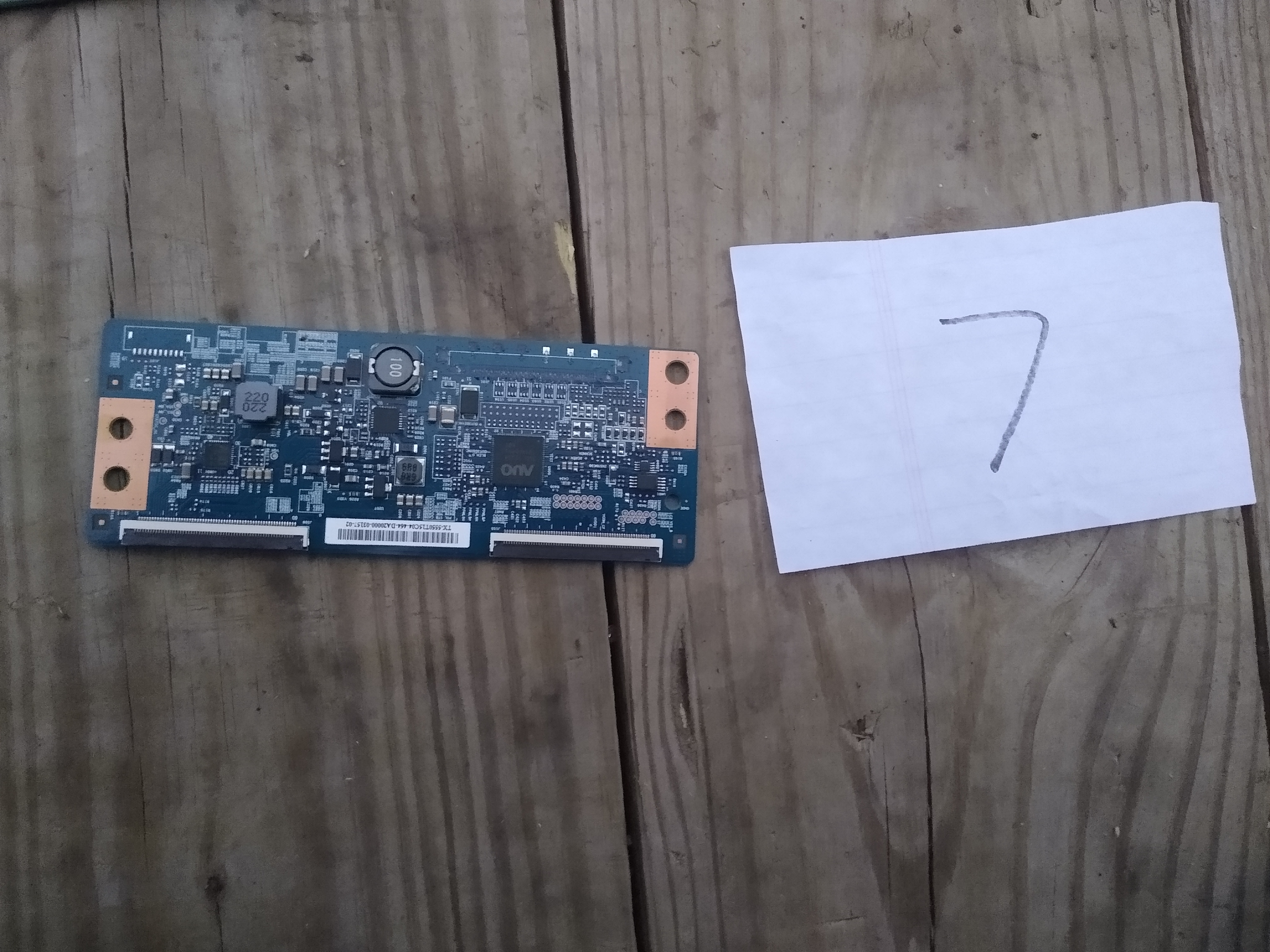

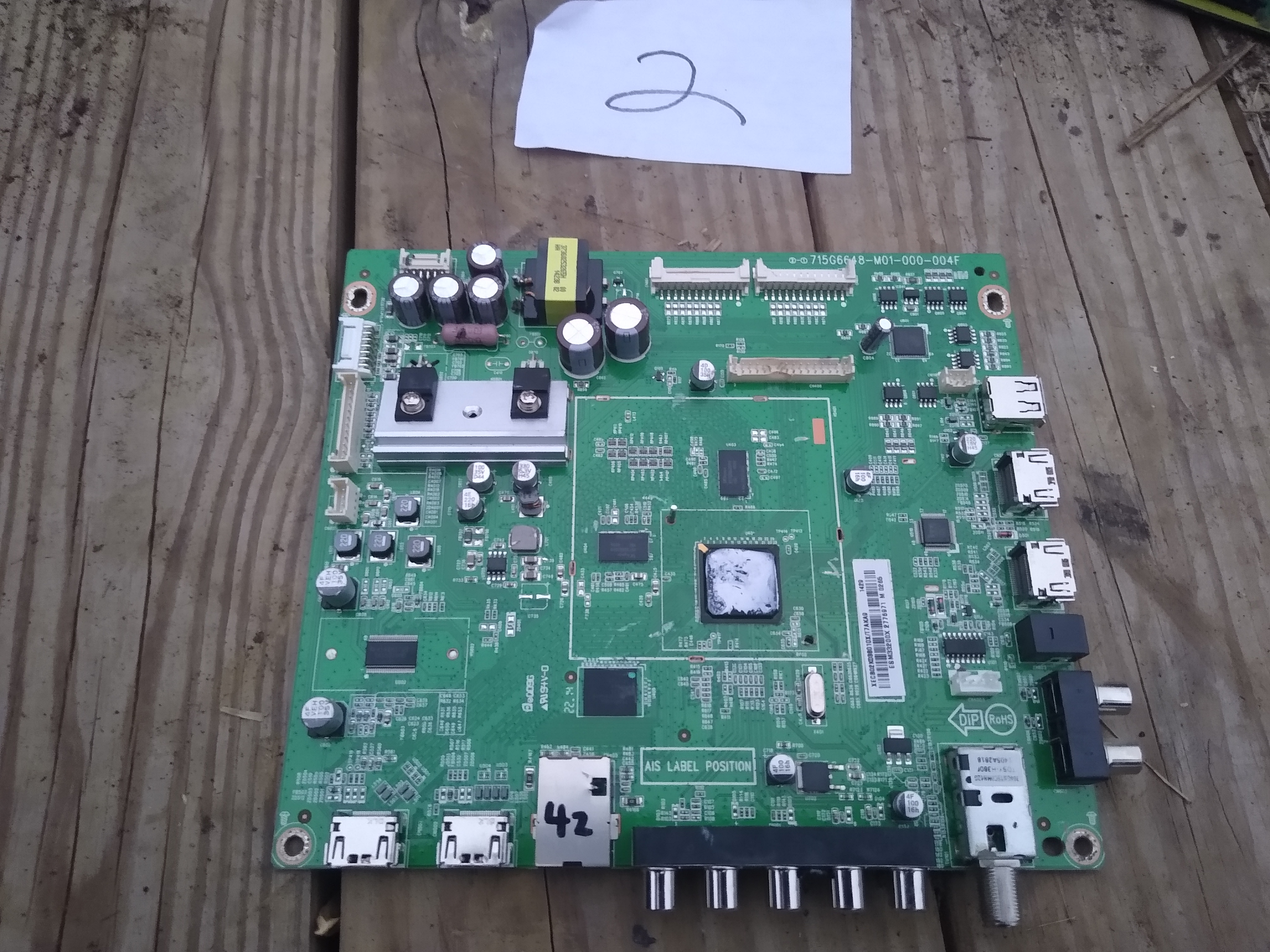

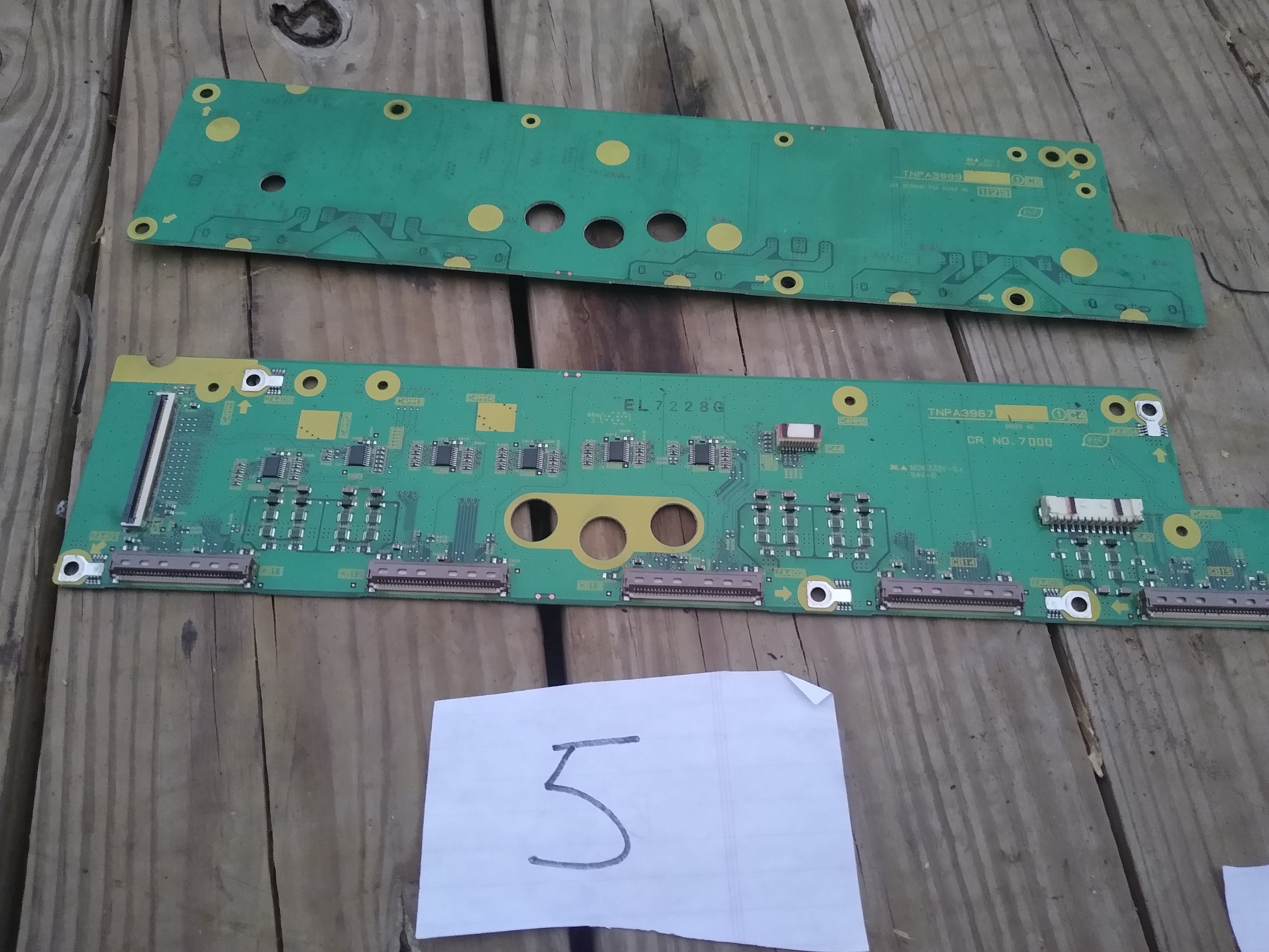

Here are some boards that I got out of a couple TVs. Some I am comfortable with grading, and others not so much. In the future I will not add so many boards to one post, but wanted to keep this topic consolidated. Thanks.

2) High Peripheral
3) High Peripheral
4) High Peripheral
5) Low Peripheral?
6) Low Peripheral?
7) High Peripheral
8) High Peripheral (small ICs on one side of the metal box)
9) Clean GFC (Could it go higher due to ICs on both sides?)

1) Agree; it would probably stay midgrade even if the aluminum was removed so if you have a place that pays well for aluminum then you can decide if that's worth your time.
2/3) Agree
4) Maybe bordering on low telco.
5) Agree
6) Midgrade
7) Agree
8) Agree (those boxes typically have a few ICs inside)
9) I want to agree but not sure if those can go with the GFCs
