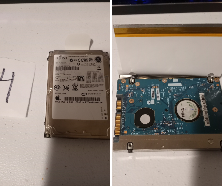

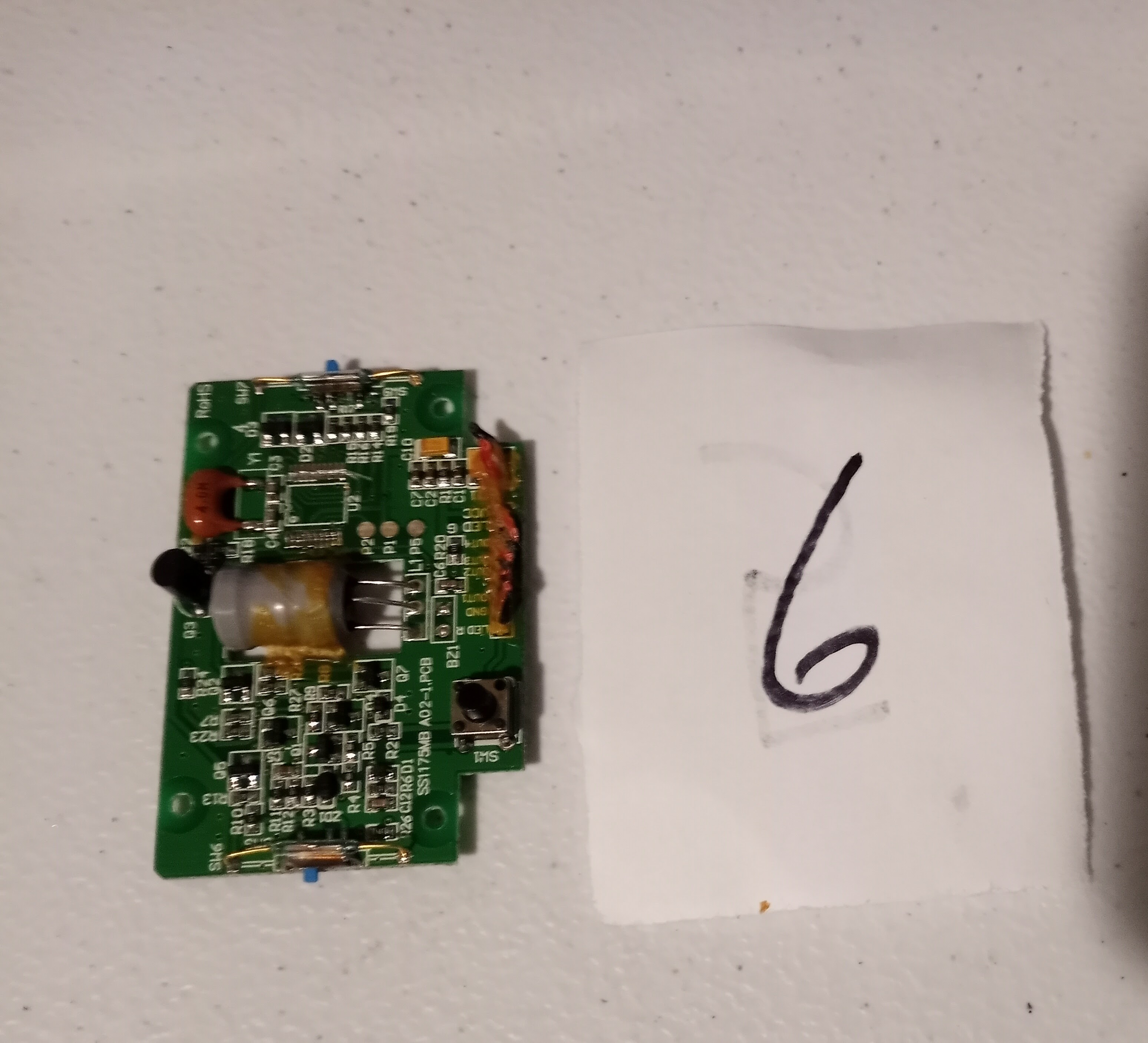

#4 I am pretty sure is a hard-drive, but I don't know what group it goes in. Also, do I remove the metal flashing attached to it?
Thanks as always!

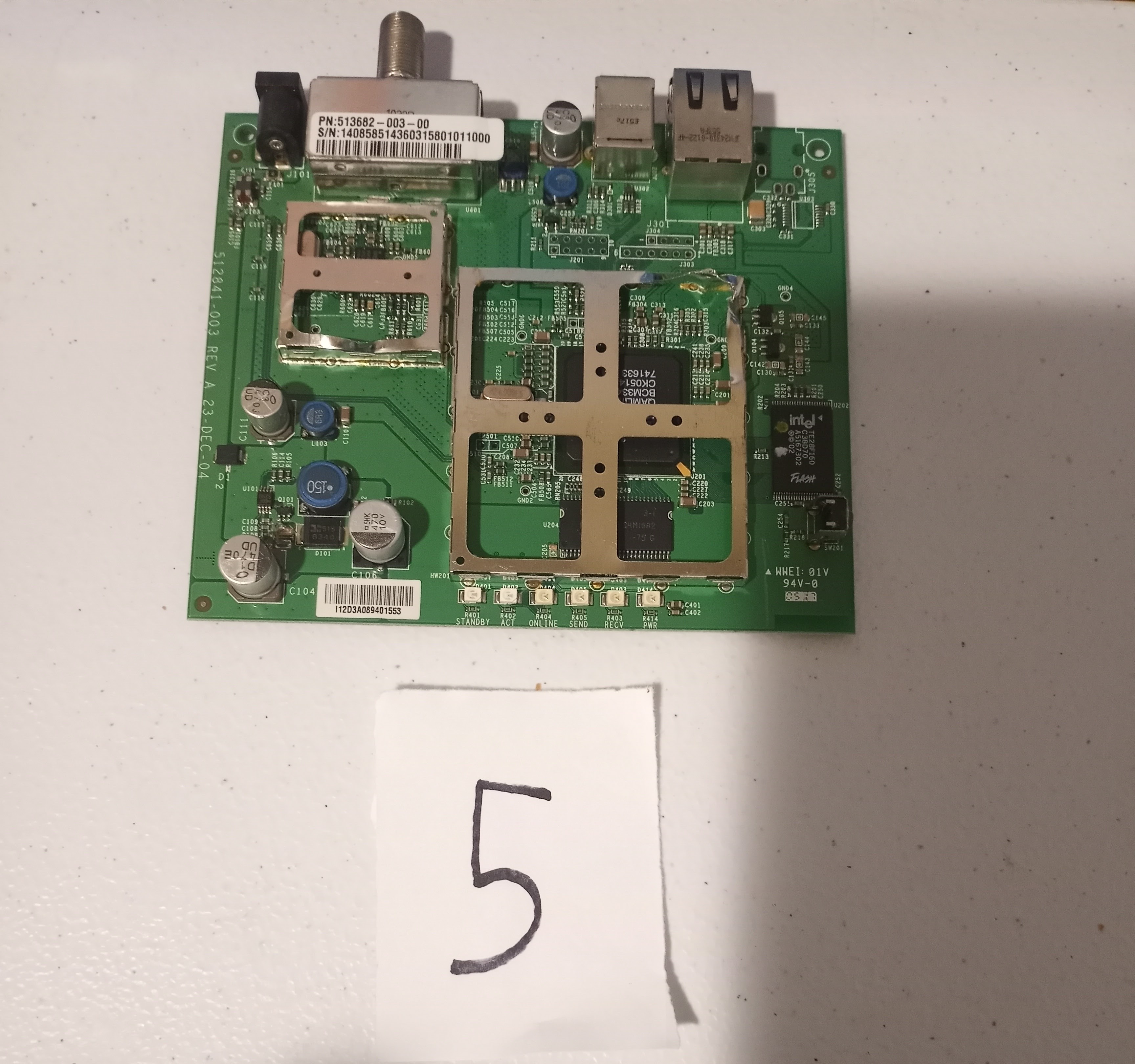

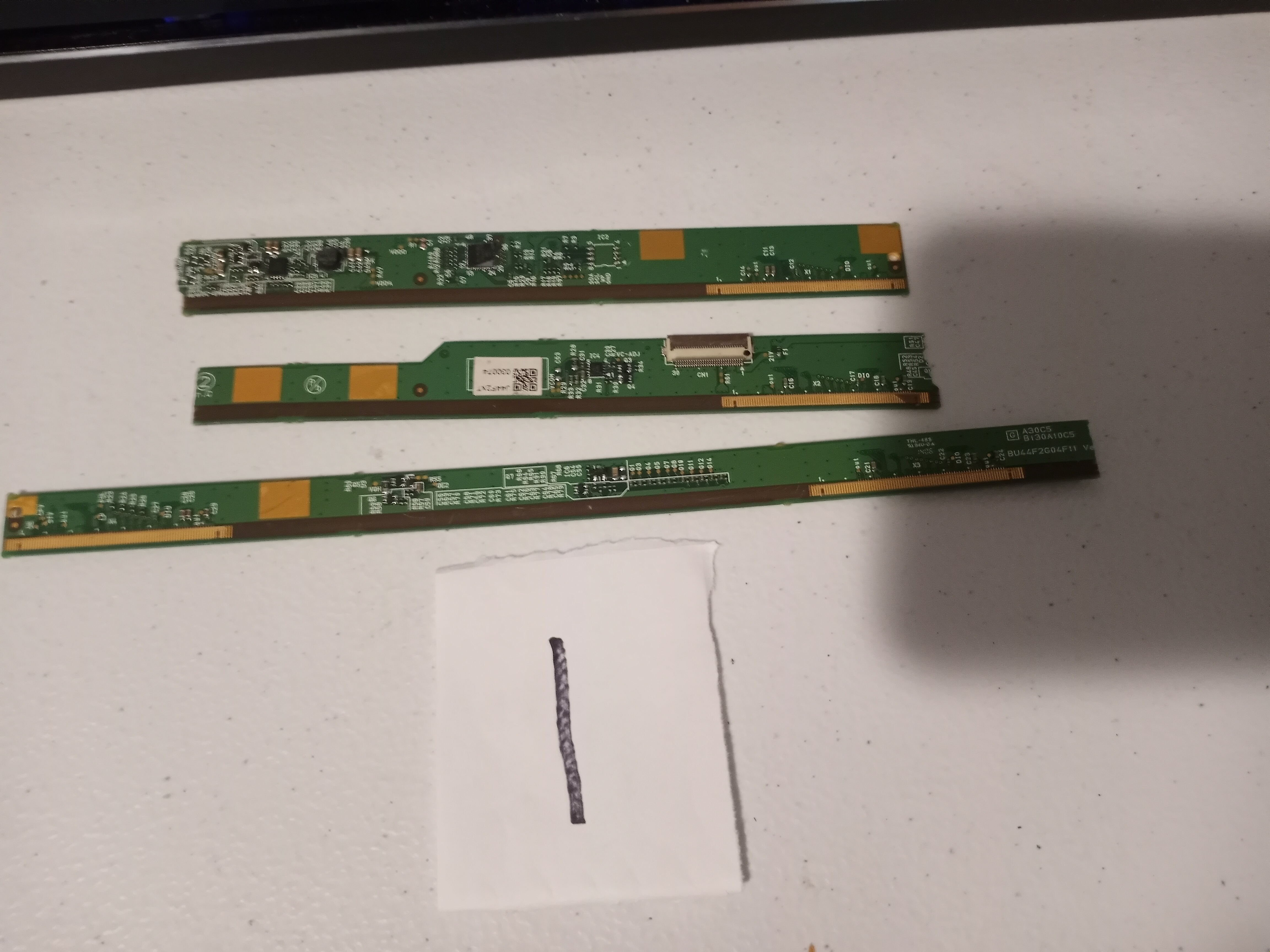

1. Not sure, high peripheral is my best guess

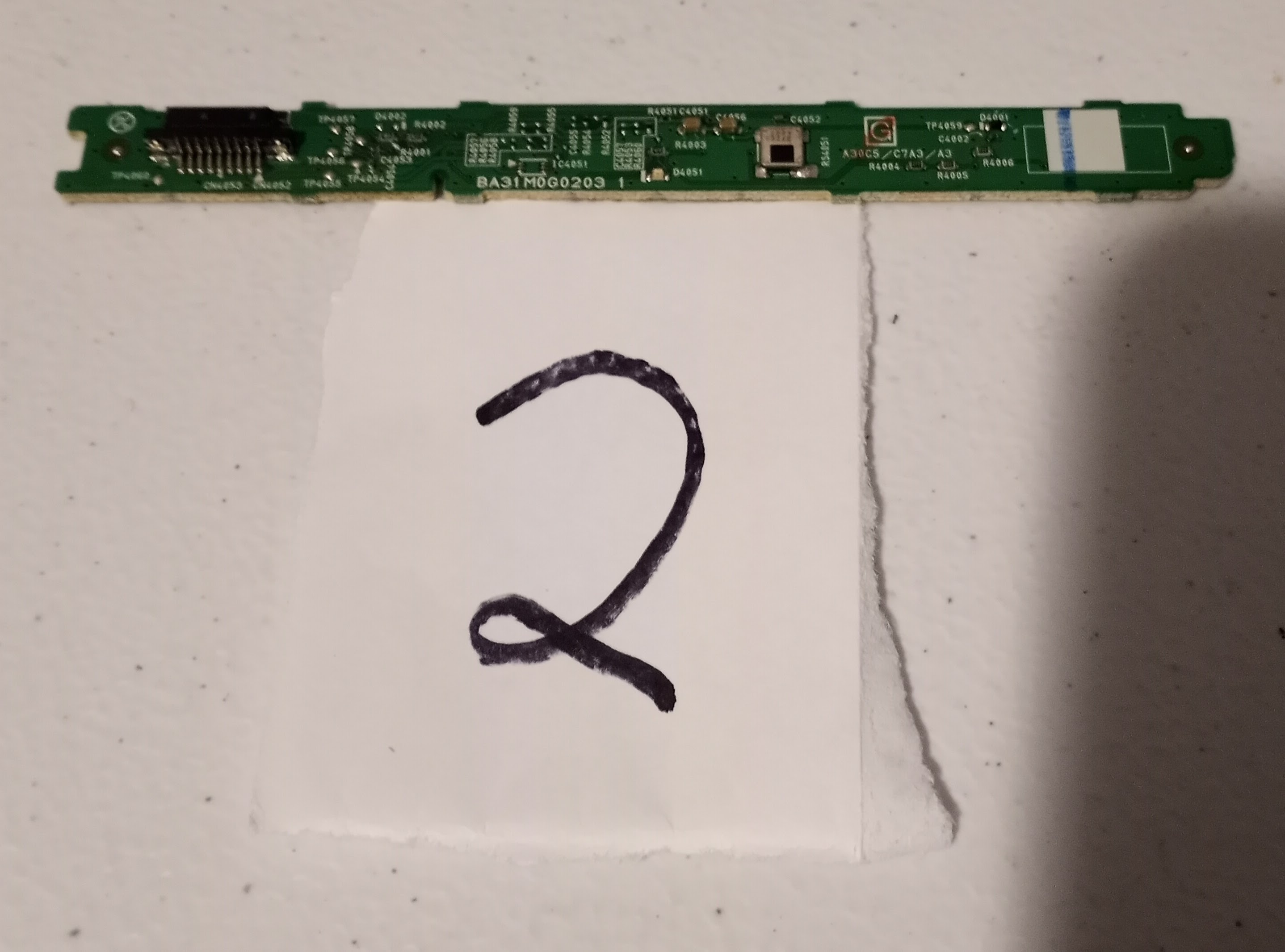

2. Midgrade

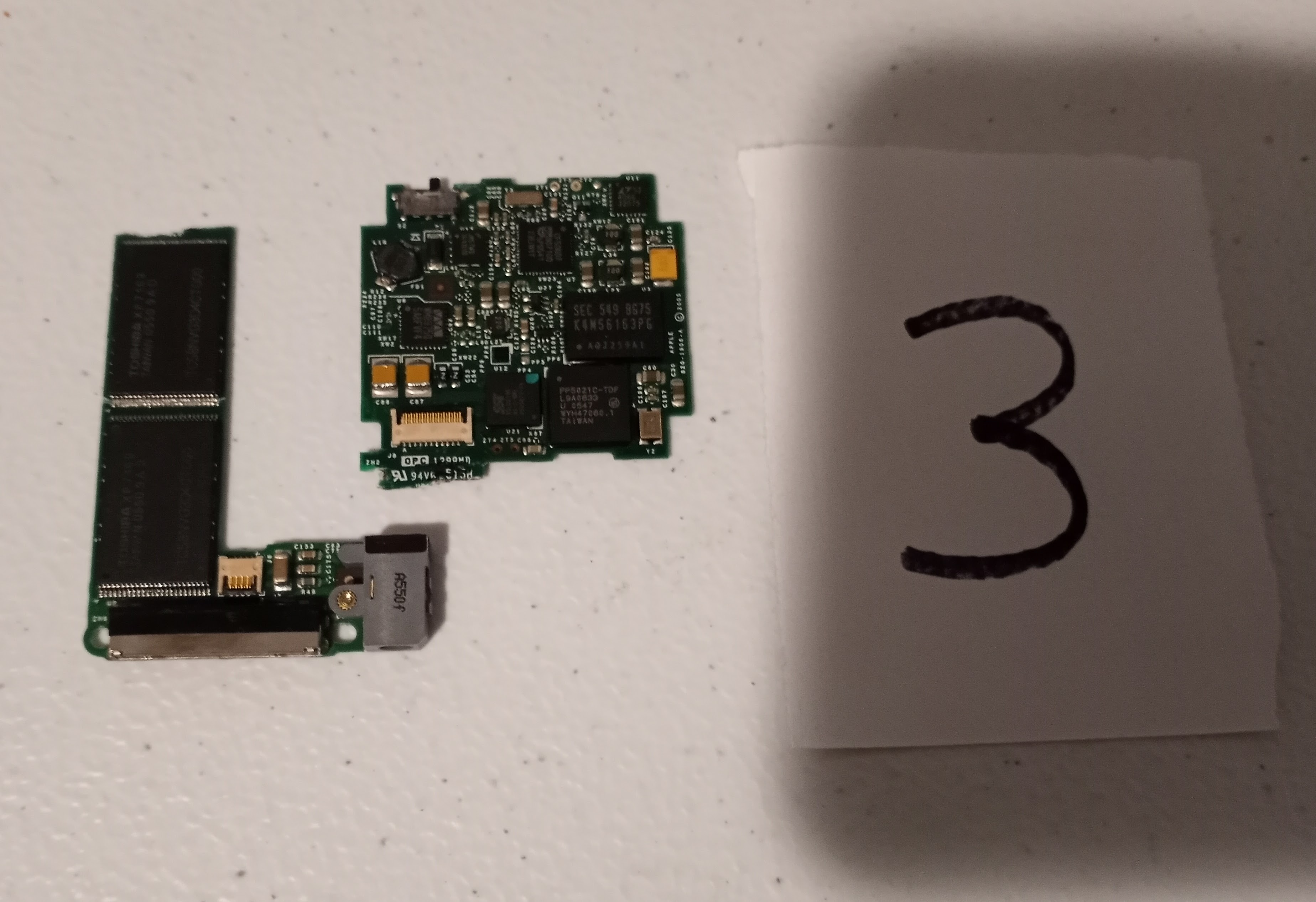

3. High telecom for both boards
4. Hard drive with board

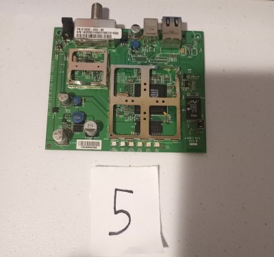

5. Low peripheral, remove the coaxial connector and the metal shield for high peripheral
6. Midgrade
PostPosted: Mon Jan 10, 2022 10:52 pm
Posts: 2633
Try not to break boards whenever possible; if necessary for shipping keep boards together (tape).
1) At best top High peripheral; Middle low peripheral; bottom midgrade; together probably okay as high peripheral.
3) From a cellphone? If so, keep together for cellphone rate; otherwise high telco.
5) Removing the fencing isn't always necessary but in this case I think you should to get the higher grade. Removing the shield on the coax may be enough though.
