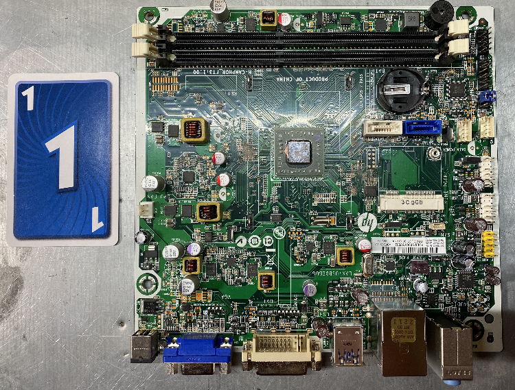

Hi,
I need help classifying this board. It looks like some type of “all in one” mainboard but it doesn’t have a CPU slot from what I can see.
Would it be classified as high peripheral or fall into a motherboard category?
Thanks so much for your help with grading!

Well, lots of views on my question but no answers so I'll answer my own question...
This board has everything but a socketed CPU, just a crappy $2 non-gold corner BGA. I'll say High Peripheral and leave it at that. I'll probably depop the board anyway cause anything under $4.75 that isn't used filler material in the box is just a waste of space from where I ship from. Cheers!

Looks like a motherboard with imbedded CPU from an HP mini computer. I would think small socket green motherboard.

Boards like this don't always qualify for mobo category. I'm not certain where this one would fall but it would not go high peripheral as that pays more than the mobo category this might fall under.
And ScrapperDave, apologies for neglecting your post. If it goes unnoticed for more than a week feel free to comment on the post like you did so it bumps back to the top. I don't know if I missed the post completely or if my uncertainty on the class made me wait to see if someone else would get to it.

Looks like an older design HO thinclient system. These are always difficult to judge for sure. Discussions on embedded and thinclient systems date back to day one on this forum and I was one of the ones who started by asking about them!
I still don’t know for sure half the time.
The thing that bumps some embedded types to high peripheral is the compactness of a full board. The smallest ones like /modern/ ATM and digital vending machine boards can even make it to laptop grade.
With the limited internal expansion I don’t think this is valuable enough to jump to high peripheral and will go with
Small socket green.
