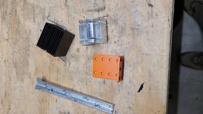

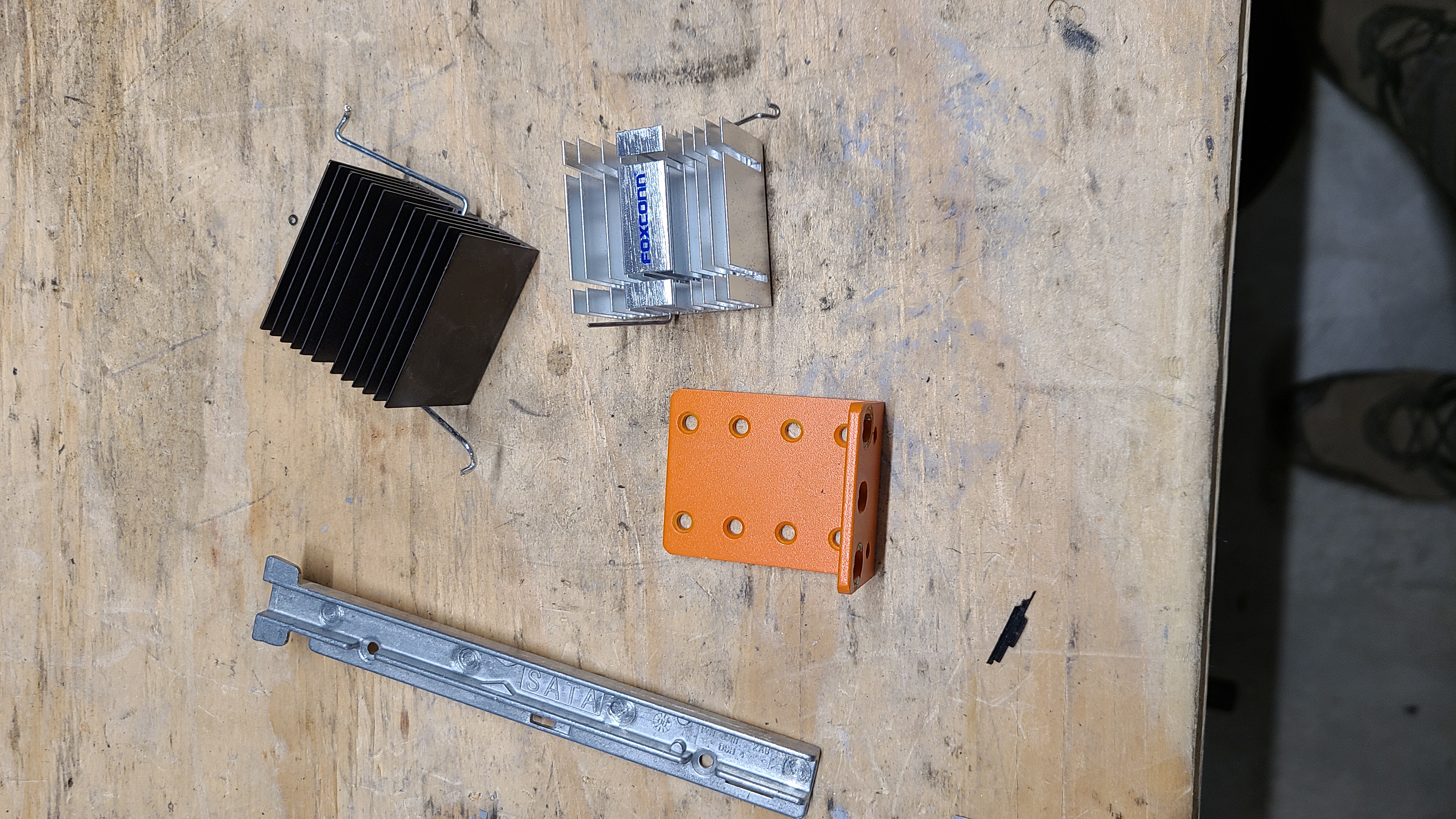

Is everything other than heat sinks with nothing on them considered "clean aluminum?" For example, I have a few chunks of aluminum that are clean aluminum with nothing on them. I also have some stuff that's painted, as well as a few heat sinks with the steel tension clasp. How would all this be sorted? The pic is some of what I'm talking about.

If it's clean, it's clean. If it has the tension wires still on it it would be dirty. I
personally think it's worth the effort to remove the tension wires. But that's me. Good luck.

I would remove the tension wire. Most remove pretty easily. Most heat sinks like that are extruded aluminum, which usually pays the best at most yards. The others I would put in painted sheet and cast categories. Sometimes the price is the same but makes it easier at the recycling facility.
