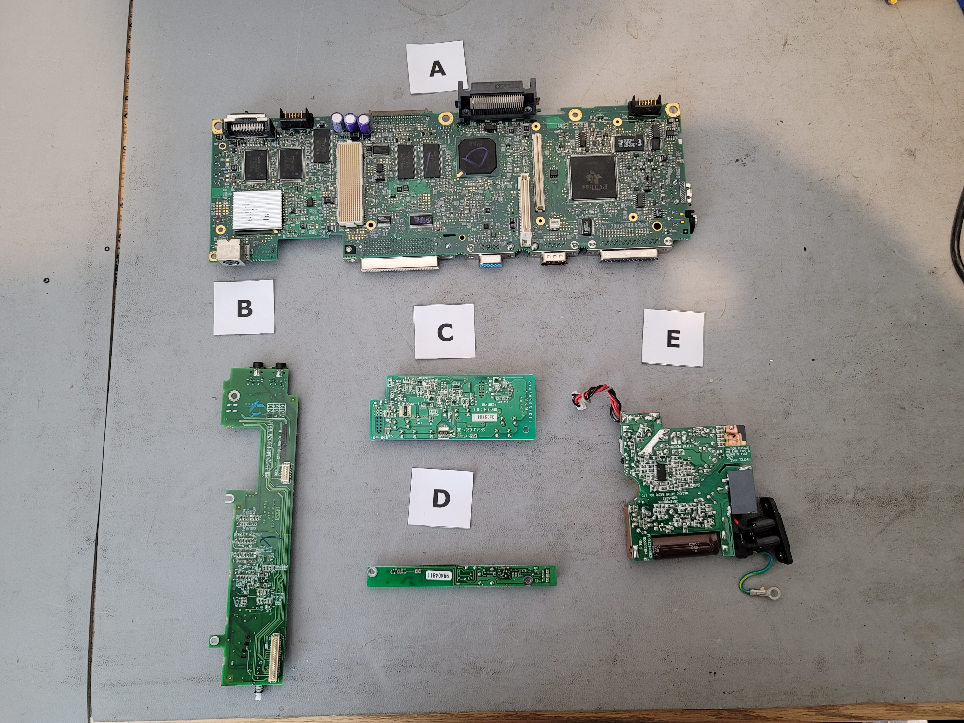

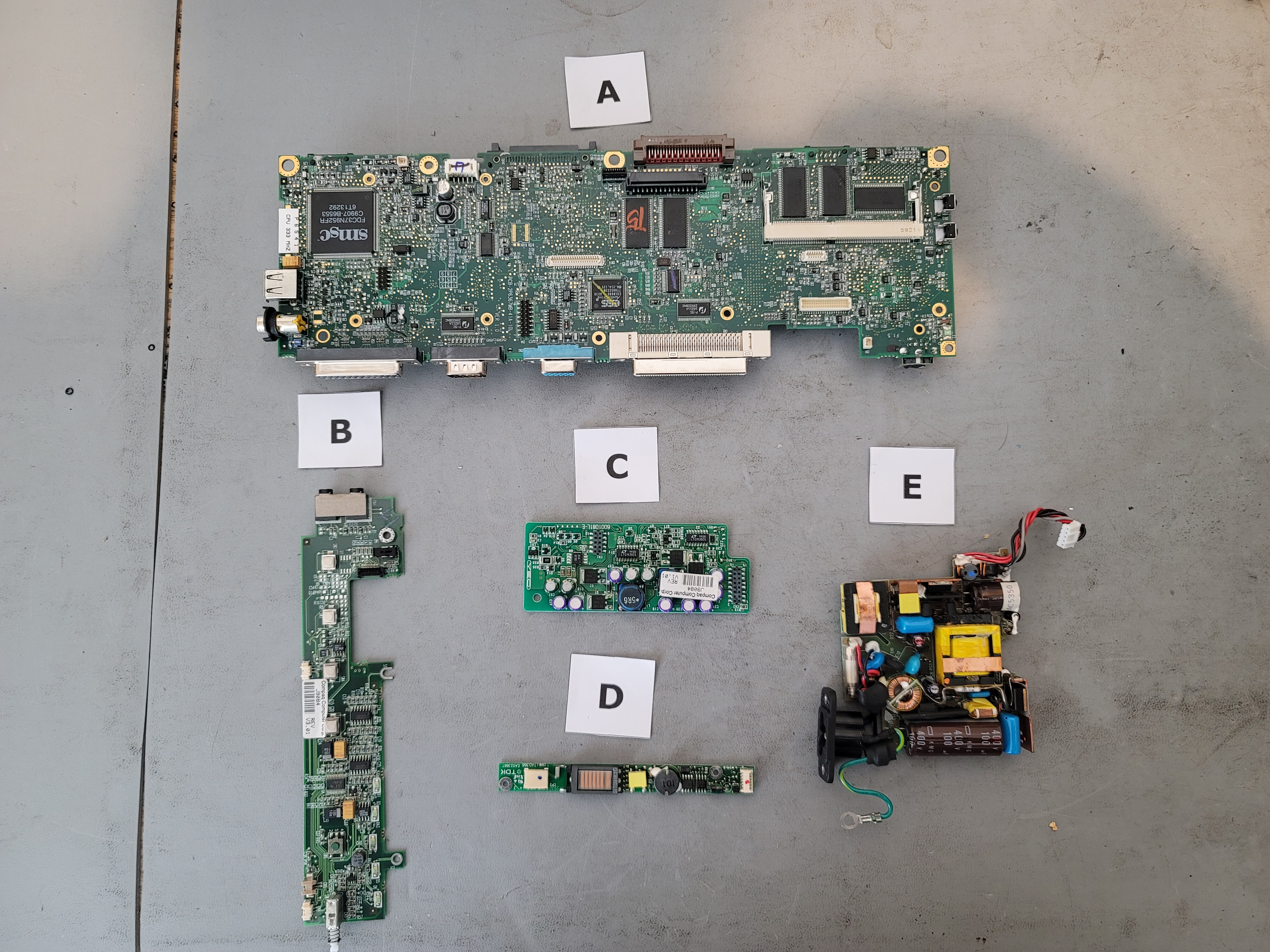

Compaq Presario circa 1999
A-should be a laptop MB
B and C I guess High Peripheral
D-Low maybe
E-Destined for the local trash as it won't be worth shipping.
C.

I agree with A, B, & C, but I think D can got as high grade periph as well. Not much total weight of the board and has a few small ICs on it. With E, you should find a local yard that will take transformers if you have enough to make a few pounds, some yards might classify as electric motors or CBM as well.

I'll have to look again when I'm not on my phone but I tentatively agree with all but D.
Looks like D has a good bit of steel weight but also has a couple ICs. So you're starting at midgrade, worst case, but I'm inclined to say low peripheral.
As for E, it's up to you to determine how much processing is worth your time if you want to strip the board of most everything that way you can sell to a local scrap yard. Or, if you have the space, low grade board tend to stack up pretty quick (at least for me). You could hold onto all your low grade until you have enough to ship freight. There's a guy on here Gorven I believe is his username, that has been helping forum members ship freight. I have used him once so far and aside from some "first time shipping freight" bumps it was great. I think it was about 25¢/lb or less (honestly not sure at this point) but definitely made some money on shipping low grade to boardsort instead of selling locally.

A) I think there's a chance for high telco here, pop the aluminum heatsink off, should be able to slide a flathead under the heatsink and chip and twist.
D) I can't see high peripheral on it, low peripheral should be good.

A-popped off the heatsink, and wondering how I missed removing it. (perhaps more coffee is in order.)
B and C sorted to High Periph
D-Low Periph
E-Local disposal
Sorted, Thank You.
