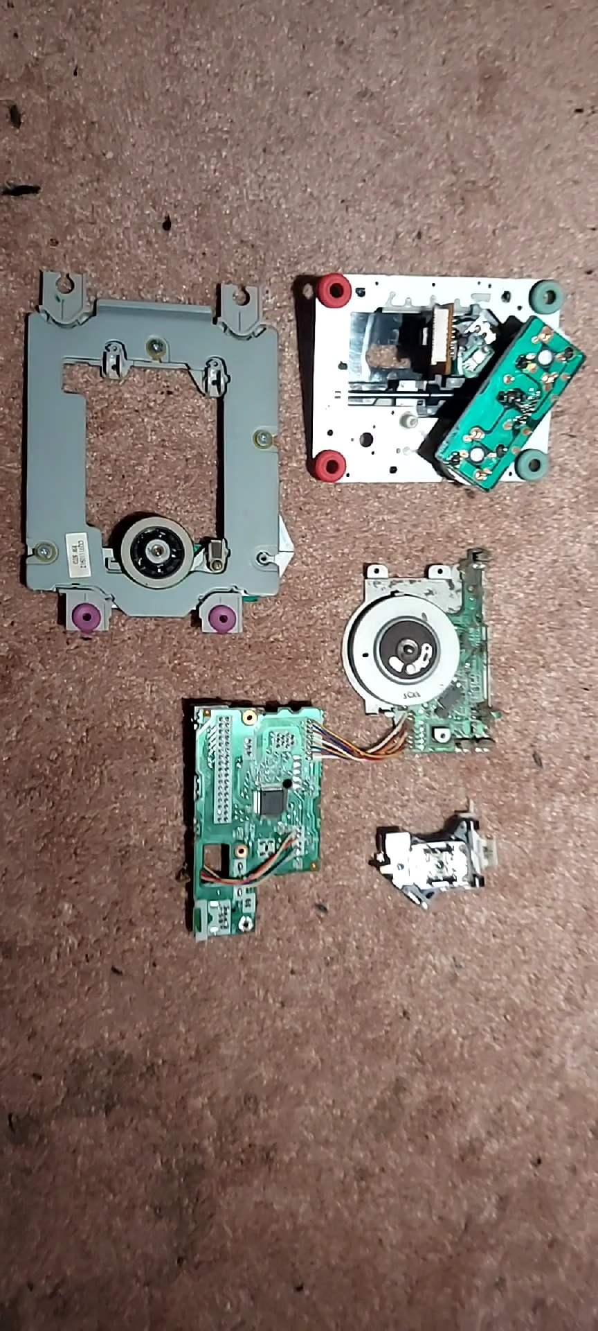

All cd reading stuff. Periphal low grade once all metal and wires removed?

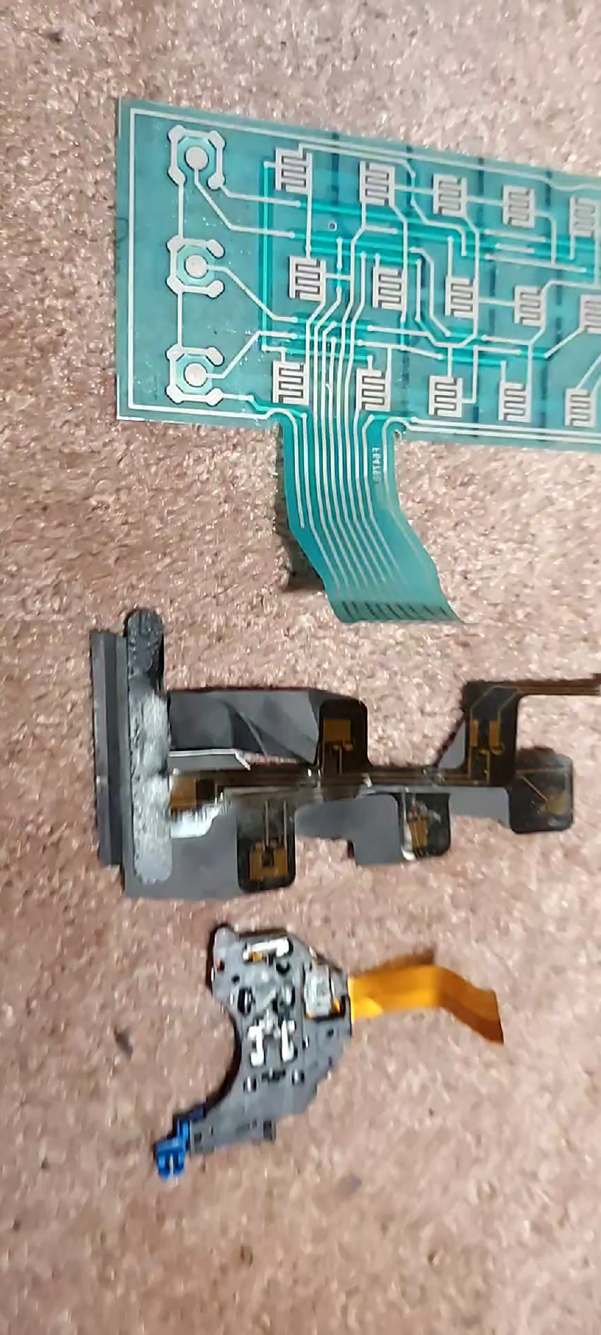

Any value in saving these flexible circuit boards?

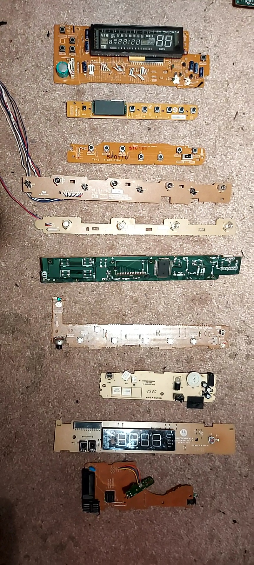

Need to remove LCD displays? LEDs?
Assume all low grade except middle green possibly low grade periphal?
PostPosted: Tue Jun 07, 2022 3:36 pm
Posts: 557
Starting from top down,
Shred
Shred
Low grade
High peripheral, remove wire
Shred
Mixed wire
Mixed wire
Shred, remove wire,
All low grade, remove wires, keep screens on

Awesome, appreciate it! I assume that was starting from very top (1st photo) and spanning all 3 photos?
PostPosted: Fri Jun 10, 2022 2:41 pm
Posts: 557
Yes, starting from top and going down.
