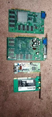

All gold finger boards as far as I can tell.
Assume that heatsink in top one should be removed
- connectors on right edge of top, 2nd down and bottom come off, as well as both brackets on that side
My uneducated guess

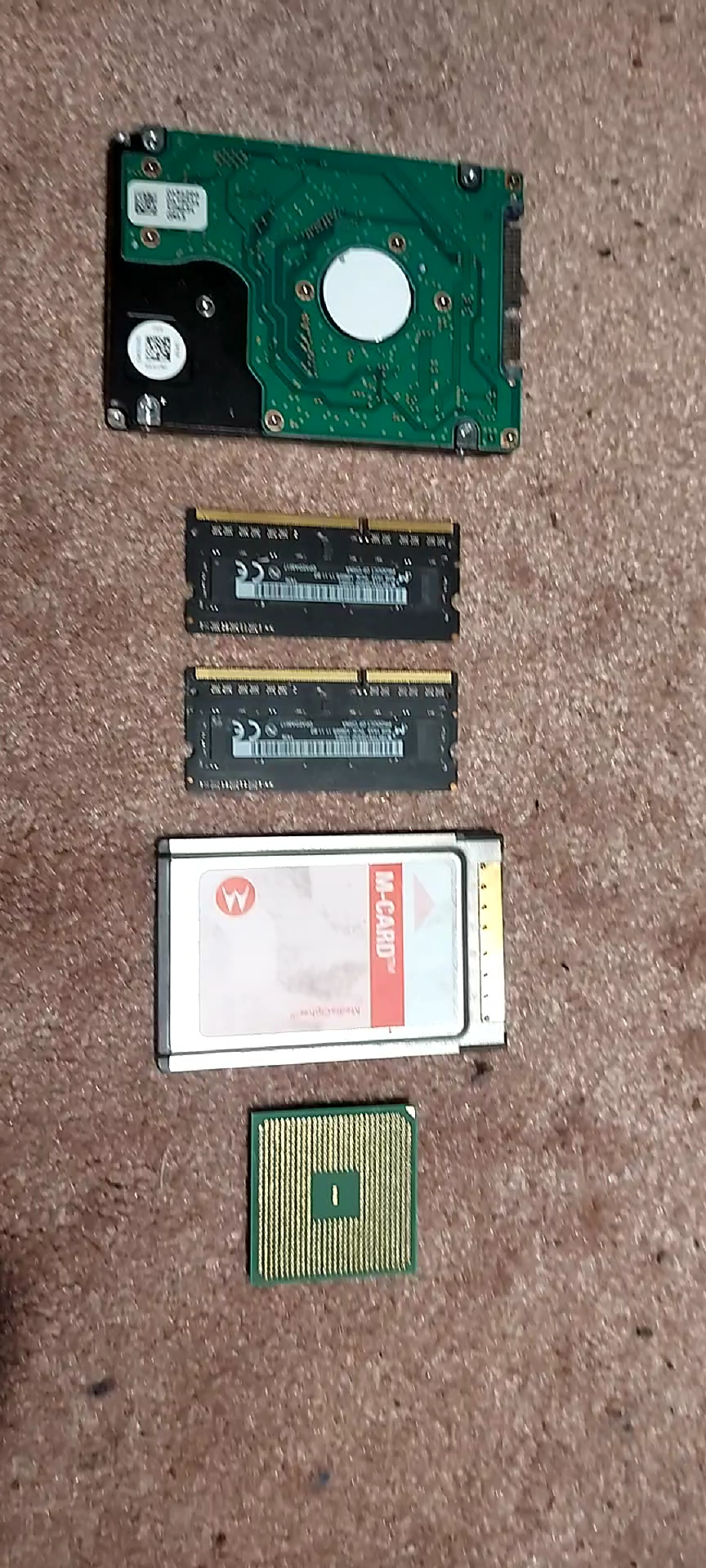

Top - Hard drive
2nd and 3rd down - gold fingered RAM
4th down - ?
Bottom - AMD ceramic aluminum top

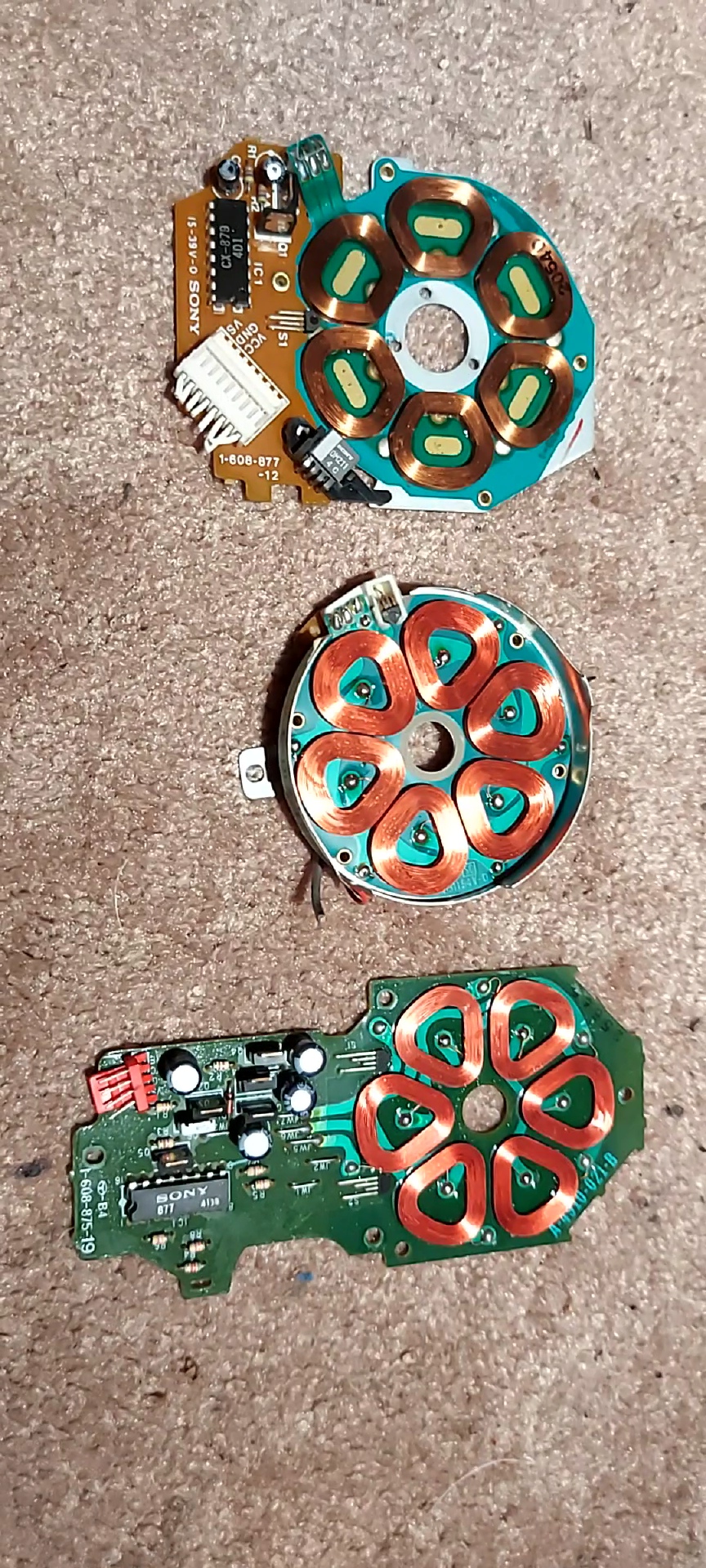

No idea what these classify as / if need more processing

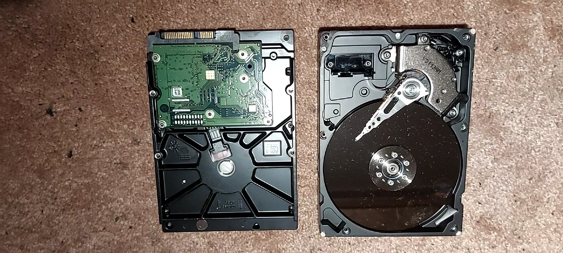

And on the right, hard drive no board
On the left, hard drive with board

remove heatsink if possible, if you can safely remove the heatsink it will go as no fan, heatsink, or bracket gold finger card.
Low grade, remove gold finger
Clean gold finger card no bracket
Clean finger card with bracket, remove steel cover.
Hard drive with board
Gold fingered ram
Remove cover for a board anywhere from high peripheral to telecom
Green brown fiber with metal cpu
Motor,
Motor
Mid grade if an actual board, motor if "board" is steel.

Just my 2 cents. On those gold finger cards, you should always remove the heat sinks, fans, any metal covers, and the brackets. NOTHING else. If you remove chips or connectors there is a very good chance to lower the boards grade. Keep it simple. ;)
