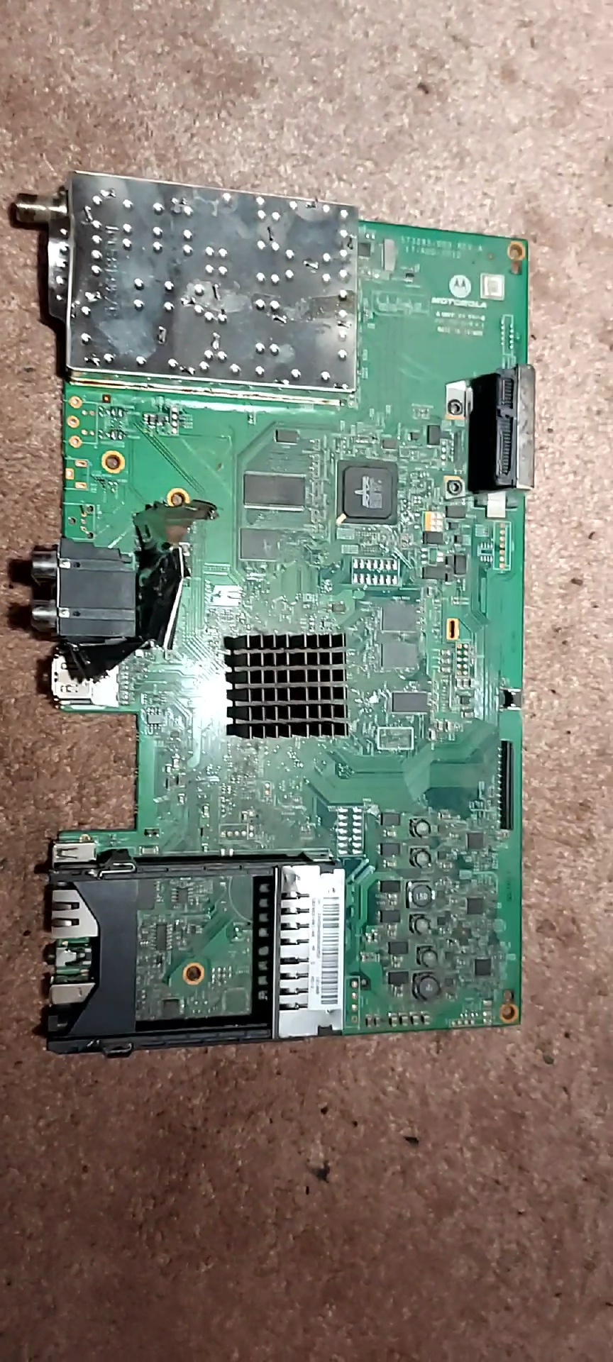

Not positive on classifications of any of these.
Anything need to be removed in first photo?
Looks like there's still some processing to do here.
-Disc style battery, bottom right
-external connectors, bottom right, right side?
-J shaped connector, top right
-Remove the wound copper unit, top left?

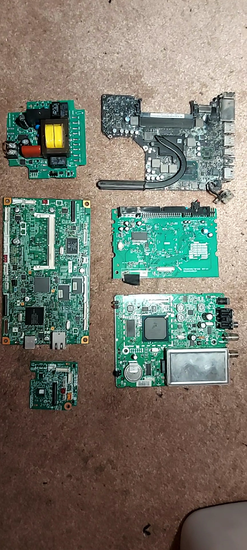

One more of a similar style here..
- remove heatsink
- remove round connectors, middle and top left?
I assume from here on labeling each board with what it came out of could be helpful for identification and sorting...

Boards are graded from the top left in each picture going right.
Pic 1.
Low peripheral
Low peripheral, remove wire
High peripheral
High peripheral
Long one, low peripheral
Middle right, low peripheral
Long board again
High peripheral
Old/high grade HDD board
Pic 2.
Midgrade, do not remove anything
Laptop motherboard, remove heatsink and any coin batteries that may be on it.
High peripheral
CD/DVD board
High peripheral
High peripheral, remove cover from steel box to see what is underneath it, and remove coin battery carefully.

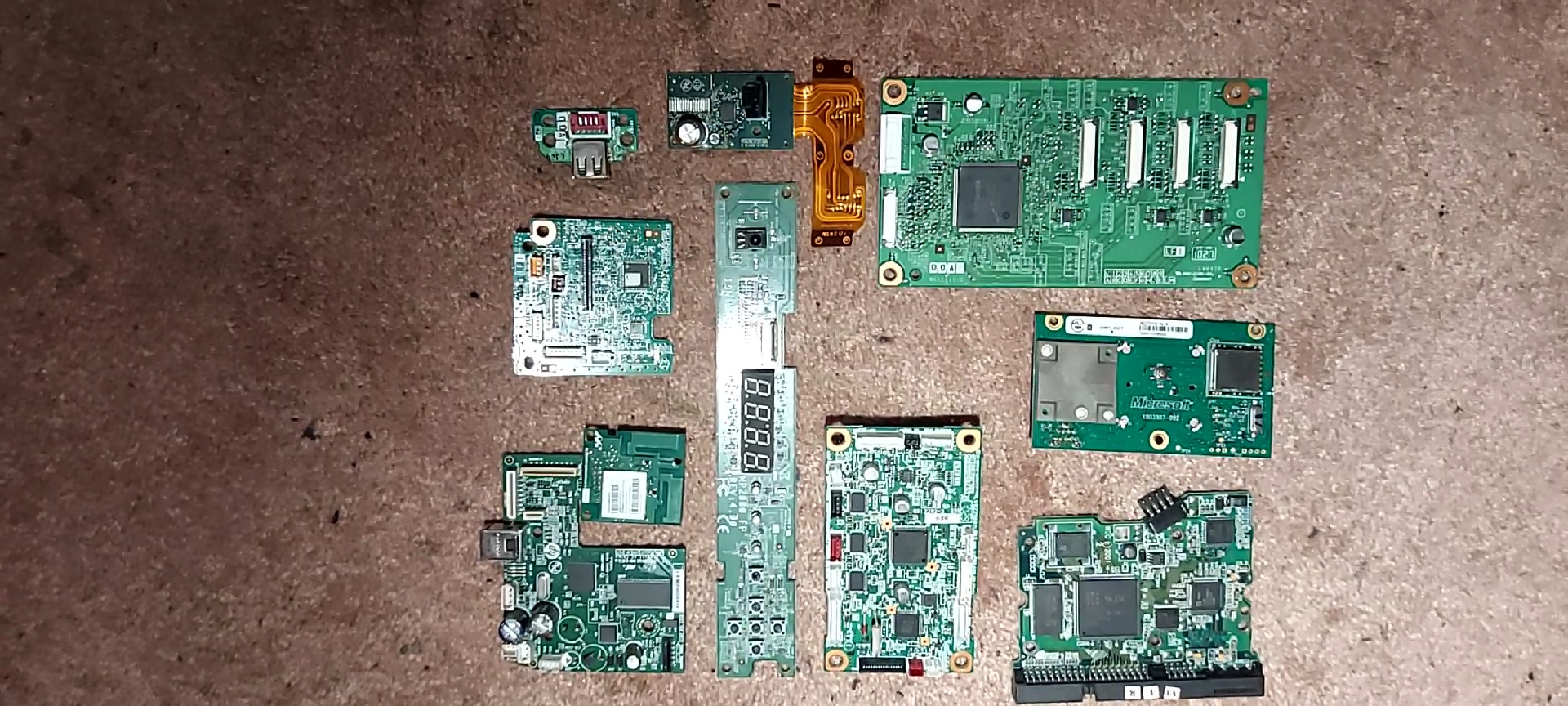

Pic 3.
High peripheral, remove heatsink (if you are able to without removing the chip, otherwise just leave it and put in high peripheral) and steel box cover. Leave connectors on, not worth the risk of downgrading it.
