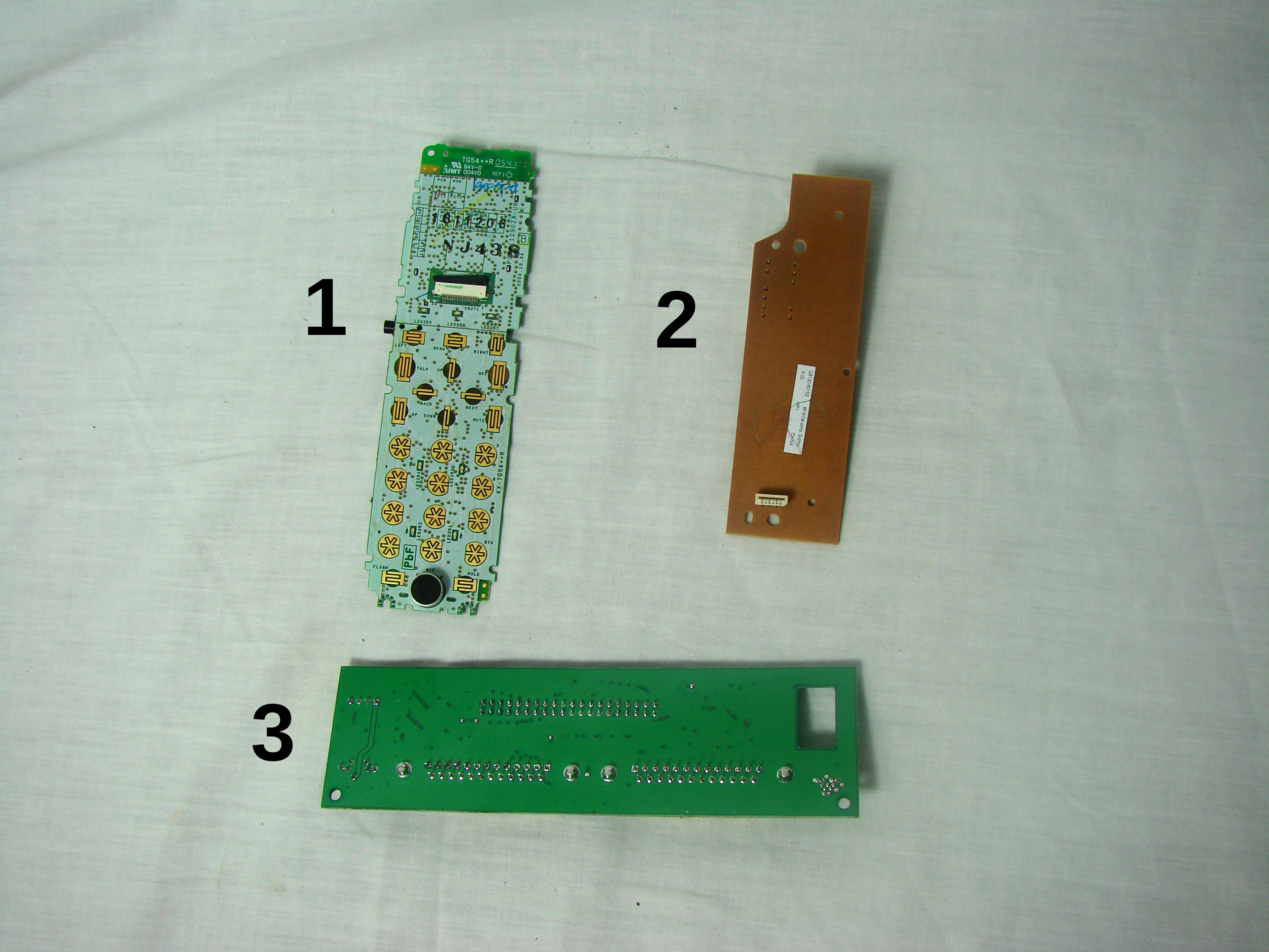

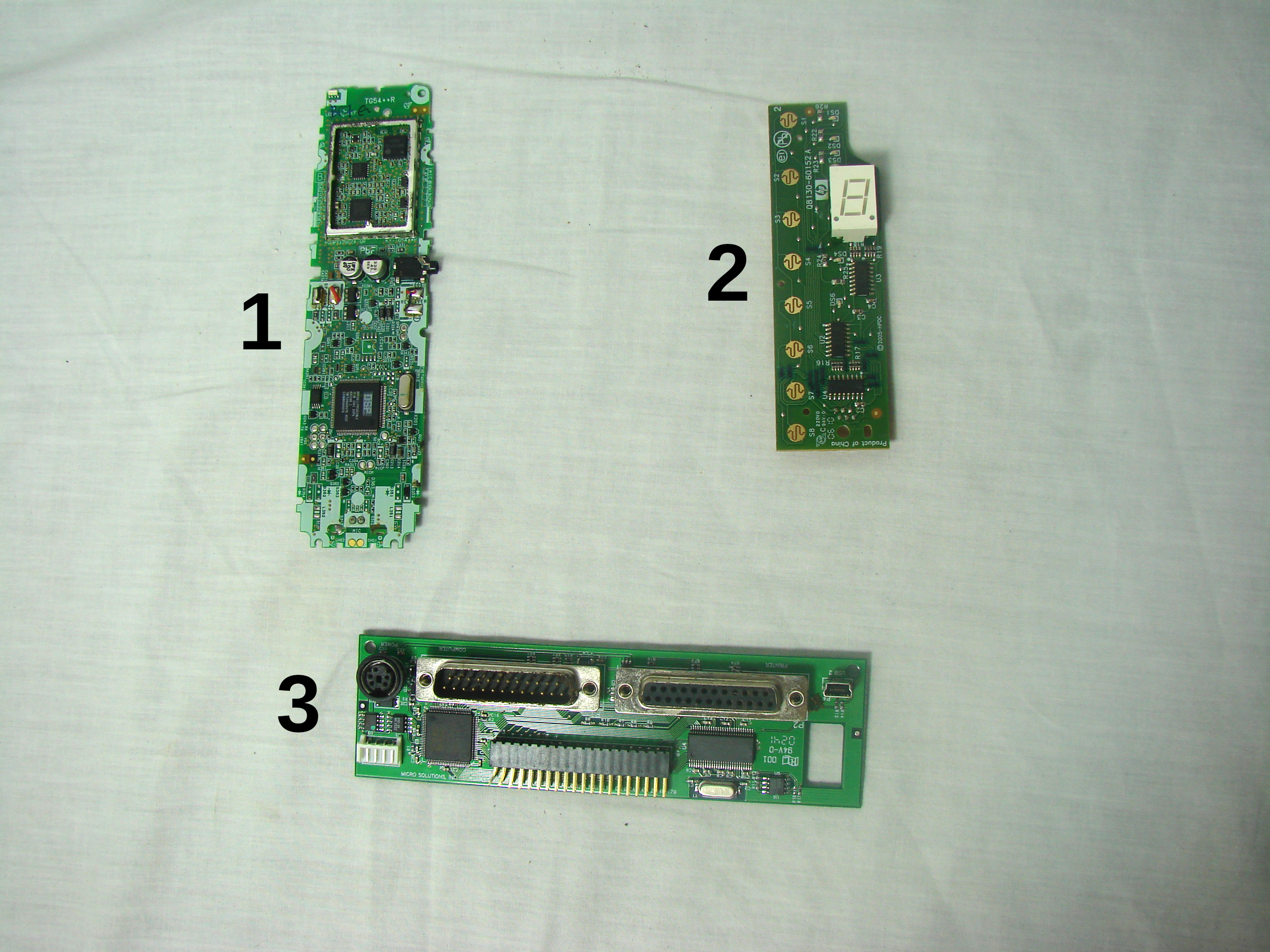

Wanted to verify on these.
#1 and 3 High Peripheral, a little unsure due to the gold plated button pads on the back of #1 and the gold pins on #3.
#2 Low grade, a little unsure due to the gold plated button pads here as well. Also, thoughts on it making High Peripheral assuming the 7 segment display comes off? (It just doesn't seem so to me.) I only ask because if it won't go that high it's in my low grade bin with the IC's stripped.

1 Should definitely be high peripheral
2 is probably an exception to the rule of brown boards being low; without being sure I'd probably stick it in low peripheral. The single digit display probably helps it go higher so no reason to remove (something Lostinlodos said awhile ago).
3 High peripheral is probably correct, though I'm not positive on that myself.

Appreciate the response marked. Good to know about the single digit displays, I wonder if that applies to multiple digit 7-segment displays or just the single 7-segment displays?
Maybe someone will respond to confirm on #2 and 3 since neither of us are positive. I'll likely do what you suggested though if no one else chimes in.
