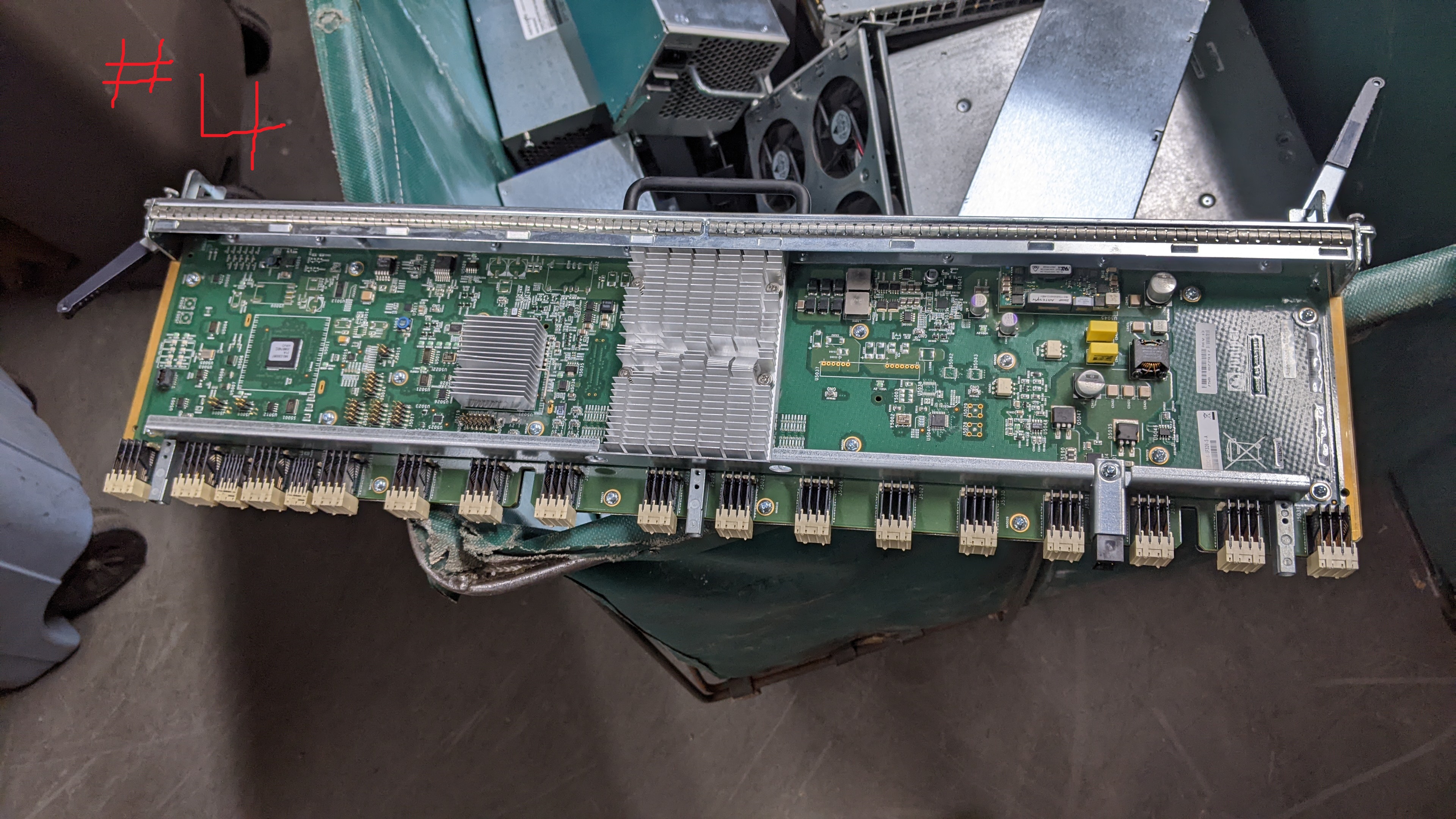

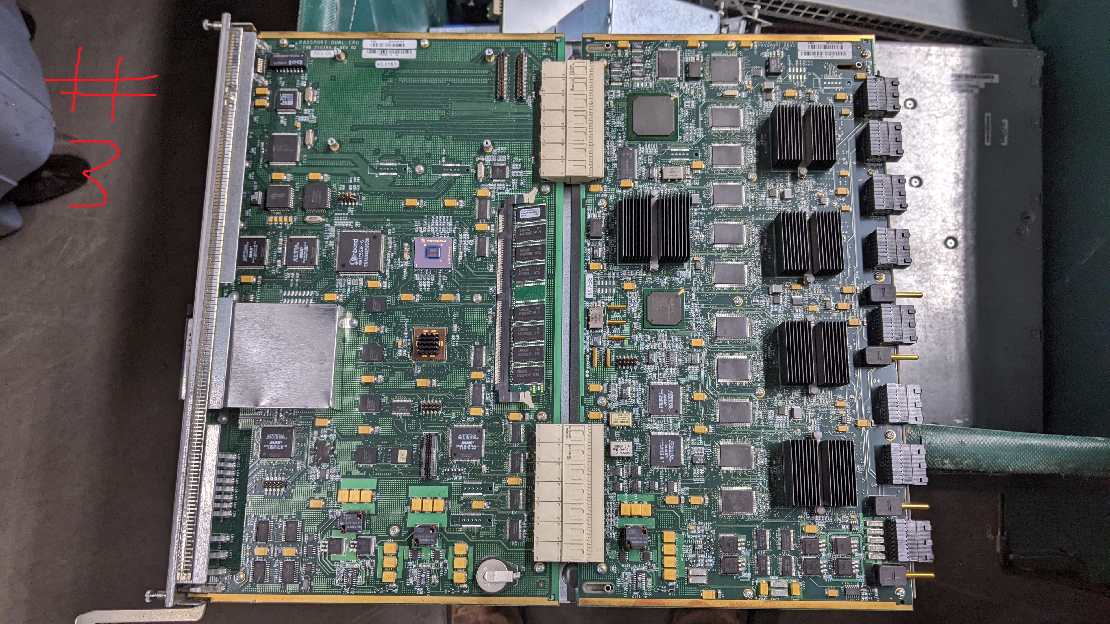

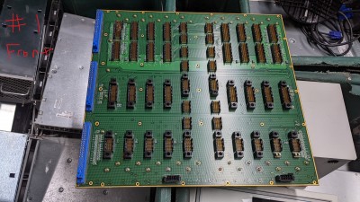

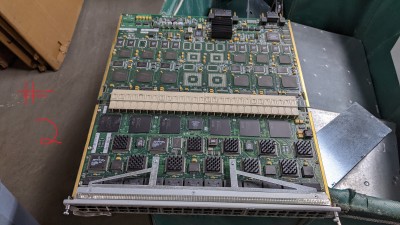

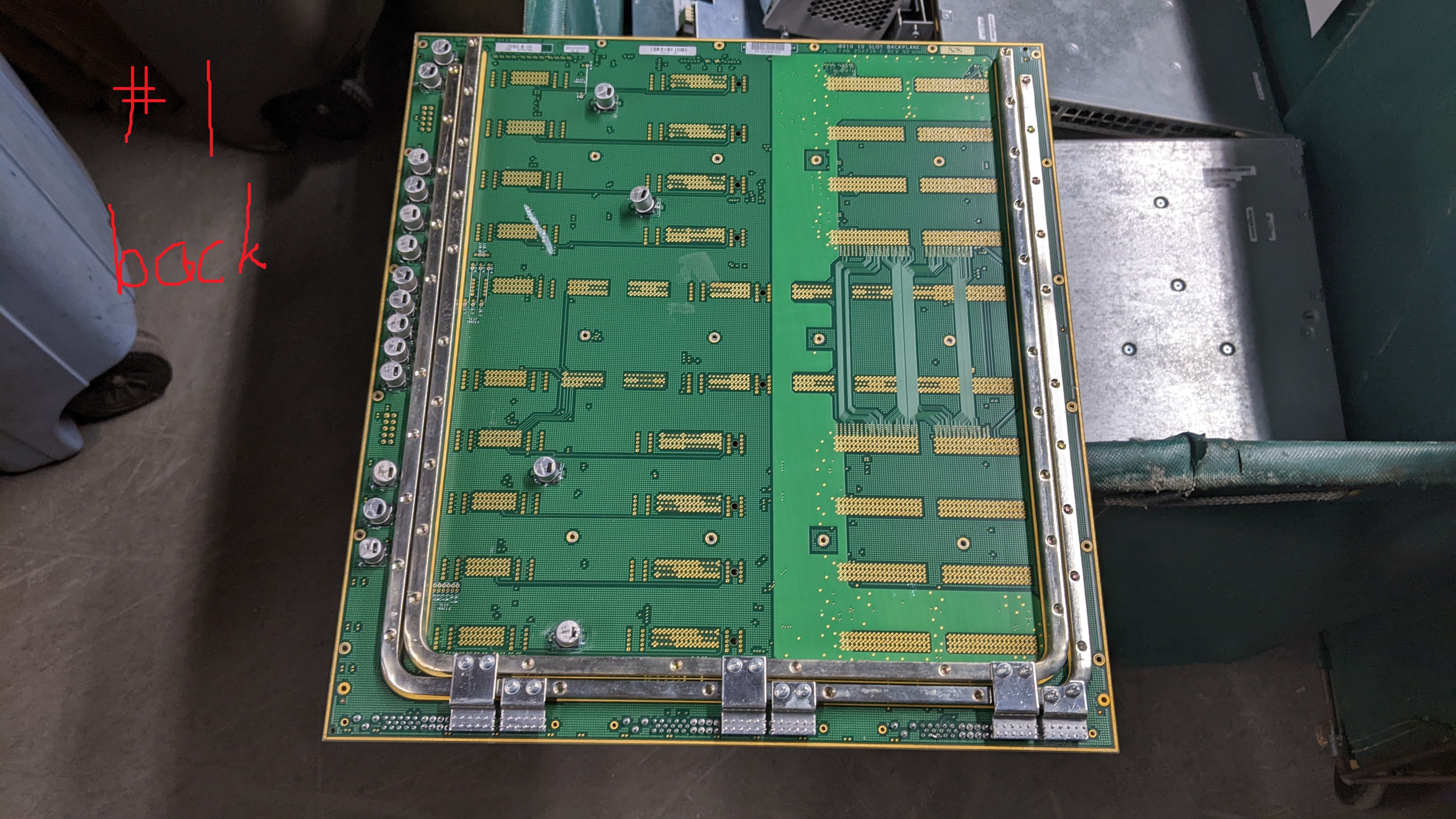

We received a fair few of these boards recently, can any help ID/grade them?

I can make 1 sure comment on your boards. Clean off the metal and heatsinks. Comment number 2. Give the forum members views of the opposite sides. #1 has front and back. Thank you. Clean off the metal. It probably is Backplane. If you turn your boards in as is from your photos. You will get a low price.

Definitely remove all the stuff that's screwed on. Also remove any batteries, I saw at least one on 3, and socketed boards, I see RAM and boards plugged into each other.
These all look pretty substantial, I'm not overly familiar with the Gold Edge category but once they're cleaned up they may qualify for that.
The slightly bent metal on top of the faceplates is likely a brass flashing (helps prevent the module from getting stuck), so be sure to check that.
