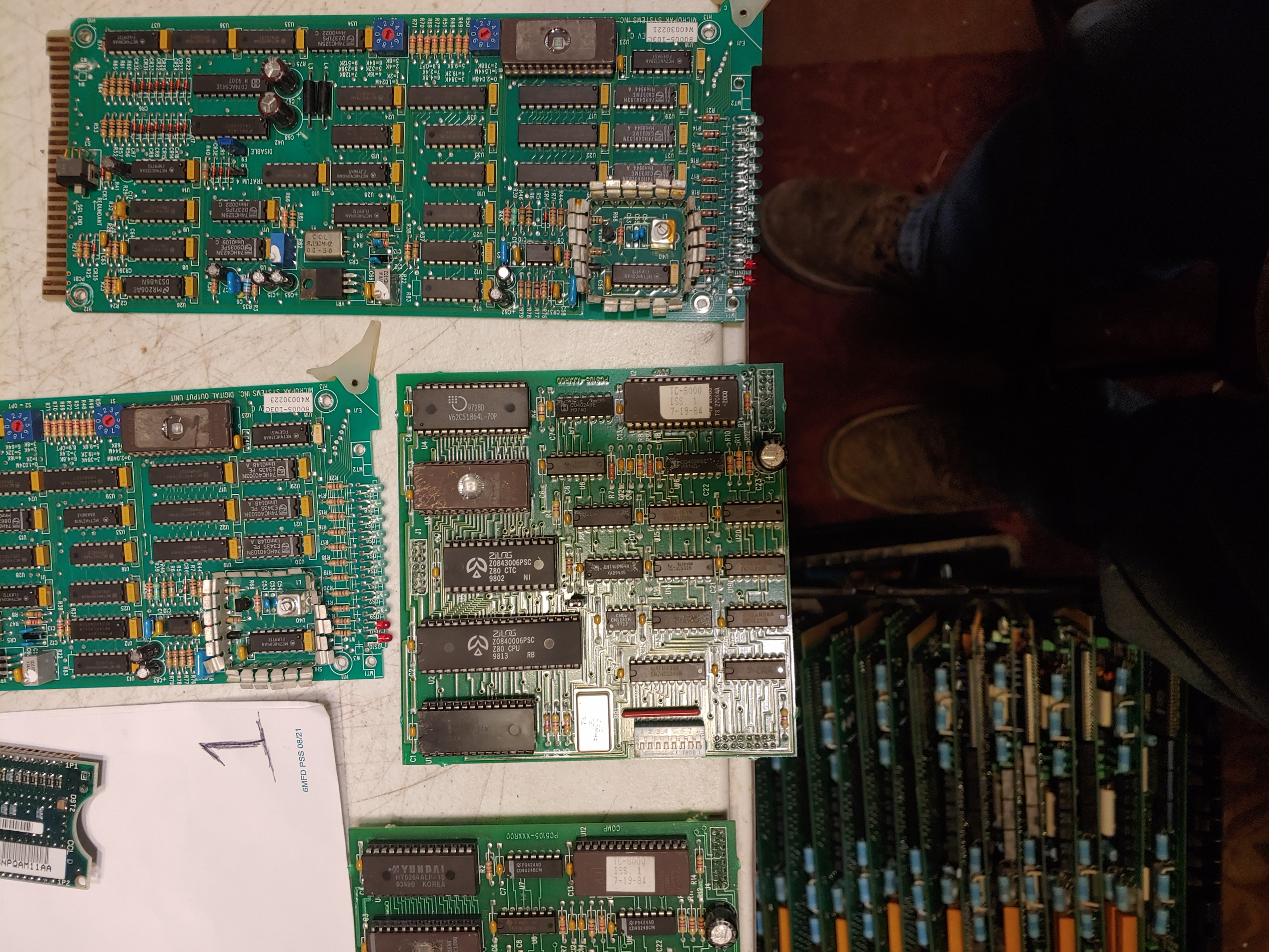

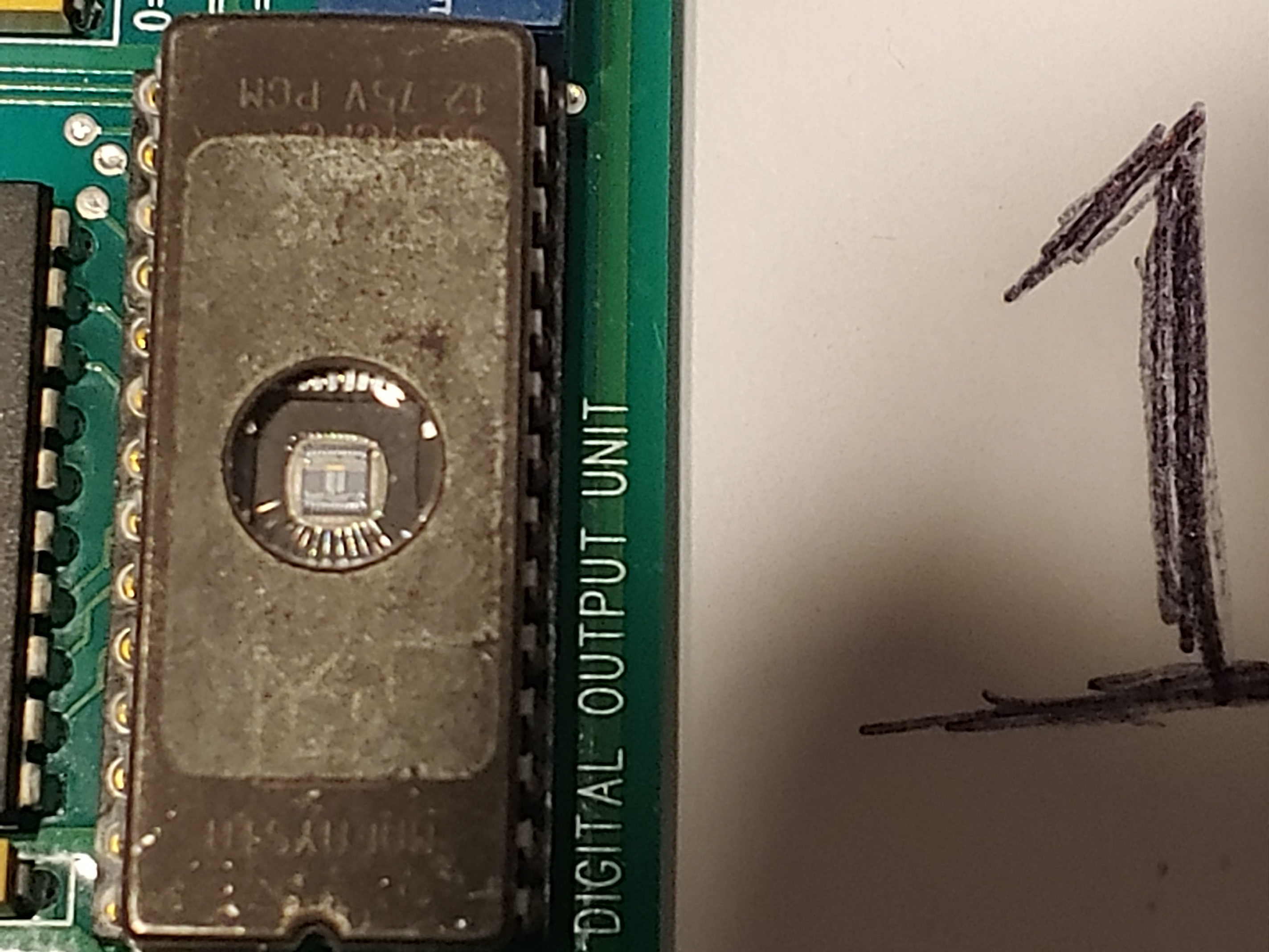

Pic #1 I have a few boards with this IC that has it appears almost like a hologram of the letter H. I am new at this so maybe this is common. I was wondering of its significance.

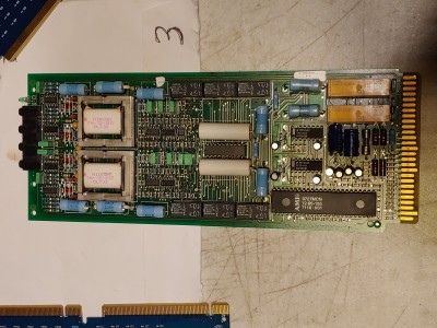

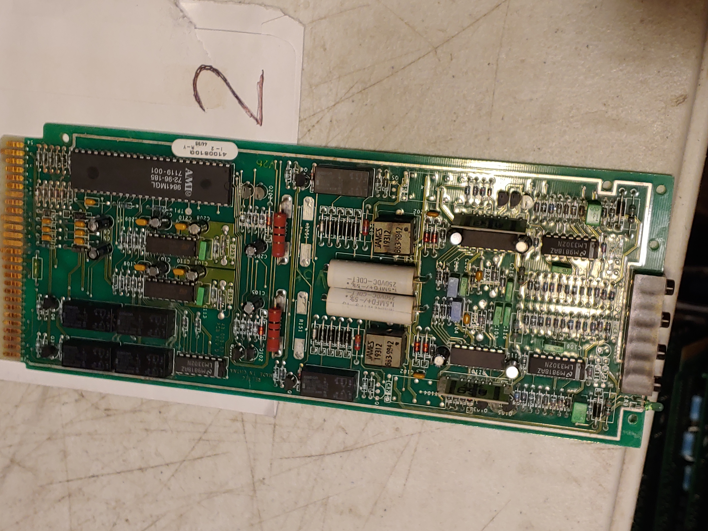

Pic #2 is this high peripheral?

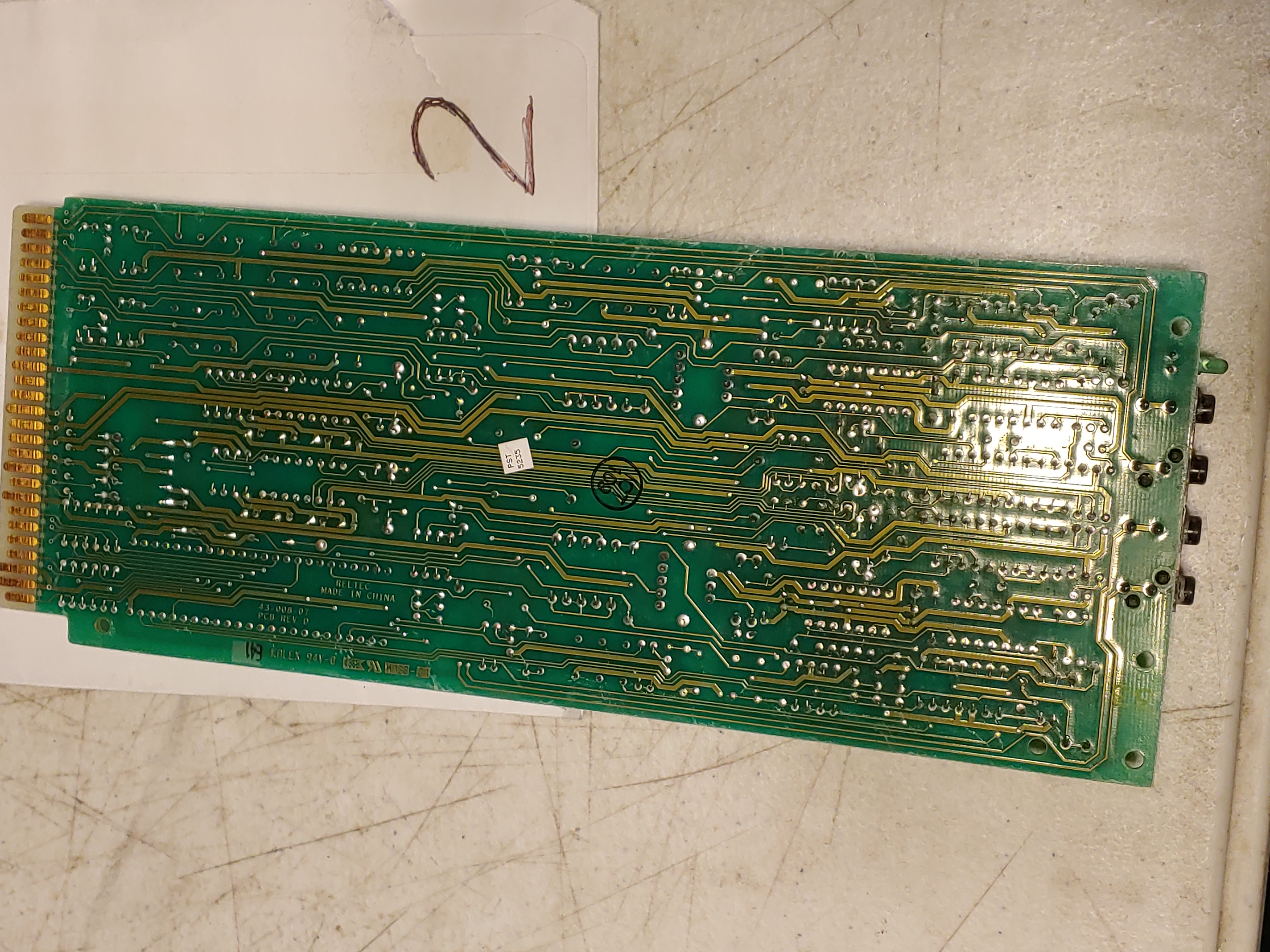

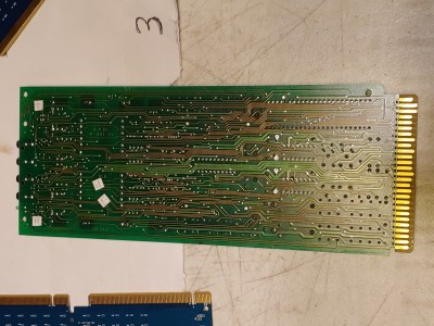

Pic #3 Is this low or high peripheral?

ICs like that are fairly common. What you see in the center is the die.
If I remember correctly, ICs can be reset by light (UV I believe) and normally have a sticker over the window to protect whatever has been programed onto the chip.
1) Long boards, at least low telco; I don't think it can go high but if you have a bunch might keep them separate but with your low telco in case they can be upgraded.
Square boards, make sure that silver box I can't read isn't mercury (doubtful, but always good to check), if no mercury, high telco.
2) High peripheral sounds right.
3) As is, I'm leaning low peripheral. Without the transformers probably could make high peripheral.

So they are called EPROMS for Erasable Programmable Read Only Memory. And as marked141 said. you can erase them with UV light, then you put a sticker over the window so they aren't erased by ambient UV light, and you put it in a ROM programmer and put your data into it.
You can see the bonding wires going to the DIE. In some cases these are gold bonding wires. in your pic I think they are aluminum. These chips are usually socketed, so if you have something similar and there's a sticker on it it's worth scraping the sticker off and seeing if there's a window and if the bonding wires are gold.
