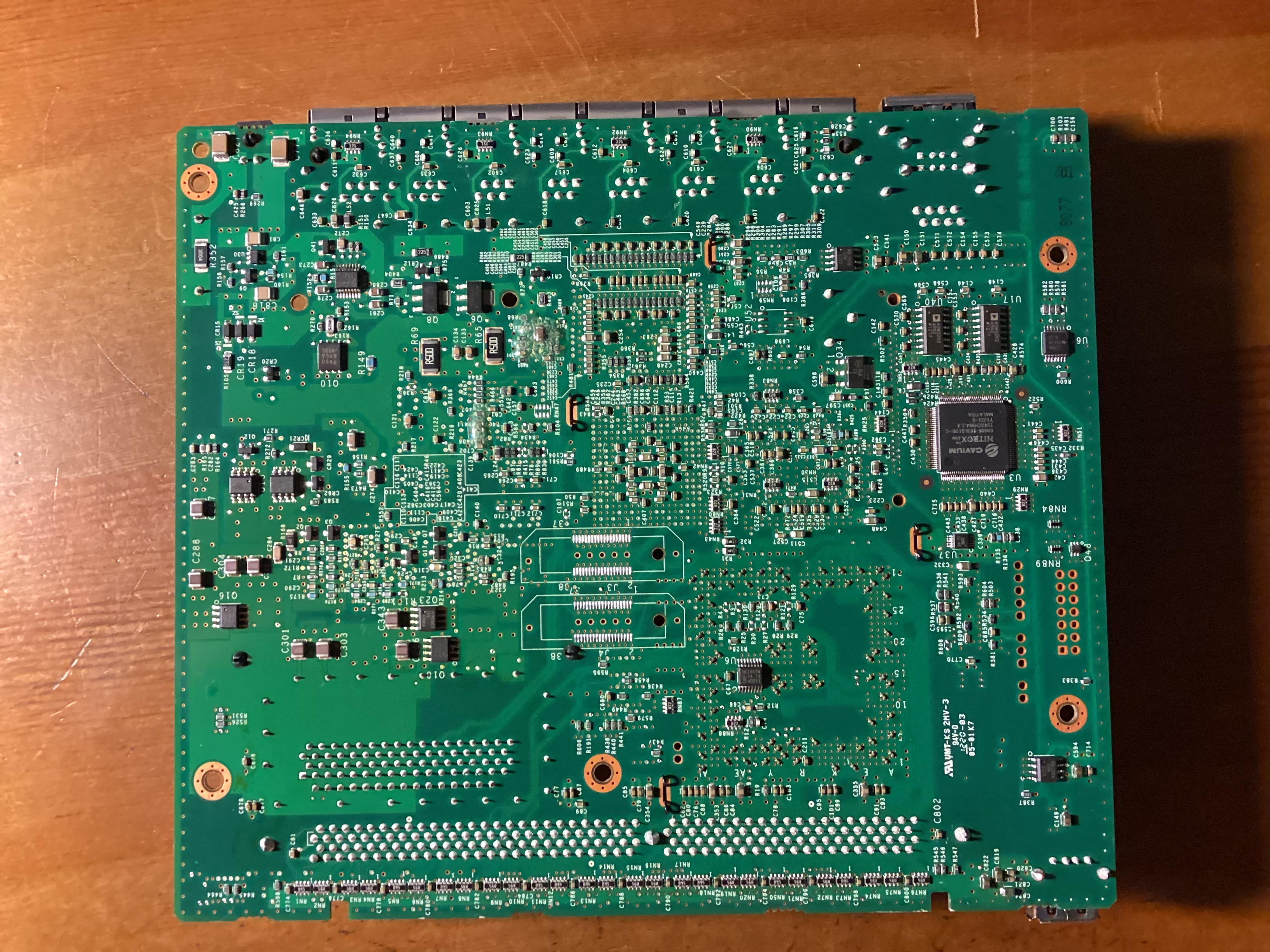

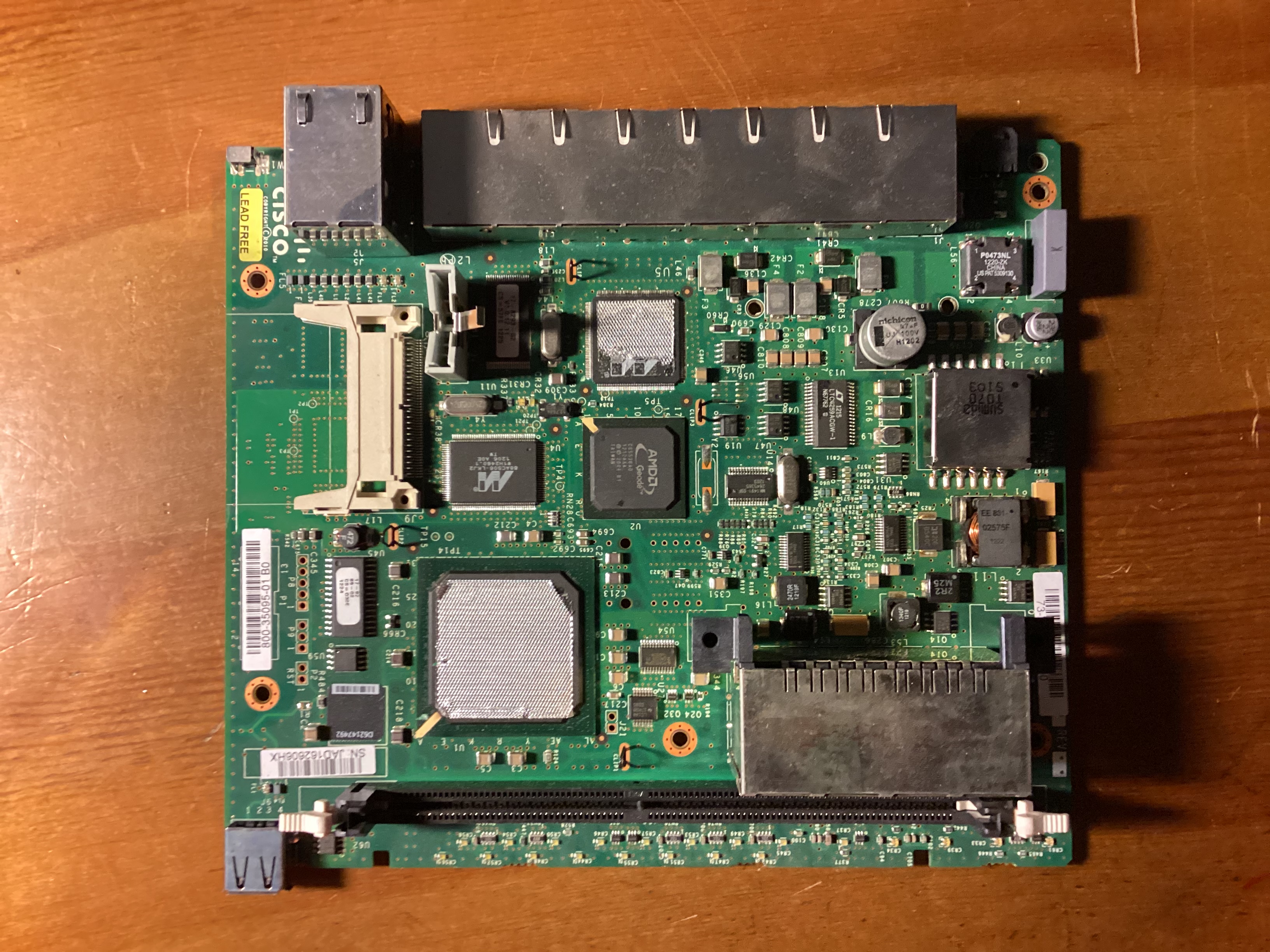

This is from a Cisco router. Will it grade as high grade telecom or something else? Thanks

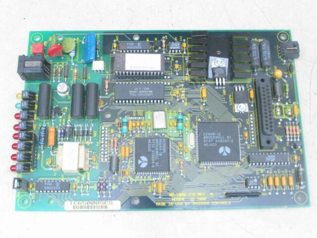

I'd call it high peripheral, based on Boardsort's example in their price sheet.

The difference I’m seeing is the board I have has two gold corner tabs and no transformer which I would think would improve the grading.
PostPosted: Tue Apr 18, 2023 1:07 pm
Posts: 806
You are correct, but there are some heavy modules on either side of the board. I wish these type of boards were high grade telcom consistently because I have several to classify. It might bump up into low grade telcom.
High Grade Telecom is for very high grade boards, usually having a lot of IC chips, gold pin connectors, etc. and little junk weight from large capacitors, steel, unpopulated areas or not populated with valuable materials.
https://boardsort.com/telecom.html
Here's another great post on the differences between hi/low grade telcom.
viewtopic.php?f=4&t=20773&hilit=+layers

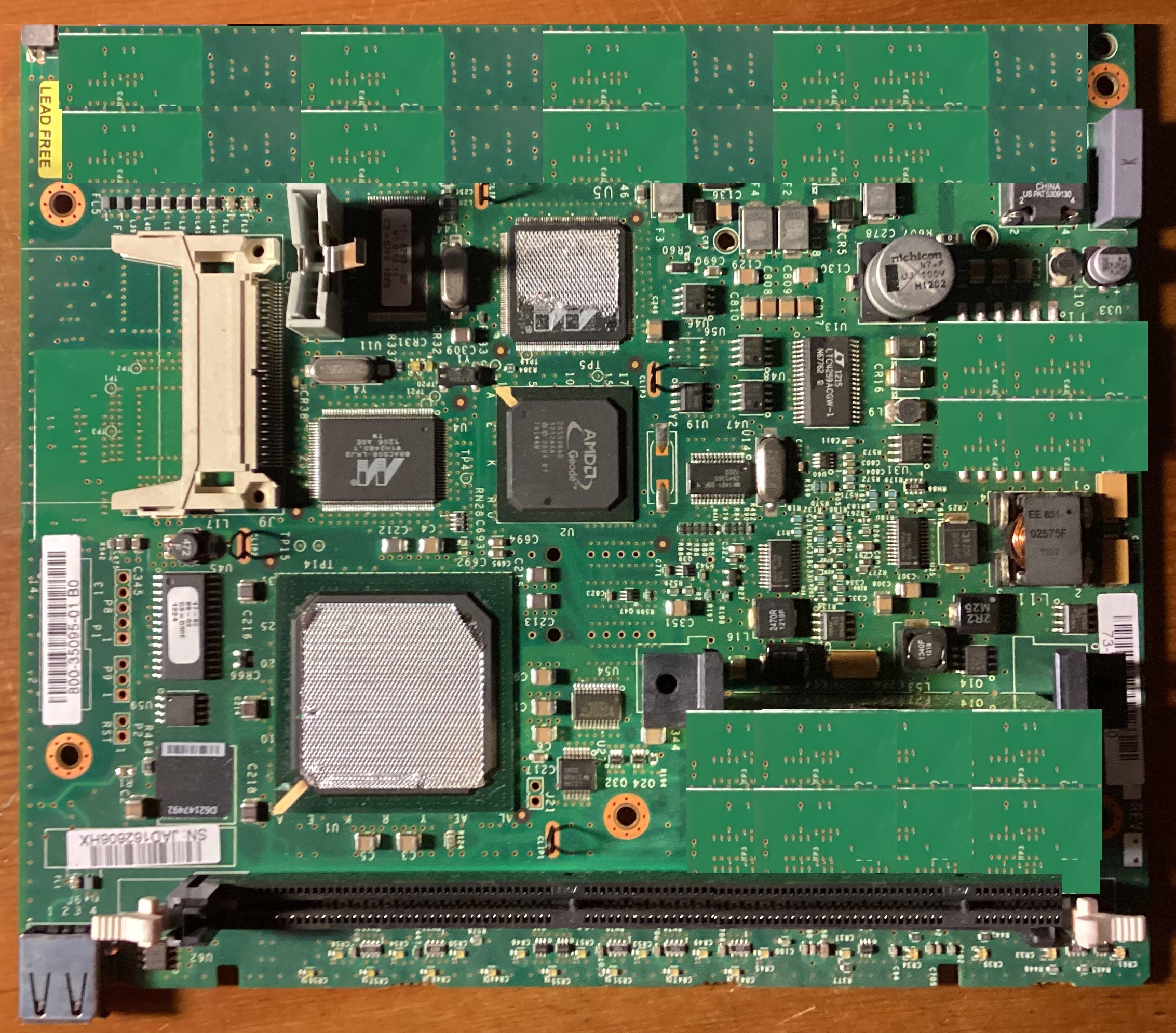

Here's what the board would look like after (digitally) trimming the extra weight off.
