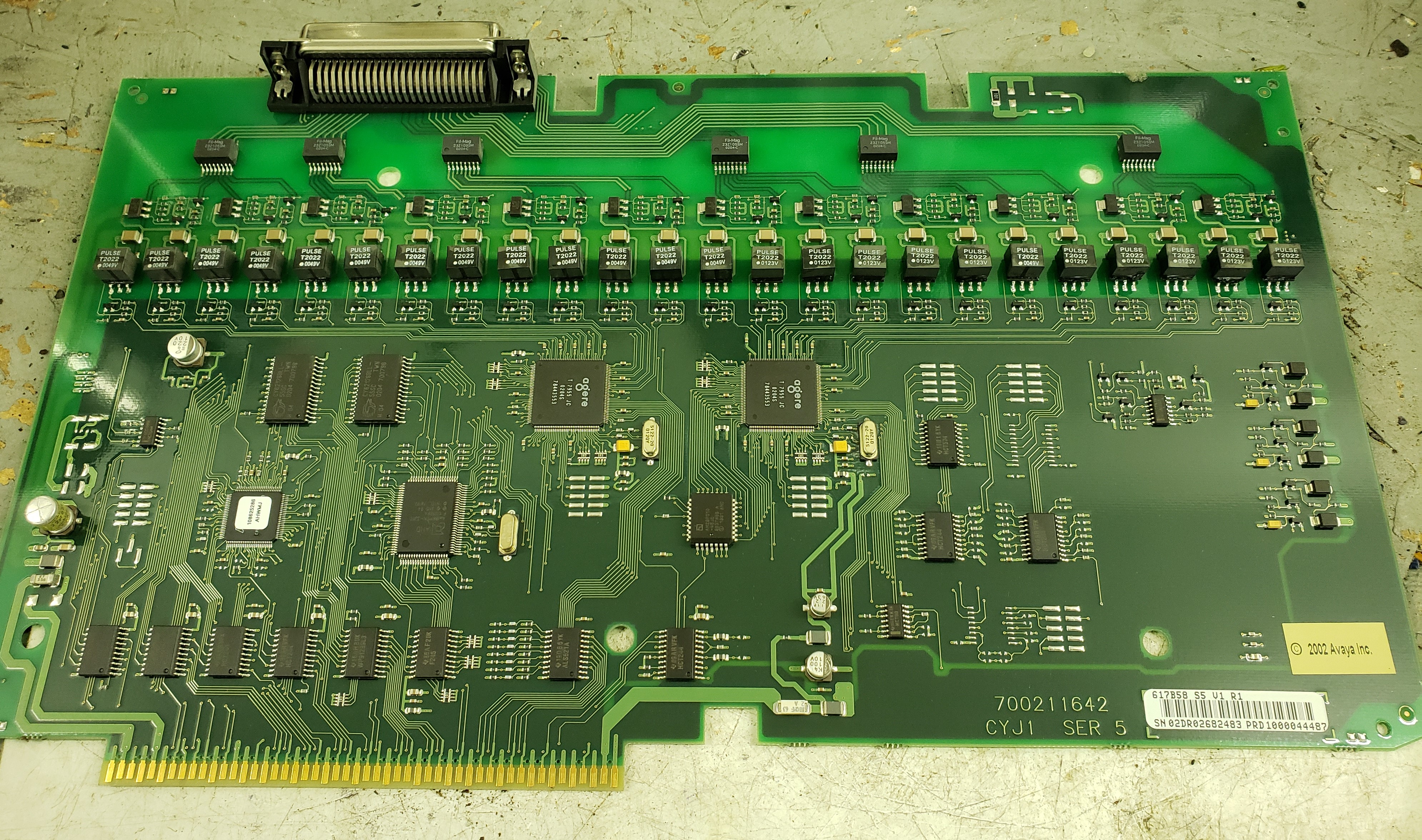

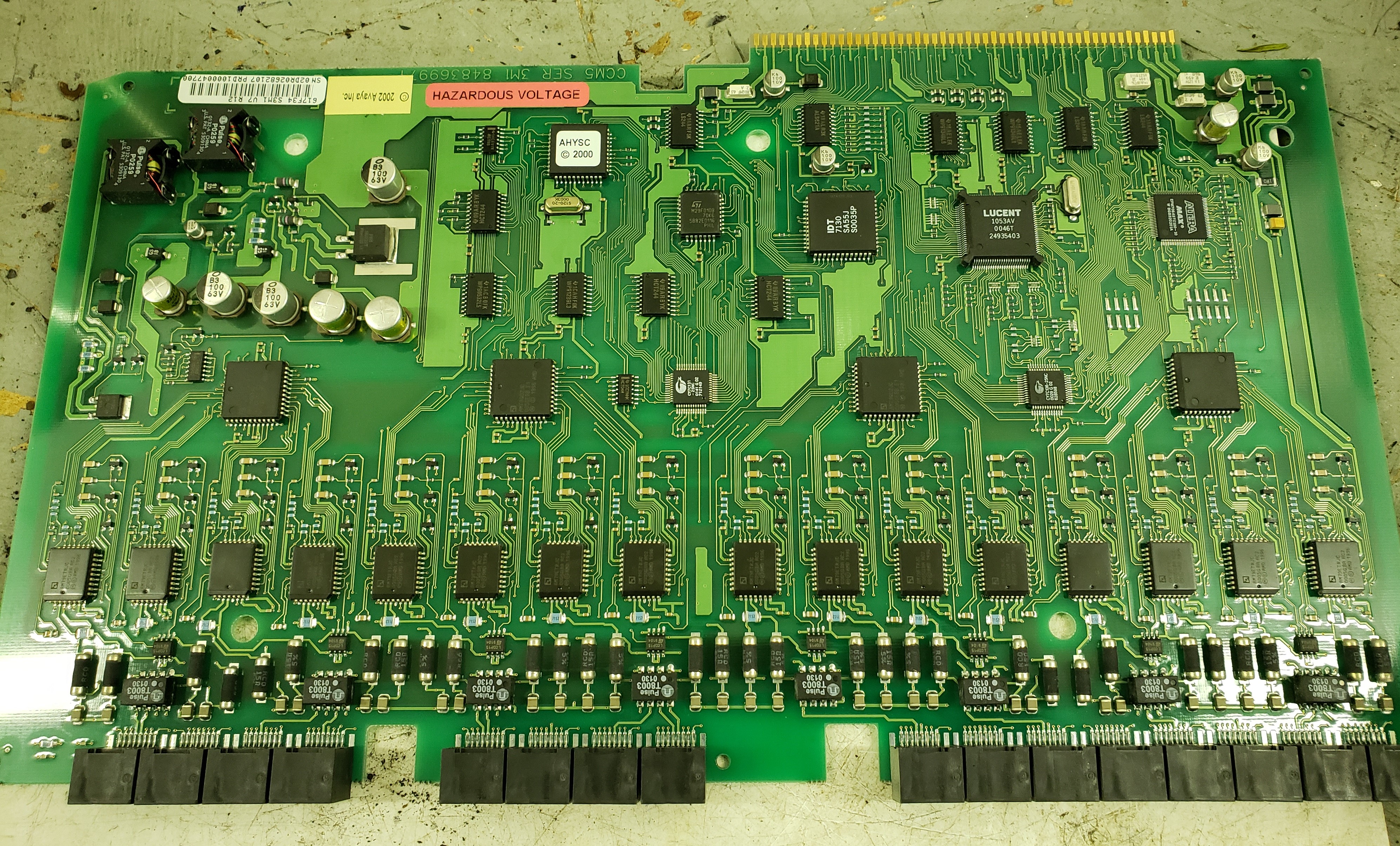

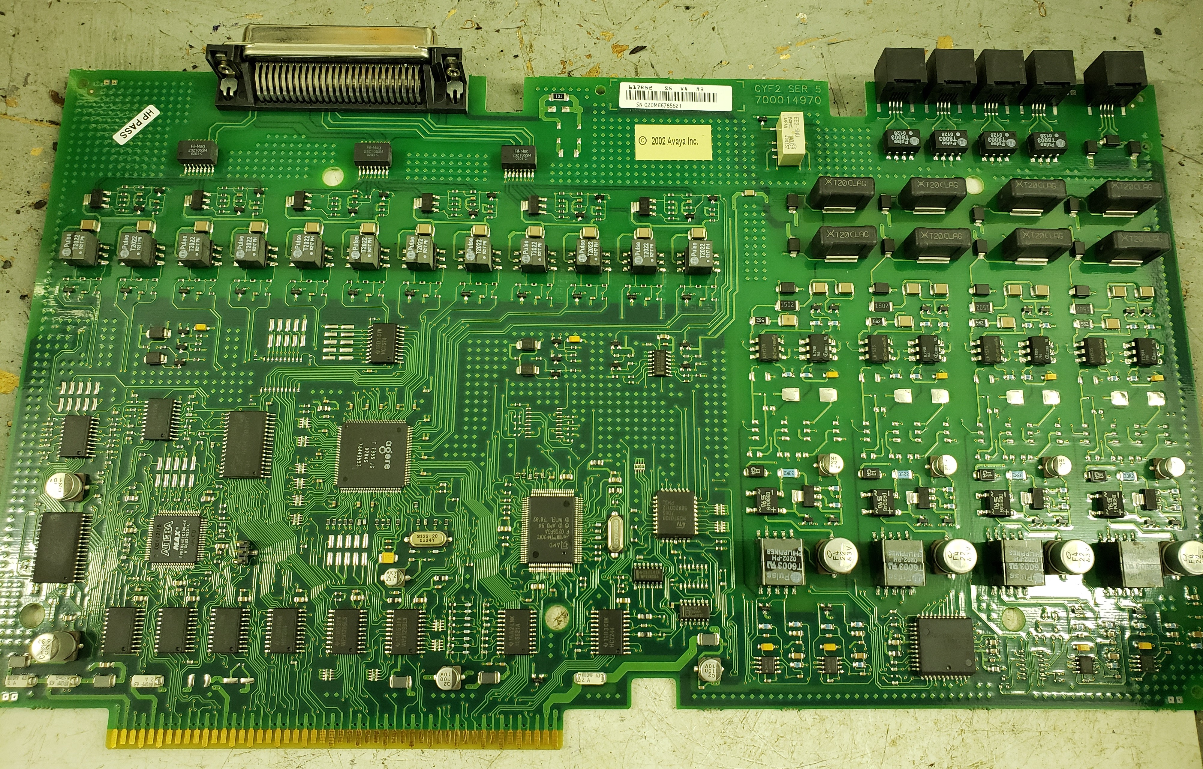

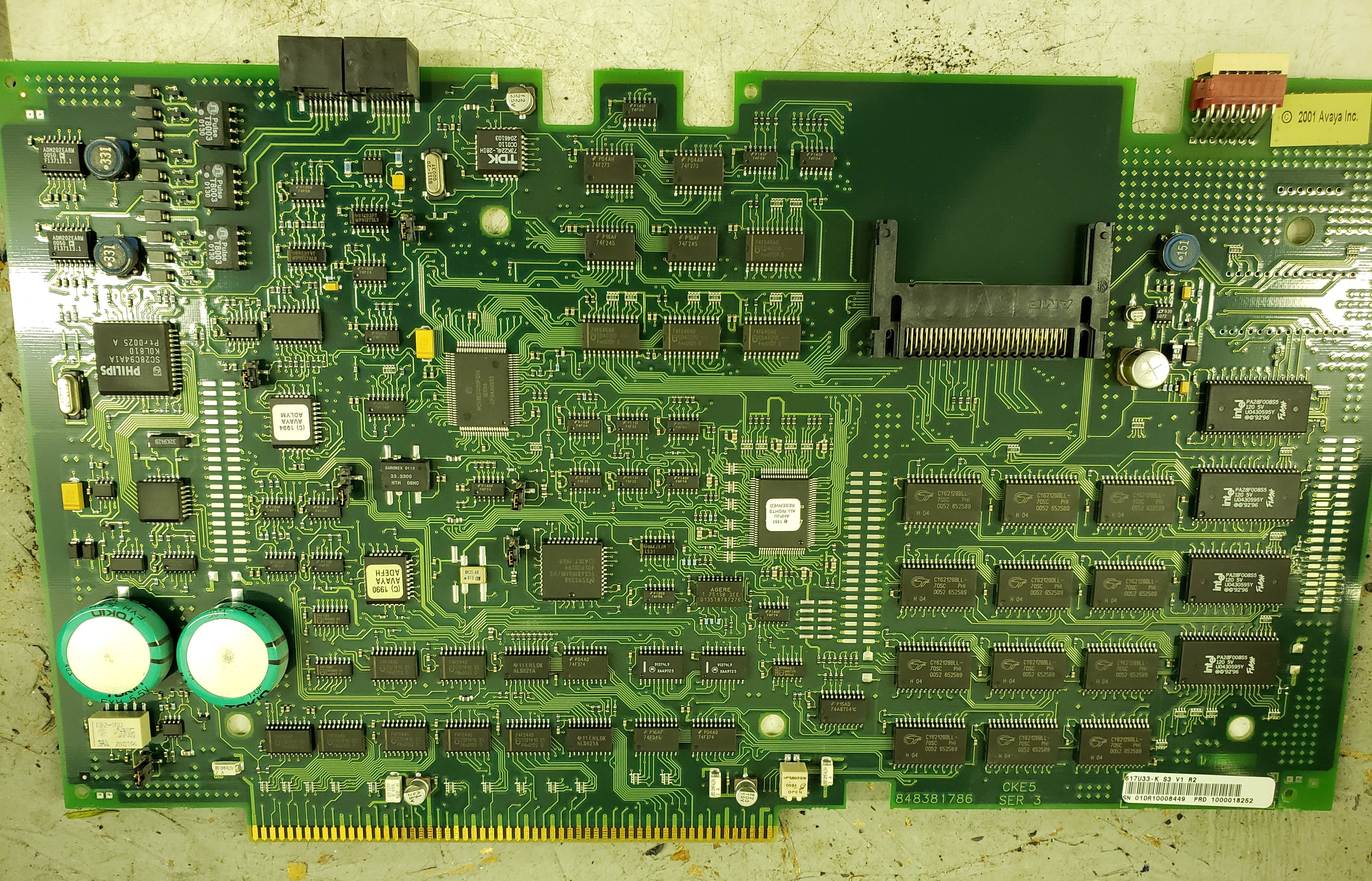

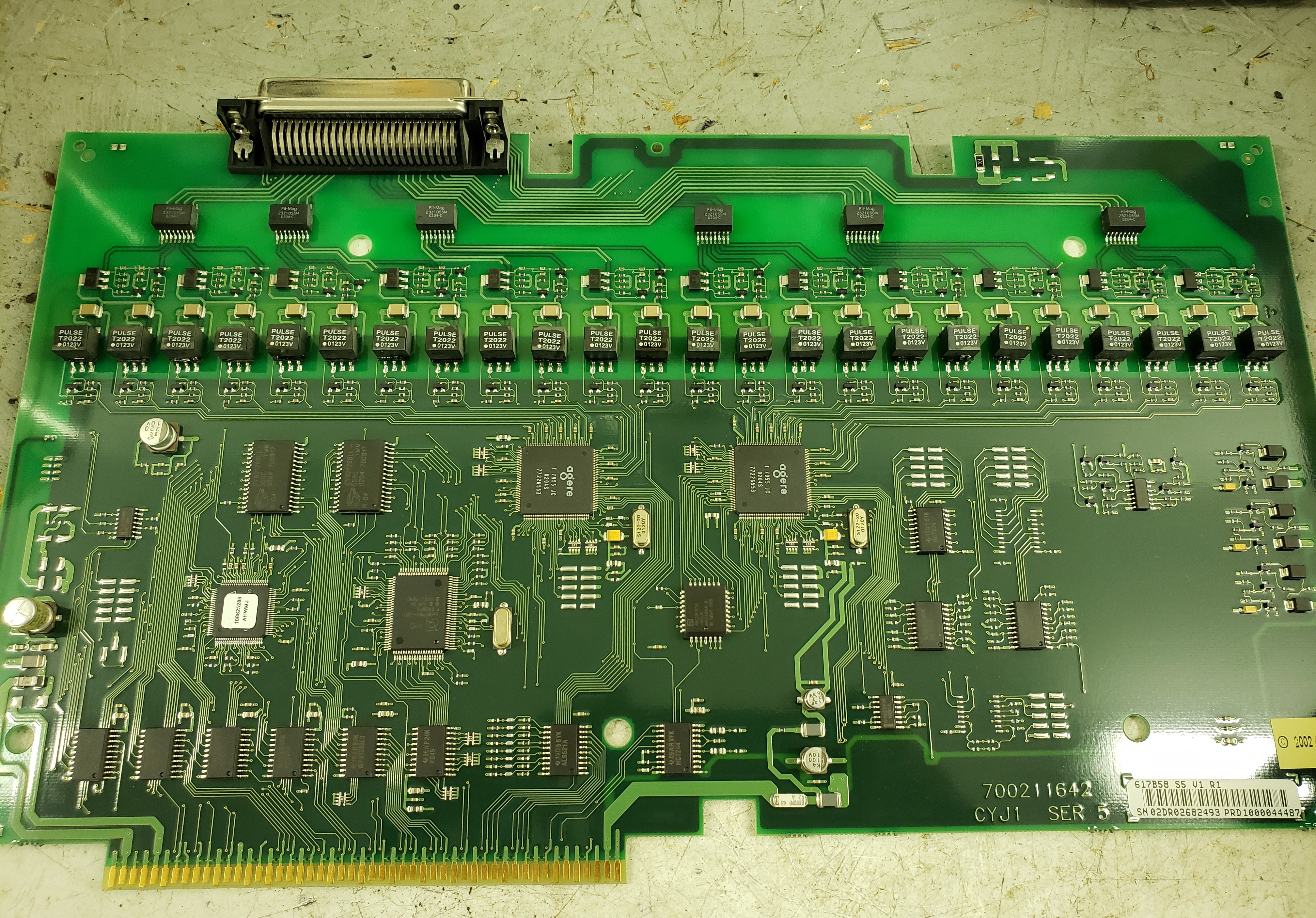

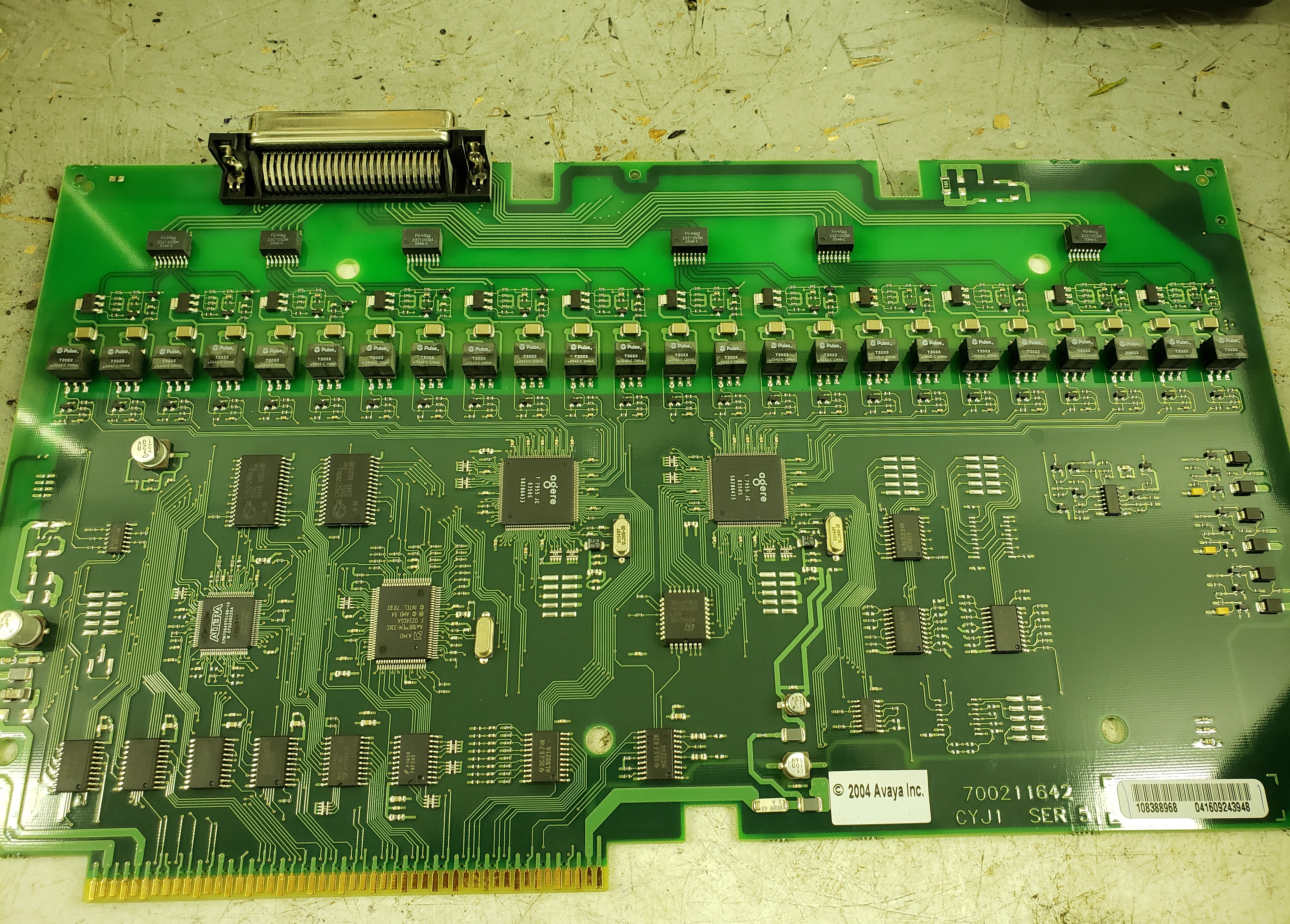

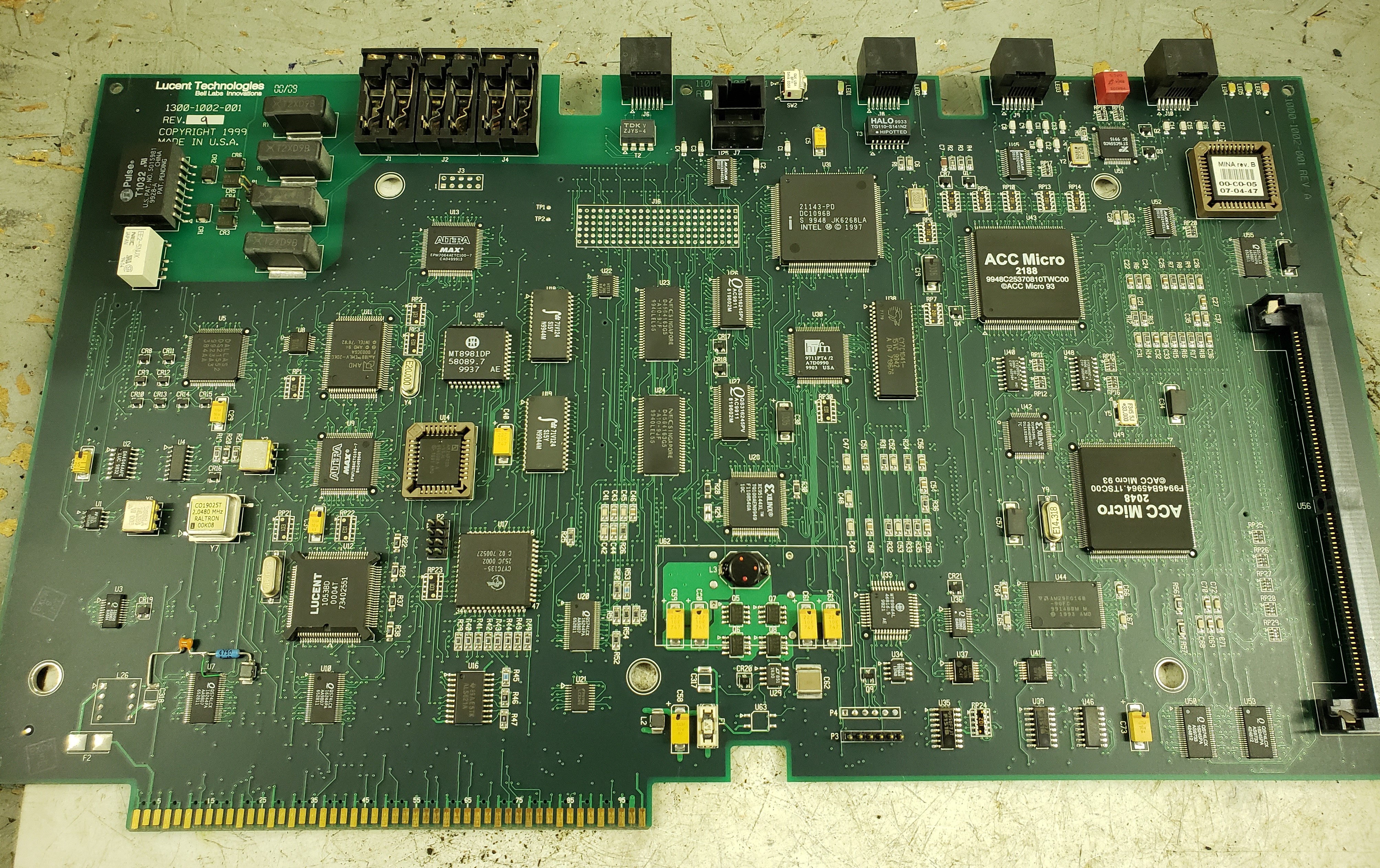

Good afternoon all. The following boards all came out of an Avaya PBX system, most of the boards are from 2001/2002. What would you list them as? telecom high, telecom low, gold finger?
Also anything else that should come off any of the boards? Thanks!

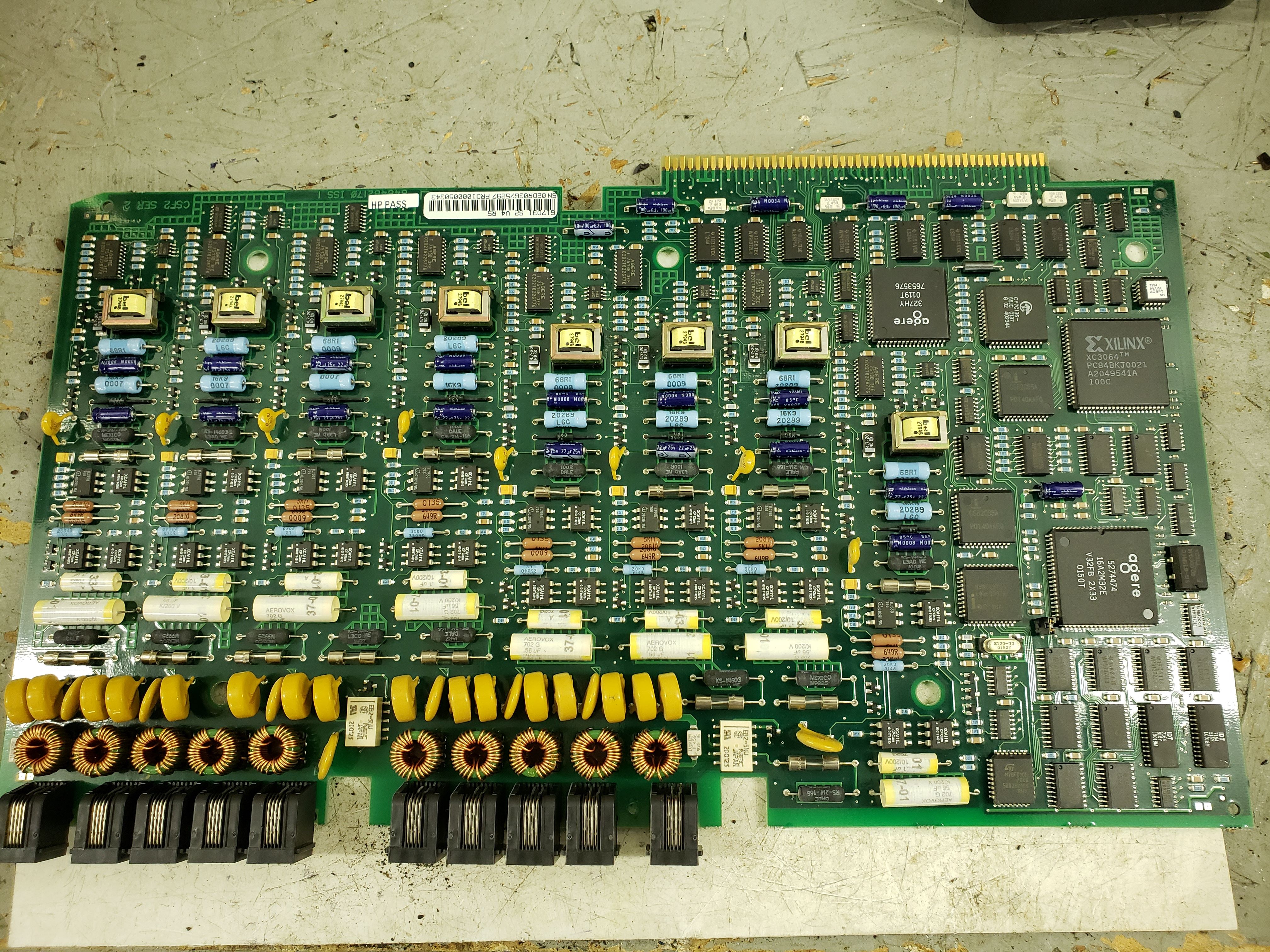

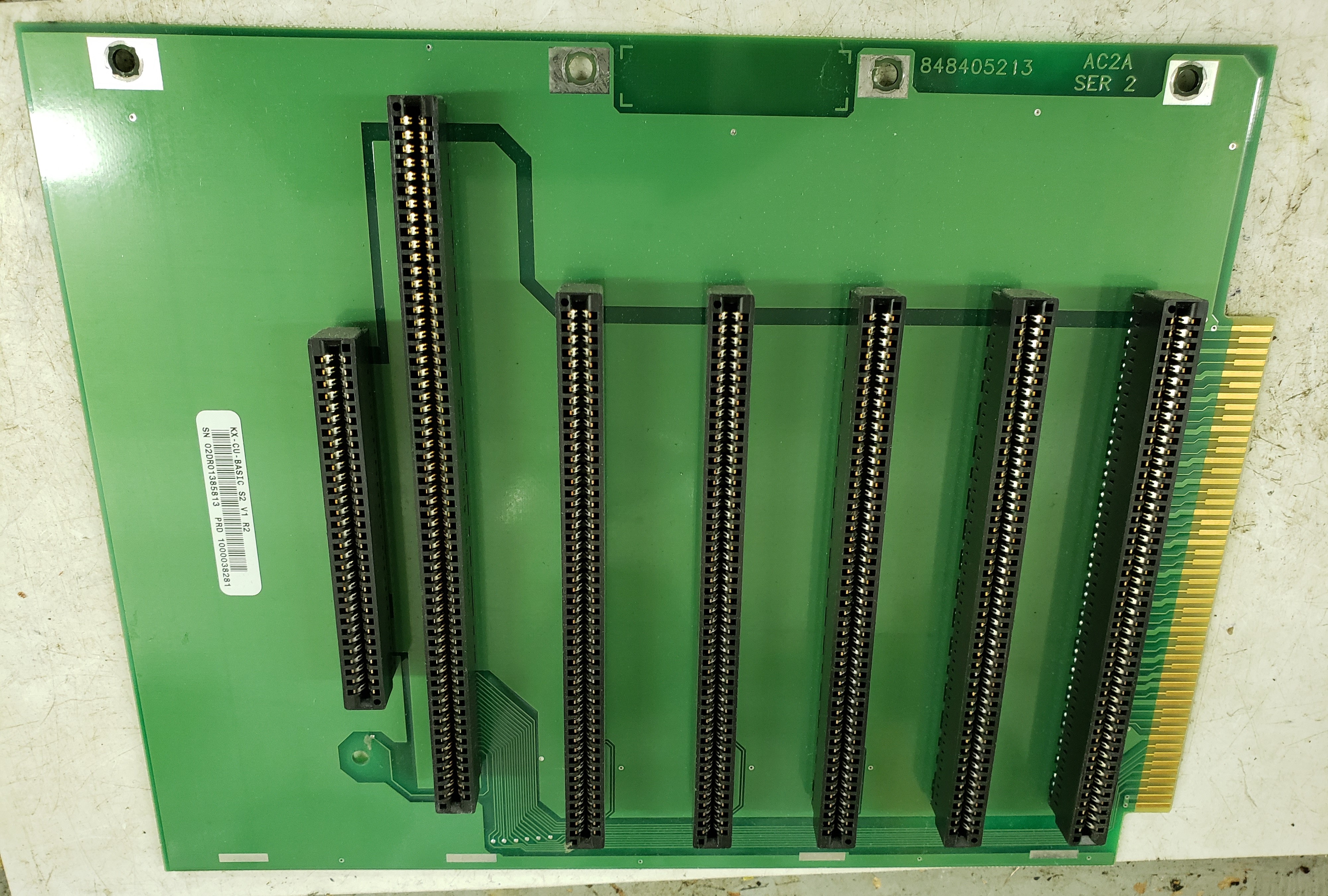

In my opinion, most of these boards have enough population to go as high grade telecom with the exception of the backplane board. I'm not sure if the backplane board would fall into gold finger board or backplane expansion board (there are a few posts that differ on this as well). Board 2 has me wondering if the amount of transformers and copper windings would bring the class down as well.
If you want to see where my opinion comes from take a look at these past posts.
Backplane with gold fingers graded as backplane: viewtopic.php?f=7&t=21656&p=43483&hilit=Clean+gold+fingers#p43483
Backplane style boards with gold fingers graded as gold finger cards. viewtopic.php?f=4&t=21861&p=44230&hilit=backplane#p44230

Ropemans answer covers most of it.
The boards in the picture with the high population and no transformers, coils or batteries will be high telecom.
That backplane board can go in Finger Card No Bracket.
The transformer/coil board #2 is Low Telecom. Cleaning it wont help, its stuck in this grade.
Remove the two green barrels from board #3 to upgrade it to High telecom.
I forgot to mention those! They are batteries right?
Thanks for the confirmation!

ropeman wrote:
Pretty sure those are chunky capacitors
