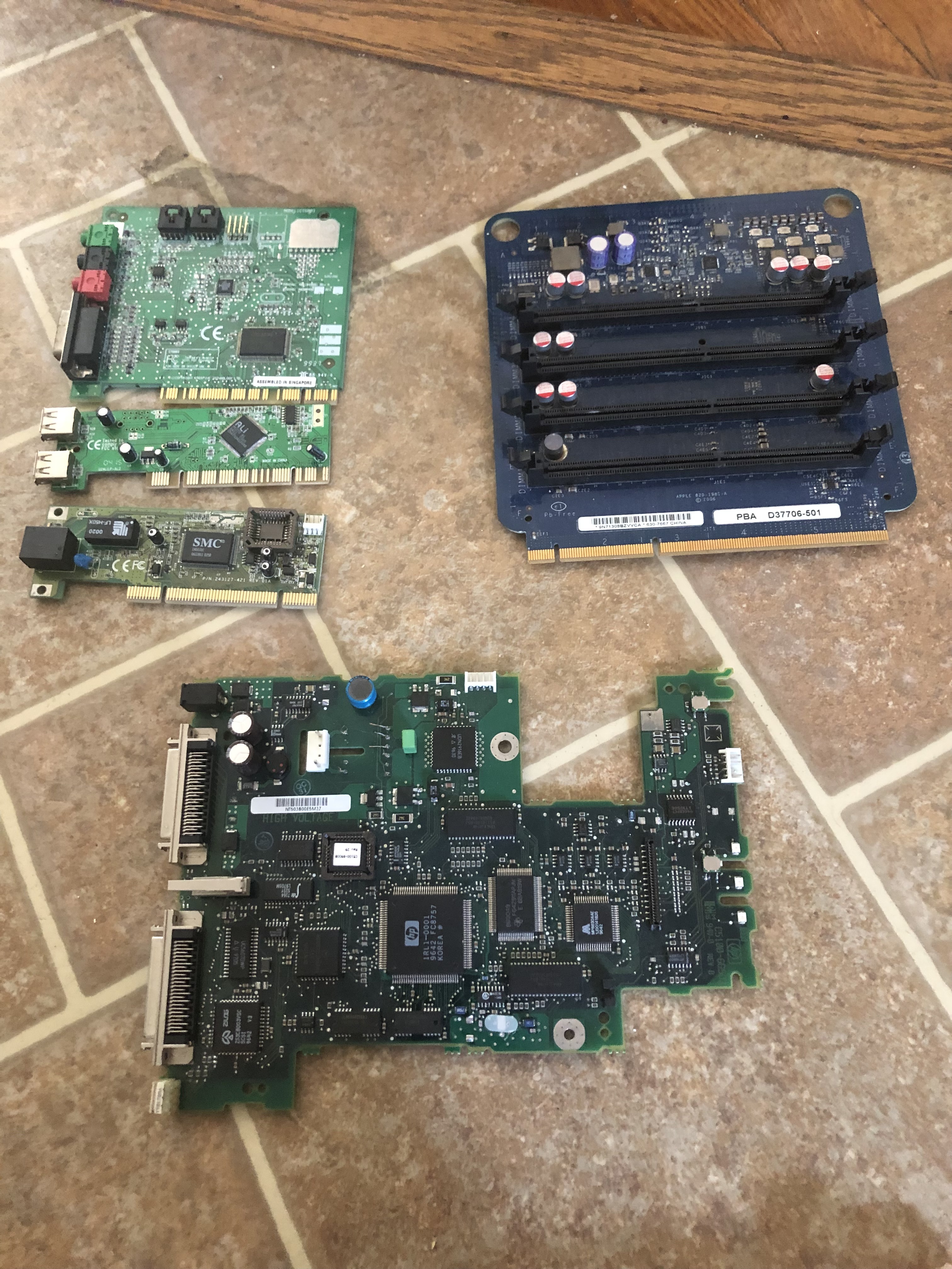

New to this, so I'm going to be posting quite a few boards later for help confirming grades.
My first thought was the left group are high grade finger cards, the right is backplane, and the bottom is high grade peripheral.

1. Gold finger cards
2. Backplane
3. High telecom

If you are going to send #2 in as a backplane board, CUT them fingers off and save them up! It will not deduct any value from the board and will pay off nicely later on. ;)

I have seen before in posts that blackplanes with decent size gold fingers go for gold finger cards.
I agree with that, but most of the gold finger cards I found posts about have a different type of connector or more ICs.
Check this topic for more details.
