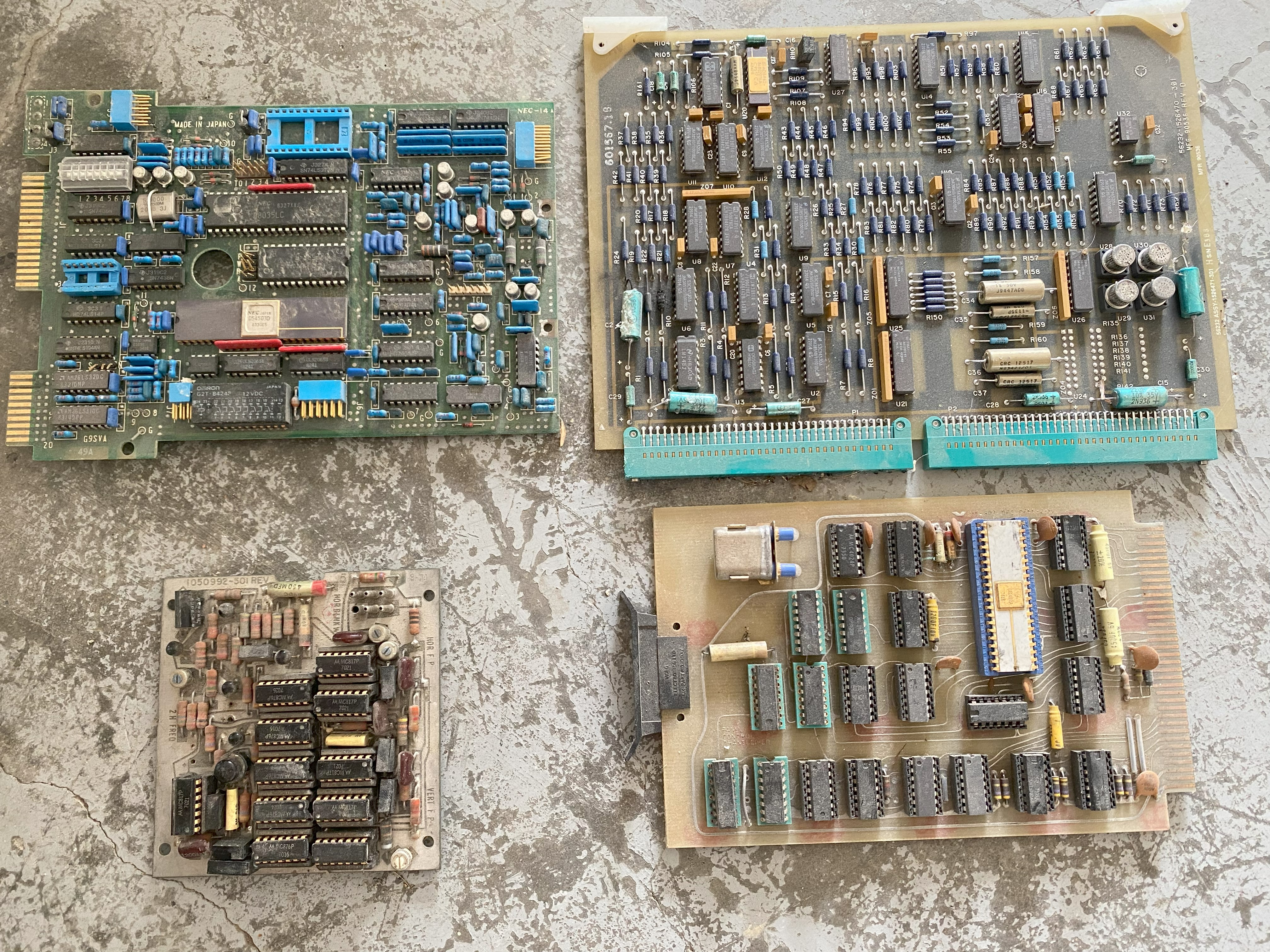

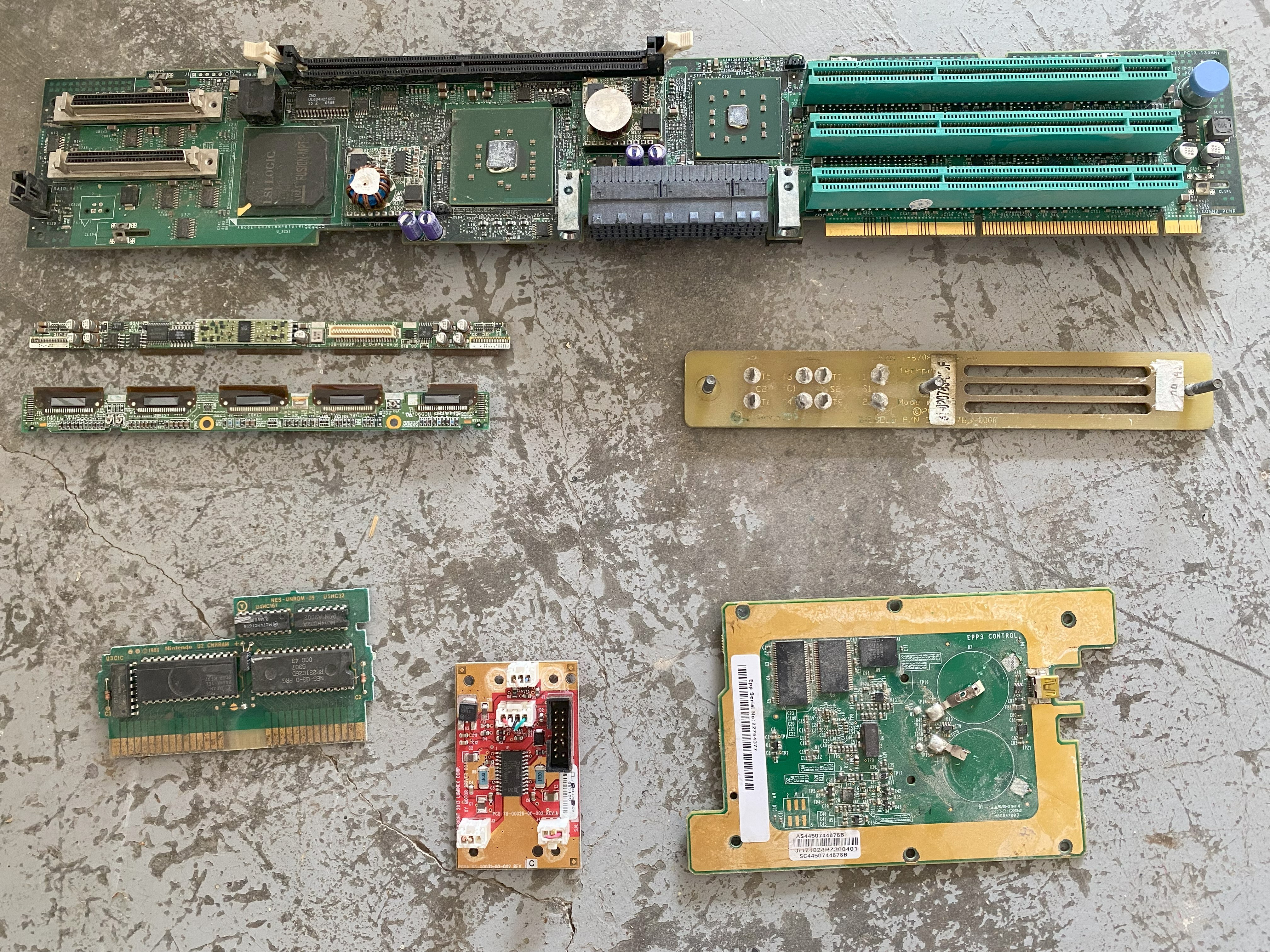

Have quite a few boards I've been saving and now it's time to clean house...
Sets 1/2 Variety of mobo's or similar that I can never remember what the grade is or just want conformation on. Top right is front and back.

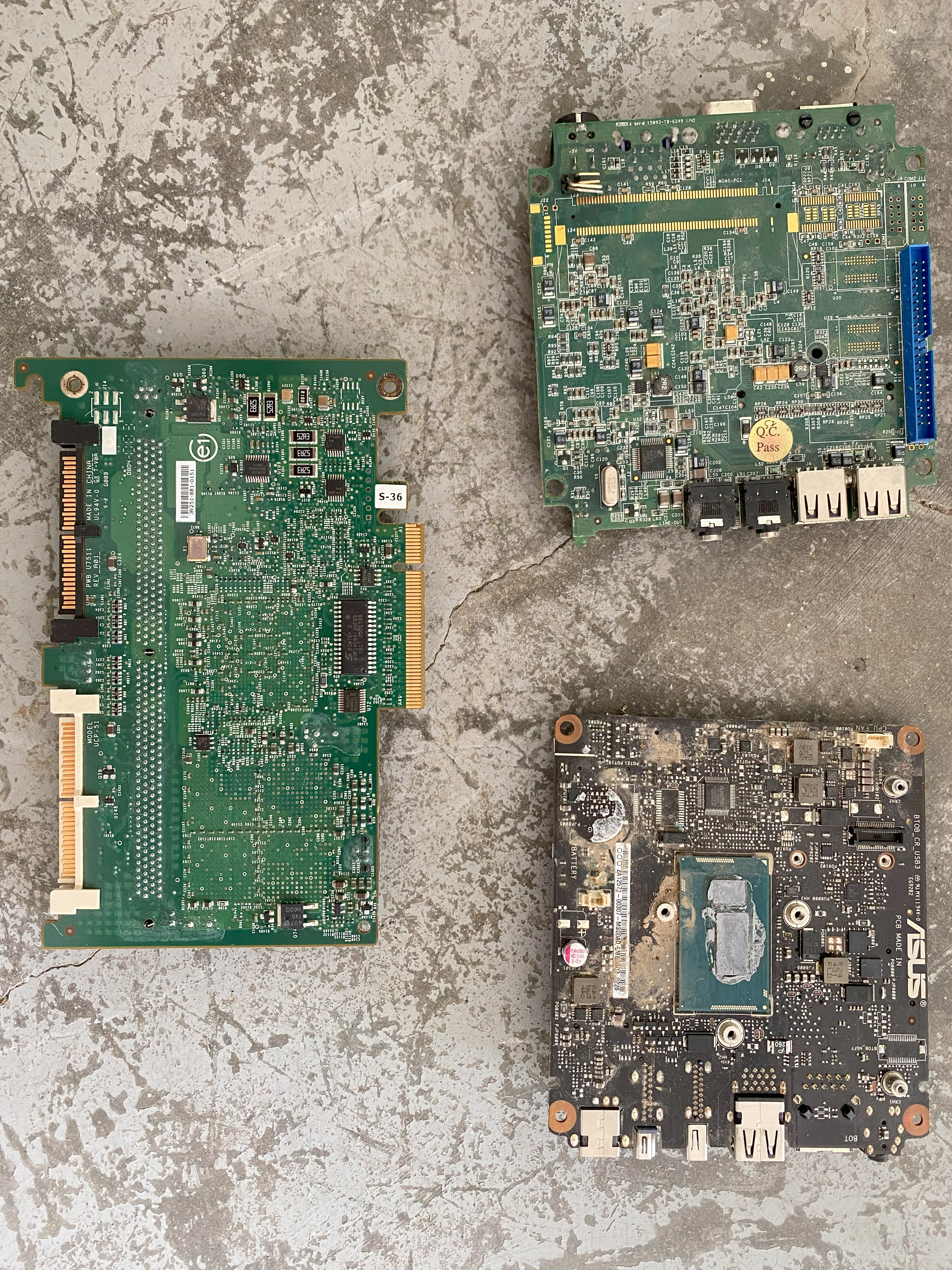

Set 3 Will definitely remove the batteries

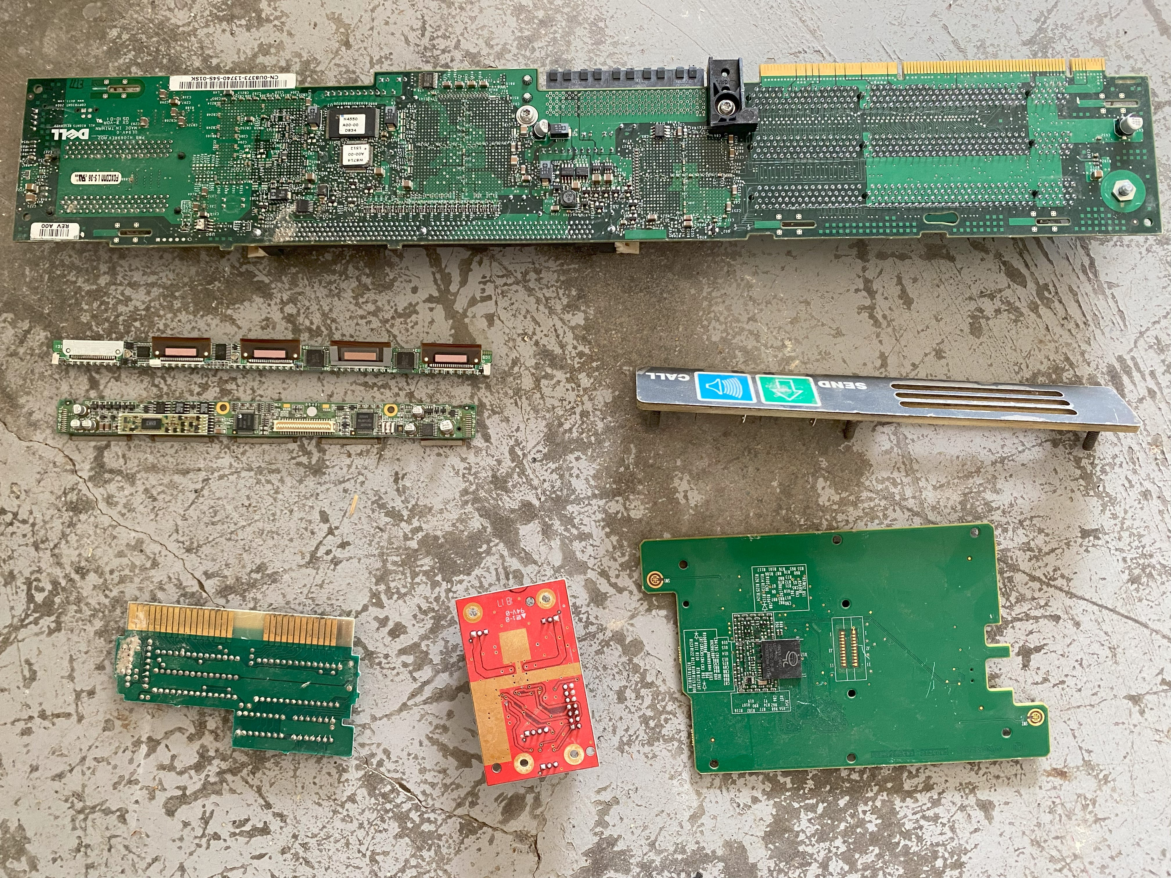

Set 4 The gold components were interesting; not something I had seen before.

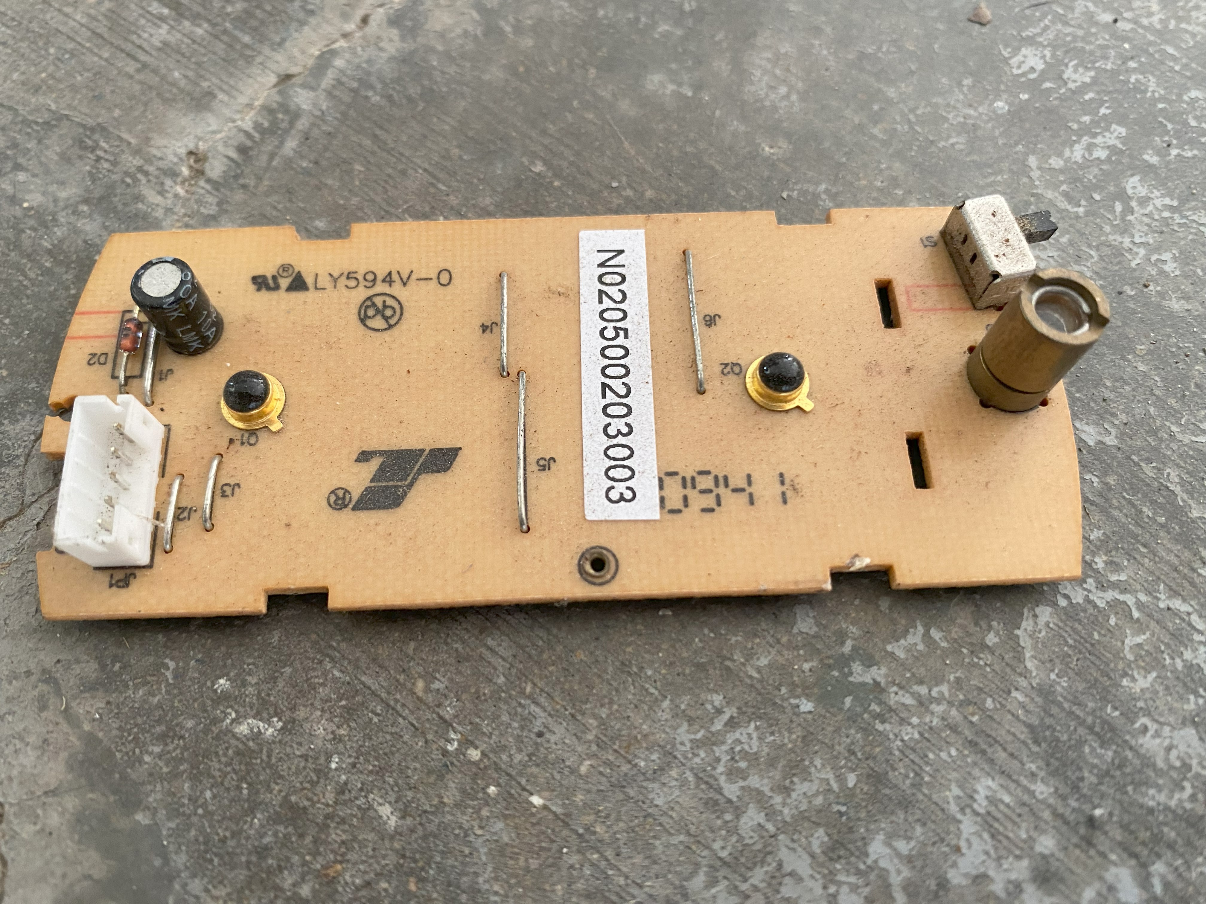

Set 5 Not sure if the gold on those two components are worth enough to do anything for the board

You have been missing for a while! I haven't responded because I struggle with classifying these types of boards as well. Would the top right two boards in set 1 and the left board in set 2 be GFCs?

Yeah, a few different things outside of sorting boards have taken a higher priority and I haven't spent as much time checking the forum. But I need to get through a small pile so I'm trying to check in and help a little while I wait for opinions.
Those GFC probable ones I think have had a slight chance for high telco depending on the particular board so I've kept them set aside. May have to email Lost or Chris to see what they think.

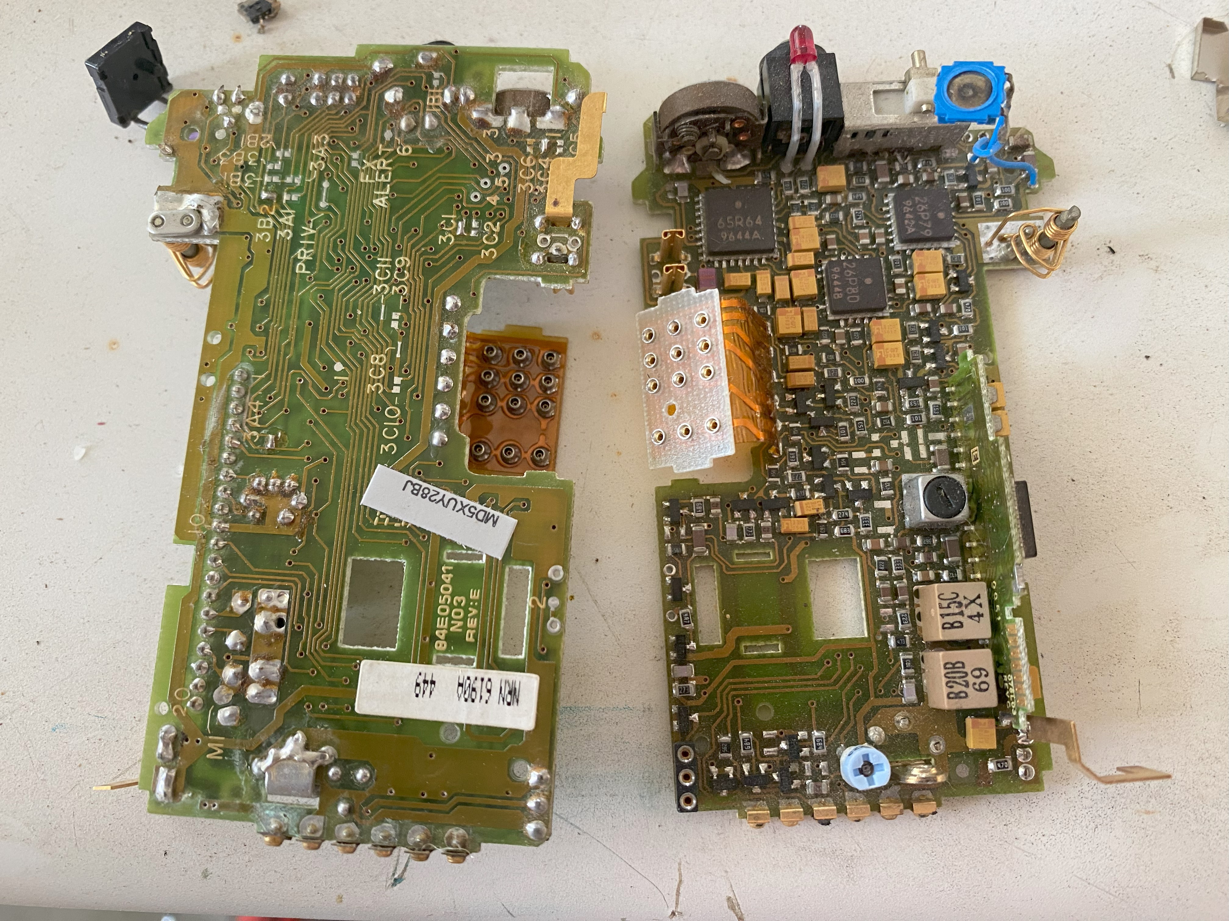

Set 10: walkie talkie boards

1 Top 3 are high peripheral
Bottom 2 small socket motherboard
2 Left gold finger card
Right high peripheral
3 High peripheral
4 The small one is safely low peripheral. The large one is probably high peripheral. That age range the back mask is probably tin. —
5 the brown board, Chris buys this little bare components loose. The rate is higher than low grade so on something like this your best remove the two tiny pieces and send them alone. The board as is is midgrade.

10 low peripheral
