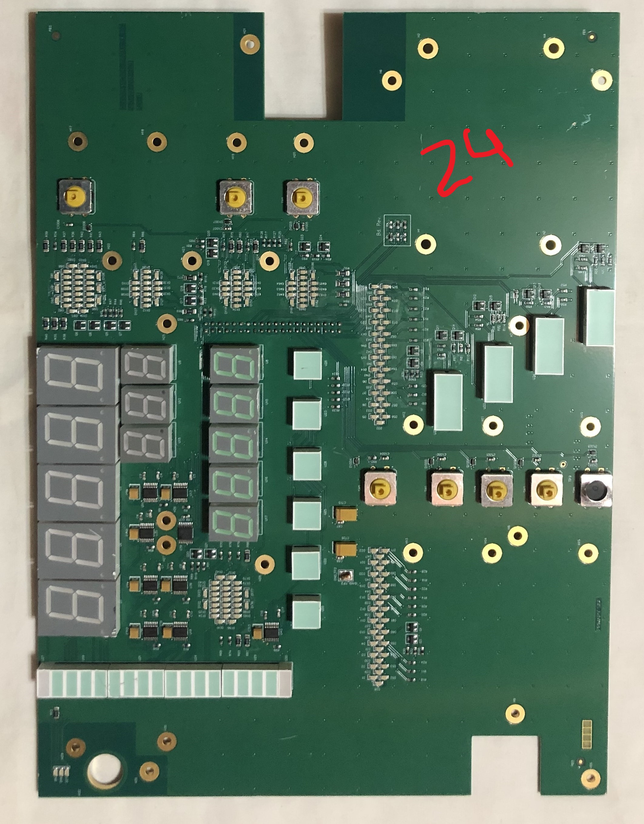

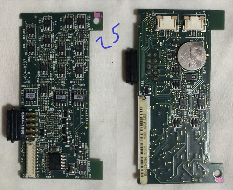

Hi, I'm new to this and would really appreciate some grading help.

FYI, it's best to limit threads to 10 boards and post multiple threads instead.
1. Gold cap chip board

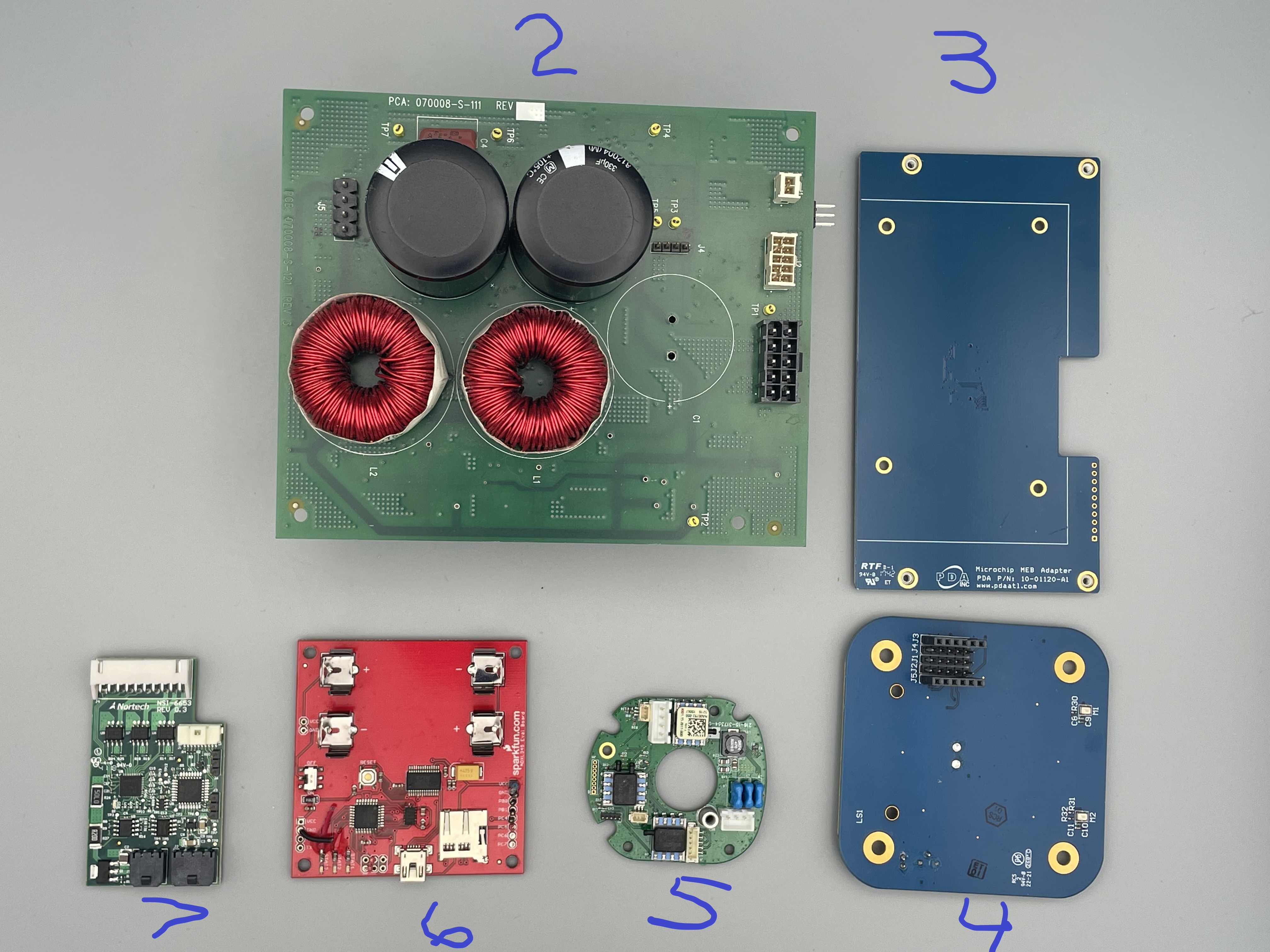

2. Low grade
3 and 4 Not entirely sure about blank boards with ENIG, either midgrade and low peripheral.

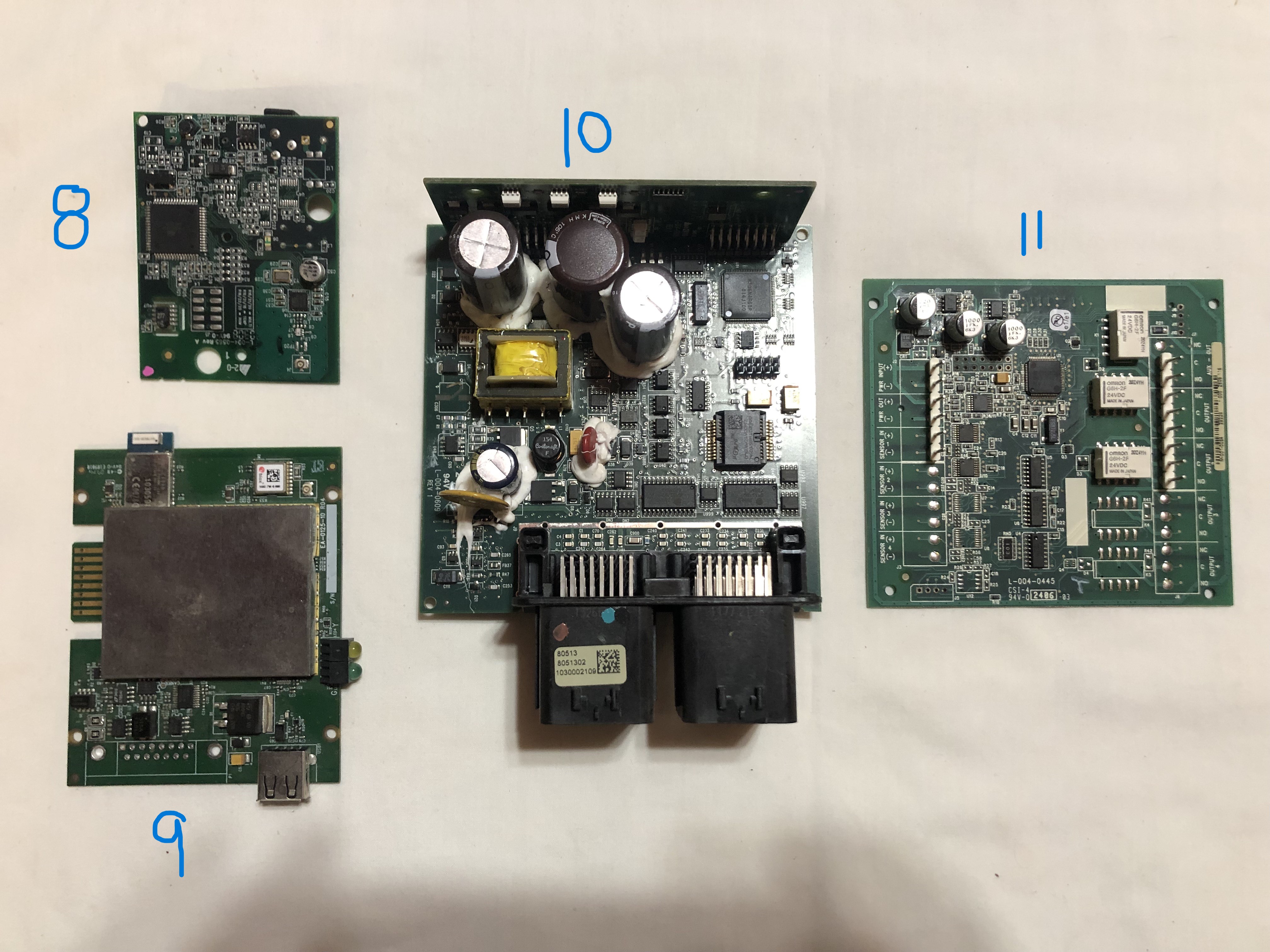

5. High peripheral
6. Low peripheral
7. High telecom
8. High peripheral
9. Low grade gold finger card as is, remove the metal shield for gold finger card no bracket grade
10. High peripheral if you remove the big capacitors and transformer
11. High peripheral

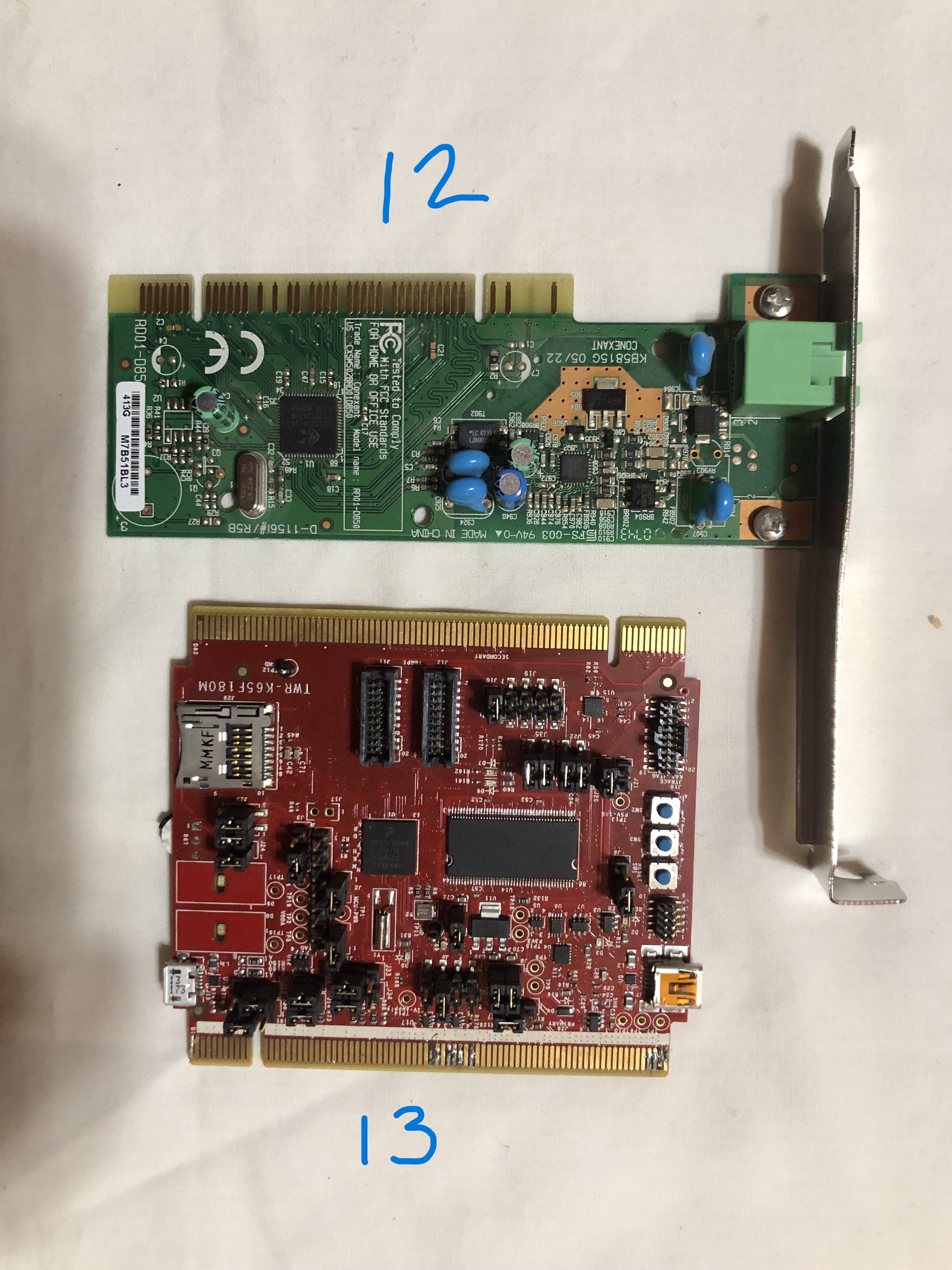

12. Gold finger card with bracket
13. Clean gold finger card

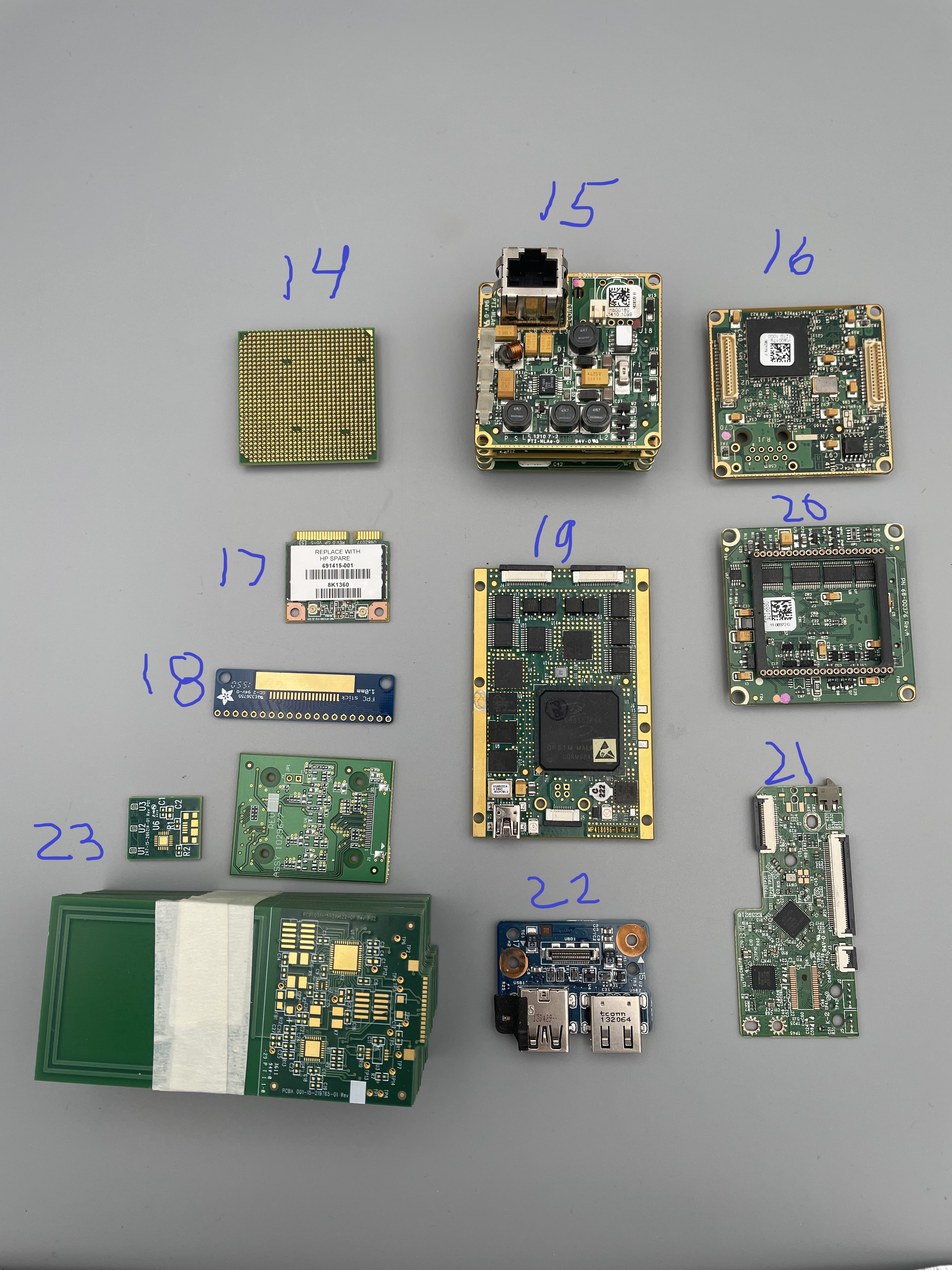

14. Green fiber CPU (depends on if it has a metal heatspreader or not)
15. Low peripheral if there's nothing of value on the other side
16. High peripheral
17. Clean gold finger card (I'd remove the sticker)
18. Not sure
19. High telecom
20. High peripheral
21. High peripheral or maybe CD-ROM board?
22. Connector end
23. Not sure
24. Midgrade? Maybe low peripheral?
25. High telecom, remove the battery
 Post subject: Re: Grading Help
PostPosted: Mon Feb 12, 2024 8:53 am
Posts: 557
Remove the battery on board 25, always remove batteries! it is the round, silver puck on the back.
