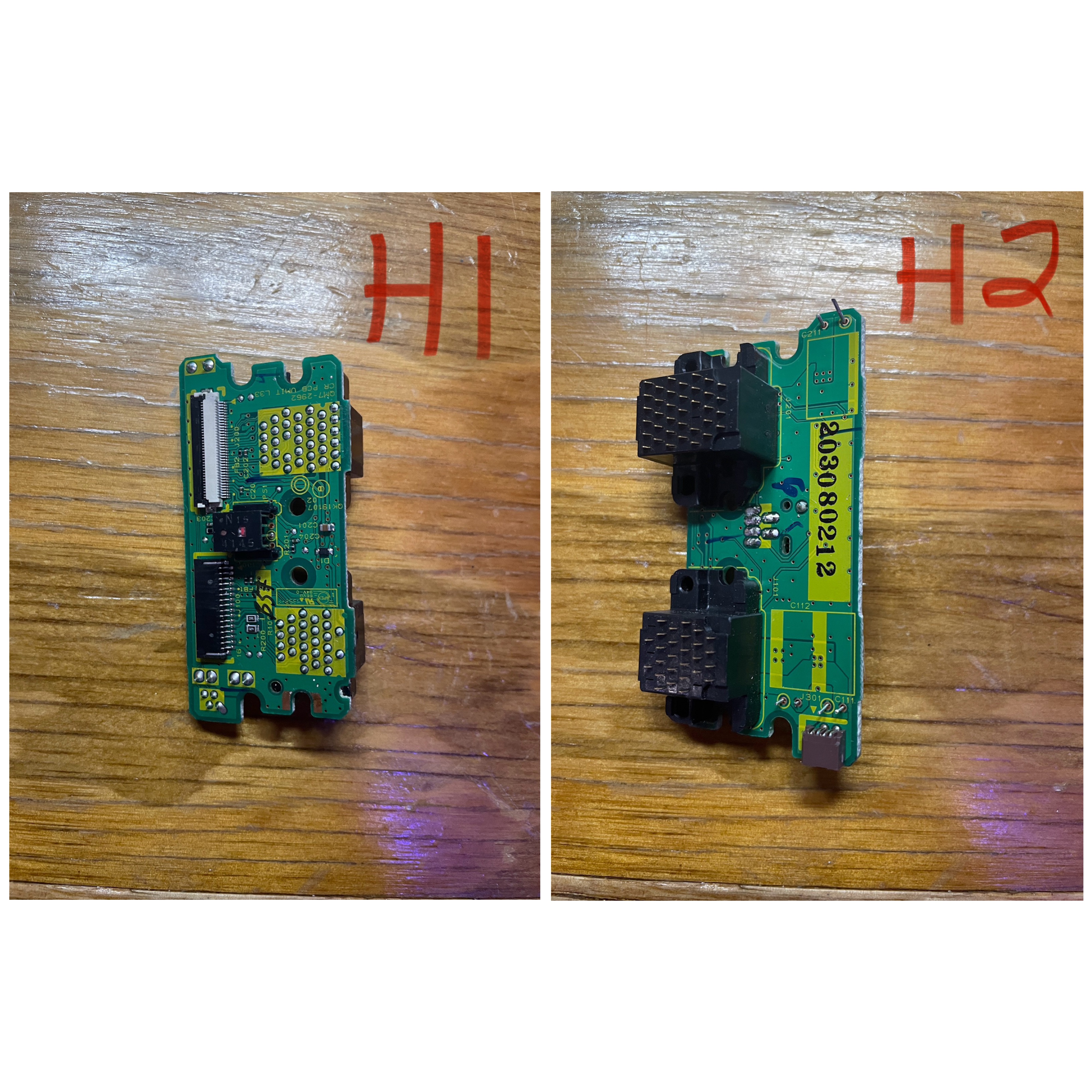

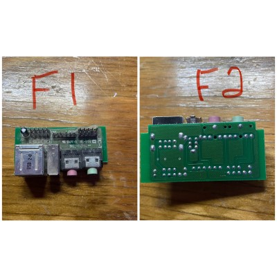

I need some help classifying these boards

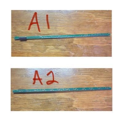

A1/A2 - low peripheral to me if that is visible gold.

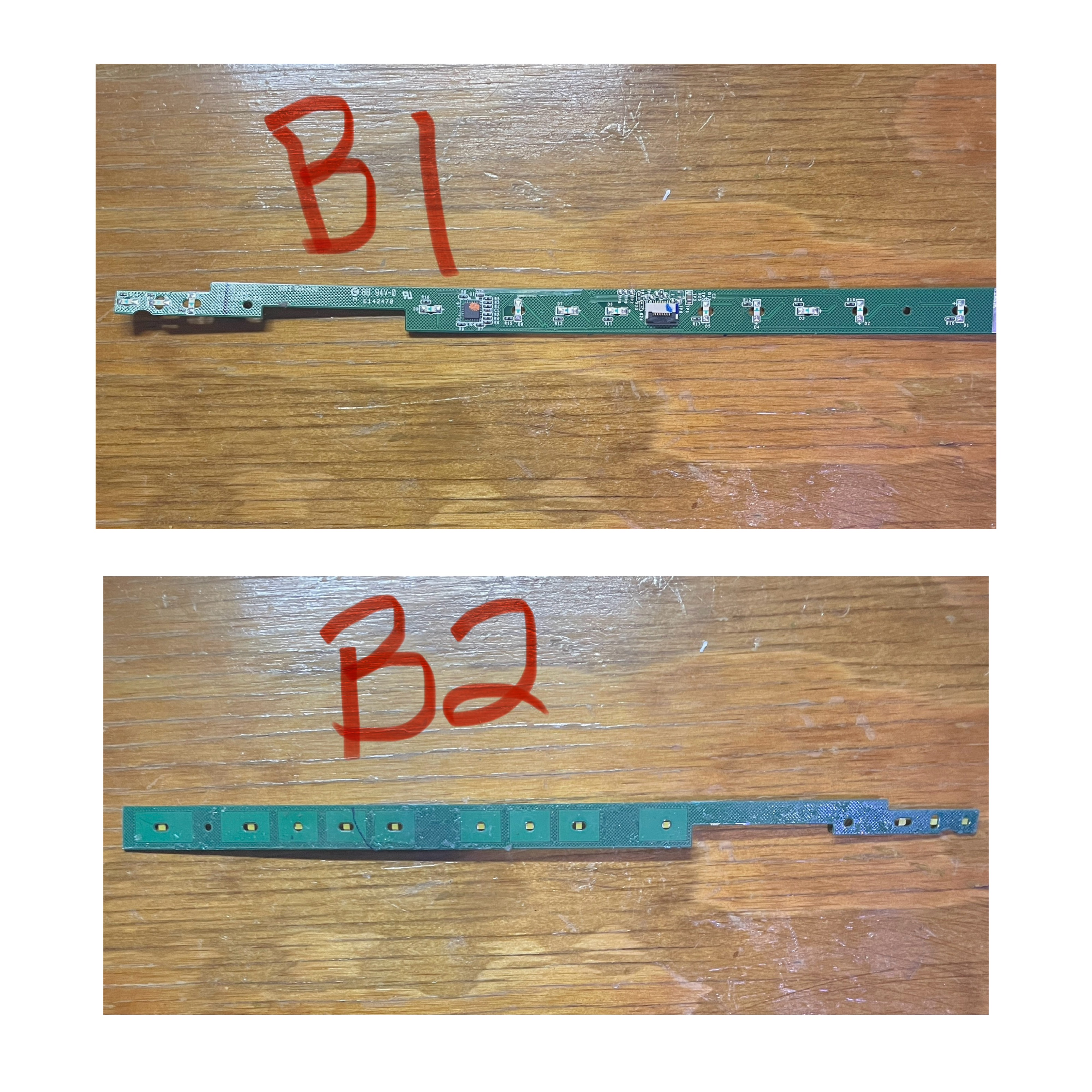

B1/B2 - low peripheral to me if that is visible gold and a square chip.

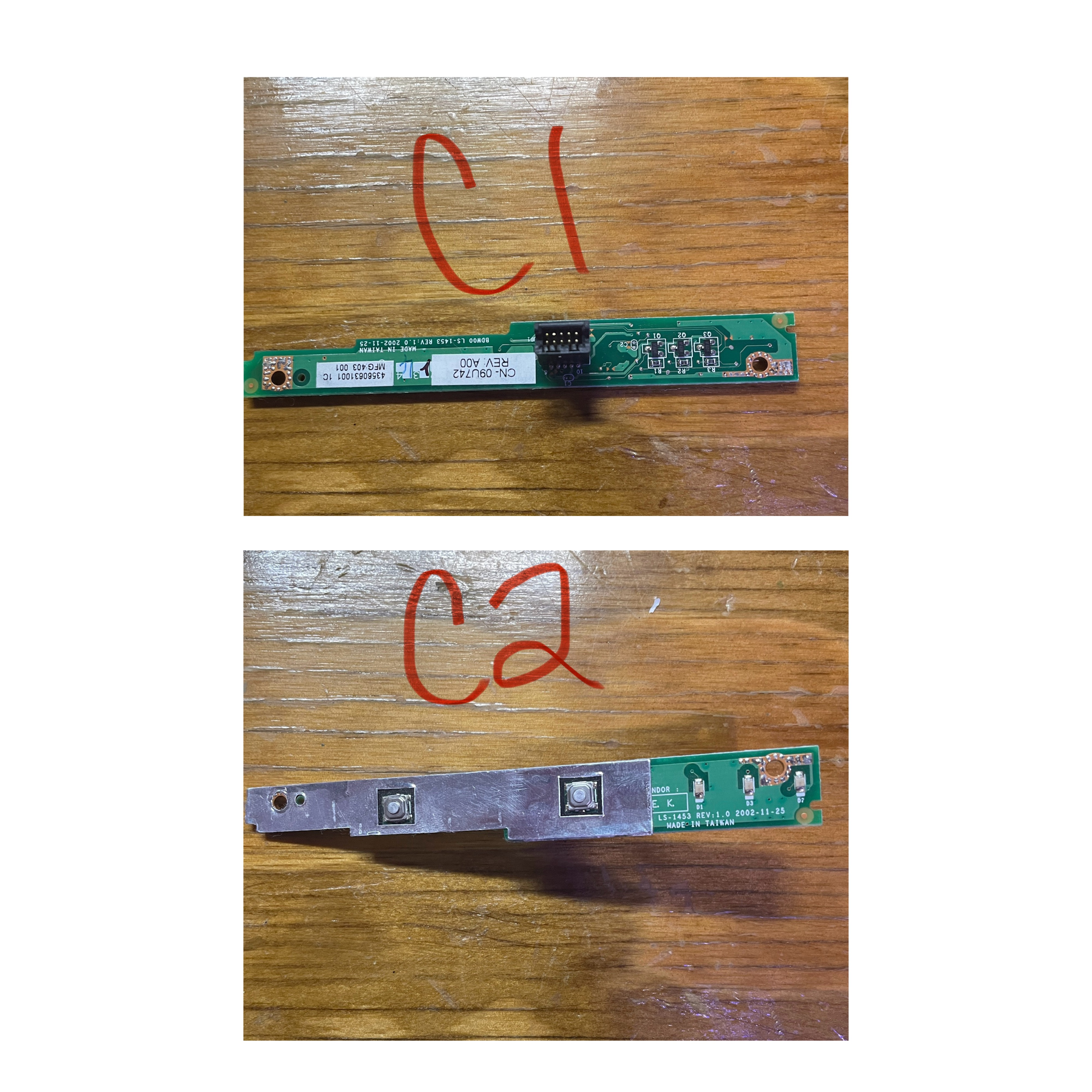

C1/C2 - low peripheral to me if those are gold pins.

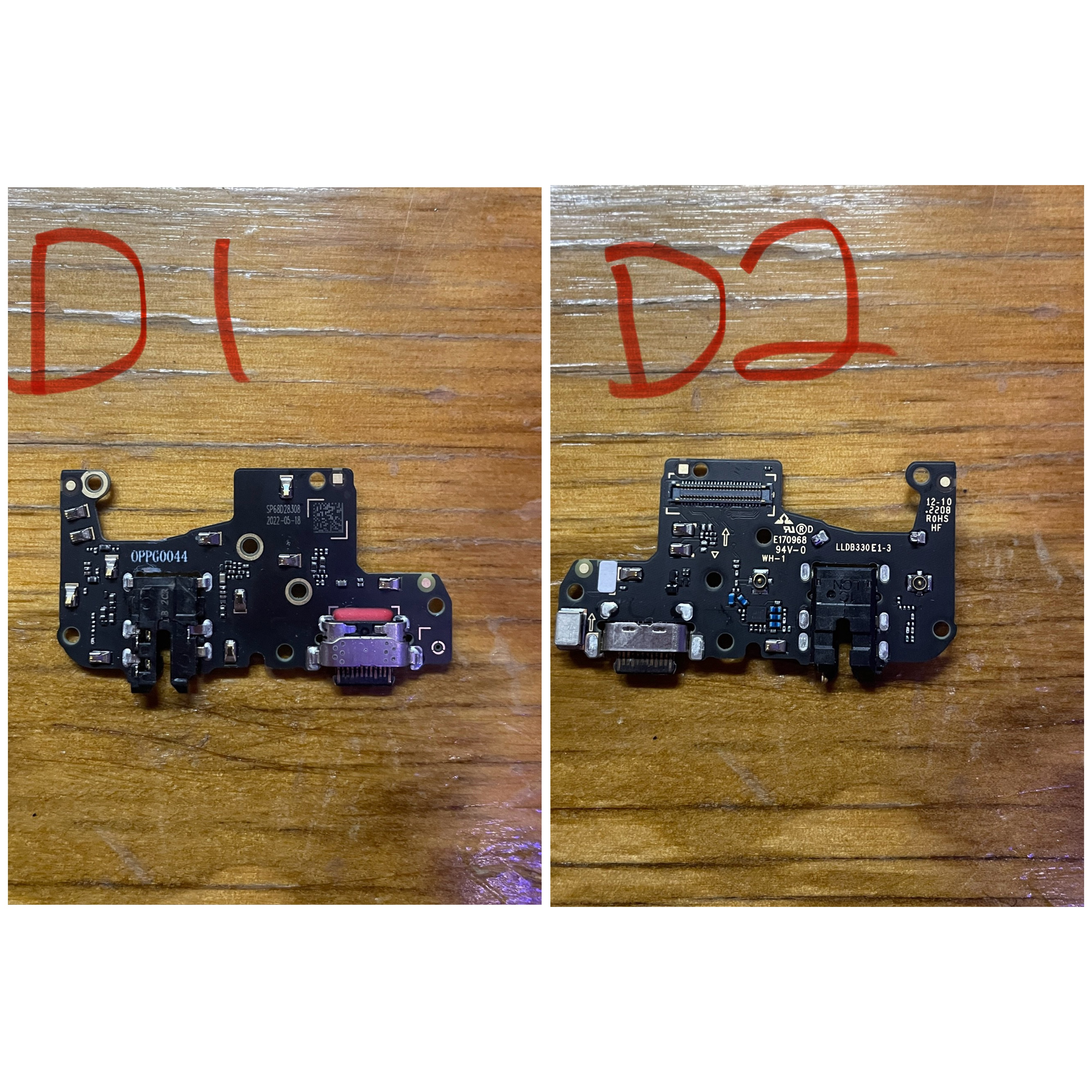

D1/D2 - mid grade unless there is some gold that I cannot see from the picture.

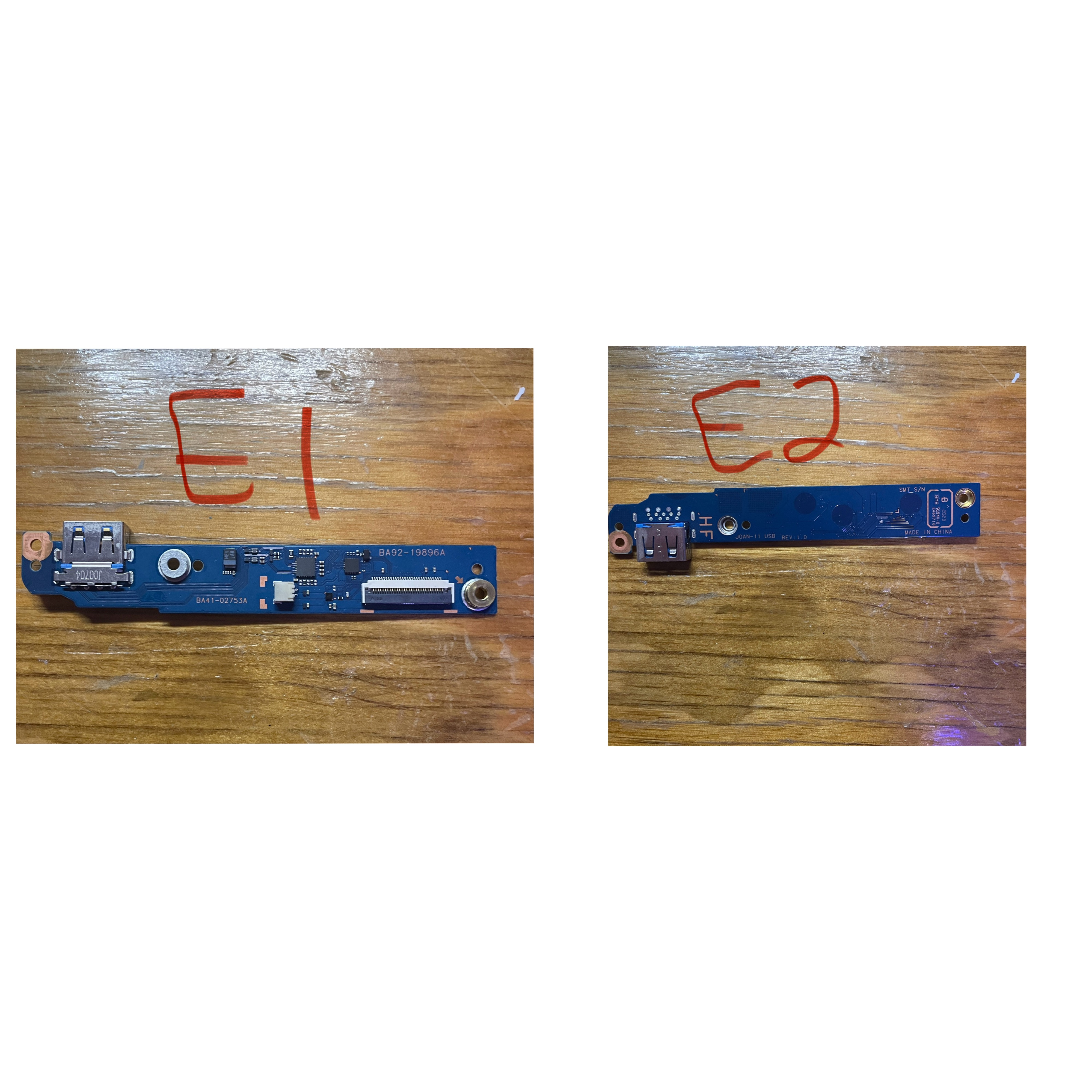

E1/E2 - low peripheral if that is visible gold on the connectors.
F1/F2 - mid grade unless there is gold pins in any of those connectors.

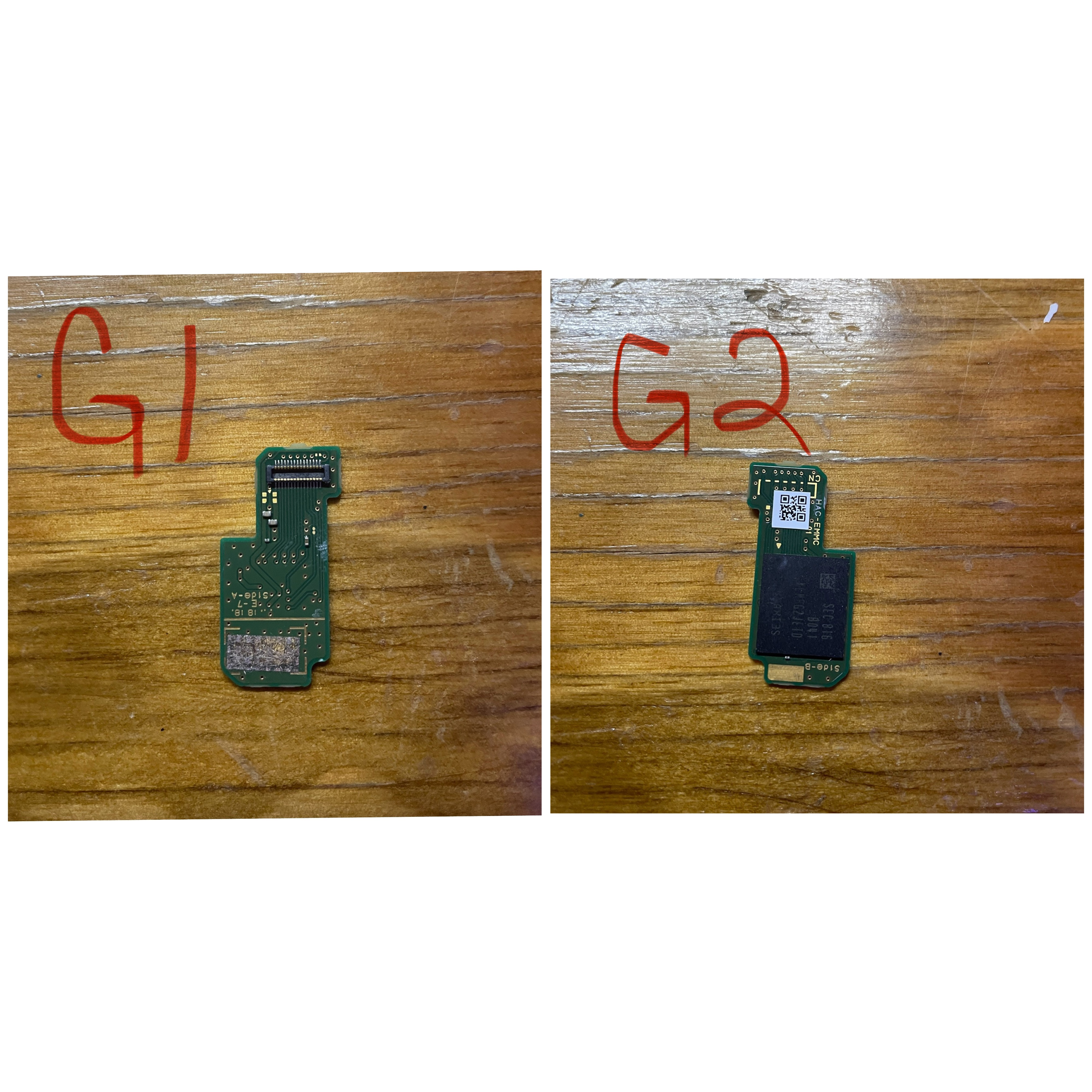

G1/G2 - high peripheral due to the gold content and if that is a removable black shield you'd want to remove to confirm the grading.
H1/H2 - looks to be from a printer. I put my most recent one in low peripheral but unless told otherwise that is where I would grade that one.

A: is from a scanner, if all the gold wires are intact this should be able to clear high peripheral. I pull the wires off these currently and the boards end up in low peripheral.
B: is probably borderline low peripheral, until I looked at the full size I thought midgrade
C: midgrade
D: likely has plenty of gold, lighting isn't great. The connector looks to be a magnet variety, if you can remove what is probably 4 magnets from around it, I'm thinking low peripheral.
E: agree, two little chips and gold pins
F: low peripheral
G: that black shield, is entirely chip. At least high peripheral, but I'd likely throw in low Telco.
H: the wire connectors look to have no gold. Depending on exactly how much gold is on the cartridge contacts it's either midgrade or low peripheral. I'm leaning midgrade.
