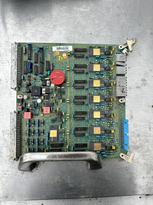

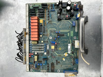

5226 - You would need to remove the ribbon wire. Cut the black wires down more. Lastly, I would remove the black heat sinks. I believe this is telcom grade. Not sure if low or high as I never came across any telcom boards personally.

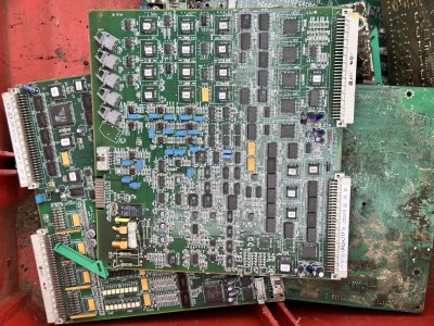

5219 - seems to be a picture of all the boards.

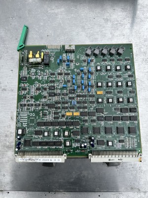

5233 - at least remove the 2 plastic arms on the right side of the board in the corners. Possibly low telcom.
5234 - remove the green plastic arm in the top left of the board. Looks to be high telcom.

5226: the black wires are on removable wire terminals, just pull out, can cut or unscrew later. Agree on other points. The gold cap chip would make this a gold cap chip board after the test of that is done.
5233: with all the gold cap chips, leave it as is. Gold cap chip board
5234: very easy high Telco. Plastic pull can stay in this case if it's not readily removable.
