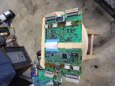

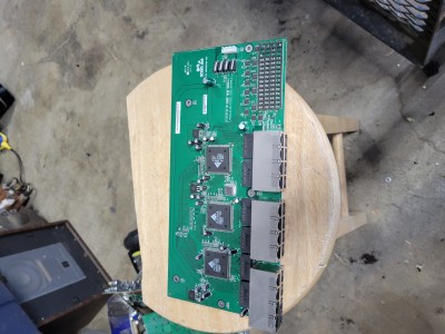

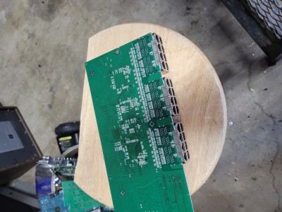

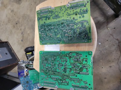

I am new to sorting boards. Right now I have an E-Scrap facility near me that just takes all Green board without Transformers at $1 lb. Beleive I can get more here. I have watched the Videos from both board sorts and Shark Scrapper. Still having problems with these 2. Any Help would be greatly appreciated. I believe them both to be High Grade Peripheral. But hey I am new. :)

Yes printer is usually high peripheral. The network card is definitely telecom. A good amount of IC’s right behind ports and it has quite a few ports.
