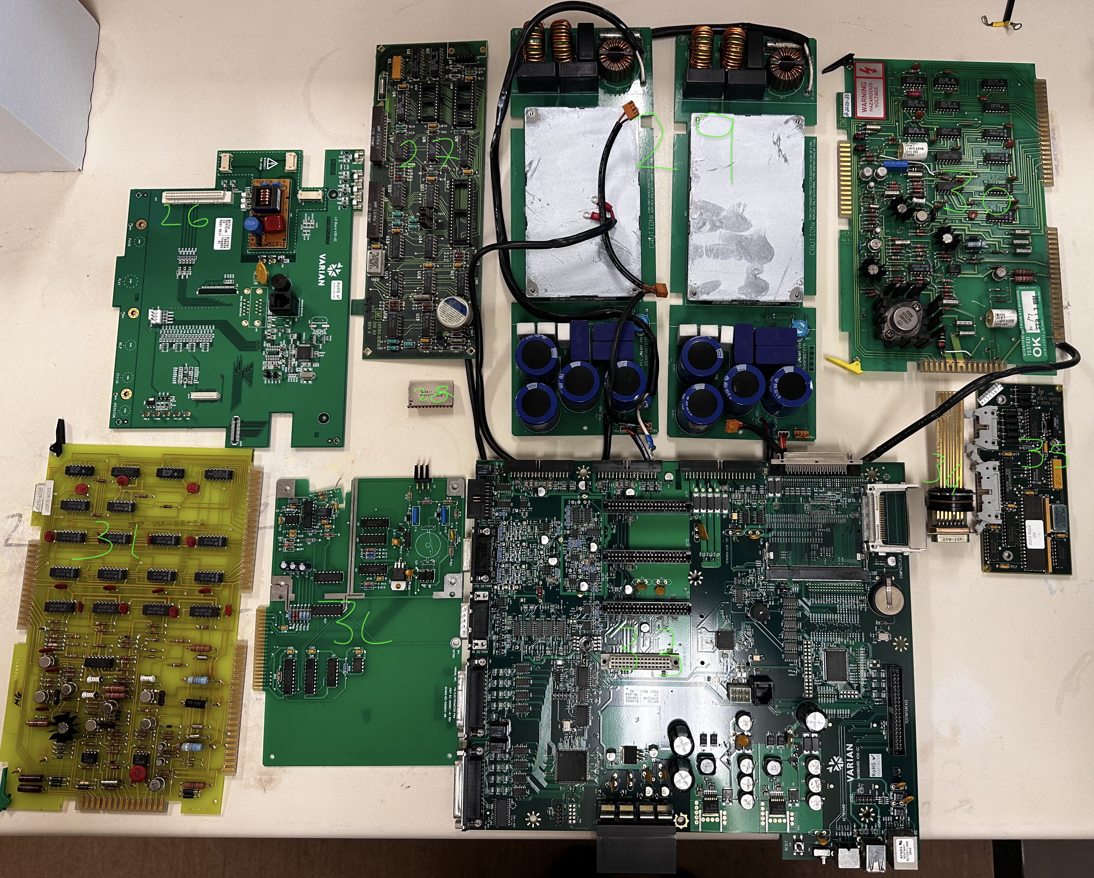

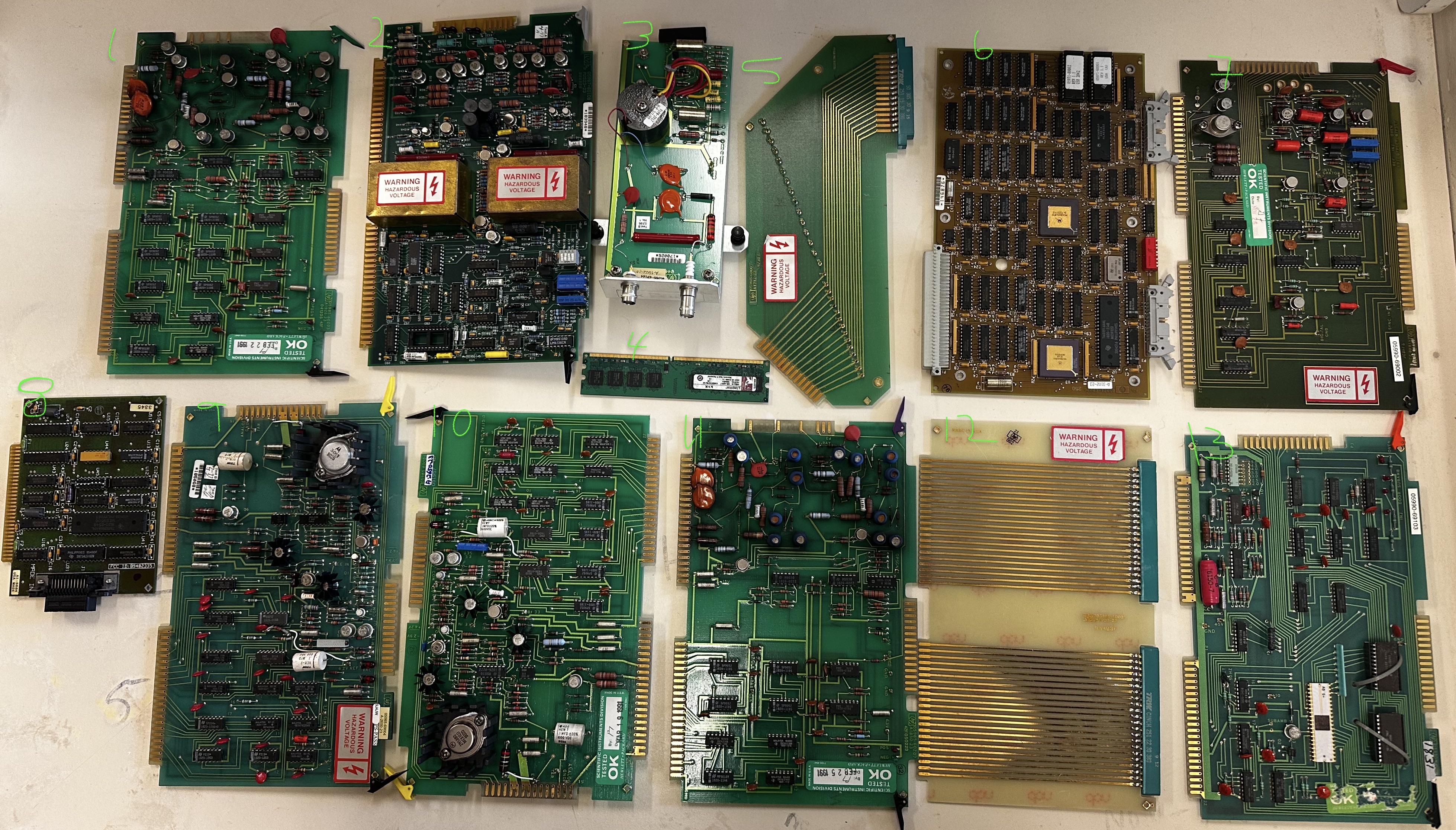

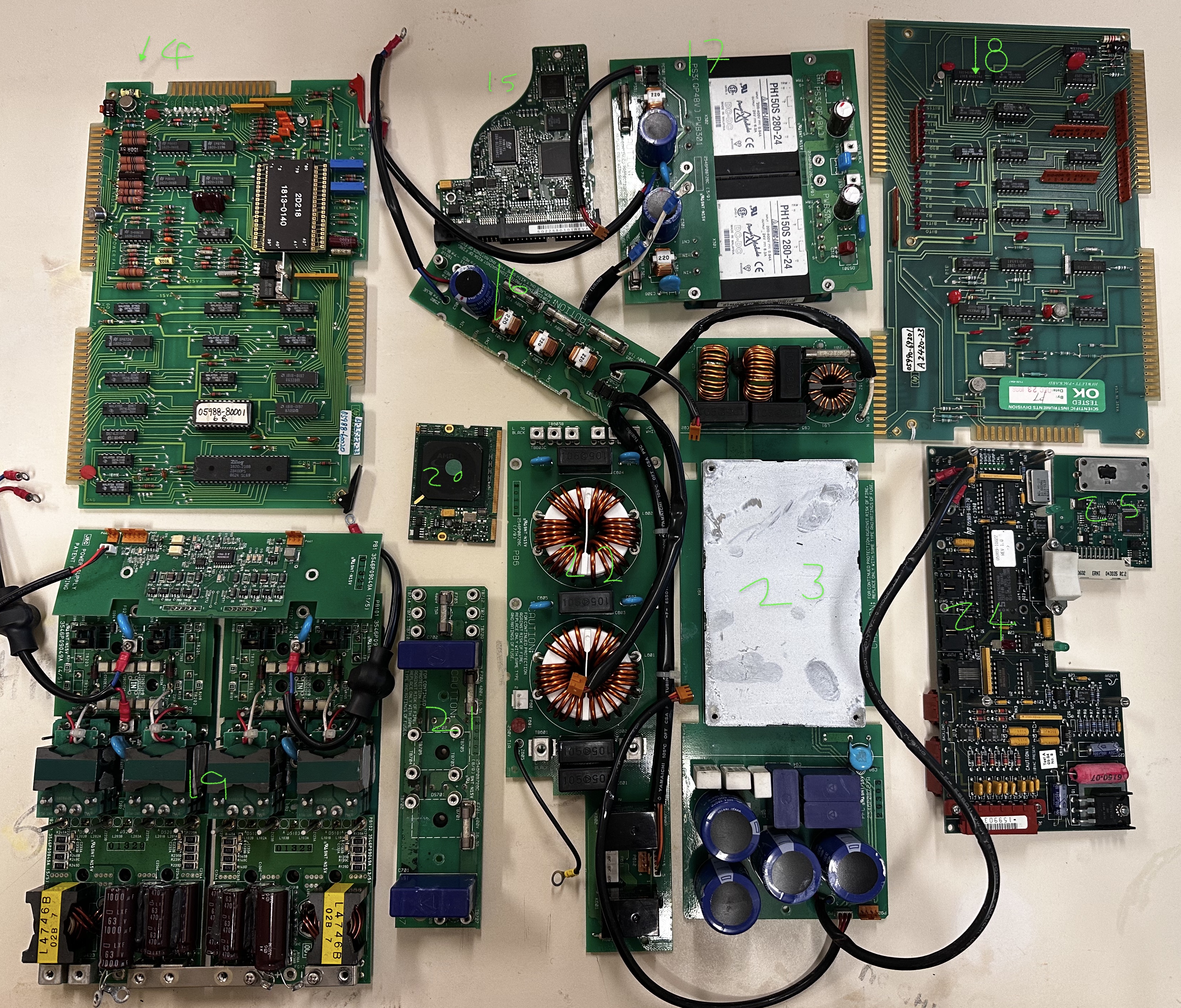

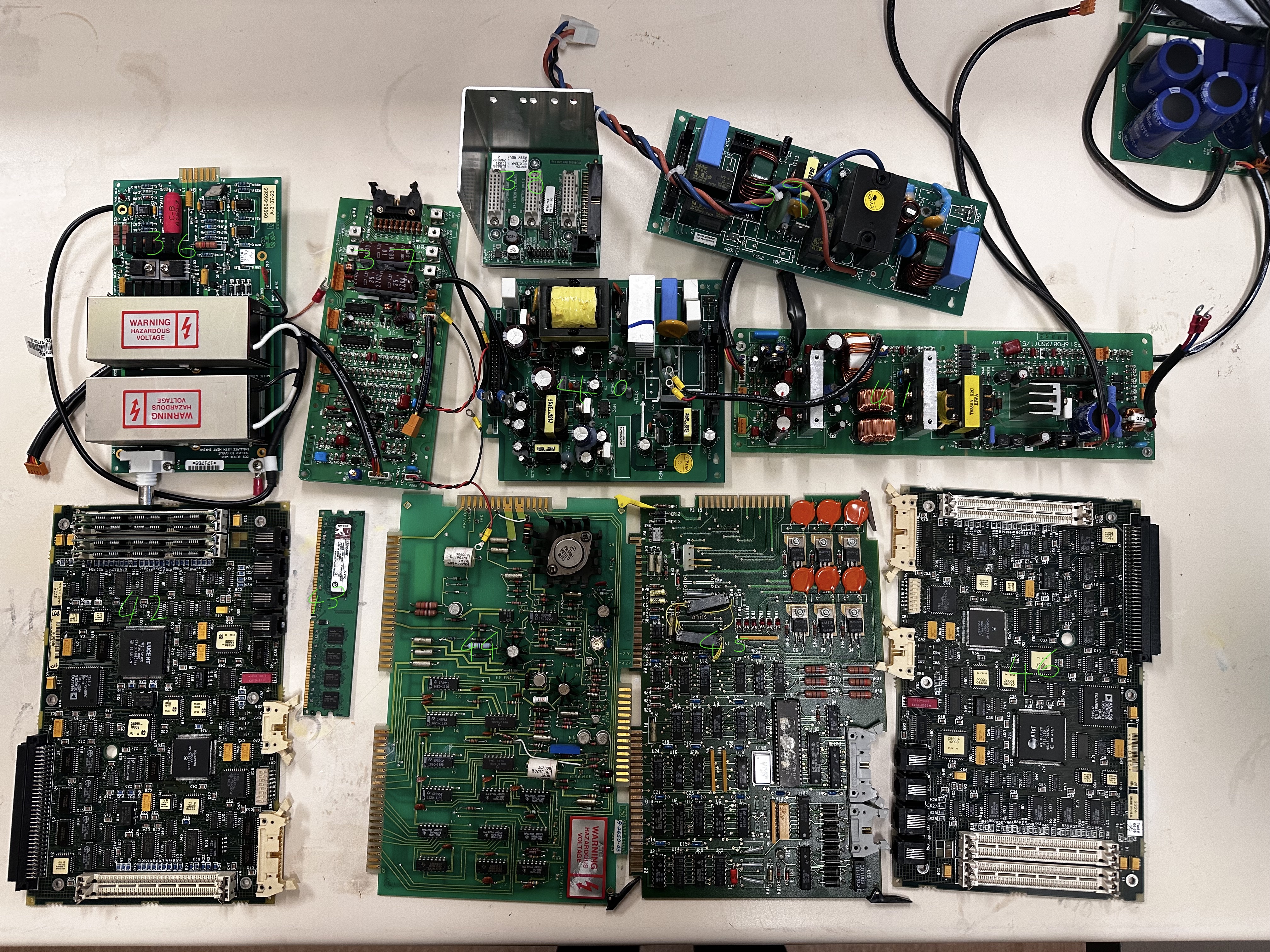

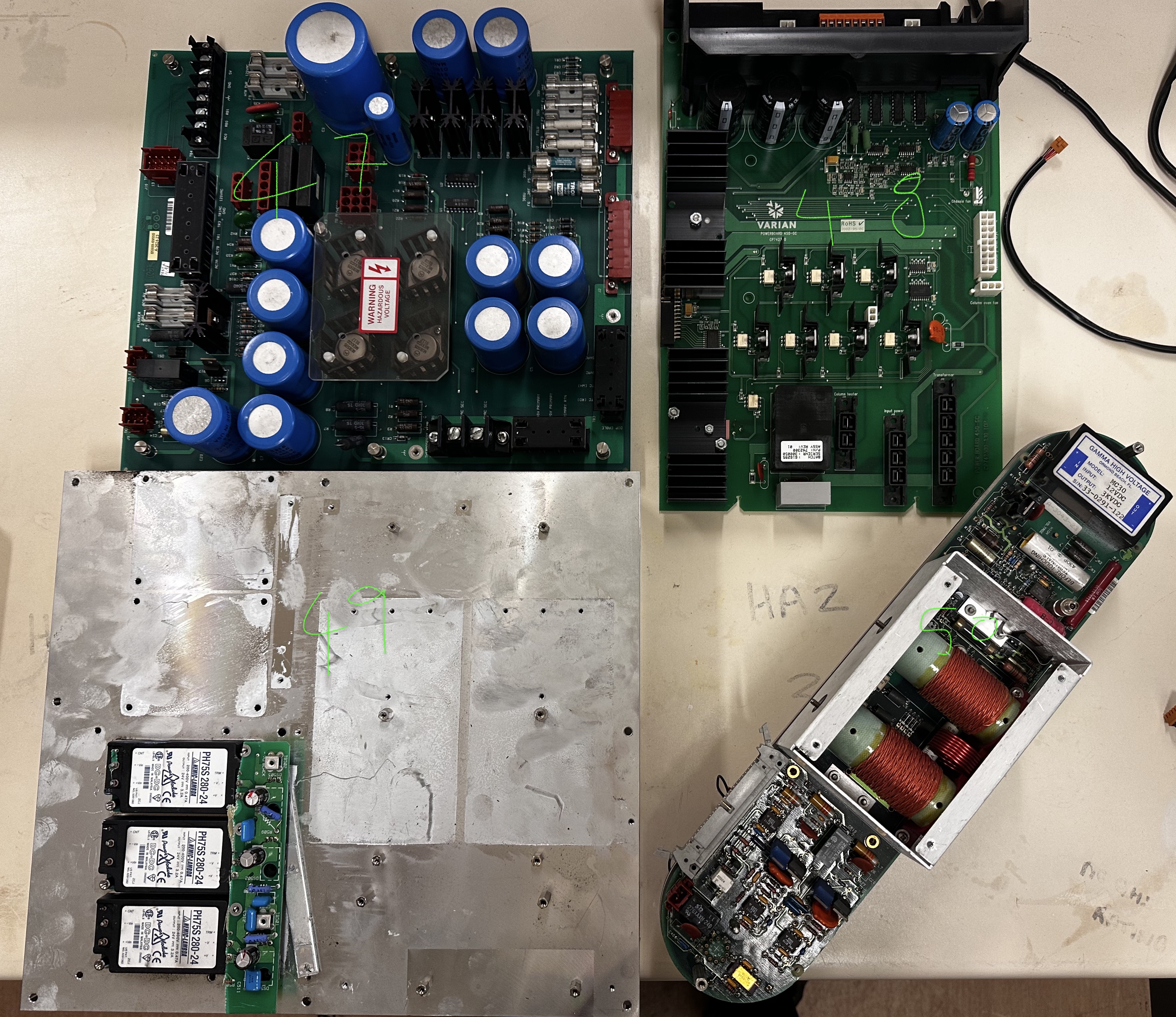

I've pulled apart a range of laboratory instruments for parts and am working through scrapping the components but have plenty of PCBs from them. These are all OOOOLLLLDDD so theres plenty of gold used and as someone new to this I'd like to work out how to best maximise my return. Im happy o cut off the gold fingers but am curious what other components on these boards are of value. I've attached a number of pics with each part numbered in the hope that someone can help me identify the high yield items to remove and sell.

Board 6 has gold cap chips which you could remove and the board would still be high telecom.

I am just feeling somewhat comfortable as a beginner on grading, mostly from watching Chris' videos and reading a lot of lost-in-lobos posts. I mostly scrap old scientific equipment as well and have done a lot of research on those boards. Very difficult to classify some of them, components are too old to be recognized for what they are. Take for example those little water tower looking things. They are transistors if they have 3 legs and the multileg ones are integrated circuits (IC). They often have gold legs or a little gold tab meaning that there is more gold on the bottom or inside. The bigger ones like on board 44 are mostly transistors and can have gold plated legs, gold heat sinks and gold inside. Generally they seem to be considered junk, at least based on how Chris referred to a larger metal capped transistor in one of the videos. If you have a lot, like many odd items you can ask Chris directly. I have not built up enough and they really vary.

Take off all wire. Take off all screwed on metal that is not gold (i.e. card 38). Take off all heat sinks. Watch the videos.
Boards 47-50 are low grade. Heavy with "junk" as Chris puts it, and little to no precious metals. Same for 36,40,41 and several others.
Take the metal off of 38 and you should get backplane rate (see the picture in the price list for backplane)
37 is peripheral high grade once cleaned
42 is High telecom, pull the ram to sell separately it doesn't downgrade the board. 45 and 46 also probably high tele.
43 is gold finger ram
44 is probably peripheral high, but you might need to remove the heat sink and Motorola transistor, which are sodered on from experience.
26 is at the break of peripheral low grade and mid grade. I would lean mid grade due to the powerpack daughter board
31 and 32 are peripheral high grade.

Board 6 has two Motorola gold CPU chips. If socketed remove them and sell separately for $215 per pound (sorry never run across one to tell you how many in a pound) and the board remains a high telecom. With them attached this is a gold cap/gold edge/CNC.
Board 6 is not clear as to the white ceramic chip. If gold capped then the board is a gold cap/gold edge/CNC, if not then high tele. However, these white ceramic chips sometimes demand a premium as collectors items.
