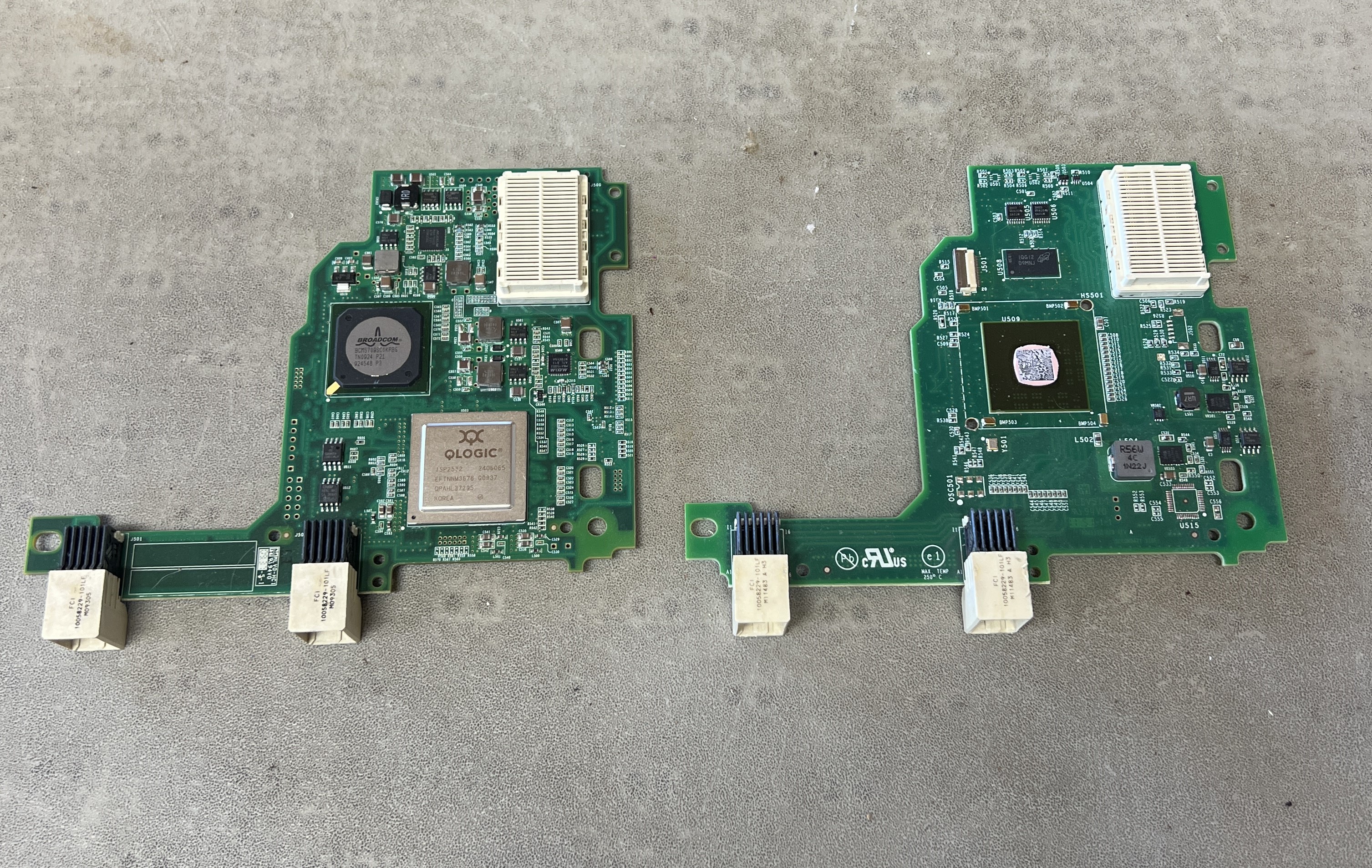

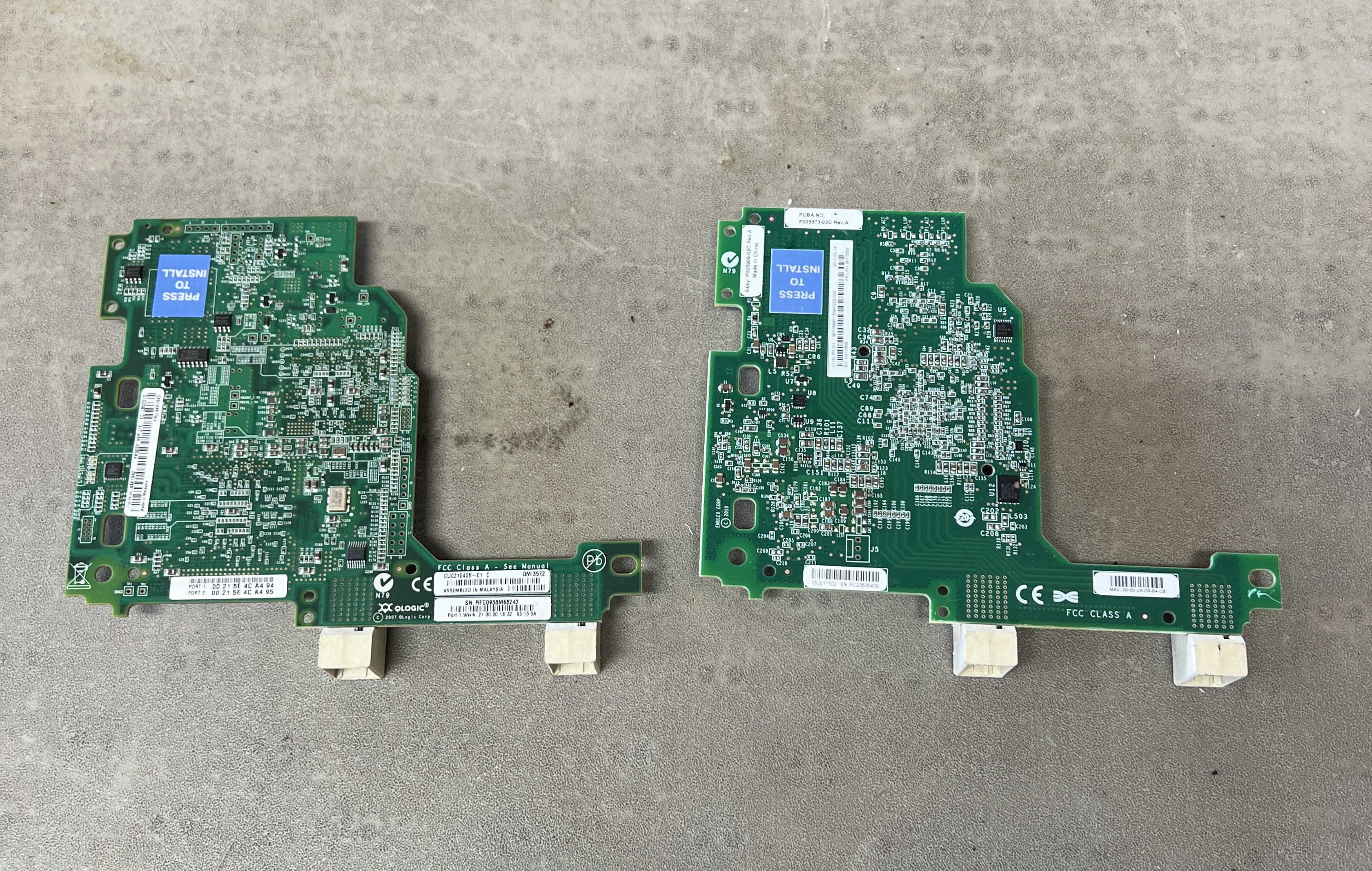

Hello - I'm new here, trying to start selling e-scrap. I would like some help grading a couple of boards.
Thanks for the help!
 Post subject: Re: Help Grading
PostPosted: Thu Mar 20, 2025 11:07 am
Posts: 815

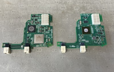

The first two look like Peripheral High Grade. The next two, the one on the right is Peripheral High Grade, but the one on the left might be a higher class because of the gold tab flat pack and large metal CPU.

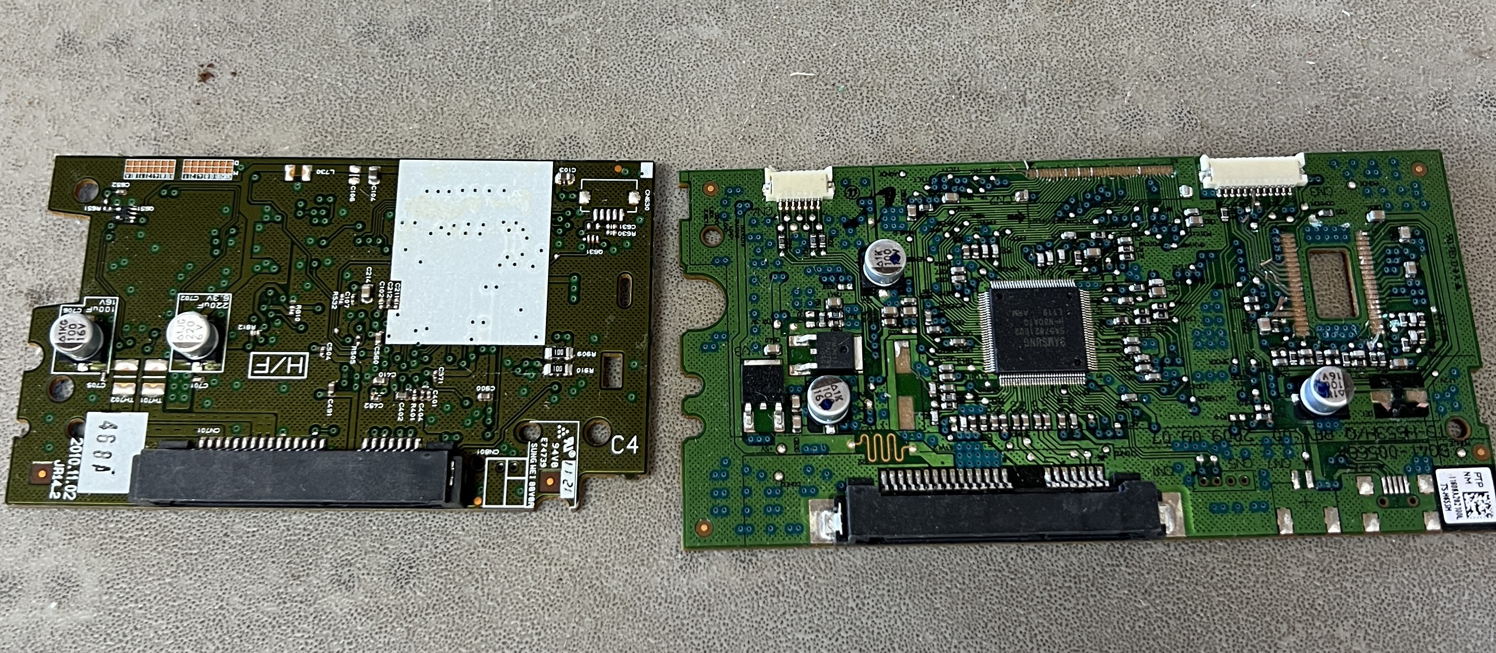

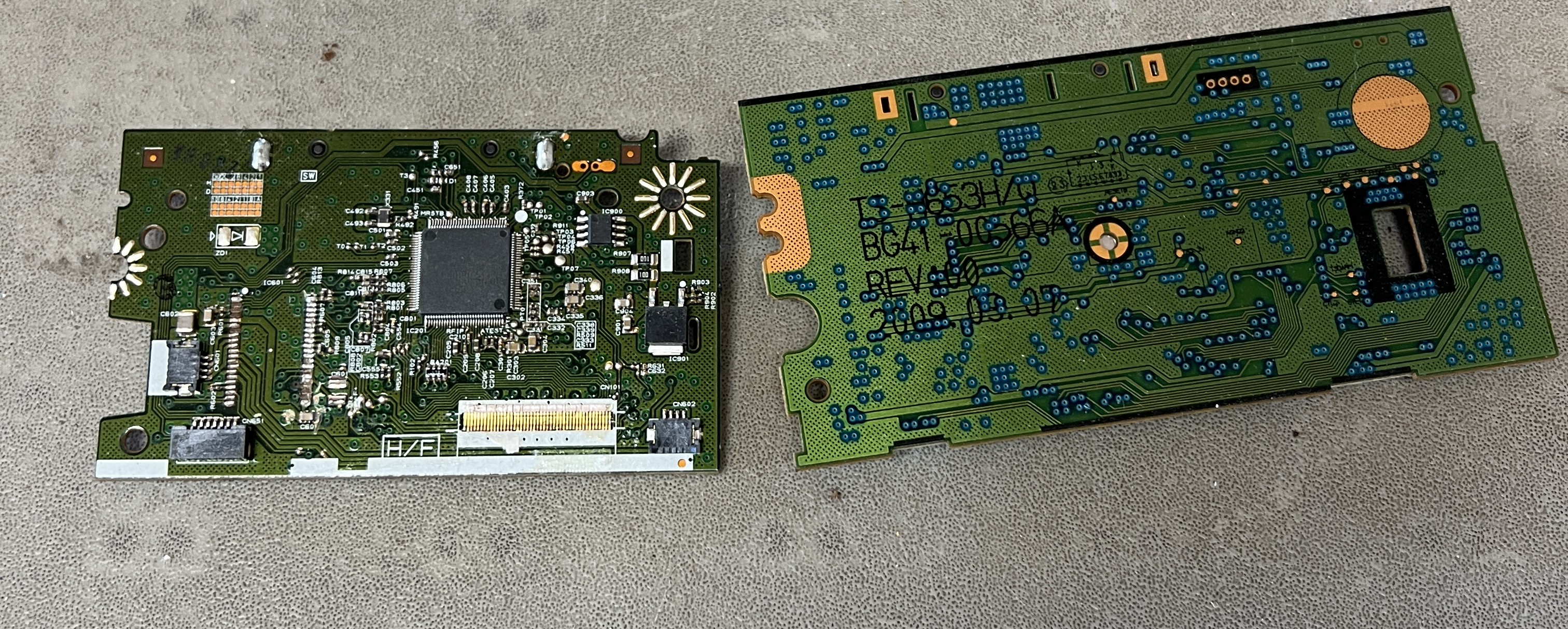

boards in img 2622 & 2623 look like they came from cd drives. If so they have their own class in the price list.
