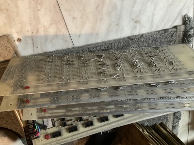

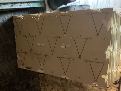

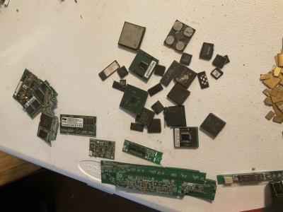

Hi I have a few different items I need help identifying and grading if possible also have some things I just need to know if you except them.

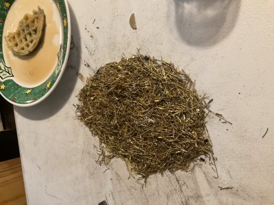

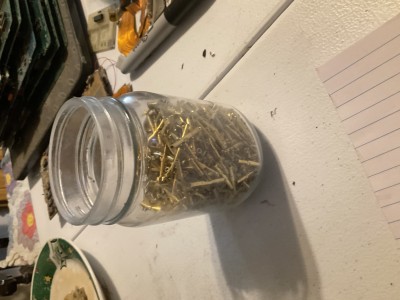

1. Solid gold pins large and small

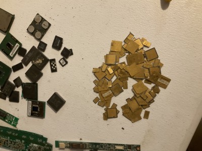

2. Gold plated chips
3. Boards with silver on them
4. Boards with pins still attached
5. Ceramic chips
6. Intel chips
7. Unknown small boards

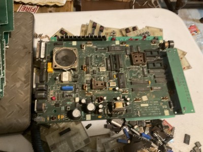

1253 Remove speaker. Remove both transformers. The bright yellow component right next to the speaker. Check if it has a lithium battery in it. If so. Remove it. Remove the potentiometer on the upper right of board. Remove the screws on the strip on right side of board. Remove the strip. I said all that. To say this. Remove the junk for higher payout. There are posts on this forum concerning junk. Sooooooo. After cleaning submit as High Peripheral.
1254 I would remove the pins and put them with your gold pin pile. That is not a Gold Pin Board in my opinion.

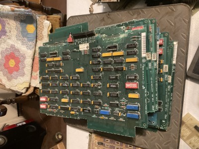

1252 High Peripheral

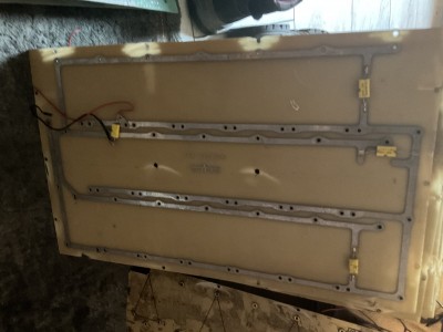

1245 Poor presentation of parts. No systematic layout. Individual components scattered about. I can't respond intelligently. But. Overall. I do think Boardsort buys whats in your picture. If you put all you have photographed in a box and sent to Boardsort. You would be downgraded severely. Labeled as e- soup.

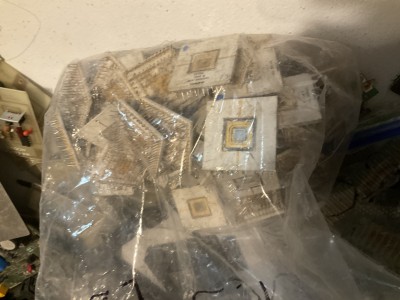

1250 Poor presentation again. Are all the chips the same? You said ceramic chips. Ok. Can one get a good look at one? Are those silver pins or gold pins on them? Think about it. A sorter at Boardsort would remove the chips from the bag to evaluate them. Gives us forum members the same circumstances to evaluate.

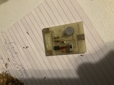

1256 1255 I do not believe they have any e-scrap value at Boardsort. But. Chris at Boardsort is a key stroke away by email.
1246 Are you removing the gold plates or gold caps off of CPUs or ICs? If so. I don't think your doing yourself a favor. I asked because I do not see pins on these so called chips. Your on your own with doing that. I can't respond.
1246 1247 Gold pin category. For both photos. Hey!!! Let Go My Eggo. I prefer butter over syrup.
