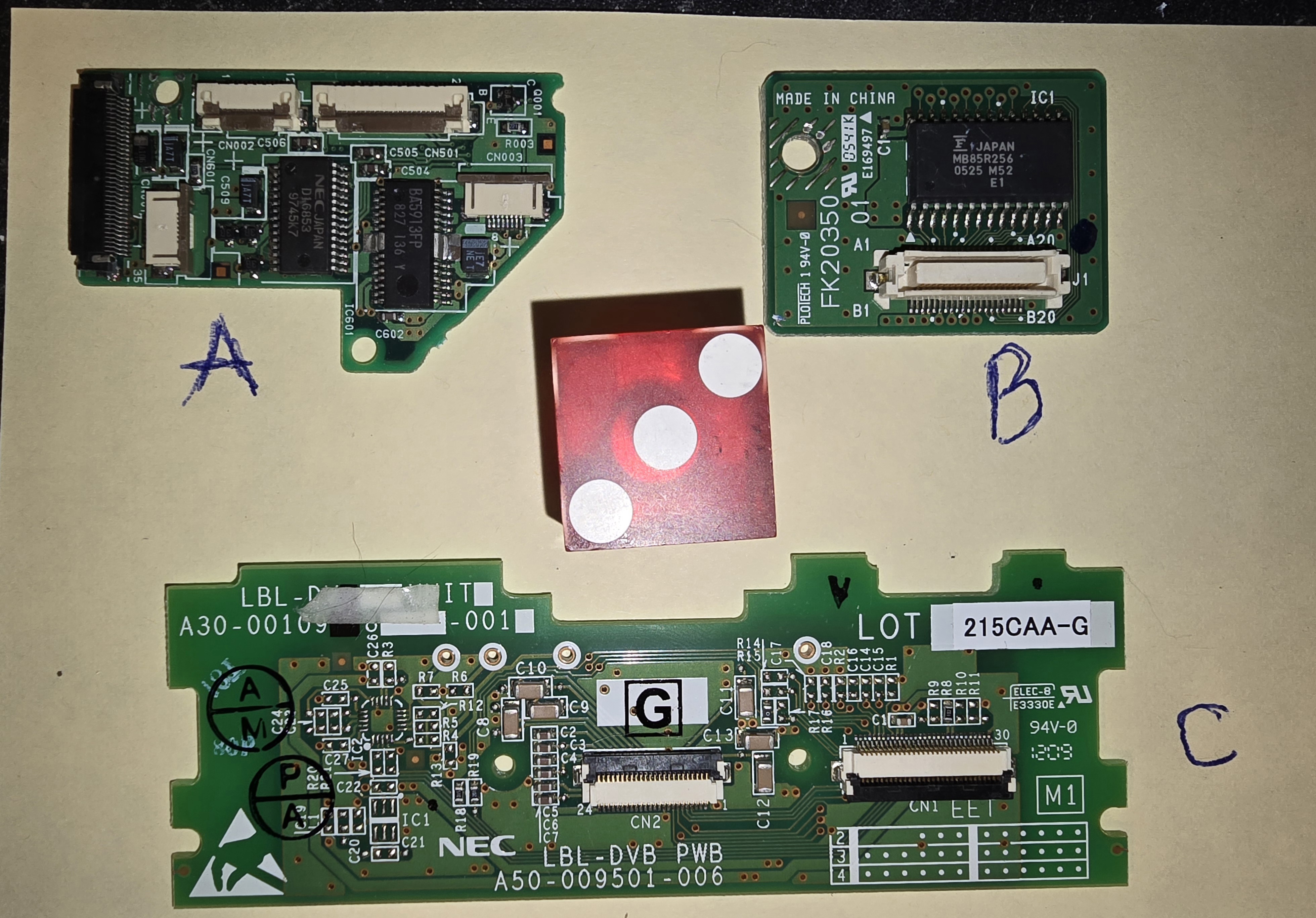

I listed 3 small boards. Can you guys help me categorize items ( A, B, C )..? I included front and back pictures. Thank you.

A High Peripheral
B Low Peripheral
C Low Grade
That's my opinion.

A: HGP
B: I'd be inclined to say HGP because while it is small, its got a chip and a connector on it. For its size that's what I'd decide to do. It's clean otherwise I'd go with LGP
C: I'd say this is a rare time I would qualify something as Mid-Grade / Low Grade that is green. Yes it has what looks like a gold connector on it but there's nearly nothing else ... If it were me I would rip that gold connector end off and throw it in your low grade e-scrap pile that some scrapyards will buy.
