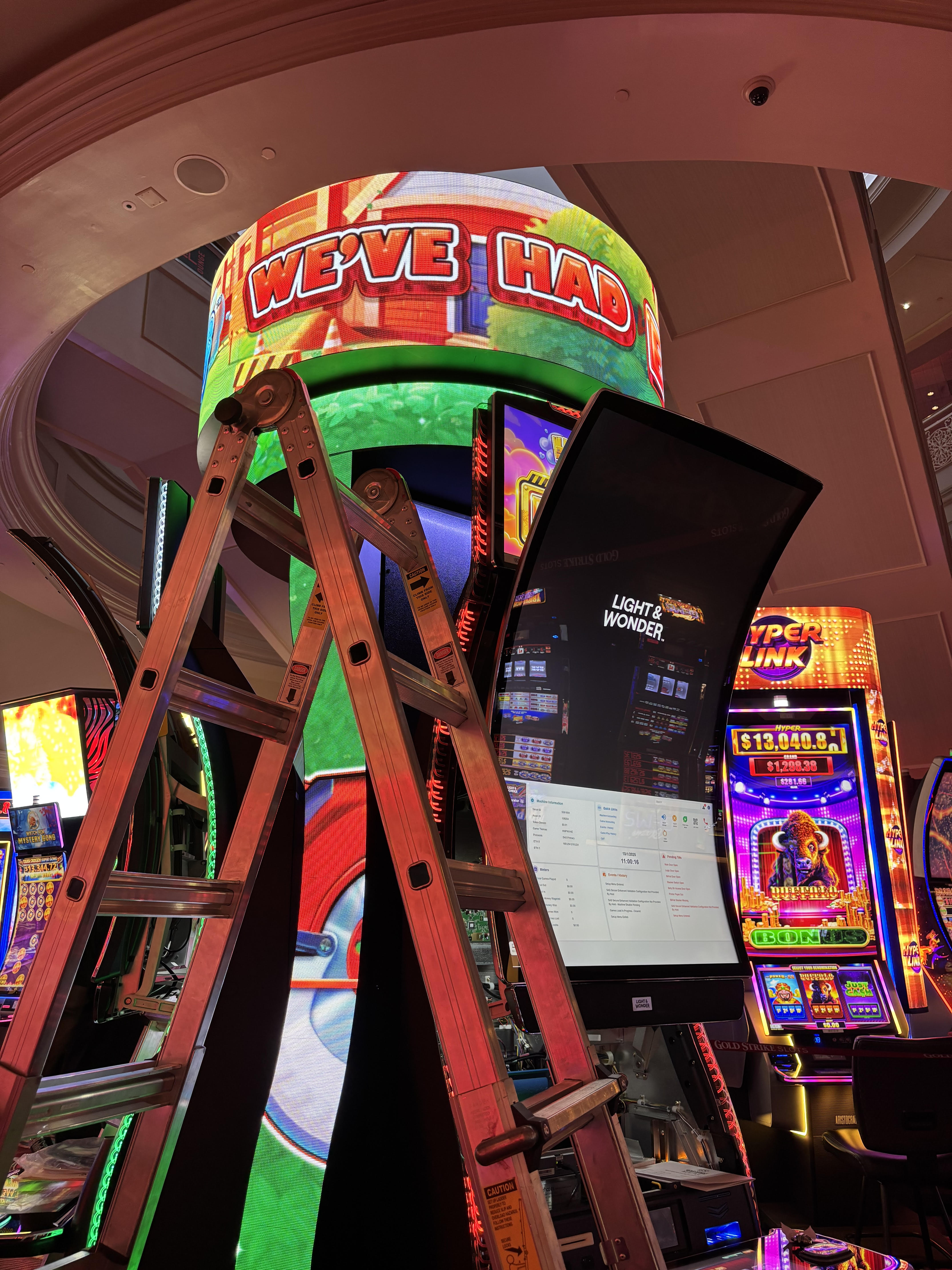

Magnets!!! I would love to see those boards installed in thier mounts.[/quote]
you probably have and just didnt realize it, especially if you have been to a casino in the past few years.

Should we be able to read the machine info?

The magnets are labeled V for voltage check or tests. Does the power come from the magnets through the board? I'm assuming it does. That's neat. What a cool design, click in and out with different programming.
It’s just generic data. Doesn’t mean anything
No they are just magnets to hold each panel in place, snug against each other. The panels I deal with have an in and an out connector and are daisy chained with ribbon cables. There will be an output board that controls 3-5 panels. It gets a video feed over cat 5 from a main controller.
The ones we use are flexible thus the clean finish on a round sign
