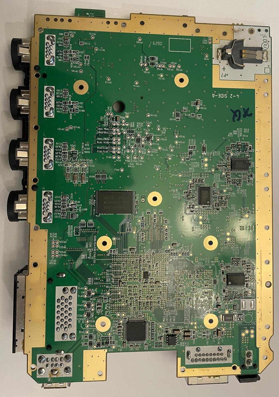

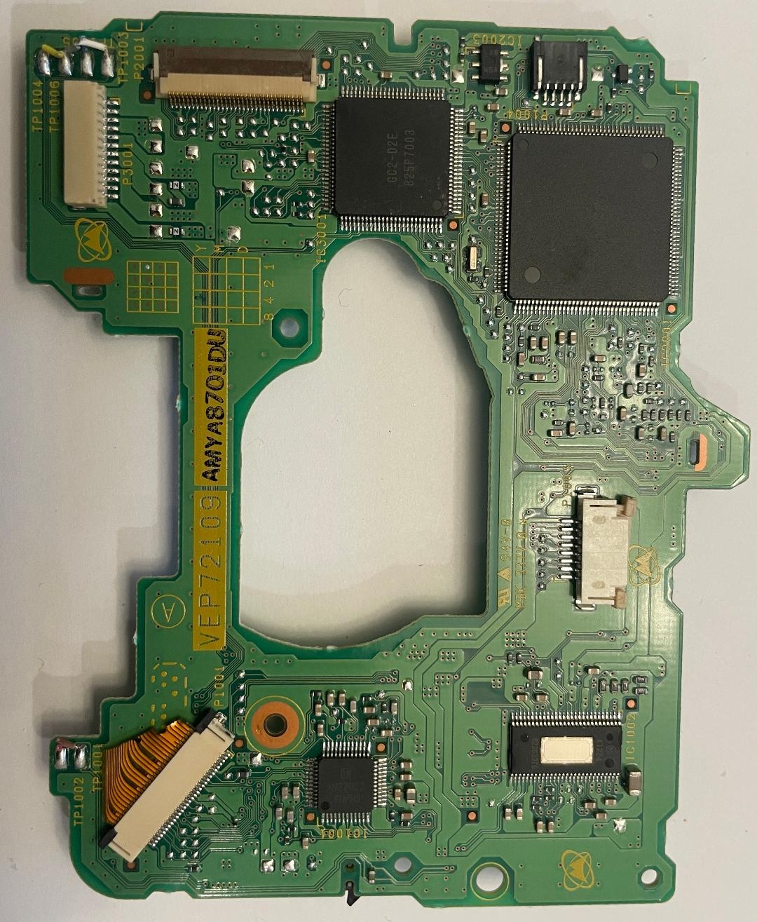

I am just starting out and would love some help classifying these boards,
Please help. Thanks in advance!
Here are my guesses:
PCB 1 - Hard drive board (because of pins)
PCB 2 - Low grade peripheral
PCB 3 - Gold edge board
PCB 4 - Low grade peripheral

You're on the right track!
1. Looks like a High grade hard drive, Non- SATA. Take pic of connection?
2. High Per, carefully remove that yellow circular object, it is a battery. Batteries must be removed. (please recycle them <3 ) Small, tiny, flathead works great if you can get in-between the hanger and batt and just roll the screwdriver. Peels it away w/o pressuring/punction the batt.
3. High Per
4. CD/DVD, quite certain I count everything there for it.

1 and 4 are cd/DVD boards
Agree with Spence on 2/3

Thank you for the IDs.
I am trying to learn, so I need to ask - why is board 3 high per and not gold edge?
Again, thanks in advance!
 Post subject: Re: Help with boards
PostPosted: Mon Dec 22, 2025 4:17 pm
Posts: 2645
Game system boards are generally high peripheral. As far as gold edge, that's a very specific case (admittedly I'm not very familiar with) where there a substantial amount of gold in the board itself. Nintendo isn't doing that with a mass produced consumer board.
