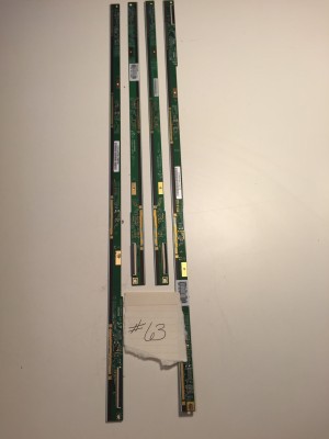

#63: peripheral

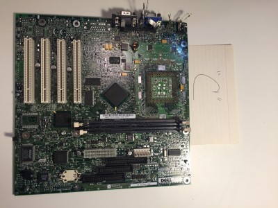

E: Probably on the low end of peripheral

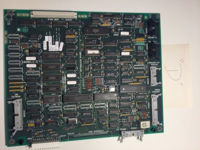

D: Telco

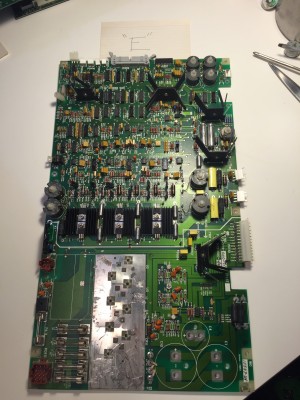

E: Since it looks like it's been processed I'm not sure it qualifies as a motherboard anymore (Not the best idea to remove things from the board) with that being said, probably peripheral now, which is the same price, lostinlodos can probably be the judge on that one.

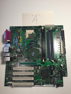

A: Small socket motherboard

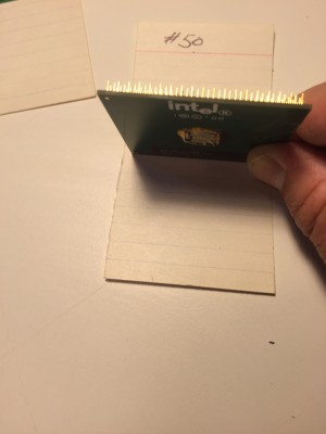

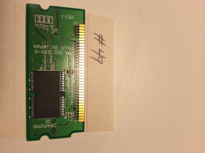

#50 Green fiber chip
#49 Gold finger card
#48 Gold finger card (you can leave the bracket on if you want)

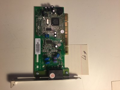

#47 Gold finger card

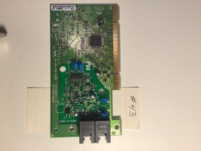

#43 Gold finger card

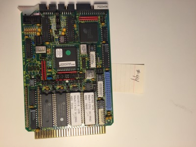

#44 Telco

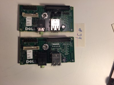

#39 both peripheral

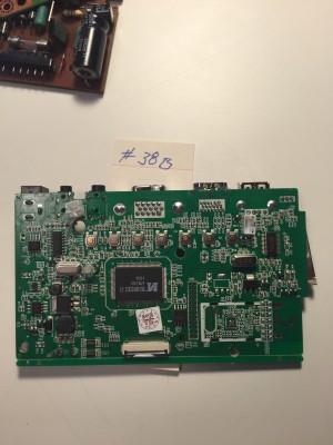

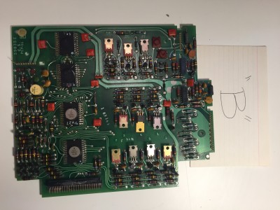

#38B peripheral

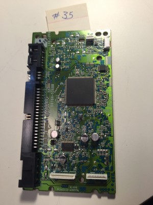

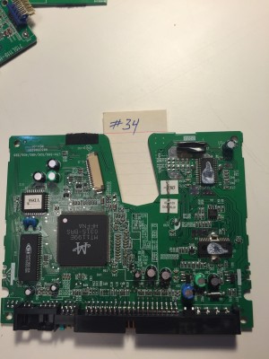

#35 CD/DVD board
#34 CD/DVD board

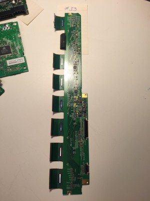

#33 peripheral

You have 2 #32s peripheral

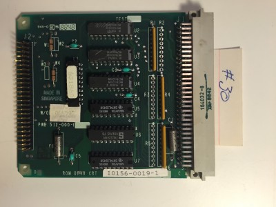

#30 MAY be on the low end of telco not entirely sure

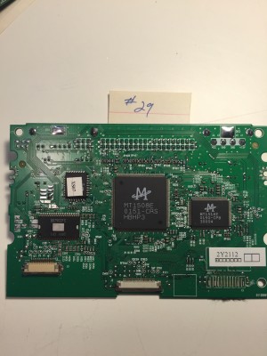

#29 if it still has the connector, CD/DVD board, if not, peripheral then I think

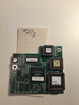

#27B telco with the chips still in the sockets, peripheral I would think without them

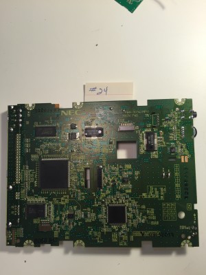

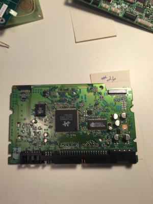

#24 CD/DVD board from the looks of it

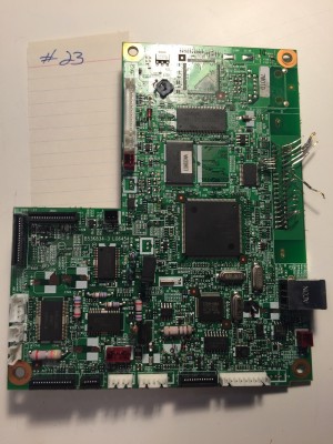

#23 Peripheral

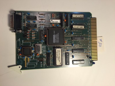

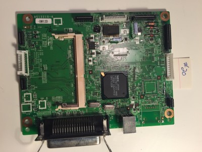

#20 may be telco

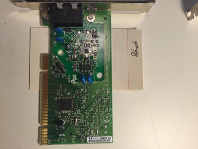

Second #20 Peripheral

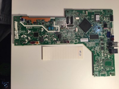

#19 Looks processed, still peripheral

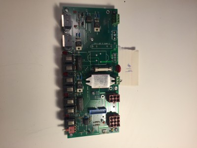

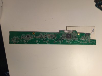

#18 Peripheral

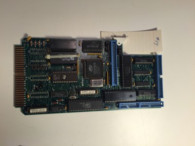

#17 telco, remove the dallas box!

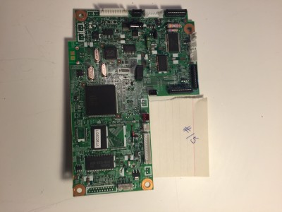

#15 peripheral

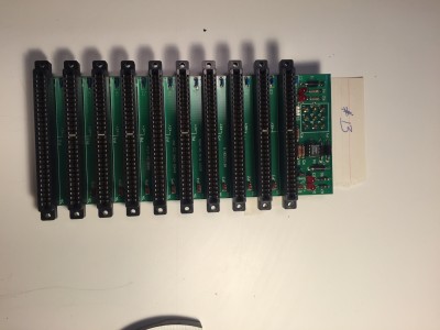

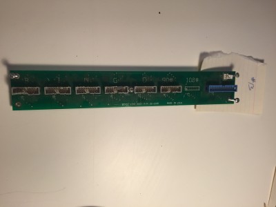

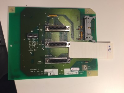

#13 Probably backplane
Second #13 backplane

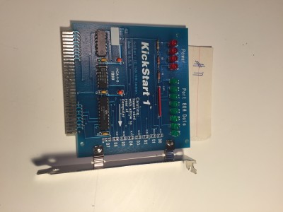

#11 if the finger is silver colored peripheral, if gold, gold finger card

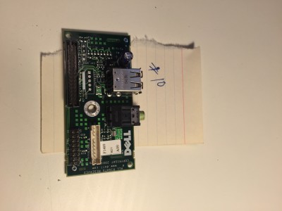

#10 Peripheral

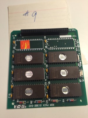

#9 Telco

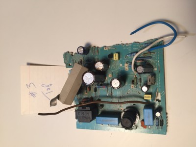

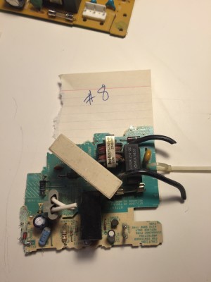

#8 Low grade

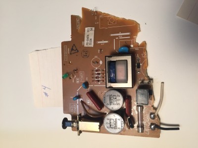

#7 Low grade
#6 low grade
#5 low grade
#4 low grade
#3 low grade (I think)

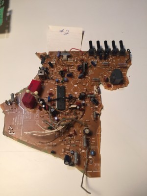

#2 low grade

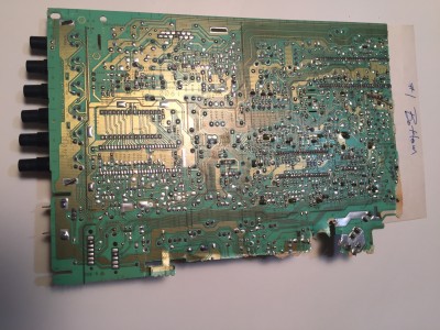

#1 probably low grade not sure.

What do you recommend I do with the "dallas box" once removed?

Dallas battery; got an electronics store near you? Tape the pins over and toss it in their battery bin. Or lowes/Home Depot.
If not call your fire department non emergency number and ask where your hazmat drop is.

C is one trashed motherboard. Peripheral now. Was a metal socket
B is peripheral on the lowest end. The ICs on it are good enough in this case

30 is peripheral, low end ICs
29 cd/DVD it's a mobile/low profile
27 don't remove anything for telco

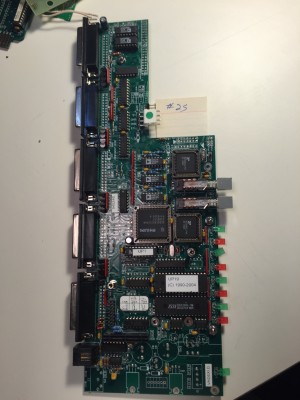

25 leave the CPU in; telco
22 needs to be reviewed on site
Upper 20 telco
14 peripheral
Upper 13 midgrade
Lower 13 backplane

6 midgrade
3 midgrade
1 is debatable low or mid

Regarding the Dallas box...
I looked this up on ebay and it says that it is a
"Dallas 64K Nonvolatile SRAM DS1225Y-200 28-DIP originals NOS"
All the used ones average around $5 a piece. Just want to confirm your advice to environmentally dispose versus sell or leave on to add value to the baord

I personally don't suggest selling battery backed rom/ram.
If something goes wrong you could be legally liable. Personally I just recycle them or on a rare occasion when I have a large amount in a single batch I'll sell them to a local battery buyer; a recycling facility.
If you do sell them they MUST be shipped ground in most variations.
