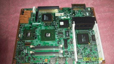

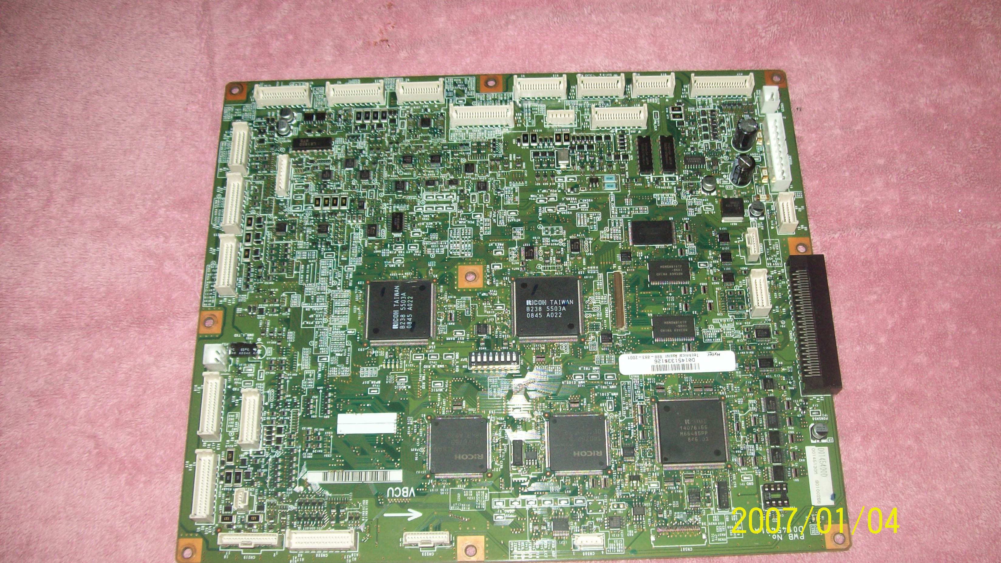

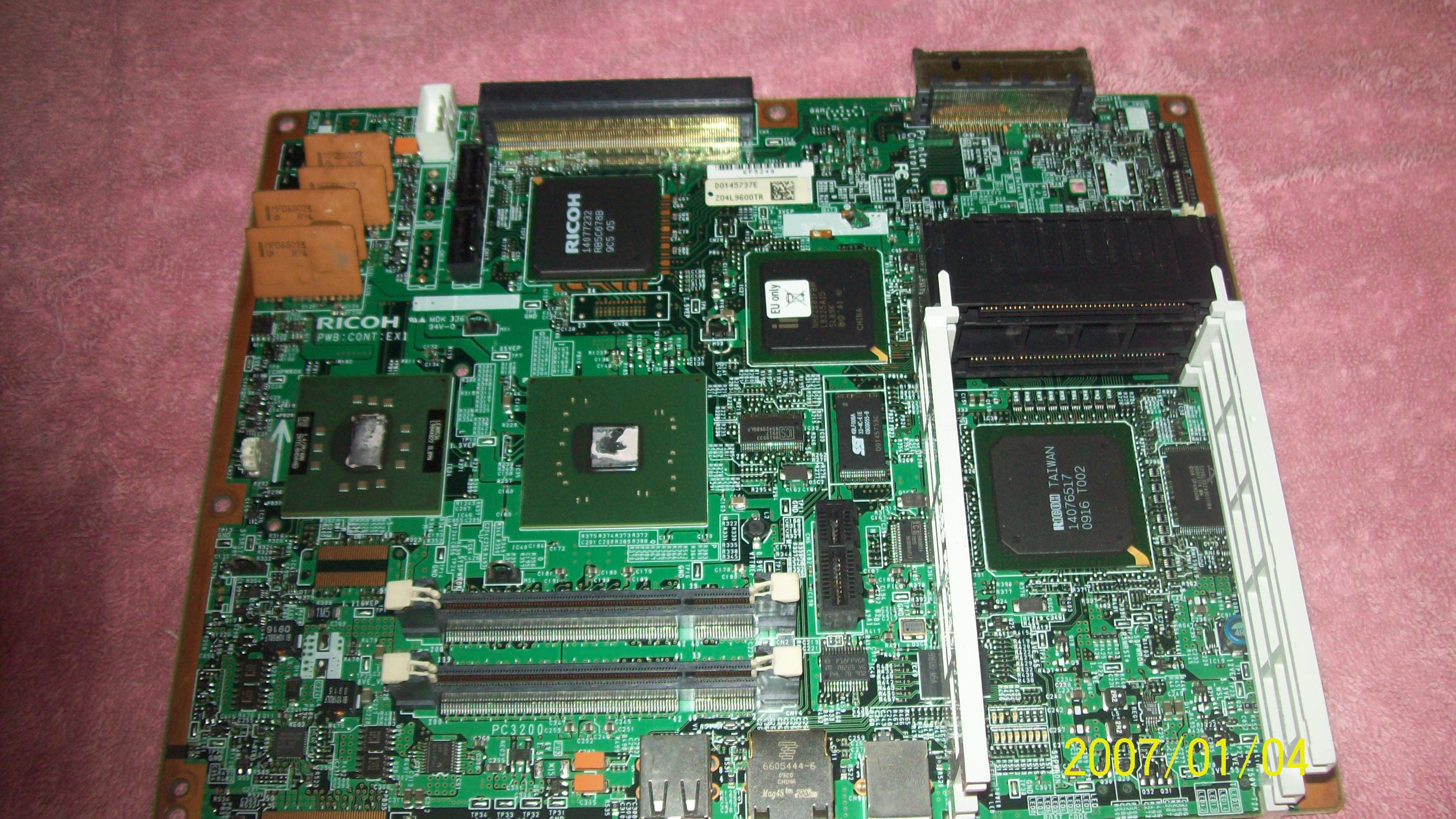

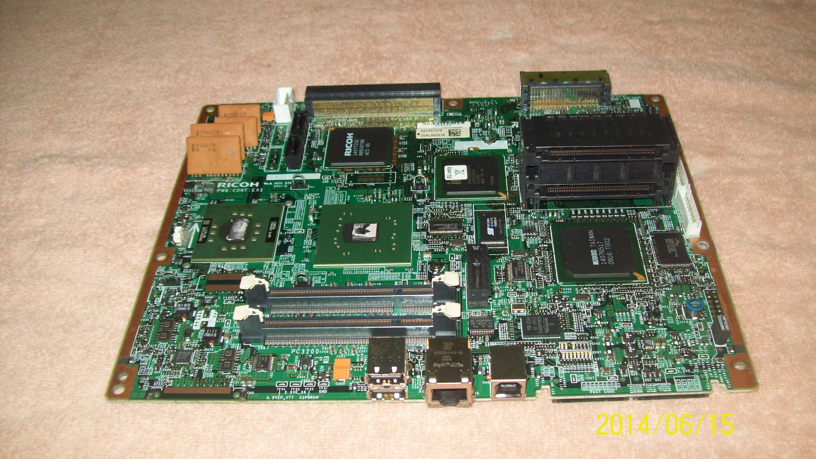

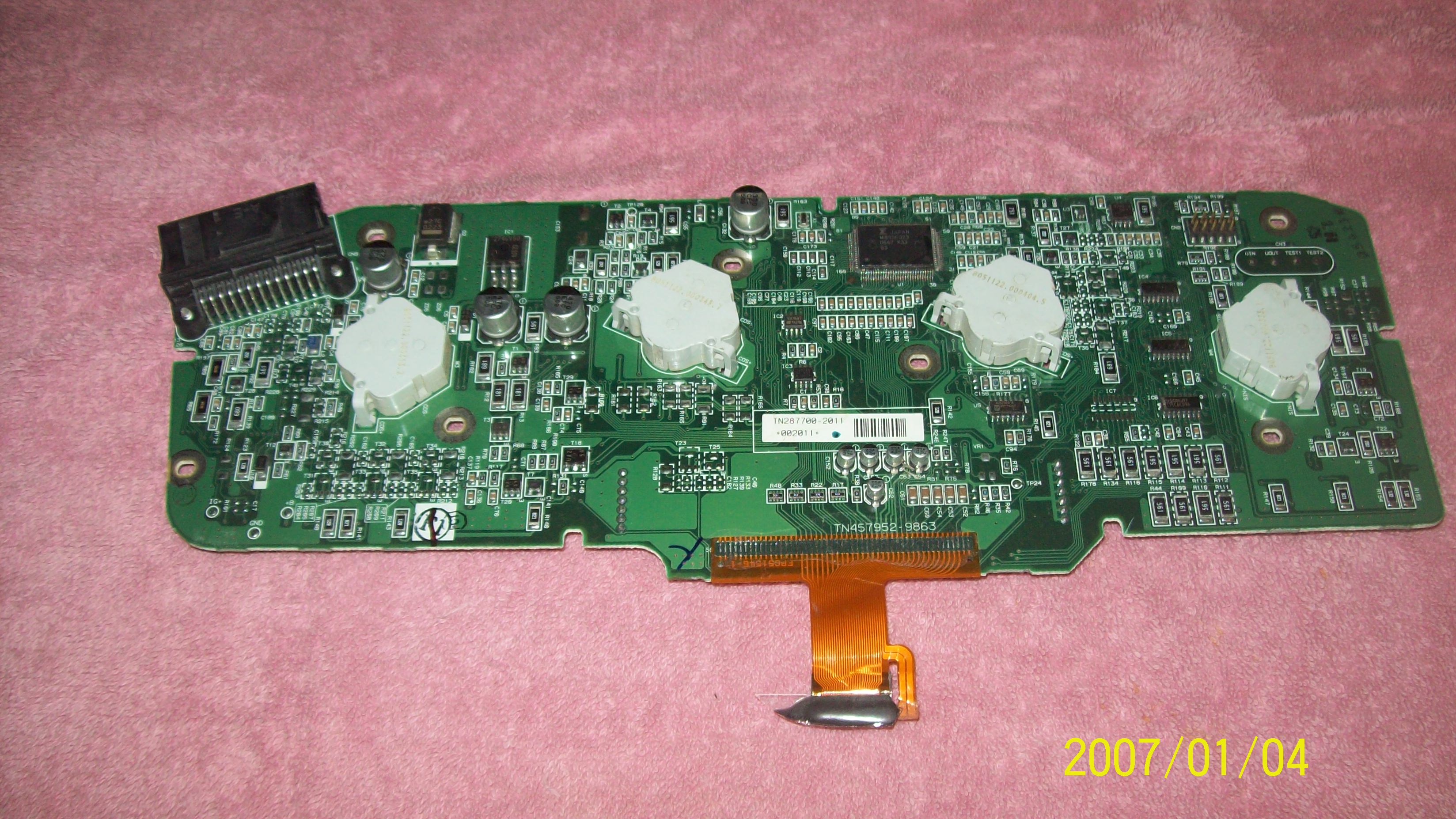

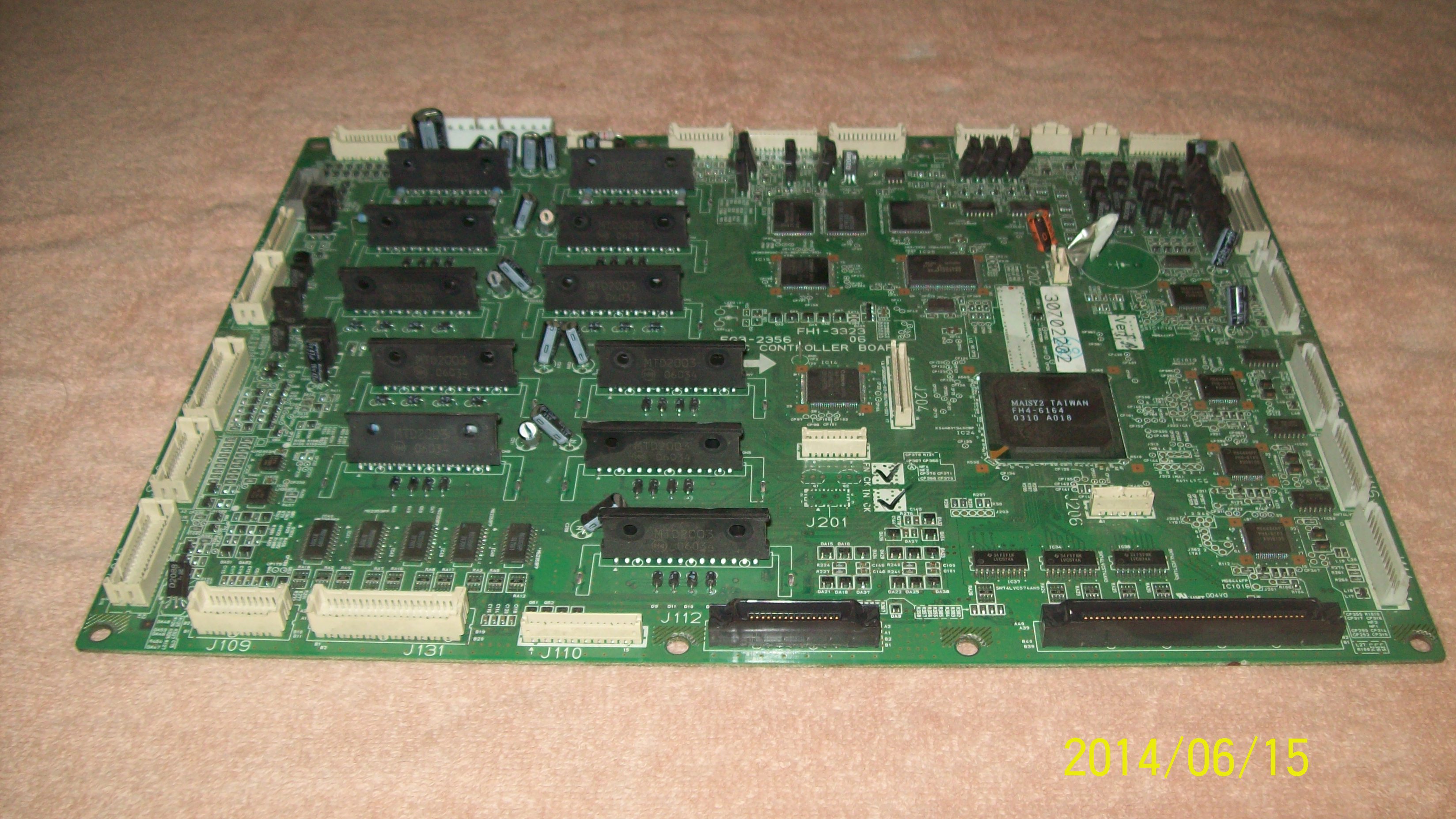

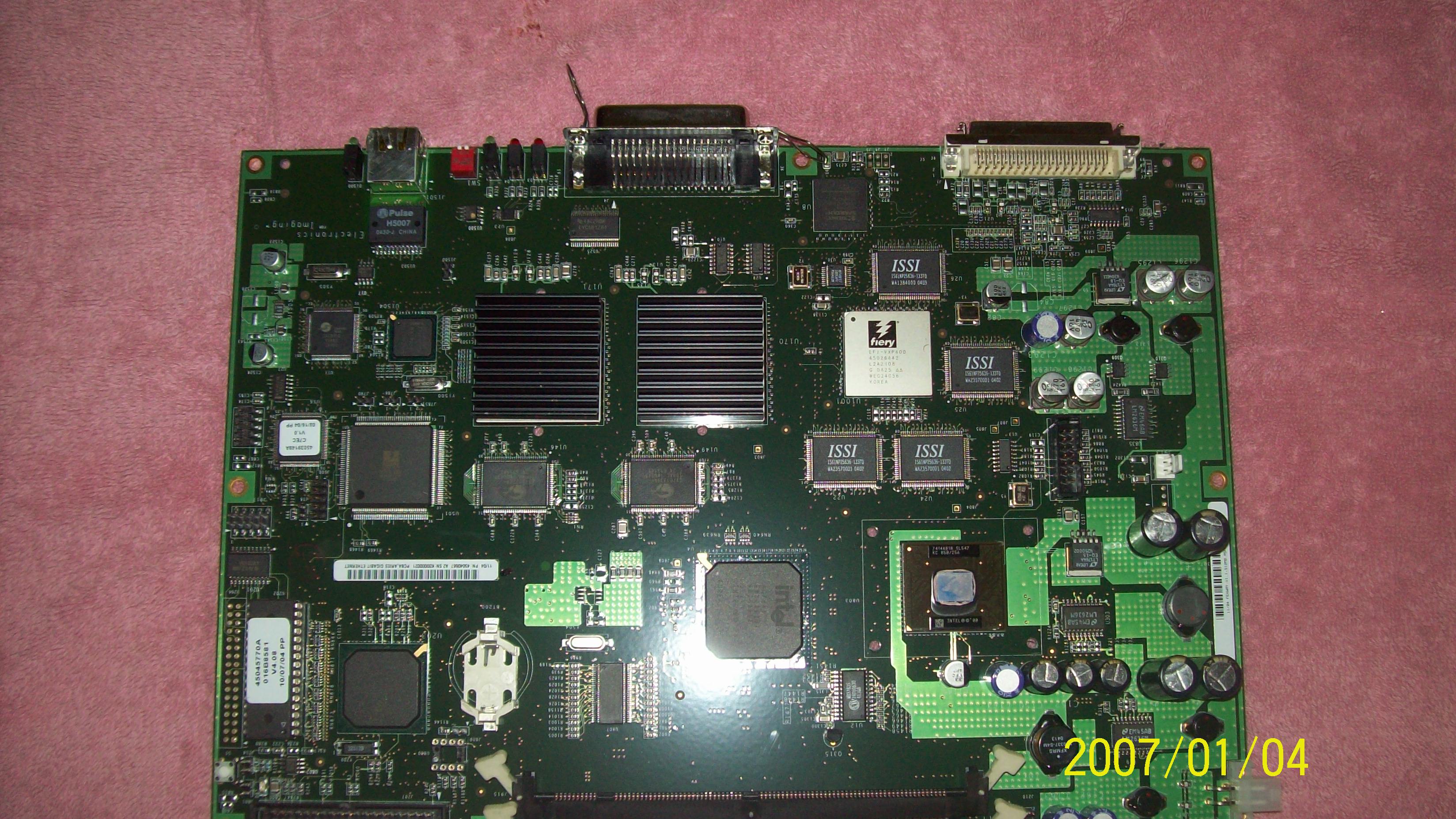

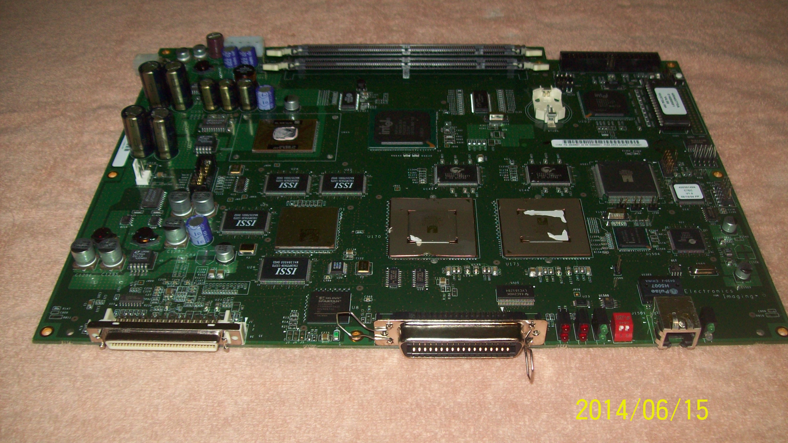

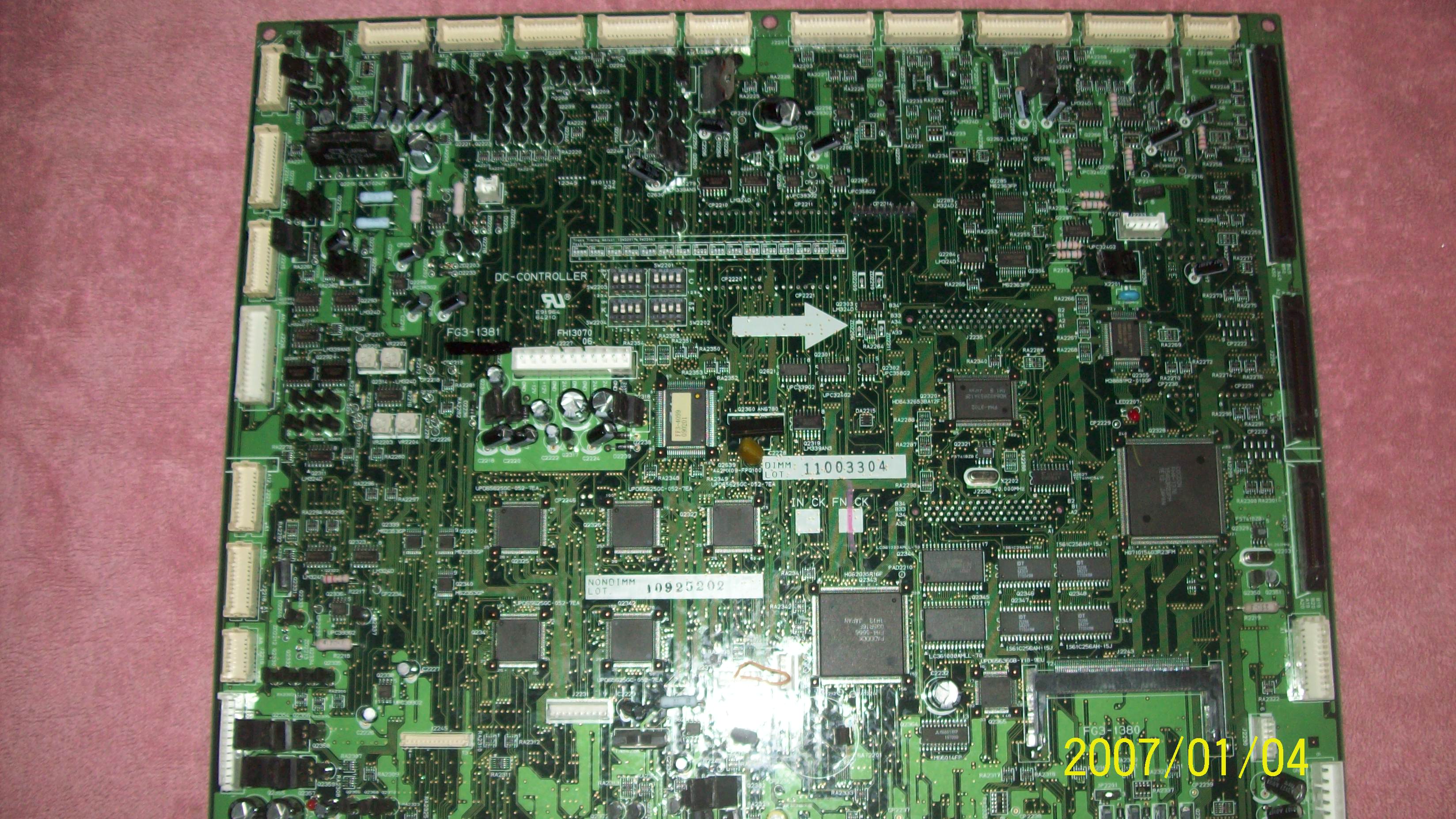

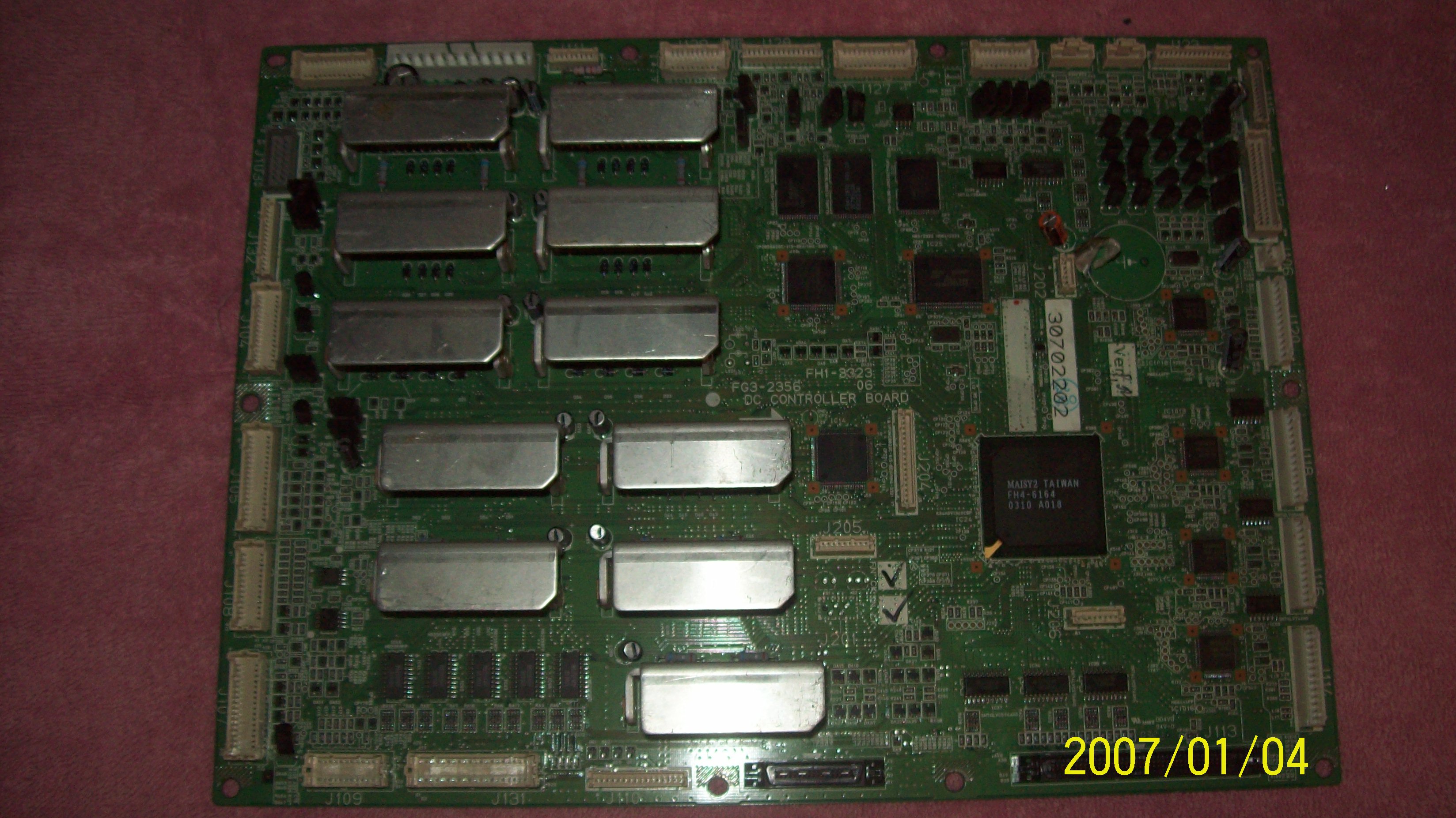

I have access to about 6000 of these assorted board's. I'm new to this and don't know how to sort and grade these board's. I've been selling local and not paid what they are worth I'm sure. Thank's for any help.

Board 1 has some decent flat pack population, so it may fetch telecom grade pricing. Boardsort may require you to remove the white plastic on the bottom right before they can purchase the board.
Boards 2, 3, and 4 are more in line with peripheral grade given the lesser amount of IC population.

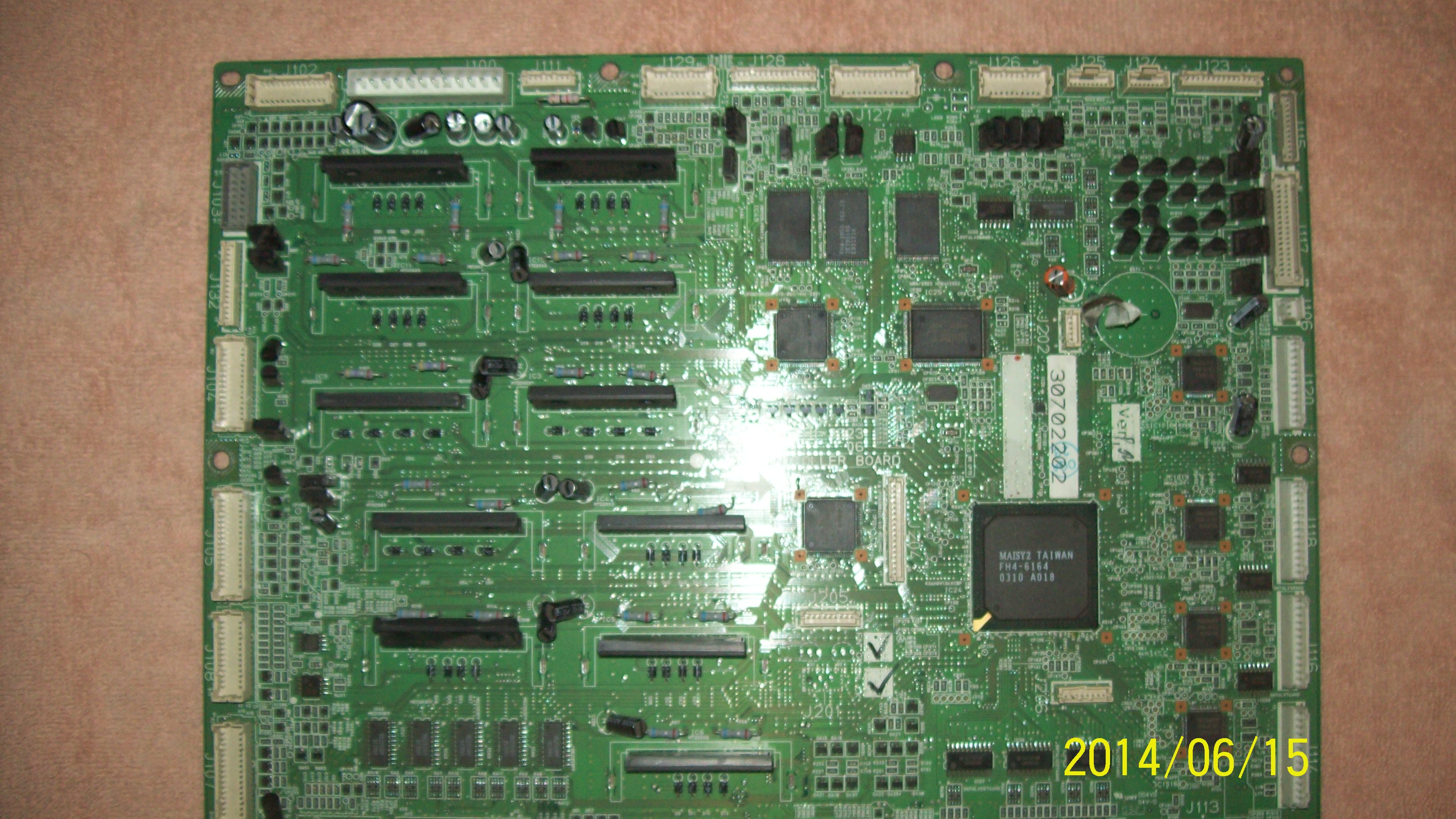

Board 5 is hard to grade since there's some metal on the board that could be covering up some chips. Can the metal be removed and if so, can you post a new photo of the board with the metal removed?
Board 6 will likely go as peripheral grade, but there appears to be two heat sinks that can be removed. If they can be removed, remove them and sell to your local scrap yard.

Board 1, removed the white plastic, pic 206, not the black as there seem's to be some gold pins in it. Board 5, pic 207 & 208, removed metal, don't know. Board 6, pic 205, I forgot to remove the heat sinks before pic, I remove all of these and sell at the scrap yard where I work, #1 ex .62 cent a pound. Posted in what is it some other board's I got today. Thank's for the help.
