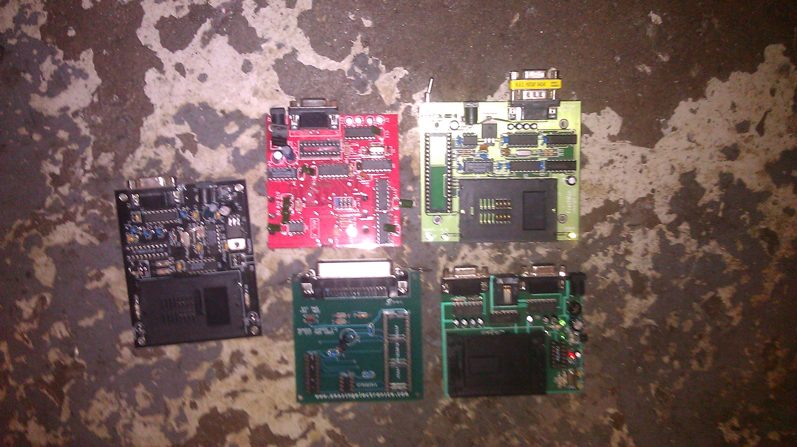

Im trying to grade these boards.

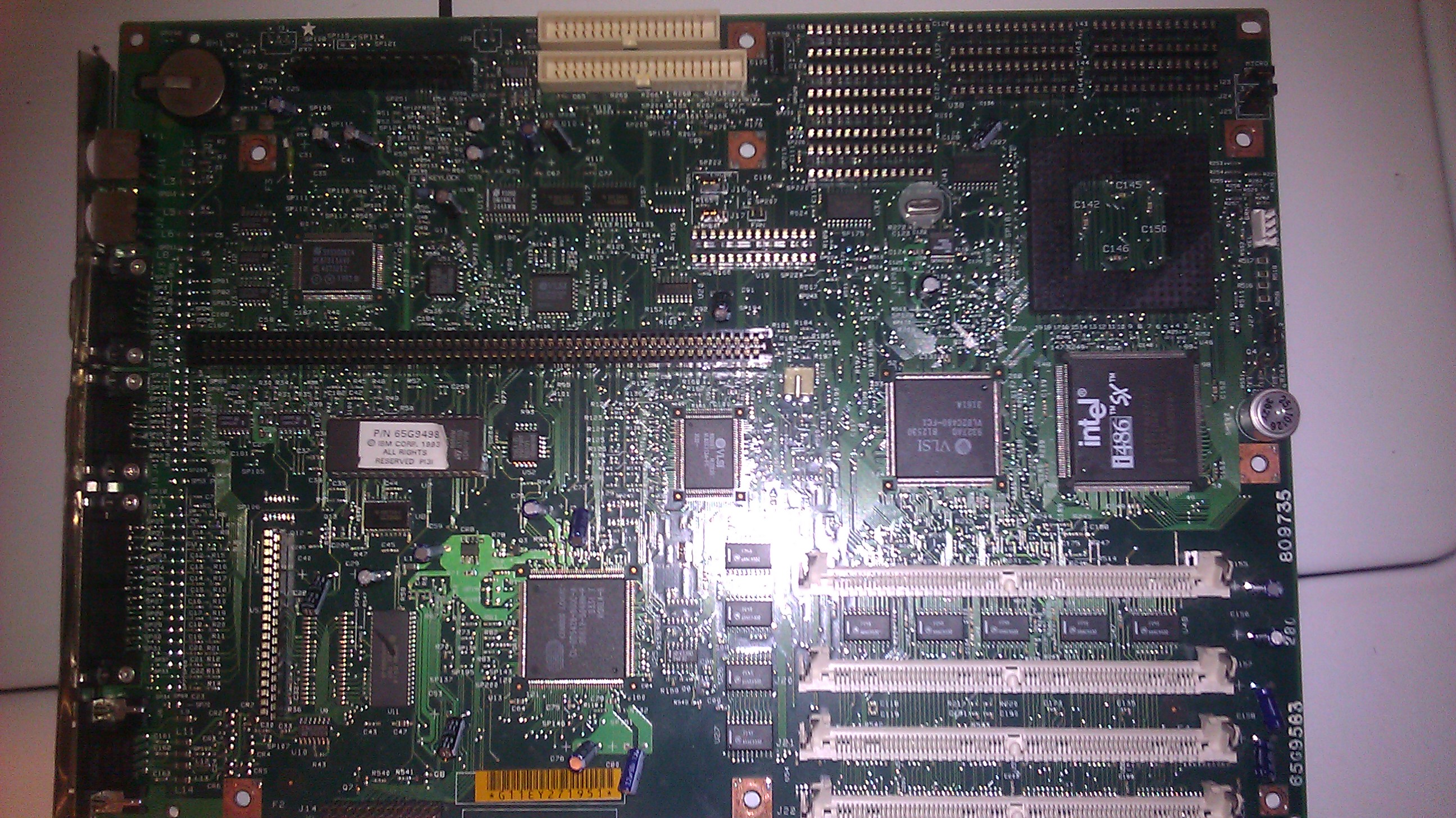

Sorry I posted the wrong one twice, the motherboard with the integrated cpu, My question on that really was would it qualify as more than large socket motherboard. Thank you.

First photo: all boards are peripheral.

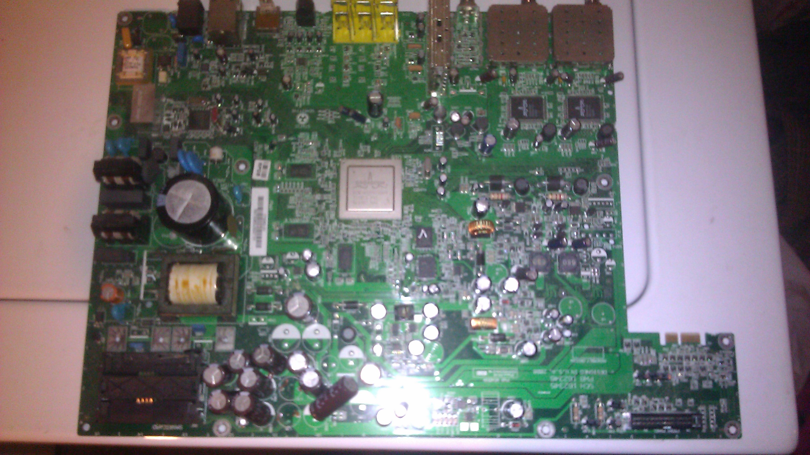

Second photo is a large socket motherboard. Many of your older boards from the early 90s have small sockets per boardsort standards, but they pay the large socket rate due to the amount of gold used.

The last photo is a duplicate of the second photo.

I know the one is a large socket, but the question I really have is it doesn't get anymore being theres a 486 CPU integrated into the board. That had happened with a number of IBMs where there was a problem with the mounting for the CPU so to fix they integrated into the board, hence the reason the socket is there but has never been
used for a CPU.

I don't believe it will get any more value as a result. Next highest grade for that type of board would be a gold cap board and that is reserved for some types of telecom boards or other PC boards where there's a gold cap CPU chip soldered to the board which can not be removed without the use of desoldering tools.
