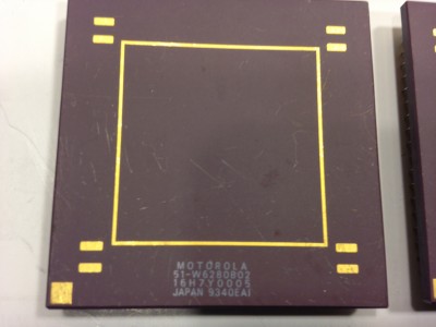

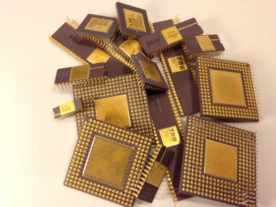

Are they all graded the same? some have a little solder on the pins, is this okay?
PostPosted: Mon Nov 17, 2014 12:38 pm
To accurately grade the first photo, we will need to see the top and bottom of the square chips. The 8086 chips can be removed and put into one pile.
in the second photo, the chip with the gold cap and gold legs can go as an 8086. The other one may end up as a foreign gold cap.

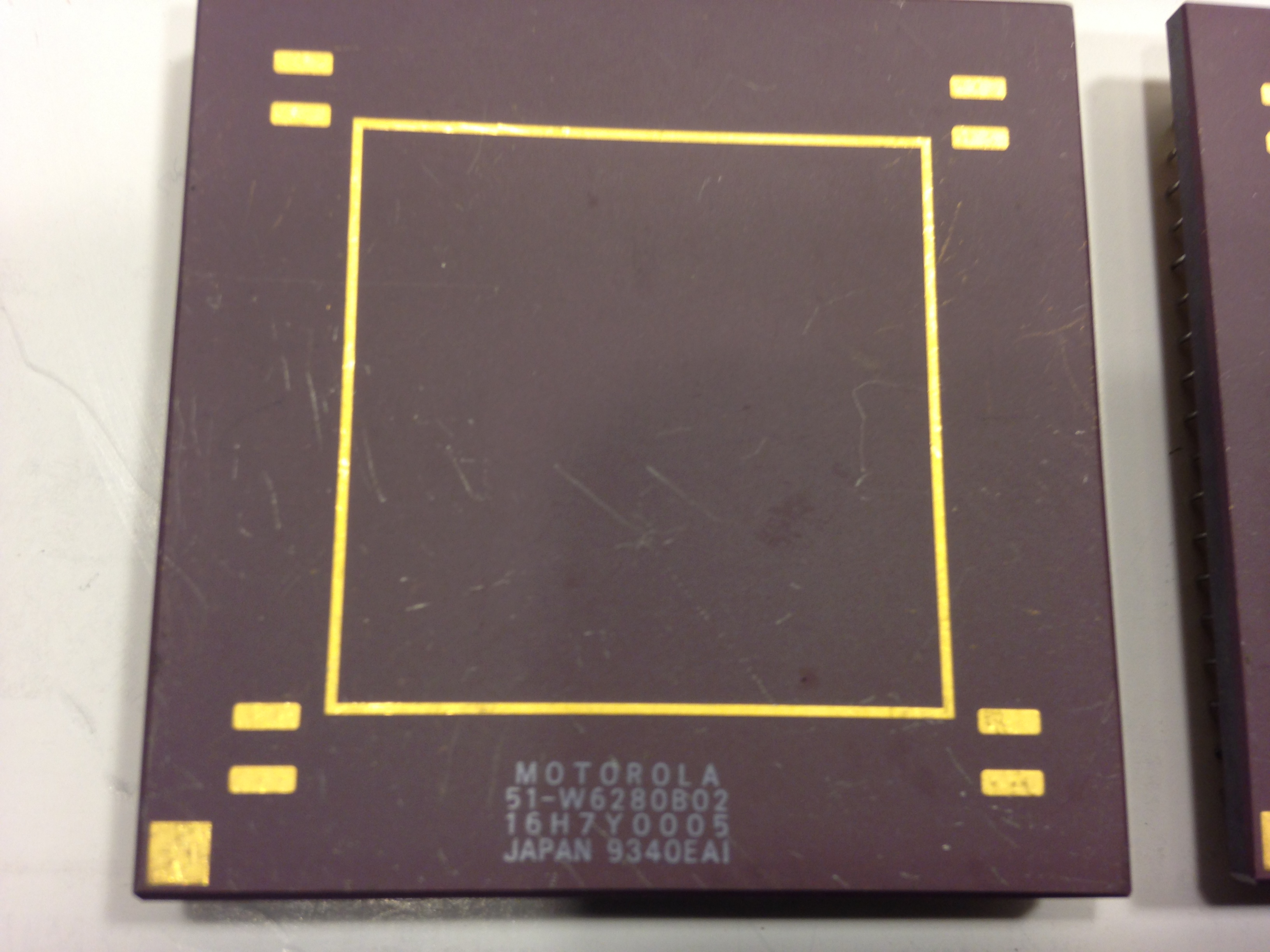

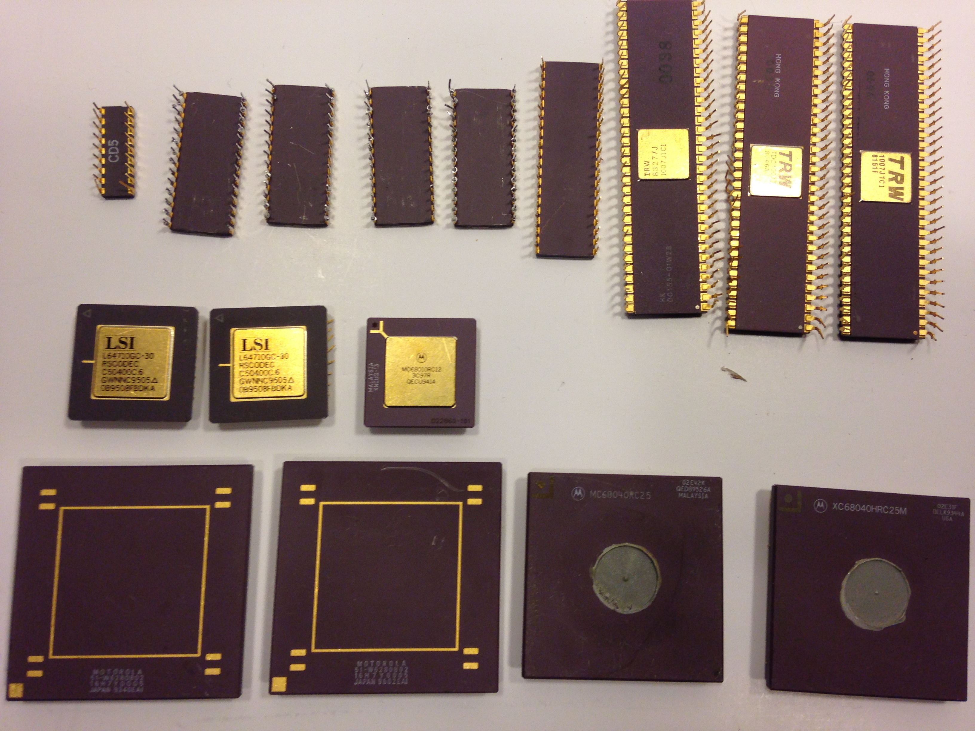

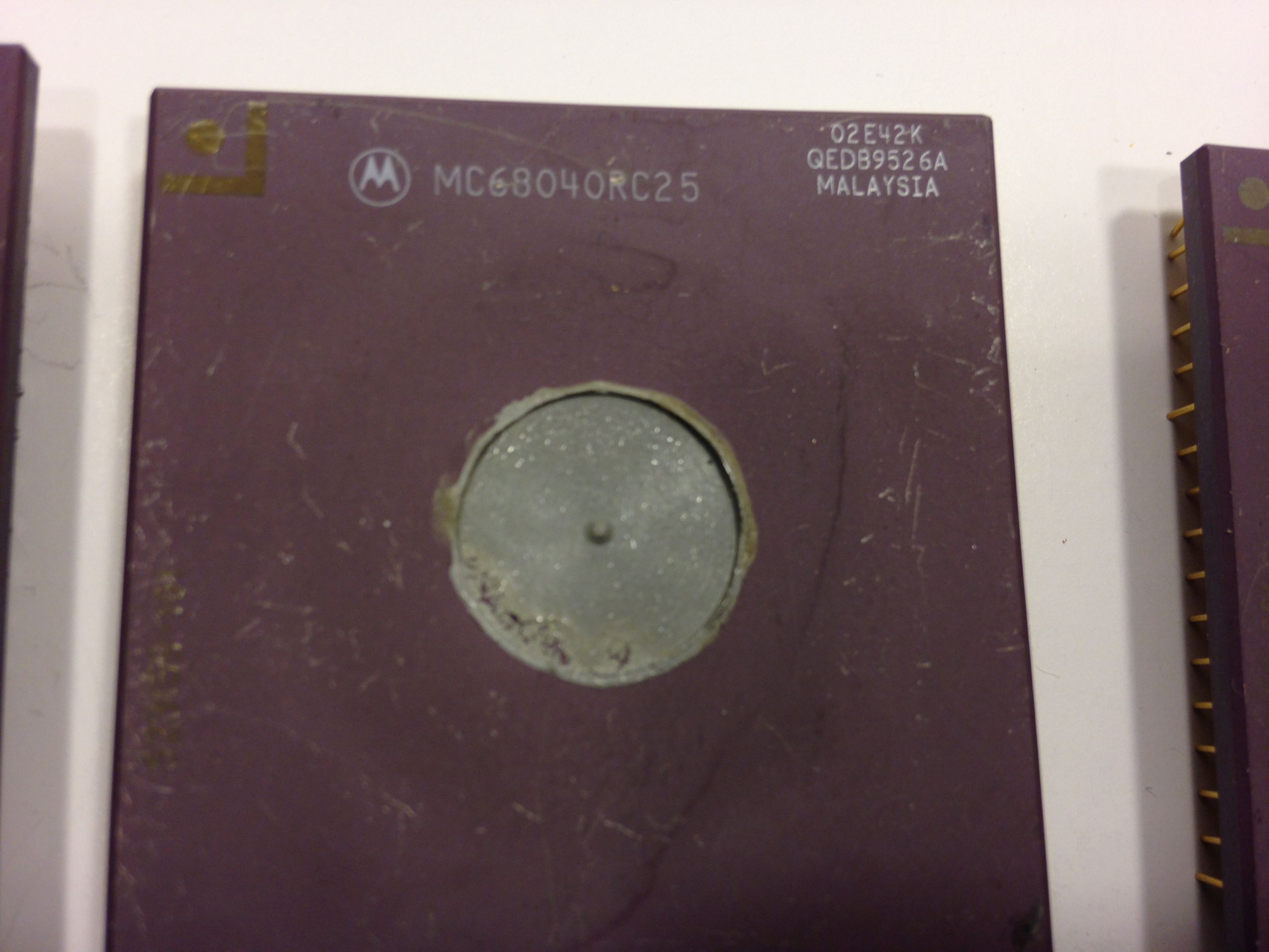

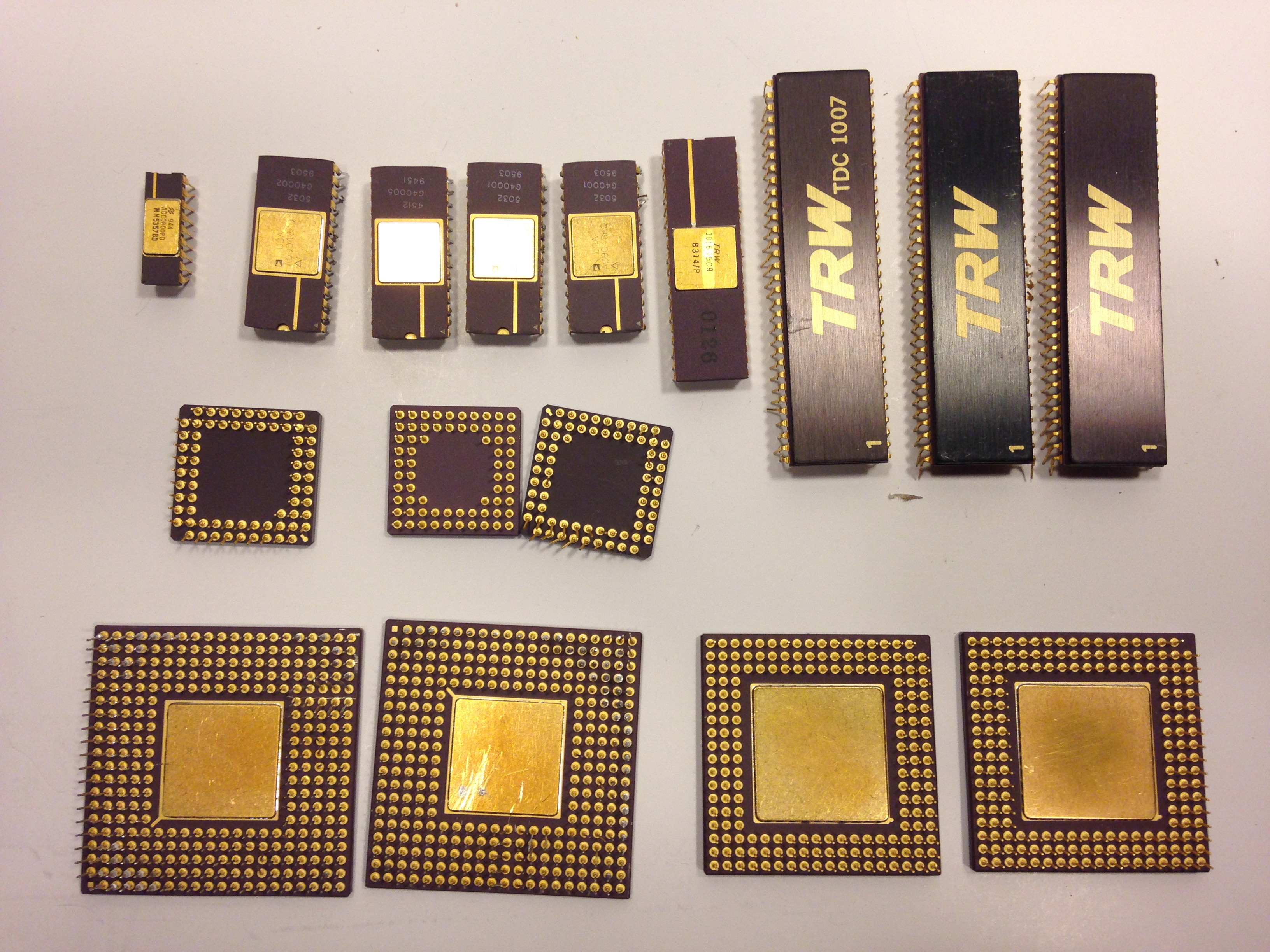

Better Pics...
PostPosted: Wed Nov 19, 2014 9:55 am
The large square chips will go as IBM/VIA/Cyrix gold caps. The smaller square chips may go as 386/486. The longer chips with gold legs and gold caps are going to go as either 8086 or motorola/foreign gold cap. The three that only have the gold legs may go as IBM/VIA/Cyrix gold caps.
