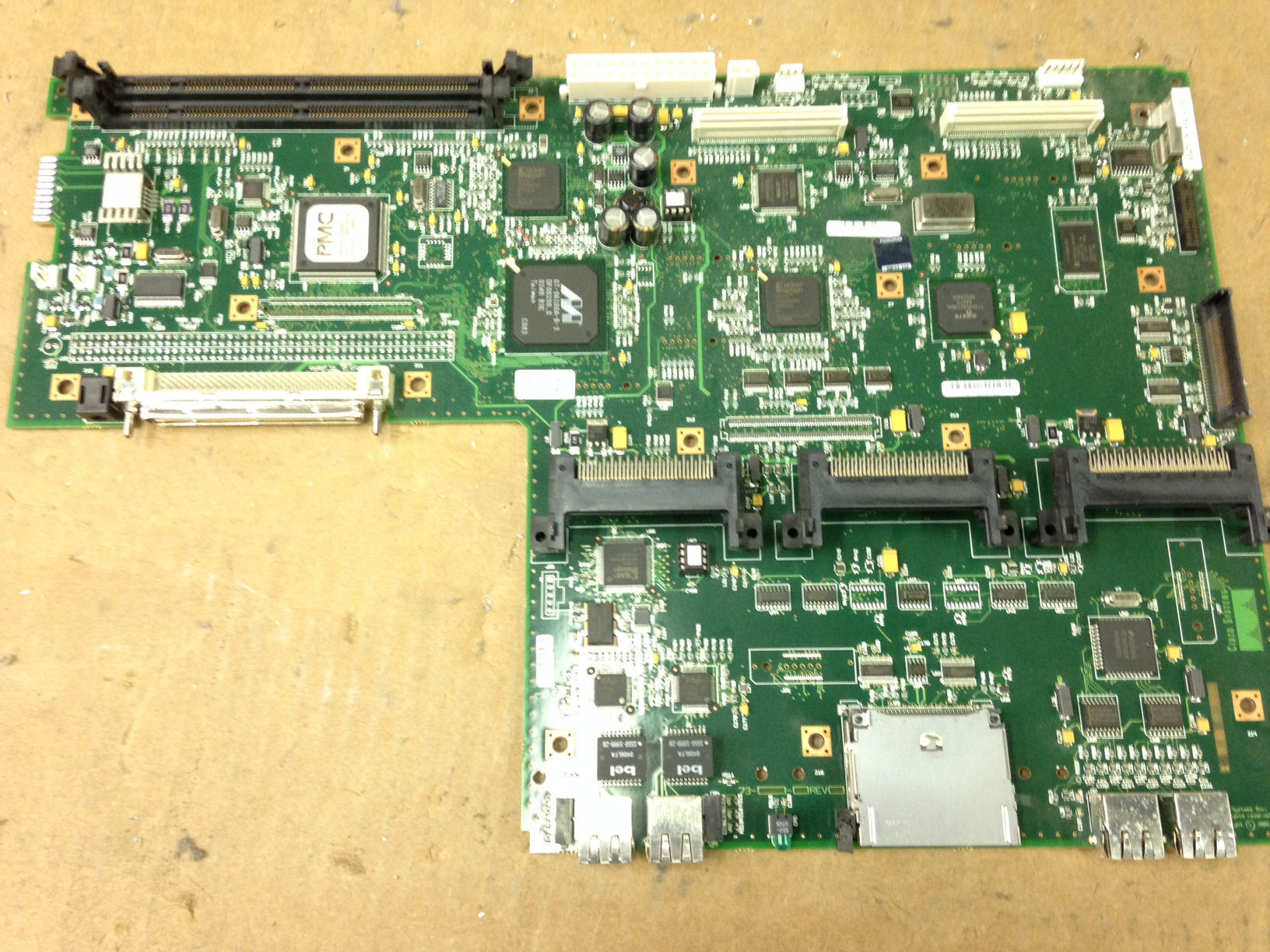

I've looked through many posts, have a pretty good idea what I have here, just wanted confirmation, Thanks!

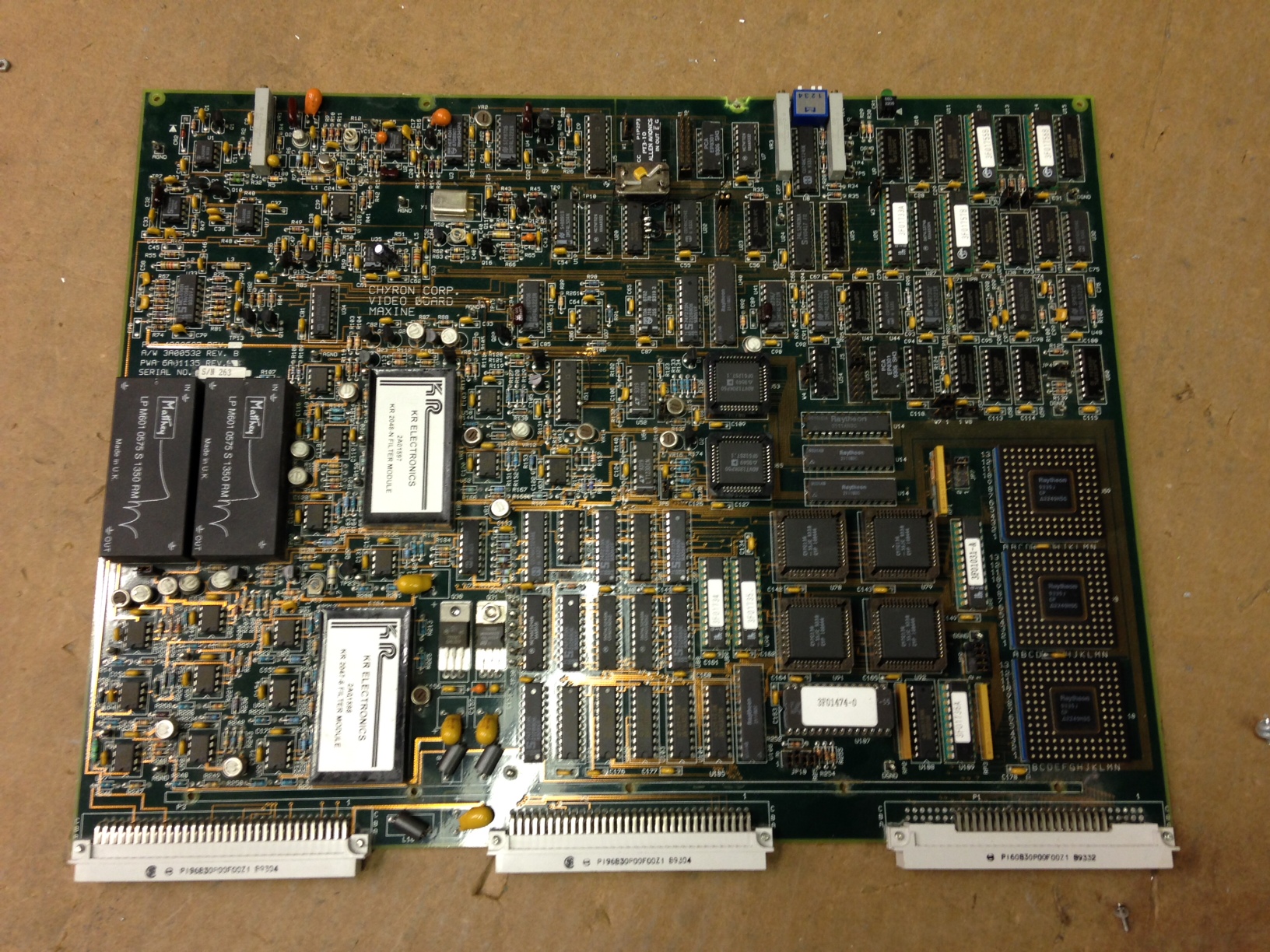

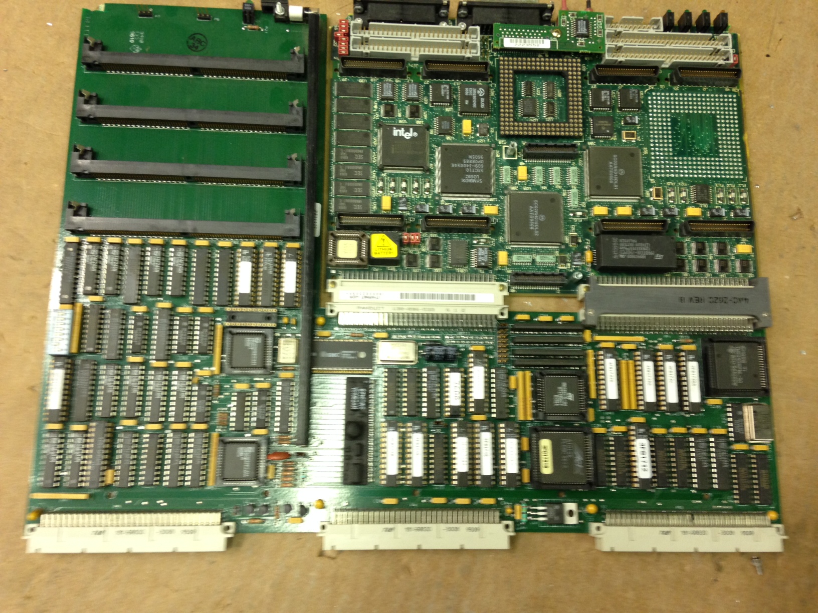

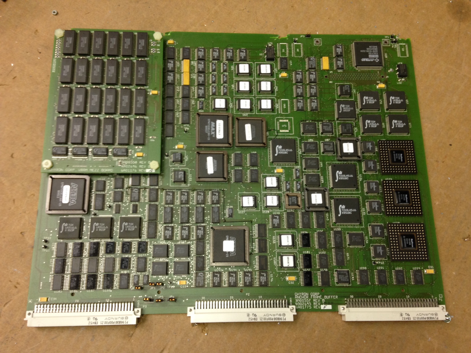

Second picture is peripheral foe sure. Third picture is telecom. No need to remove the little board since that board is telecom as well. Fourth picture you may get telecom or multiple socket board depending of the socket size

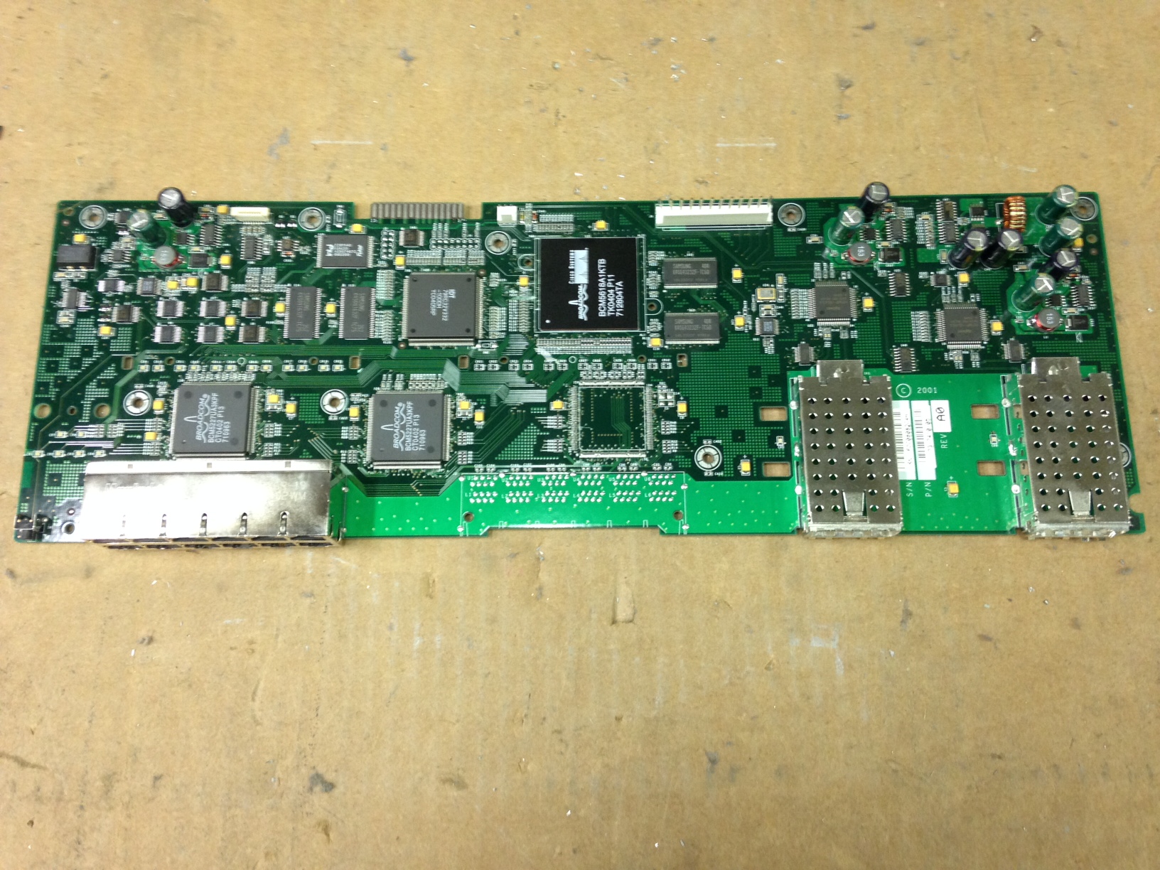

No comment on the 5th one eh... That could go as multi-socket too I guess. At this point it looks like I am going to have a fair amount of peripheral. Hope to find a local buyer for the peripheral and small metal socket MB. Not worth shipping...

A lot of your enterprise grade router and switch boards fall into the telecom category due to the number of flatpacks present and the existence of tantalum capacitors. Looking at your cisco boards, those will pass as telecom. Your fifth photo appears to be telecom grade.

Once it was determined these were peripheral I removed the flat packs and degraded the boards.... Oh well, Live and learn.
