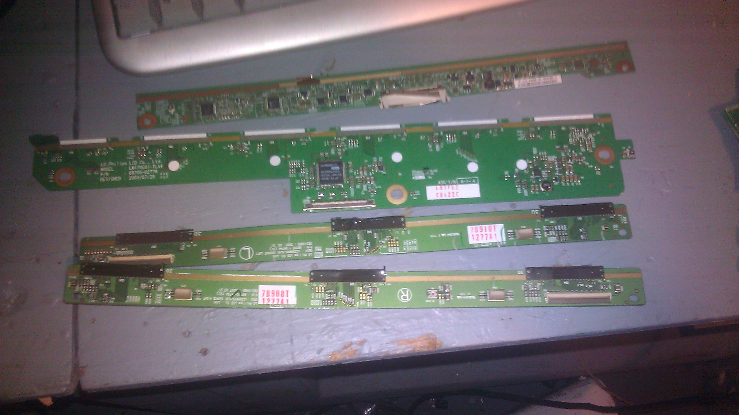

Need a little help. First one I was thinking small socket mb maybe, but peripheral at worst. Second are from flat screen tvs, and there's that gold strip running doen them that the connectors go to from the screen. Could it go as gold finger maybe, third I was hoping for high grade. Alot of IC chips, just each board has the connectors, don't know if this component woild help or hurt. Any answer as well as an explanation would be awesome to help me grade others that are the same. Thank you.

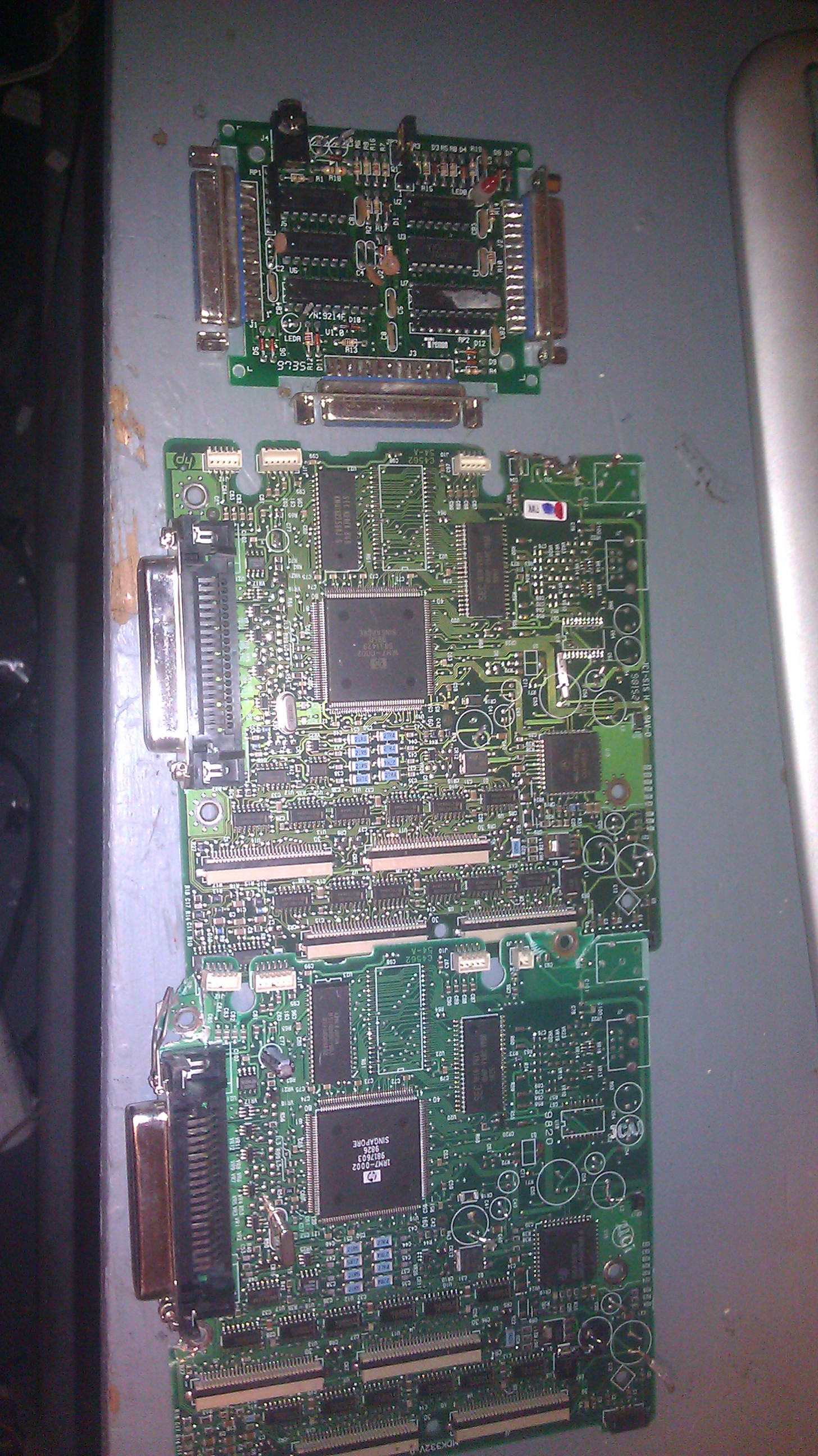

Second

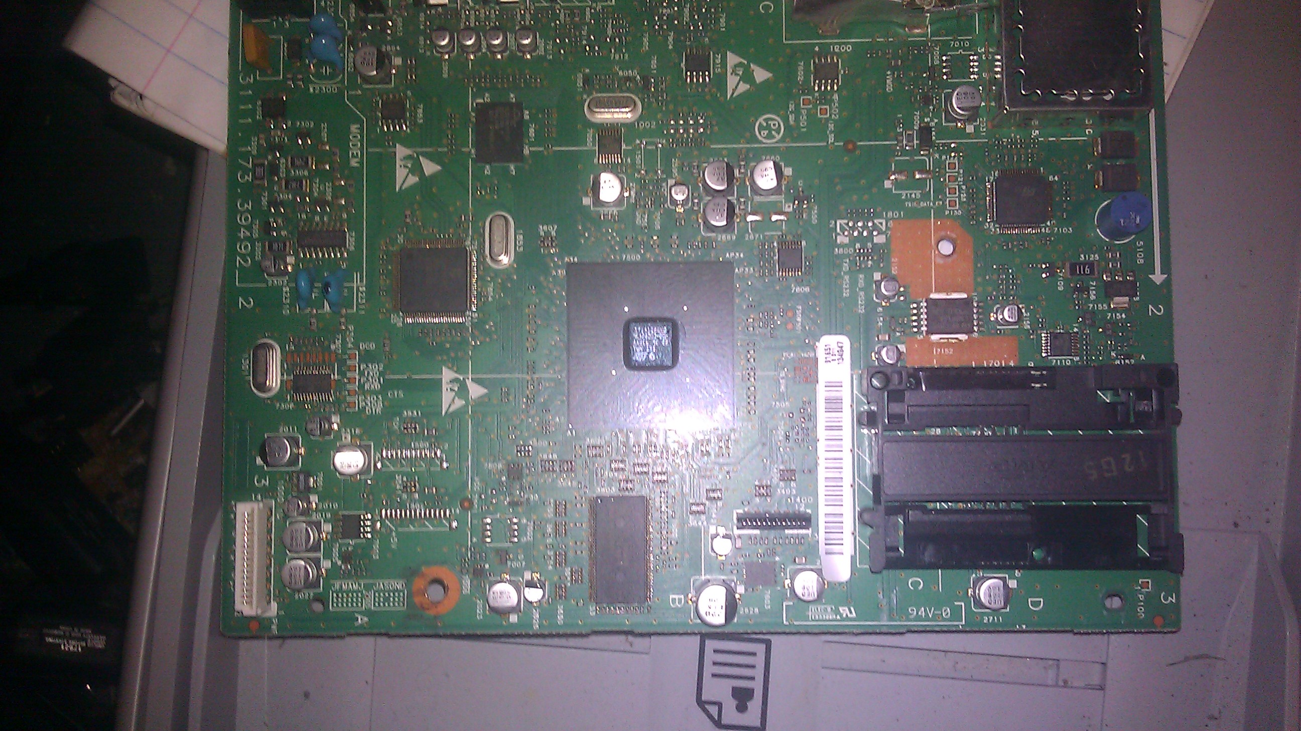

Third

The first and second images are peripheral. Check one of my posts from before.
viewtopic.php?f=4&t=155
The third picture I am leaning towards peripheral as well. I don't see a small socket like from a motherboard to give it that grade.

602 is right on all of these. Not enough IC population on any of the boards and no visible sockets or soldered components indicative of motherboards are present.
