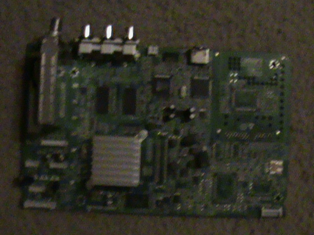

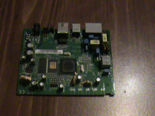

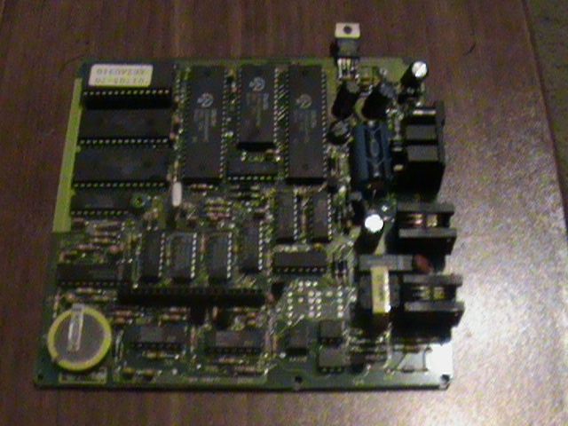

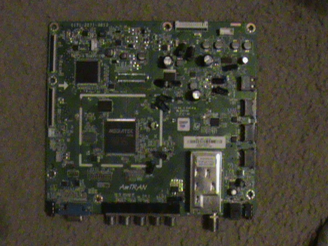

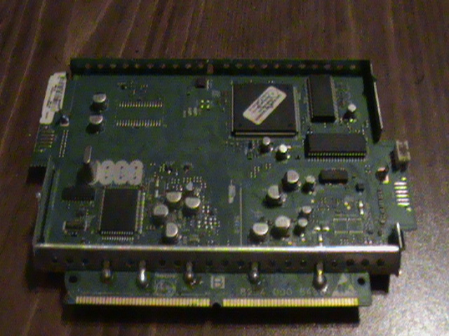

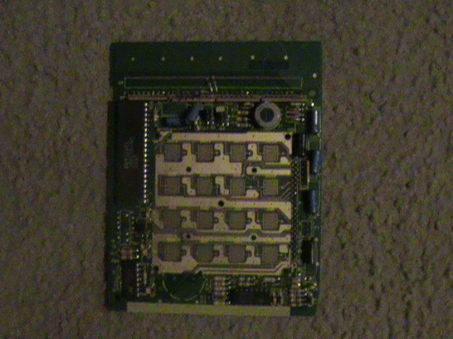

Different kinds of boards Im having trouble figuring out.
PostPosted: Tue Jan 20, 2015 7:46 pm
This is my take on those boards.
First is peripheral
Second board... If you remove the gold fingers you can sell that as Clean Gold Finger and the board would still hold peripheral grade as long there isn't much metal on it. If you leave the fingers on and remove a bit of the metal frame you may get Gold Finger Card grade.
Third is peripheral to me. You may get Telecom for it since it has good number of ic chips. Remove the battery
Fourth is more like Telecom due to the ic population. Remove the battery as well.
Fifth, sixth and seventh are peripherals. For the fifth picture remove the aluminum heat sink and sell it separately.
