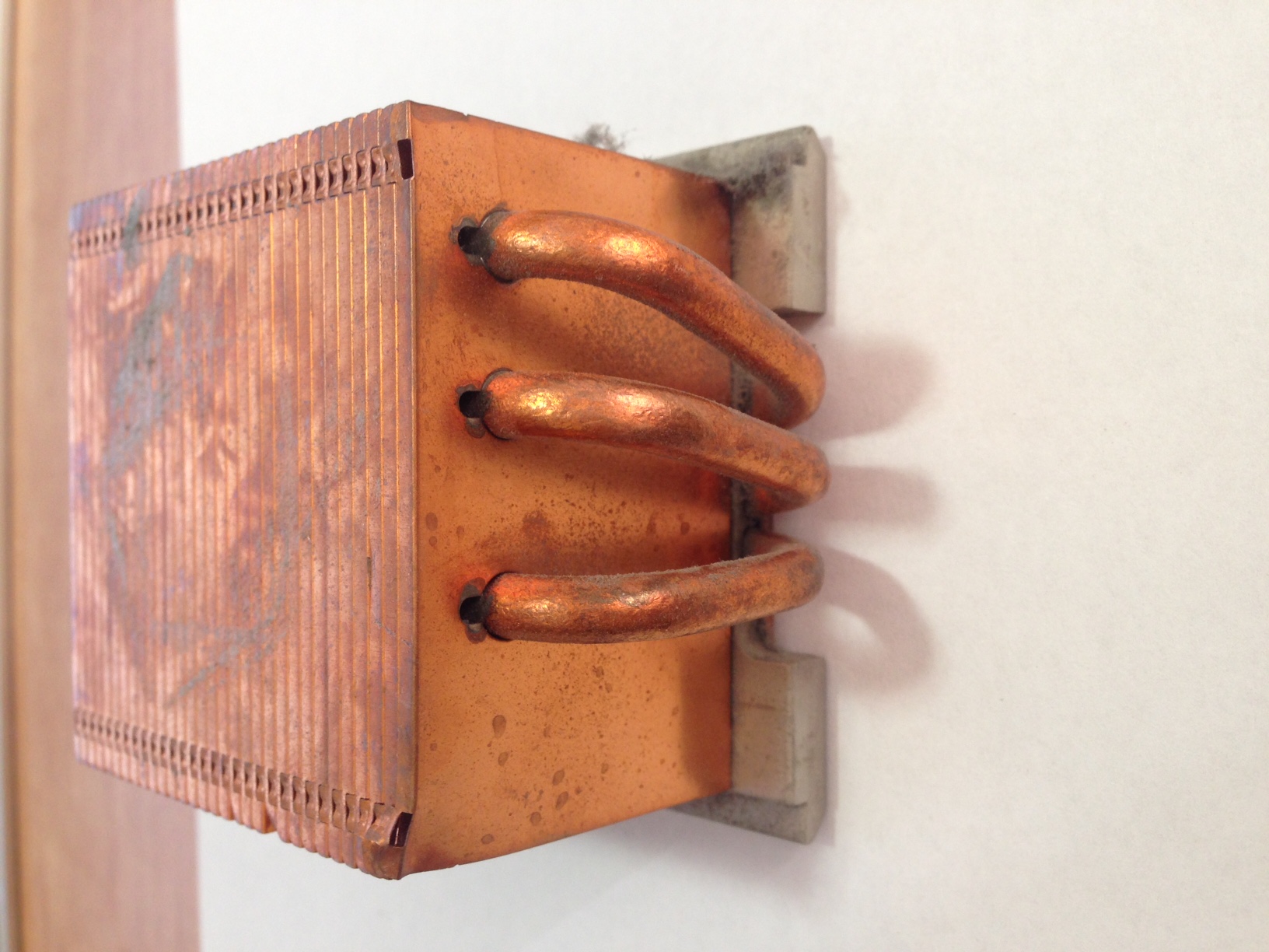

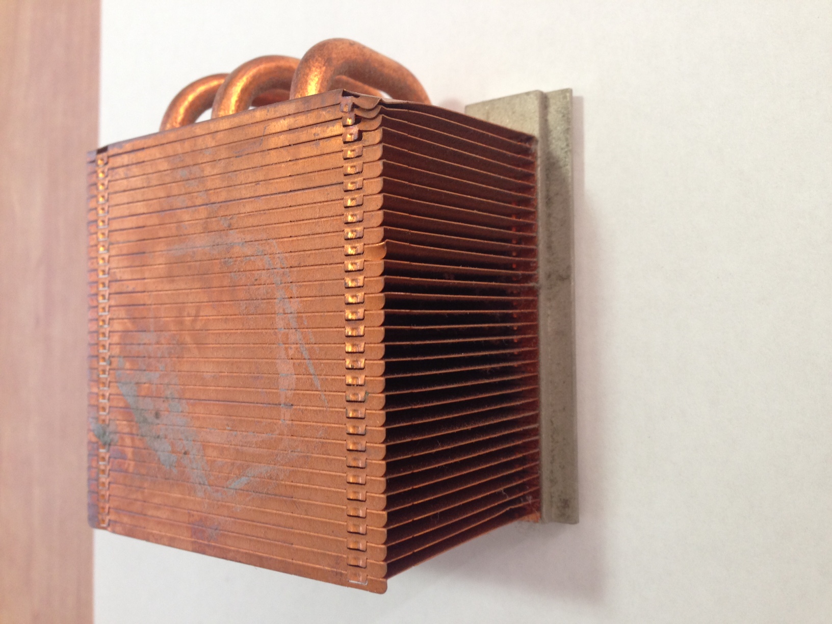

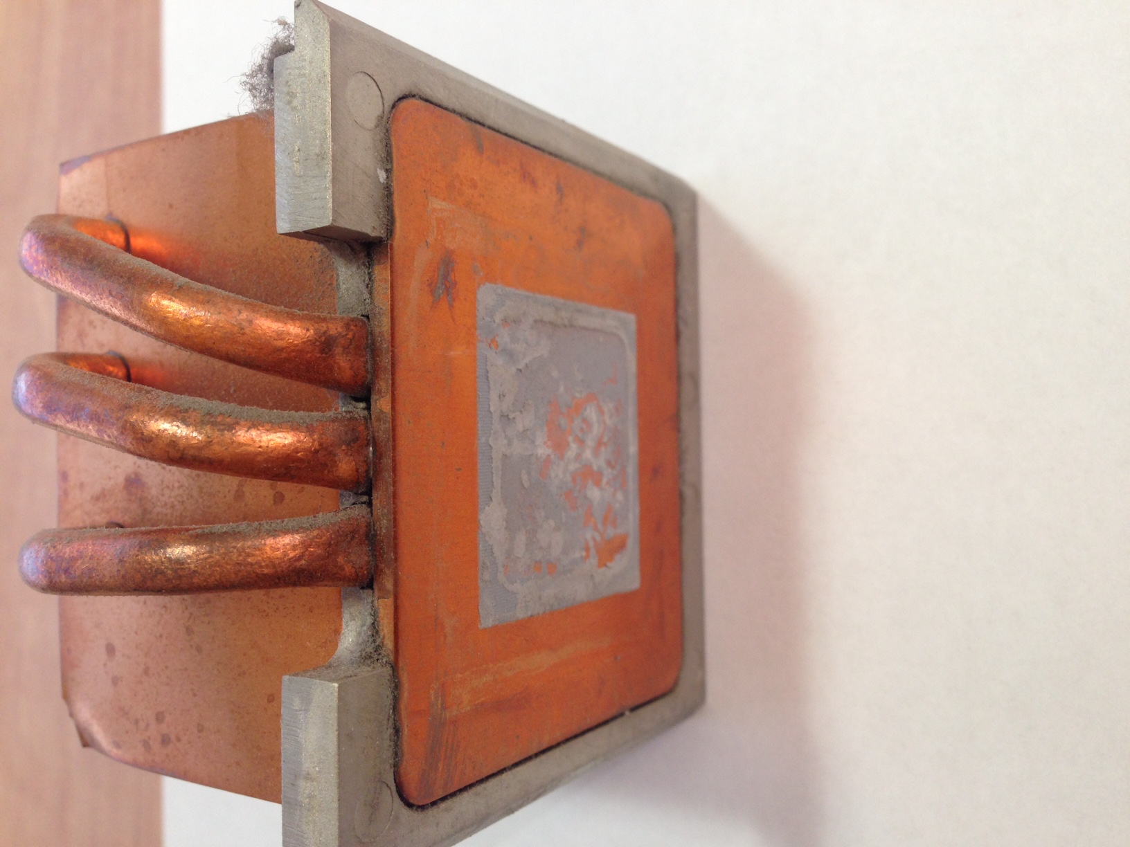

Hi guys,
would these heat sinks be considered 'Clean copper heat sinks' ?
thanks in advance

it has an aluminum plate on the bottom so not clean copper. remove the plate and it would be considered clean.

Check the base with a file before removing I have run into some that were still copper even though they look silver colored, This would be what they cll Tinned or plated. You have to file or hit with a grinder to verify if it is Aluminum Soft and stays Silver color), Stainless (this will stay silver but throw sparks on a grinder), Brass (will be Yellow under the coating) Or Copper (will be Pink under the coating)
That is something you really have to watch. While they give prices for all copper and also Silver coated Brass, I have never seen a silver coated Brass heatsink before. They have always been coated copper and if you say brass then that is what they will pay you which is 35-40% less.

I believe silver is not a good material to be used in heatsinks. It's likely that base is aluminum. A Dremel with a cutoff wheel or angle grinder may be your best tool to separate the aluminum from the copper. If you're not selling the heatsink to boardsort, check with your local scrap yards to see how much they will pay for it. If you separate the aluminum and copper, expect #2 copper price. If leaving it as is, you will get aluminum/copper radiator pricing in most places. In some states, you may need to be a licensed A/C technician or have a permit from a licensed A/C tech to be able to get Al/Cu radiator pricing.
