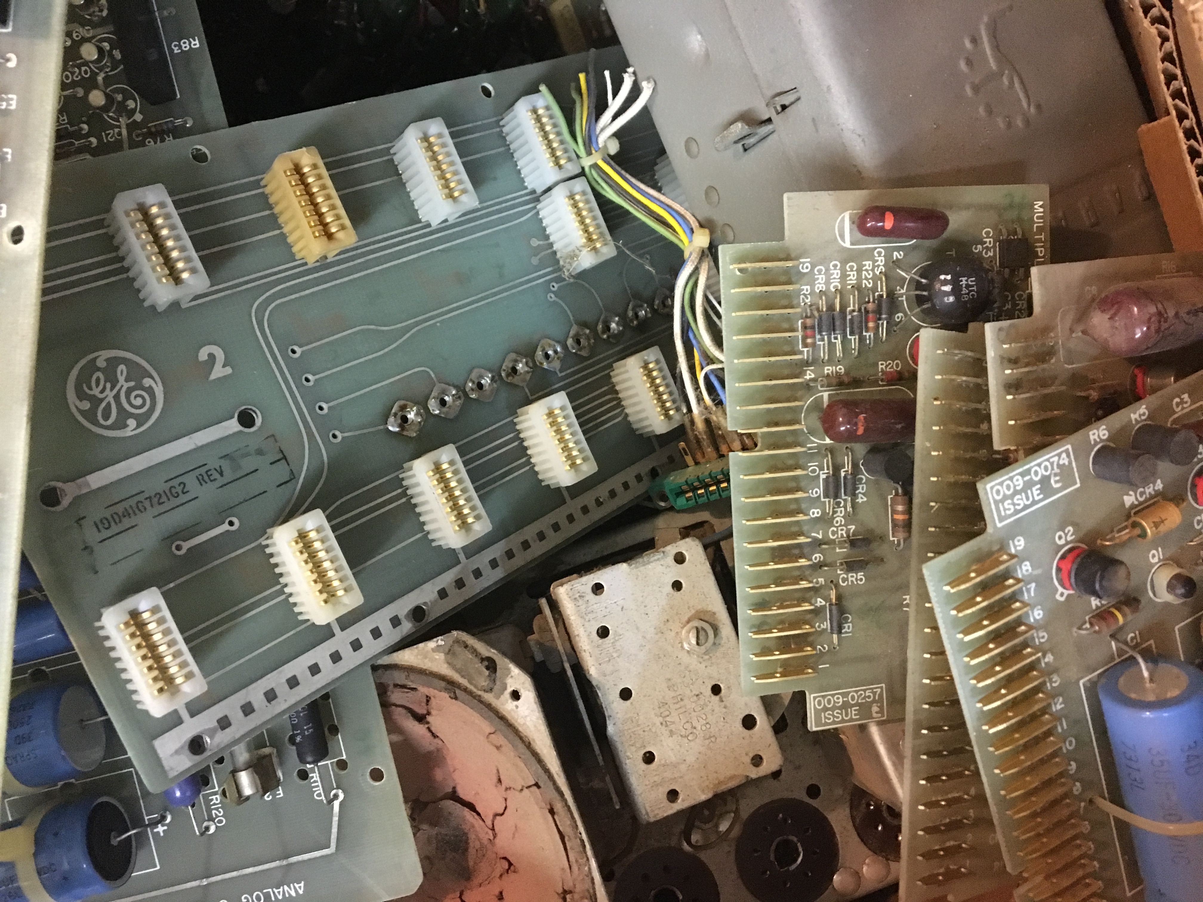

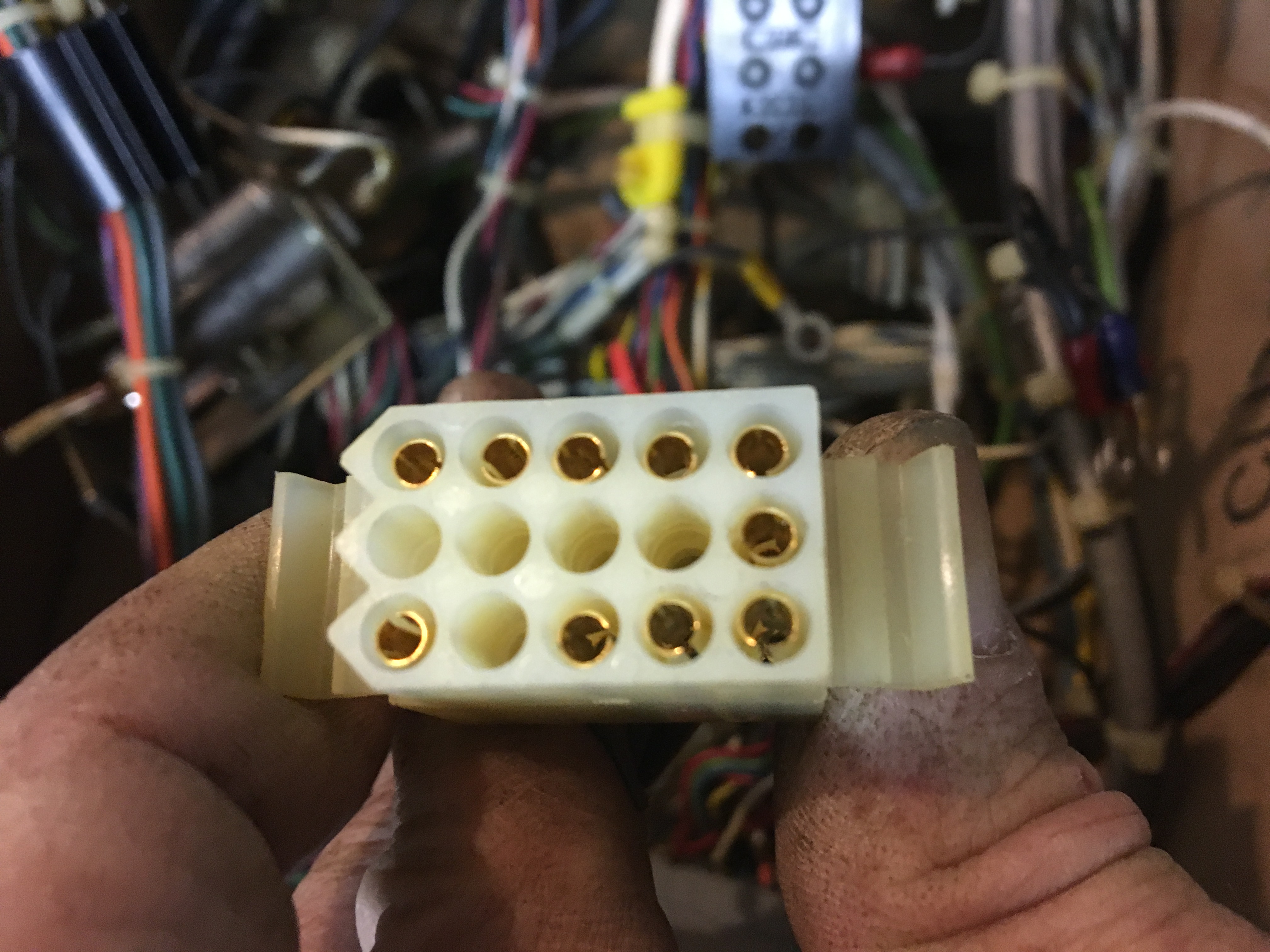

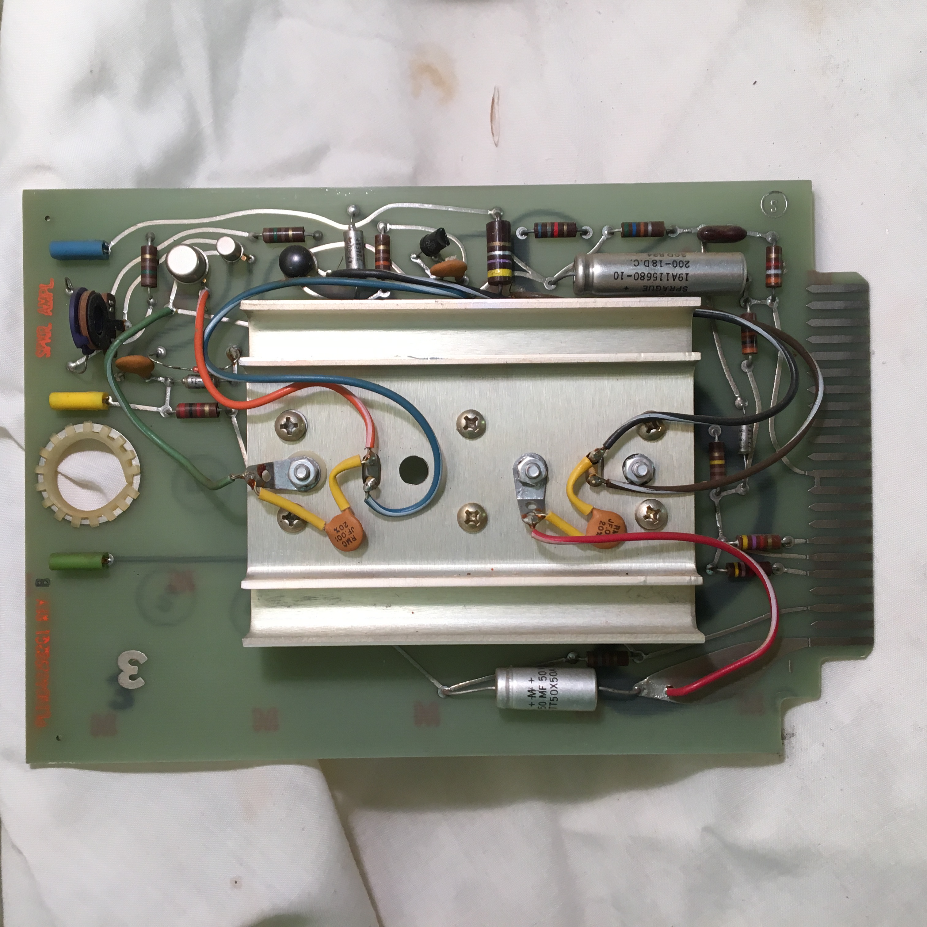

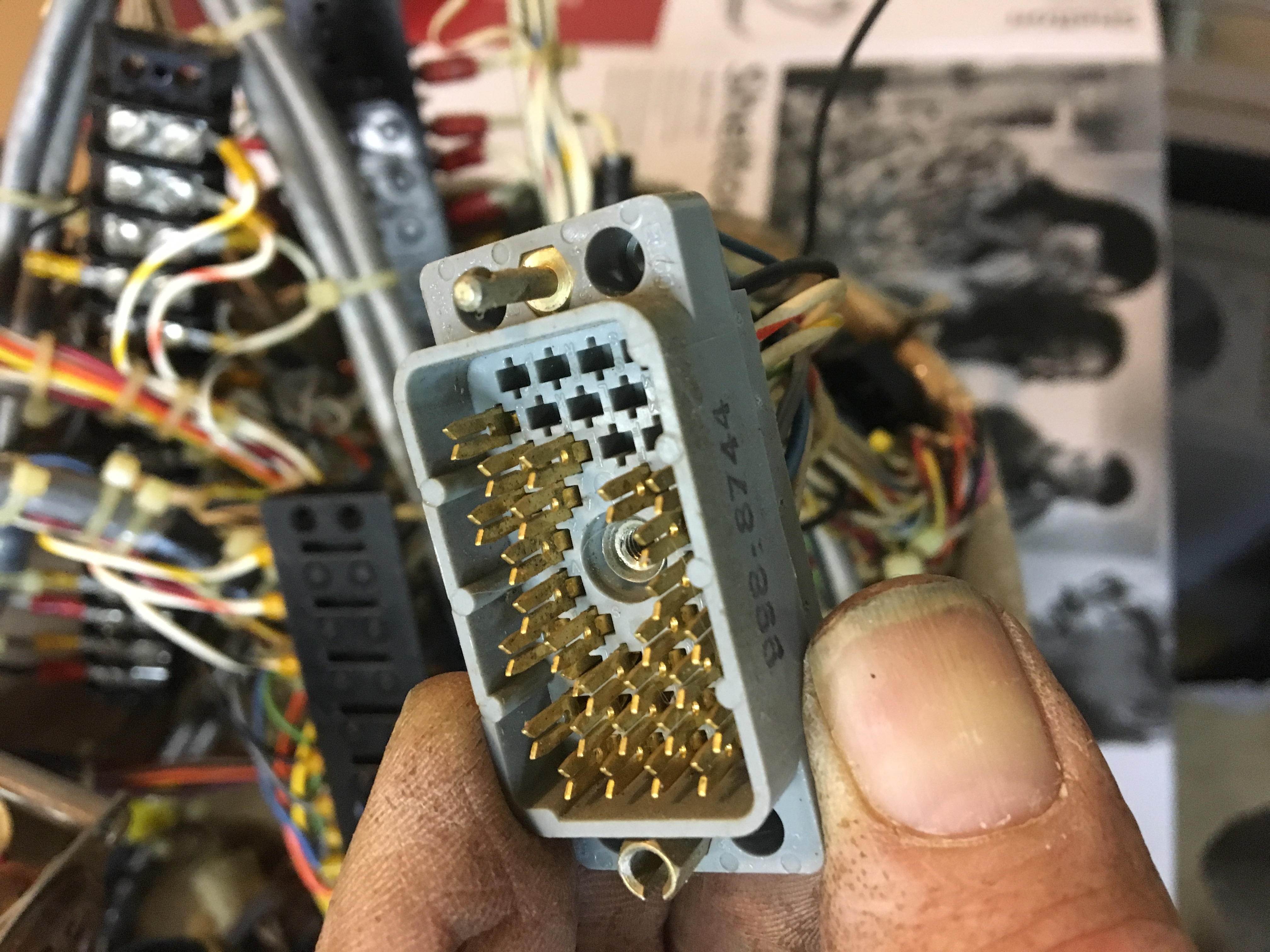

From 1970’s radio equipment. And an old gas chromatograph. Lots of boards with what appears to be gold connectors. Big transformers, big capacitors, lots of silver colored wiring Newbies not sure how to proceed
PostPosted: Thu Jul 26, 2018 10:29 pm
The first two would need to be quoted out on reception they’re better than gold pin connector most of the time and not good enough for pin or peg board classing.

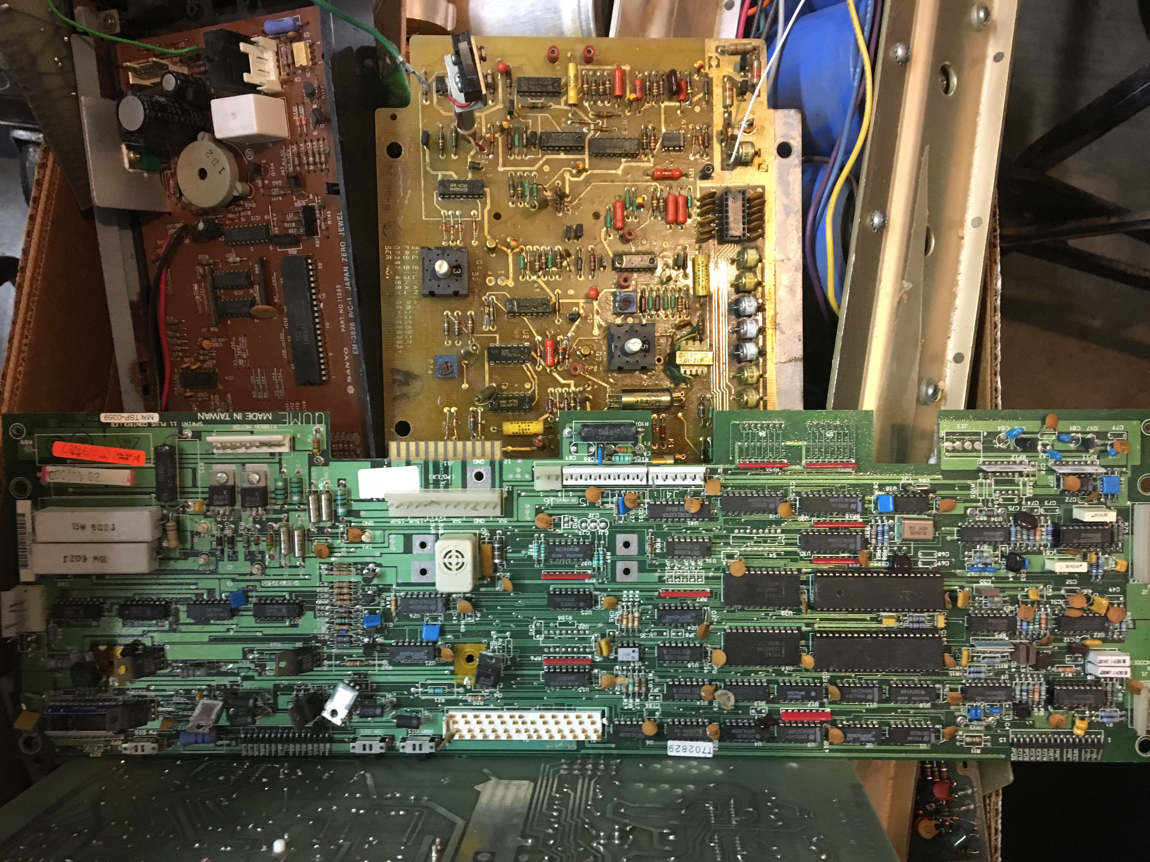

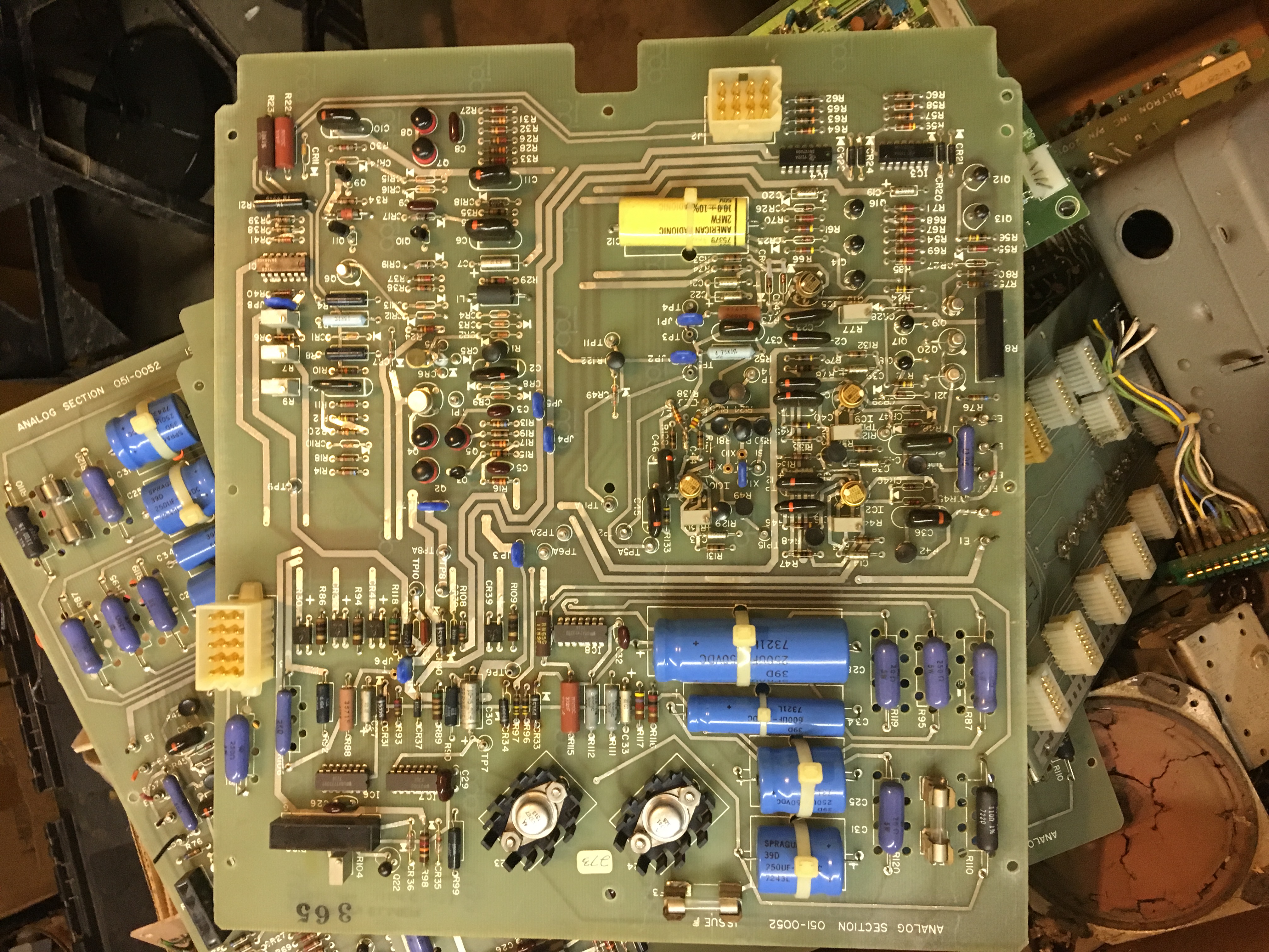

3rd photo, the green board is peripheral. The brown board is low grade UNLESS the etching is gold. Where it would definitely receive an upgrade, probably to peripheral.4th pic the GE board is peripheral and the boards with the big capacitors are low grade.

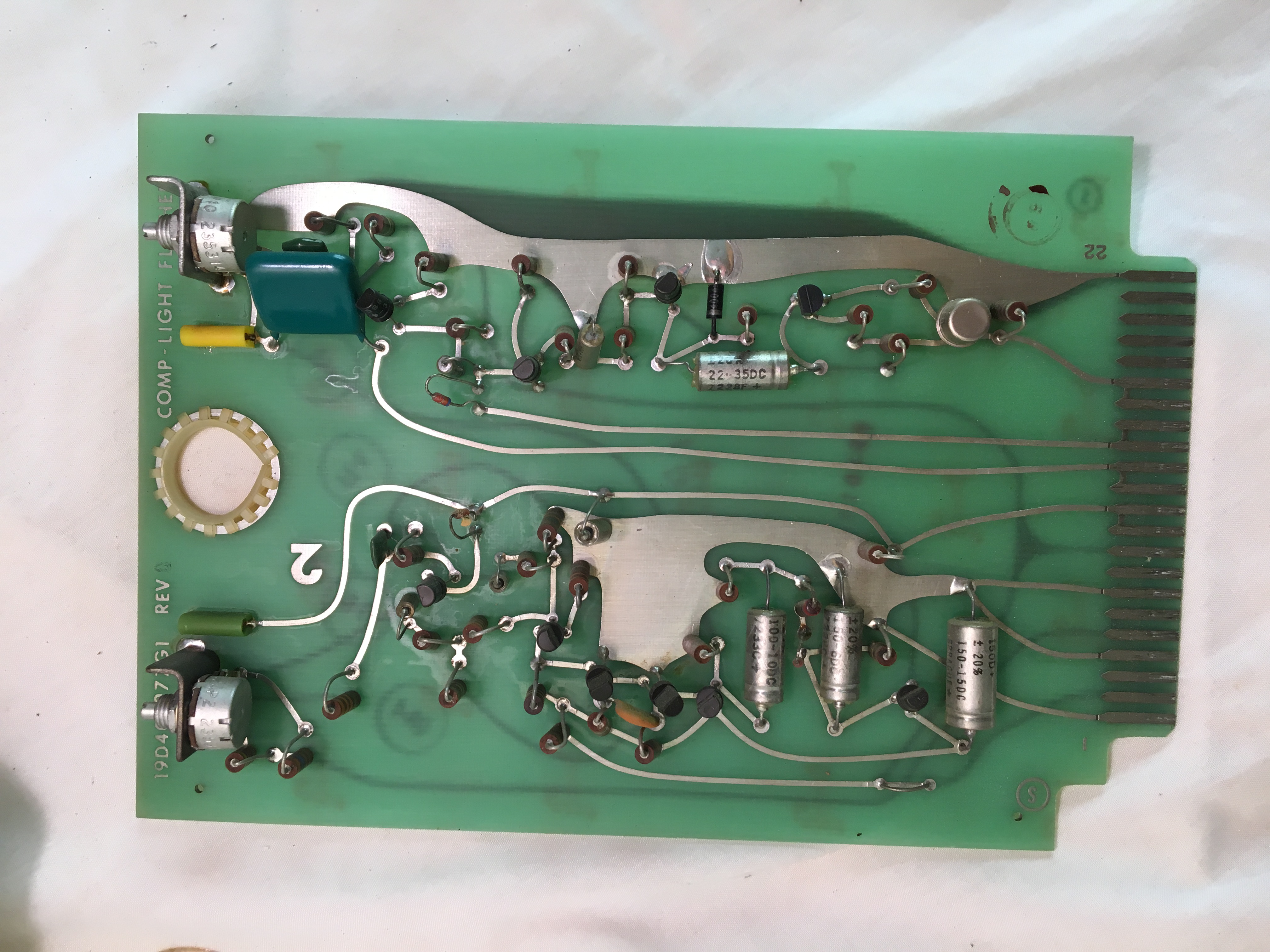

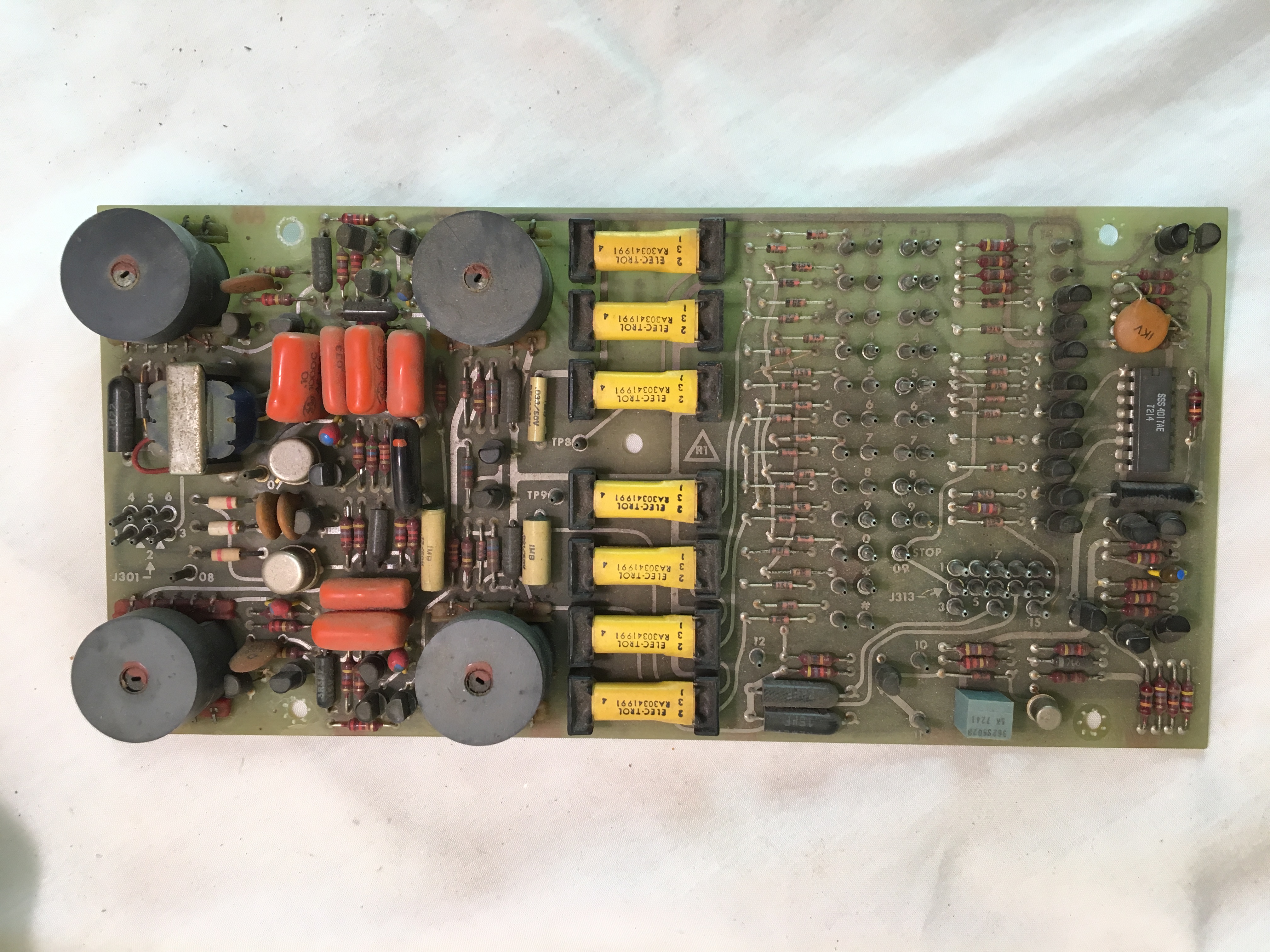

Last board is low grade. My suggestion is grab a set of slip jaw pliers and rip the pin connector off for clean gold pins, or if you don’t have slip jaws grab regular pliers and snap the boar. It would fall in line with the first two photos.

Thanks, that helps a little. The last pic that you said is low grade has a dozen of those shiny black circular components that are transistors with three gold plated legs.

midgrade
That second one....
Midgrade
Anyway the ones with the silver or nickel fingers will go as peripheral as long as they don’t have any transformers on them and have an IC of reasonable size.
Without an IC it’s hit or miss depending on other things
It’s very similar to pinball boards and organ boards I’ve sent to Chris. So I don’t see a problem.
Back to the second board. Normally in this age group and general class of boards the solder mask would be Lead. bUT! I have never seen a lead laydown so cleanly done. Ever. There’s a chance it’s silveride; silver alloyed with aluminium and/or nickel. Which with that amount could bump it to peripheral. On the other hand it could be an early use of tin and then maybe you’d get midgrade for it. I’m leaning to silveride and hence peripheral as it follows the etching to the edge connector (finger) and hence I’m leaning peripheral.
Stuff in this age group is always hard to classify, my suggestion is to post photos and we’ll all do our best but some things, like that second one, are ultimately going to need in hand inspection.
