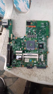

Supplying to a small refinery here in Lagos as there aren't really any e-waste scrap yards. One of their requirments (apart from quantity) was to remove capacitors, transformers, cooling elements from the boards.
I'm mostly dealing with cell phone boards and laptop boards so i'm curious, are there any transformers on these boards? I've removed the capacitors from most of them but i'm not clued in on what transformers and cooling elements are.
I've attached some pictures of some of the boards. Trying not to make any mistakes that can be potentially dangerous.
Thank you

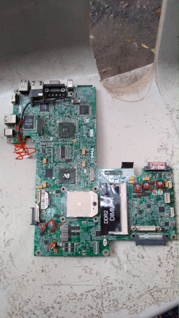

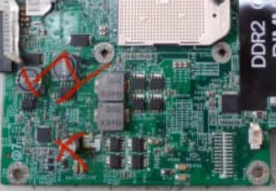

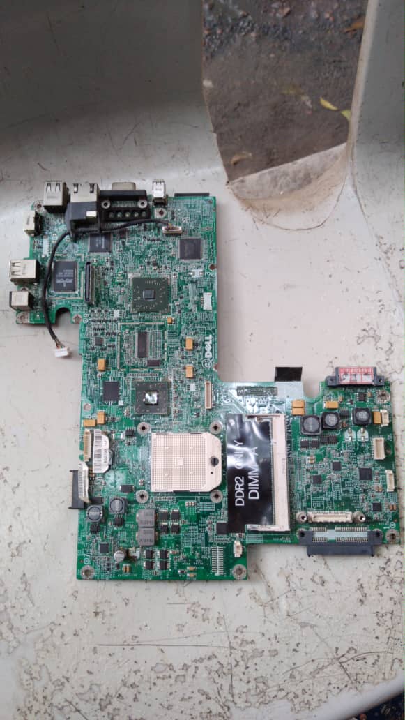

Wires, naughty!
This isn’t complete but gives you something to look for.

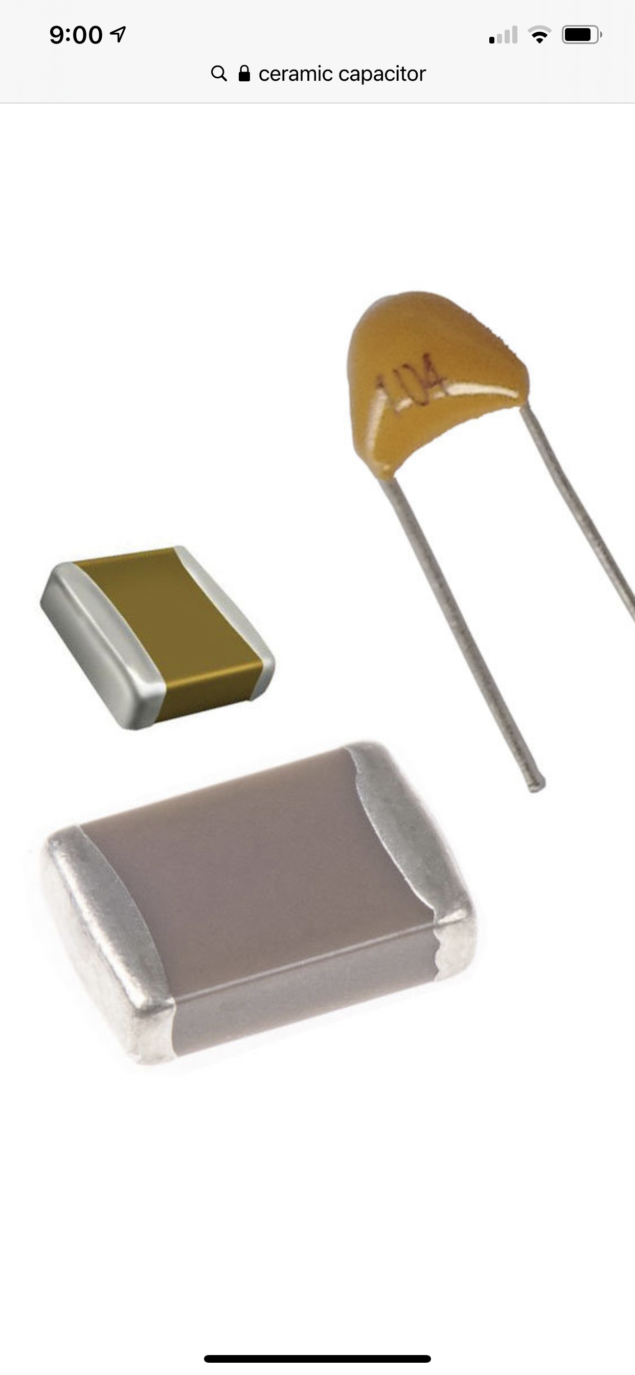

Regarding MLCC's, do you have any pictures so i'll know what to look out for.

They’re little itty bitty tiny bread loaves or long stick Walker things.
The former have platinum and/or palladium. The latter tantalum.
As I said leave them on.

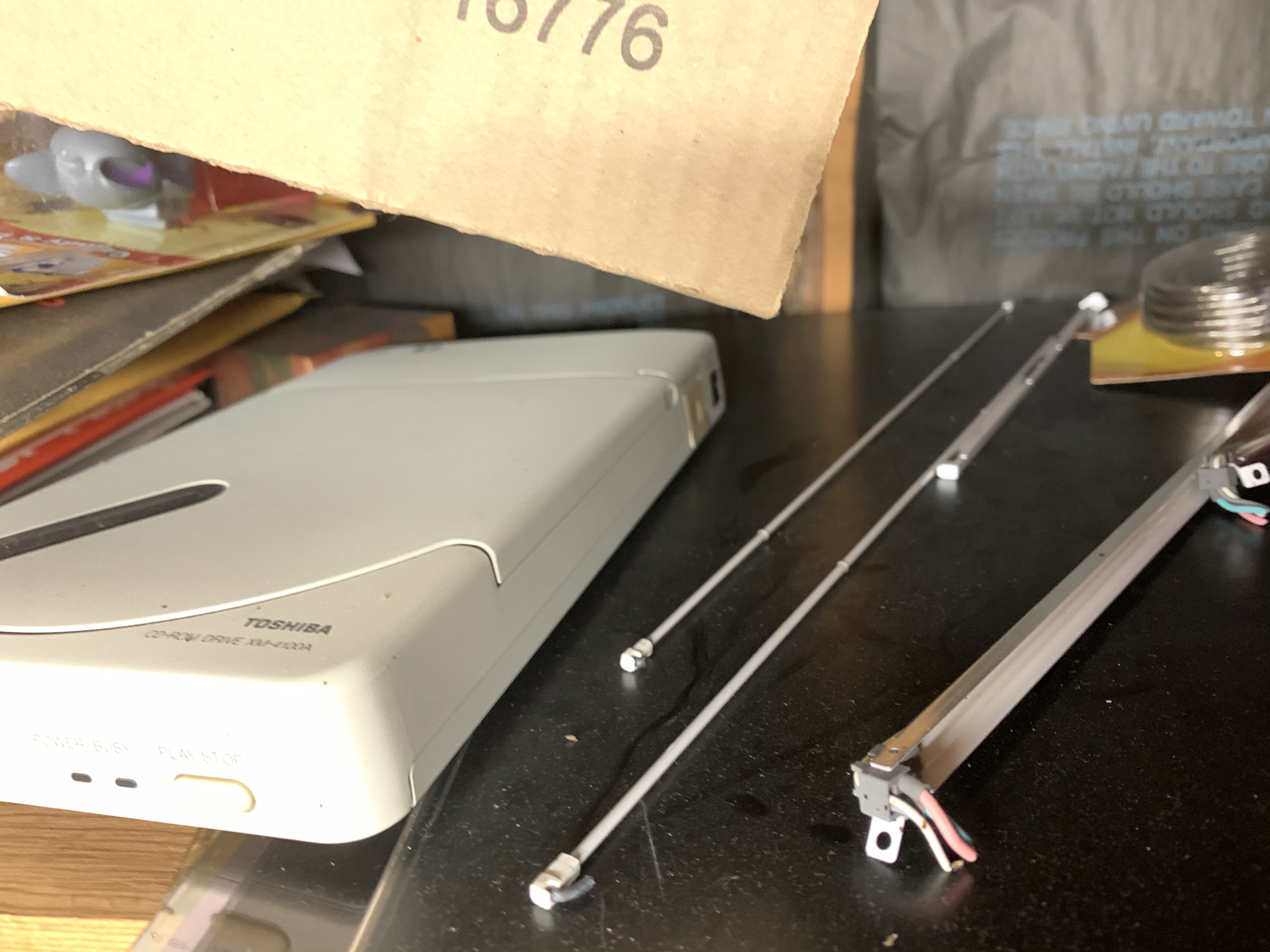

Finally Mercury is in old tiny Florescent tube backlights. Give me a moment to take a photo rather than looking them up.
PostPosted: Sun Jan 31, 2021 11:07 pm
Posts: 10555
Backlighting

The bits you highlighted in the pictures i put up (i've attached it), are those capacitors too?
PostPosted: Mon Feb 01, 2021 6:31 pm
Posts: 10555
I can’t be positive from the original photo but I believe they’re ceramic regulators.
Just rack them with a wrench or hammer and dump the powder into the recycling bin. Don’t use a magnet. I made that mistake once and ended up recycling the magnet. Couldn’t get all the microscopic dust off it. Just dump it.
