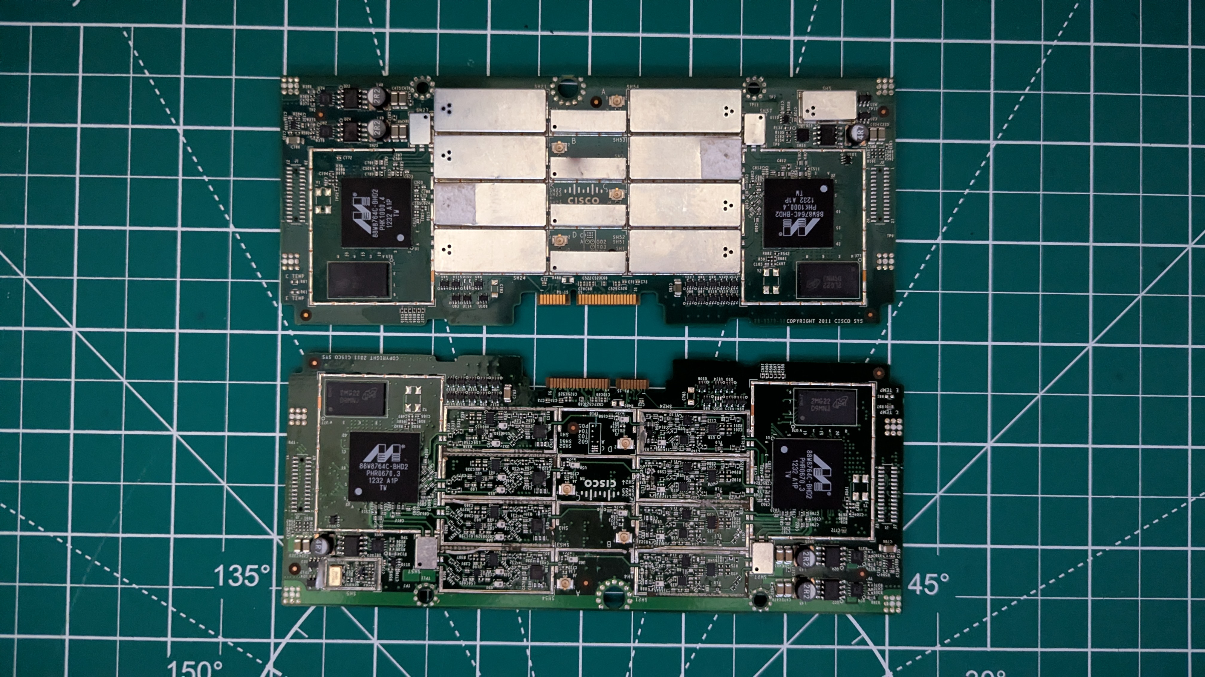

Is there a better method to removing the second type? I have piles of boards with 10+ pieces of this type of shielding per board and it takes forever to remove it all. It takes so long using the methods above, and I have so many of them, I'm genuinely considering just sending the damn things in w/ the shielding in and taking the hit on them being graded lower.
File comment: Here's an example of a board with way too many of the second type of shielding, with and without the shielding.

I have a few Cisco WAPs like that and I know exactly what you are talking about. I use a sharpened putty knife about an inch wide and pry between the shields. If you have a table you can lay the board on and have some kind of backstop so you don't have to hold the board while prying the shield it makes removing them much easier. Once you get to the last shield you can access it from the side. I'm not sure how much it will lower the value of the board by leaving the shields on so I take them off.

I've tried various sizes of flat head screw drivers, pry bars, picks, chisels, etc. but it never occurred to me to try a putty knife. I can see where it having a fine edge and stays flat (versus the taper of a chisel, for example) it might work well. I'm headed to the hardware store tomorrow with a few boards to try some putty knives out in the store. :)
I definitely prefer to remove the shielding to max out the value but I have HUNDREDS of these boards. Hopefully the putty knife is a marked improvement for me. I may also try hitting them with some heat to see if it loosens them up at all.

You could use a paint scraper as well. I use a one inch wide one as well.
Both are roughly the same thing, scraper and putty knife but you want to use metal not plastic
