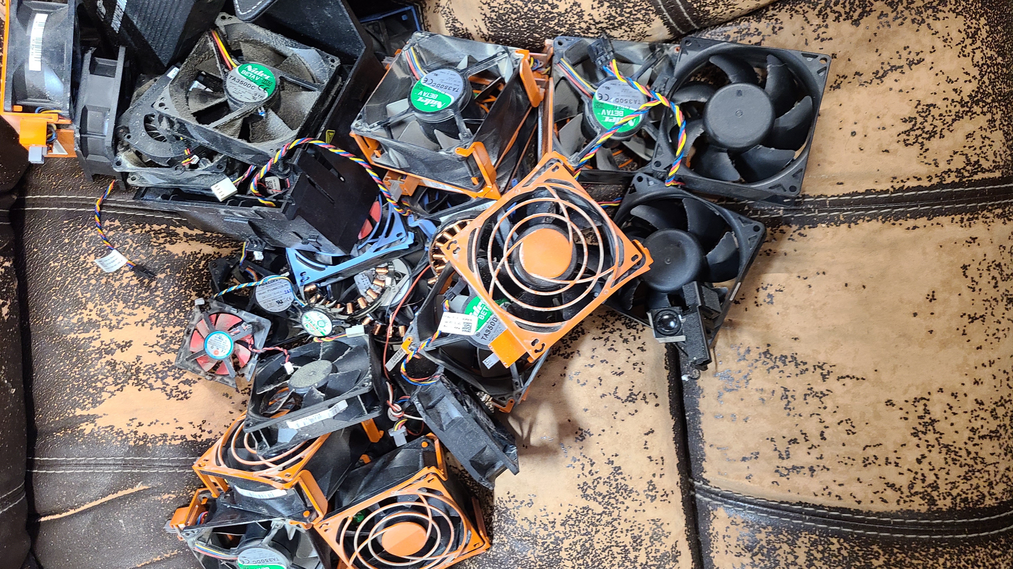

This is the pile I have so far.

The motor inside will be purchase as Motor/Transformer here but it must be completely removed from the fan assembly. Motor only.
As they are in the photo it would be considered rubbish at our yard and would have zero purchase value.
