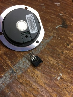

Lost,
I was reviewing your post on hard drives.
The picture with the aluminum motor and silver connector.....are those pins silver?

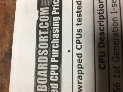

The second picture with the rhodium......where is the rhodium?
It may need to take pictures of what I have and have you point it out to me.

PostPosted: Mon Jul 03, 2017 1:14 pm
Posts: 10616
Directly above the C in CPU
I don't recall this exact hard drive but the pins I've normally come across are nickel, silver, and gold plated nickel.

Lost,
lol I'm a little slow.....
"Directly above the C in cpu"
I didn't understand what you were saying when I first read that...lol
I see that silver spec in the picture, my question is where is it at in the hard drive?
Would it be worth the time and effort to recover it from roughly 150 hard drives?

PostPosted: Thu Jul 06, 2017 8:13 am
Posts: 10616
It's a tiny dot on the paper to the right of purchasing and to the left of CPUs.
PostPosted: Thu Jul 06, 2017 8:21 am
Posts: 10616
Looks like we're all messing up today; lol.
They're attached to the read heads. And the rhodium is attached to that pieces.
Is it worth it? Well...!
I can dissect a modern drive in 30 to 45 seconds from whole to parts. That's from practice telling me where all the various screws are and what size. Habit more than anything. Whole you're looking at 50c-$1 and apart $3+ so there's value. If it's worth it to you.
If you're going as far as breaking down the drive snipping the ends of the read arms off is a 1 second thing.
Again they weigh nothing but add up quickly. I keep them in a plastic pill bottle. That extra moment to snip the heads off is worth it if you've gone that far.
