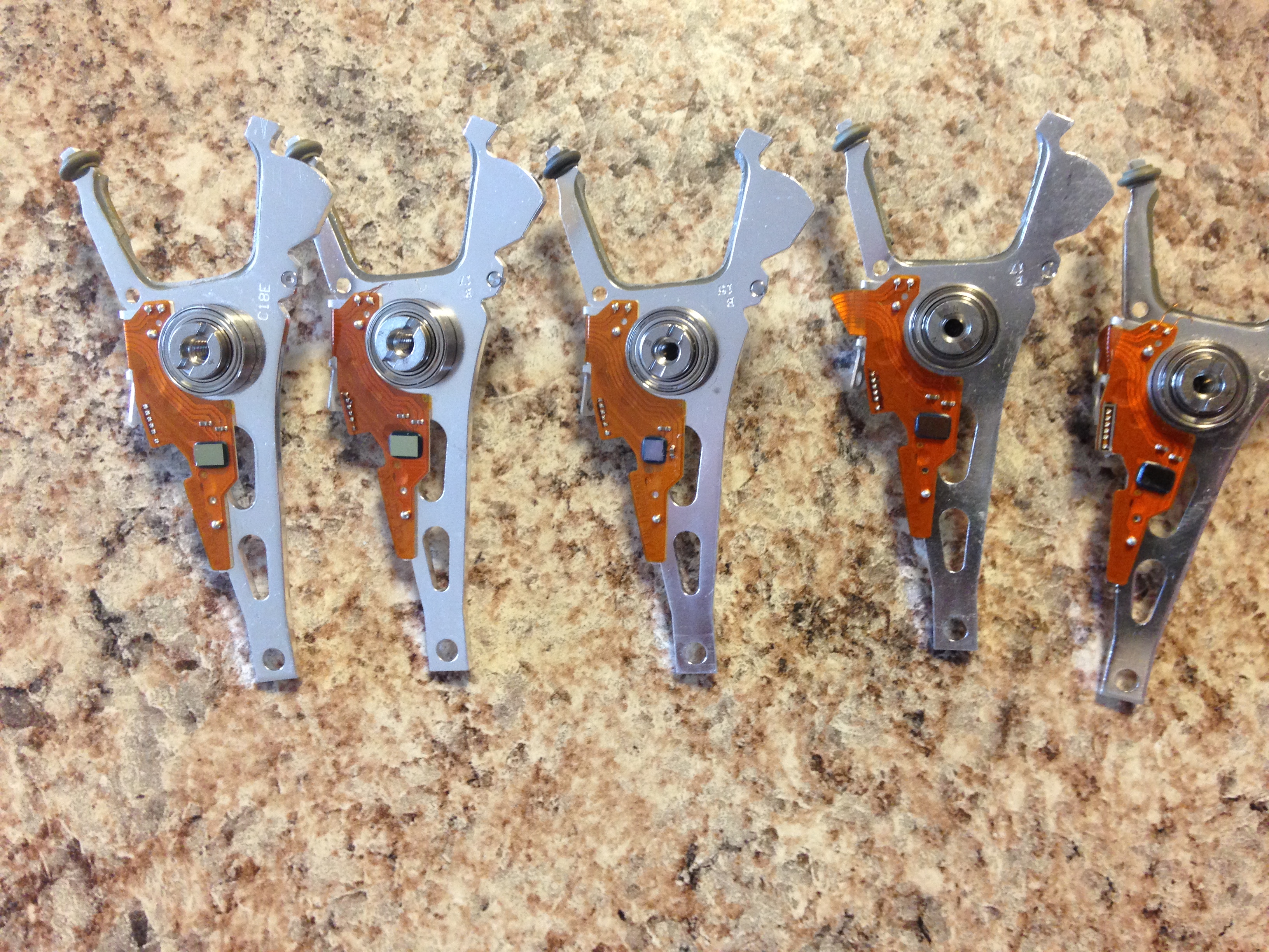

I'm still trying to make sure I'm on the right page with the rhodium. The tiny squares is what I'm looking for right?
Can rhodium have a gold tint or is it always silver colored? Some of the squares have a slight gold tint to them.
If this is in fact what I'm looking for what's the best way to get them off the drive head?
Thanks for all the help :)

Looks like it's been removed already here. It's a tiny pickup on the heads at the tip.
I'll pull another one apart in a short while and post better pictures than I did before.

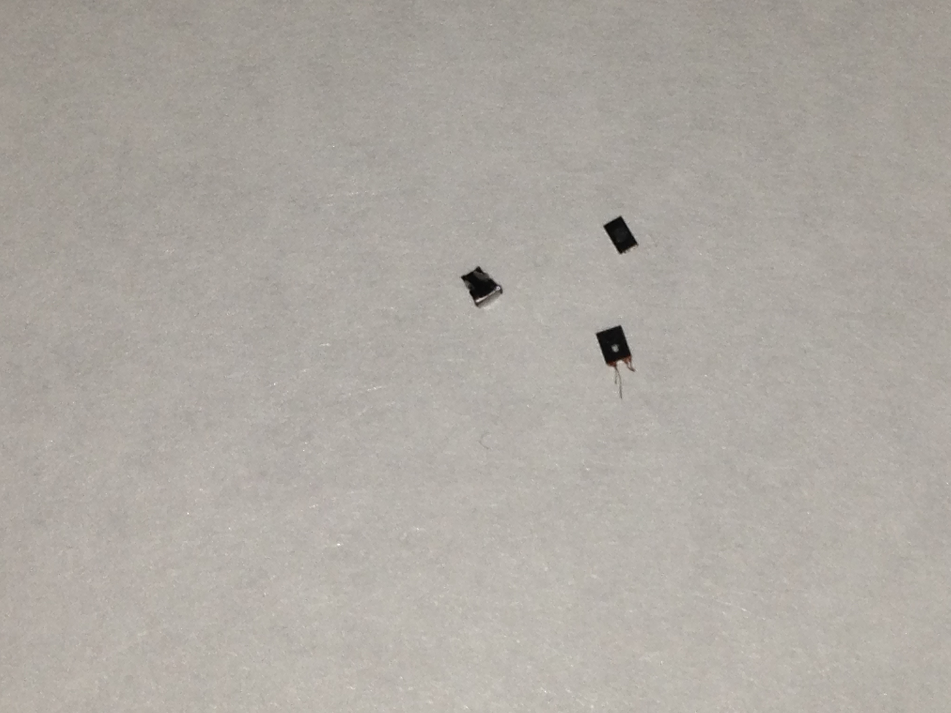

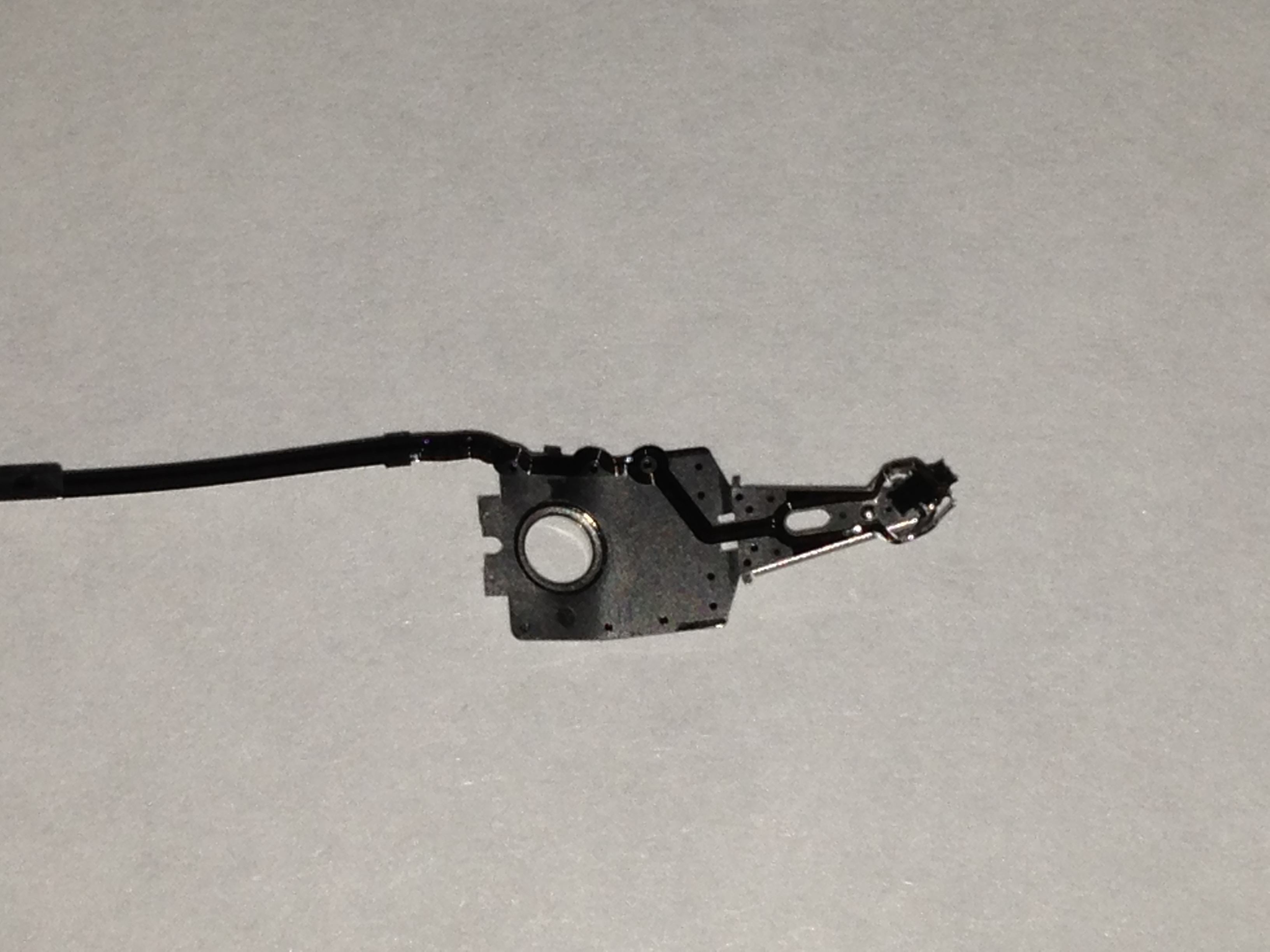

Ohh ok I may have pulled the right part then. I will take a picture of the pieces I pulled and post it and see if I have the right thing.
PostPosted: Mon Jul 10, 2017 4:31 am
Posts: 750
Location: Texas
Let's try these pictures :)

There you go. There's a tiny piece of metal on the very tip end . The pickup (wrong term but you understand eh) Usually a high content rhodium alloy.
Actually it's the same idea as record needles and their diamond chips. Save enough there's some money there; in both cases.
