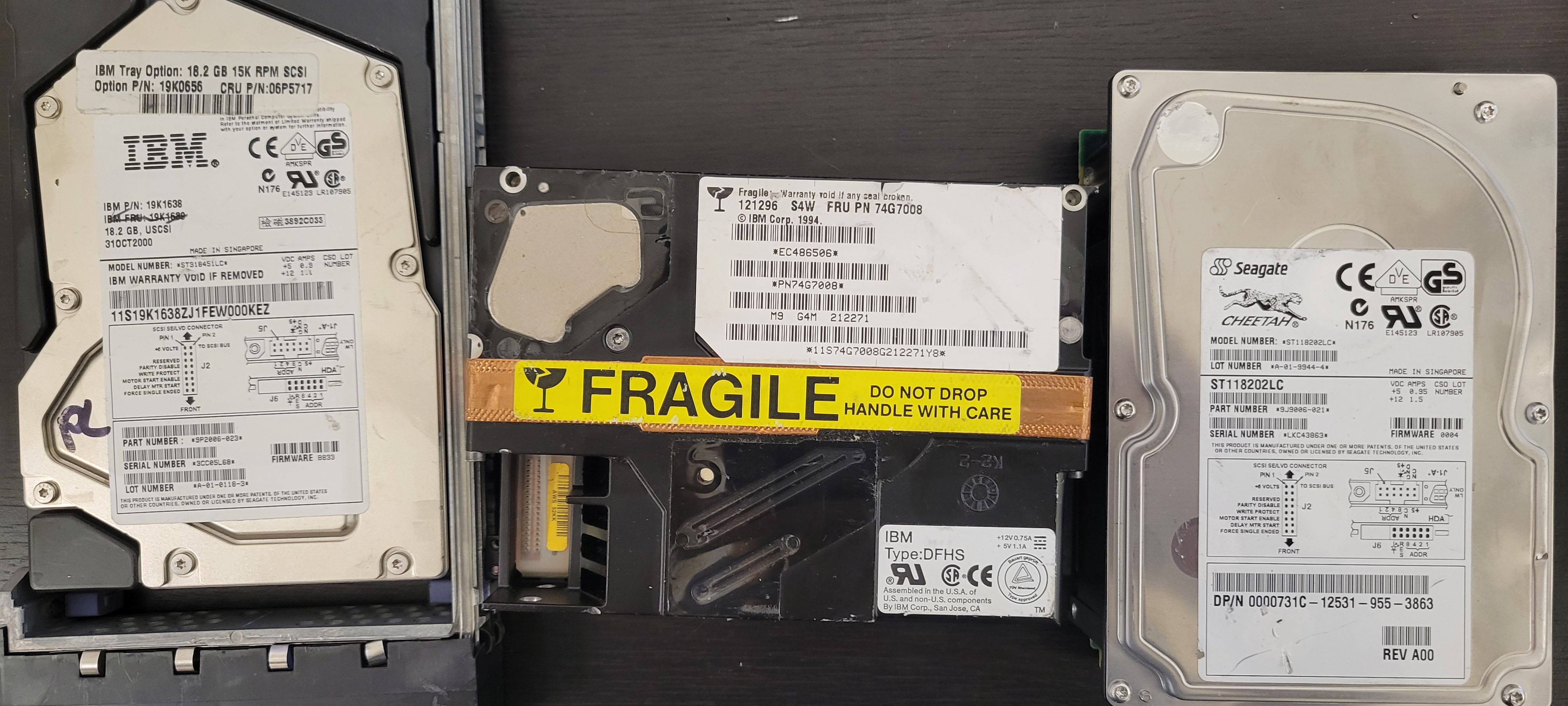

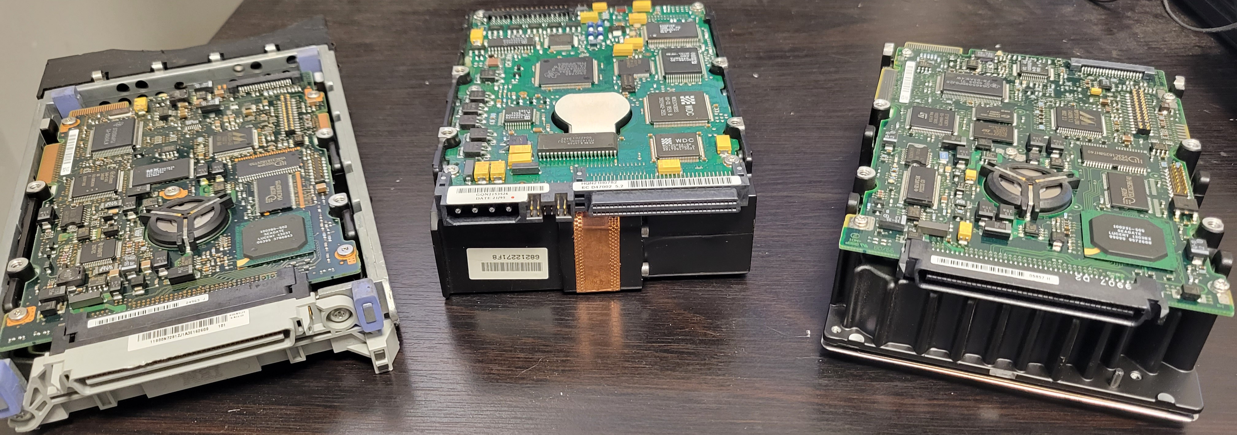

I am also new to this, but would like to start trying to resale some of the hard drives that come through my warehouse. I am trying to follow this topic but most of the information goes well over my head. How would you recommended learning to identify different types of hard drives? All these types are new to me.
I can Identify sata and ssd's. I know what 2.5 and 3.5's are, but the rest of it might as well be a foreign language to me.
Also what are these three considered? I probably have half a gaylord of similar drives I am trying to figure out what I can do with.
PostPosted: Mon Jun 27, 2022 5:07 pm
Ohh! Fun stuff!!!
The shiny ibm is a “high speed” scsi drive. These will work for most old Macs, MC IBM PCs, just about any 90s workstations.
The middle ibm is an early 90s workstation drive. Probably from a 300 or 600 series WS. Or a competing unit.
The cheetah, if it works, is a popular choice in 16bit, 20bit, and 32but retro systems outside of the win/Mac/Unix world. The drives have a dead lead in that is writable and are under-provisioned. This means they can support trac 0 file systems, not just track 1. AND have more space than they claim. A minor firmware patch allows both non-standard FSs and full disk access, as much as 25%+ over the stated site. But this reduces speed because it removes the multi-point read method these drives use.
The left one is scsi (uSCSI)
The middle one is probably MC (and a dozen other names) and requires an adapter to connect to a scsi interface.
The right on is probably SCSI2
The first test is to hold the disk vertically and gently rotate it and listen for any clinking or rattling.
If none, second test is a power on. You’ll need a system with the right interface. Preferring one that isn’t important incase of on-load viri. Dos/CPM boot disk or a classic Unix or linux boot disk. If the drive spins up you have a good board and a good drive.
Final test is to load an OS or live disk and run a disk test. Gparted works on most systems, and Open-DSK on older ones. ODT is also available.
Again use a system you don’t care about.
I’ve seen rapid payloads installed on even really old disks by (bad word names) people. Everything from bios busters to CS attacks. mem loops. Micro basic boots to divide by 0. There’s nasty stuff out there.
Final step, after the final test, is a secure wipe, and no format. Buyers of this era and earlier prefer unformatted since the OS or rom will run an LLF.
The cheetah with mod firmware can replace any proprietary drive if the host OS supports the disk size.
